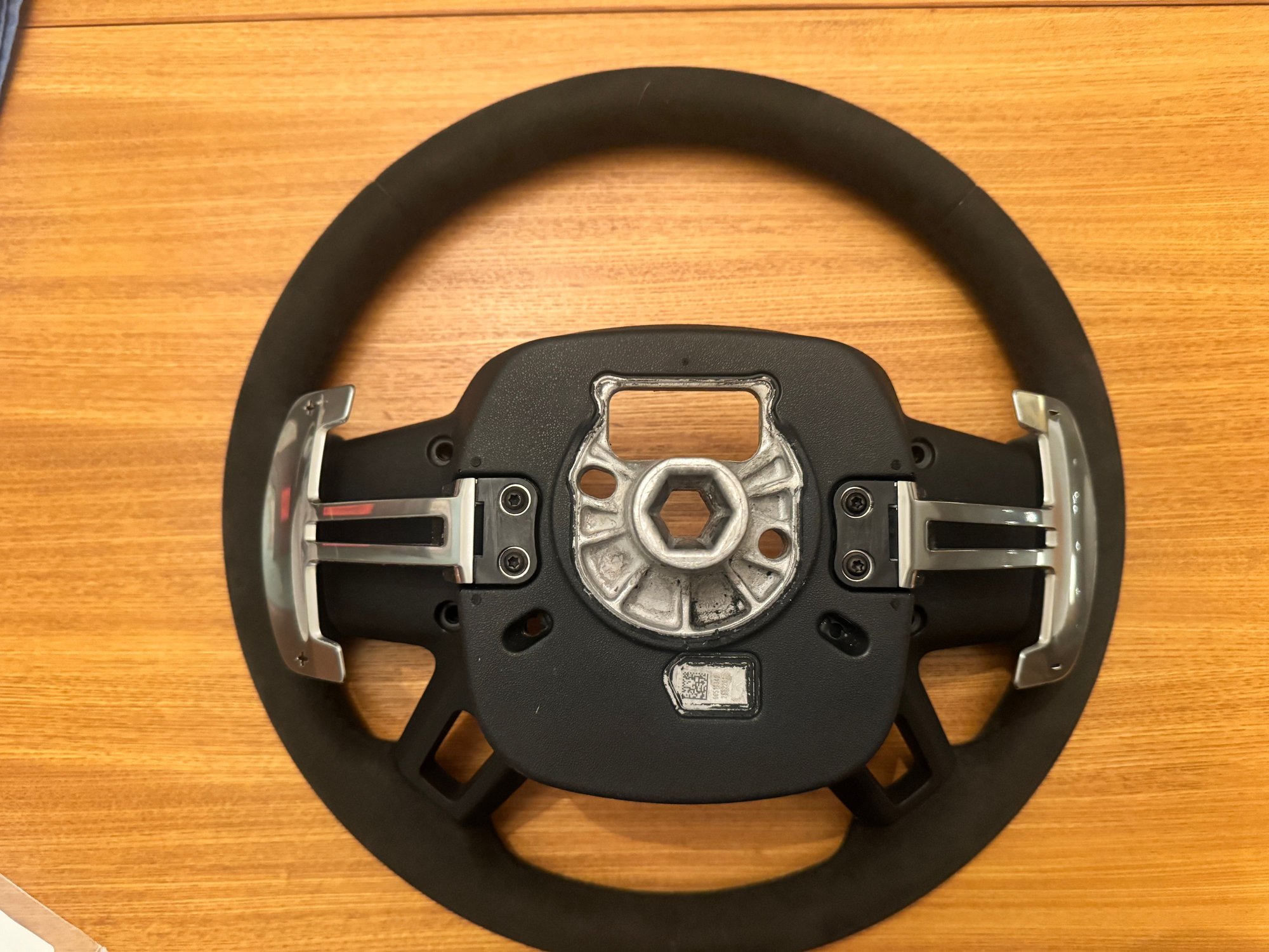

In case anyone needs this info, in adding shift paddles to my L663 (V8 wheel), I found that it’s not possible to source the mounting screws for the actual paddles from JLR in the US, at least not for the past 6 mos. They have been on backorder forever and apparently JLR just doesn’t supply them. LR140025 is the part #.
I found the exact spec of the screw and where to buy them from to secure shift paddles to L663 V8 wheels. These are exactly what LR screw is.
TORX Button head T15 M4x10 (10mm length) black stainless steel

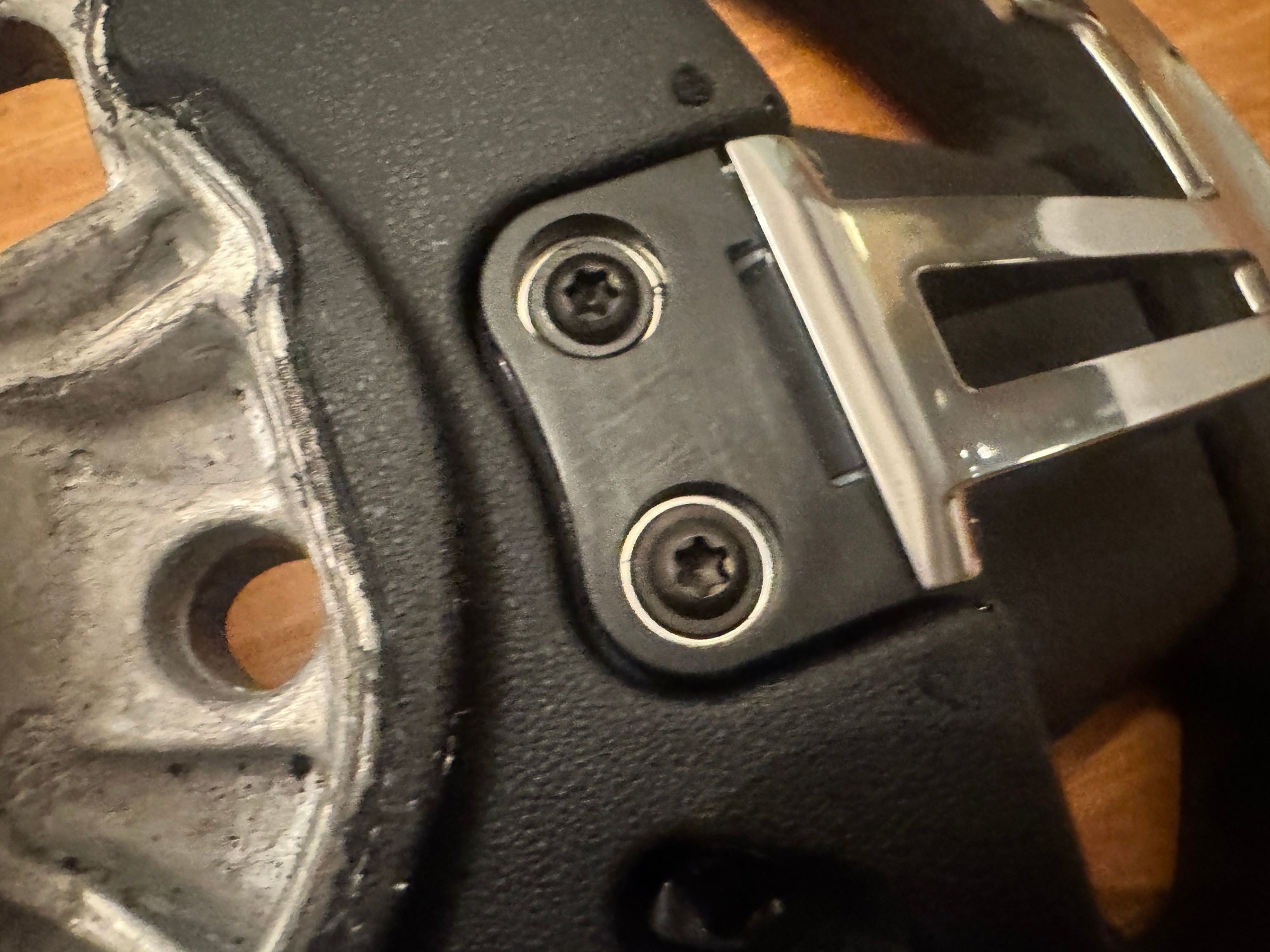

Technically 8 of these screws are used.
2 for each paddle (from rear to secure)
2 for each paddle’s bracket with rubber grommets on the front

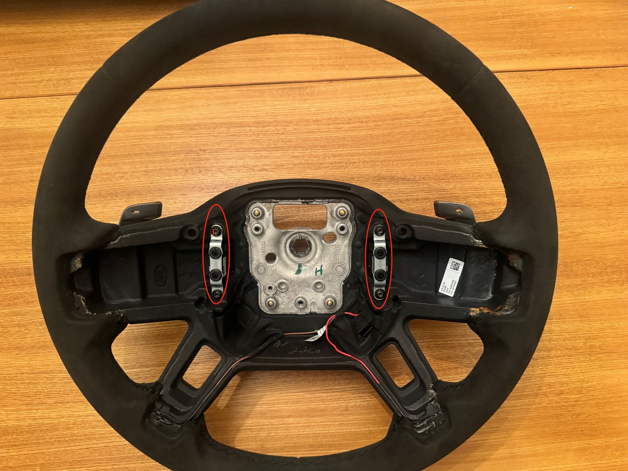

Note: the powerful UK video install does not feature the bracket. You do need them or the paddles are imprecise and don’t “click” as well. They wiggle around. Here’s those brackets circled. The brackets, which you need 2 of, and usually do NOT come with steering wheel. Here’s the bracket. LR154070. Mounts from front, one for each paddle. It has little rubber receptacles that the paddles fit into.

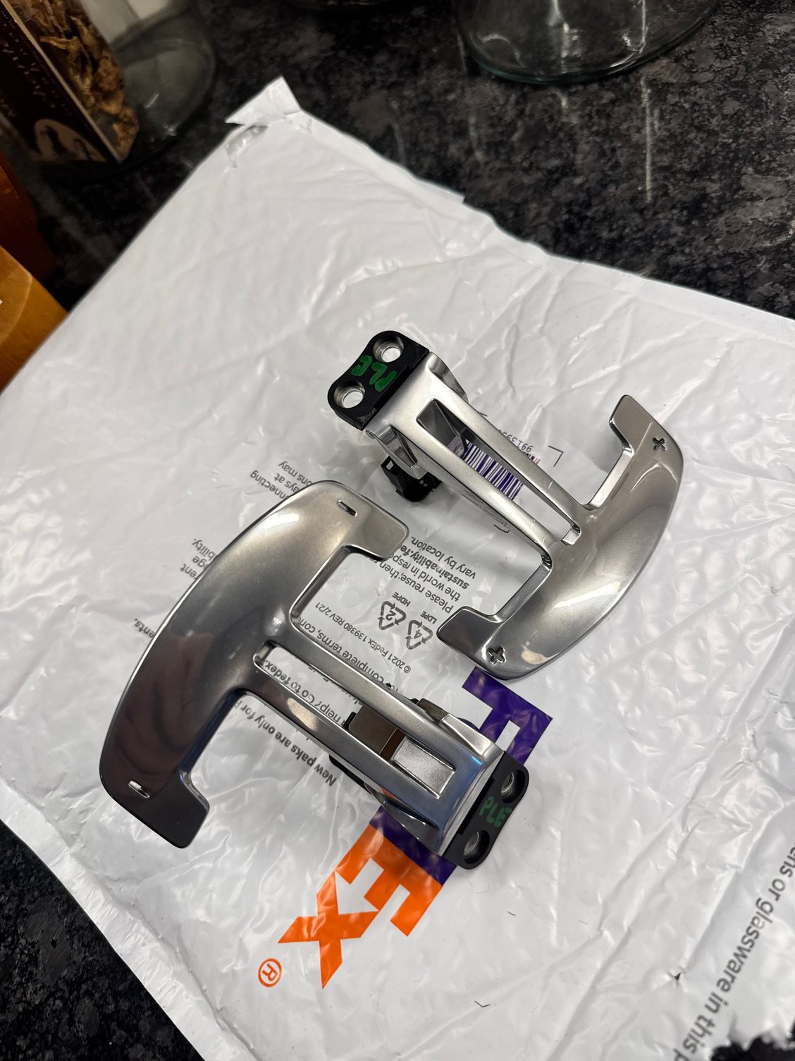

Shift paddles, which you can use from any L460, L461 RRS or L663. I bought L461 used paddles from ebay.

Thanks for sharing! I upgraded my steering wheel but didn't realized I completely missed inner bracket (LR154070)!
When I upgraded, I ordered the screws from dealership and it took about 6 weeks to get those screws (only bought 4) from UK.
Now whenever I shift, I will get so annoyed that my shifting is not scrip click like it suppose to be (once I know, I know.....)

Yes, I was surprised that they missed that completely in the powerful video. It’s plainly obvious that the shift paddle has 2 hard mounting points and then these 2 additional rubber mounting pegs. I tried my paddles without them, exactly as you said: A bit wiggly, imprecise. They still work, but the tactile feeling is terrible without the brackets.
Also, nearly never paddle-capable wheel and paddle upgrade kit is sold without these 2 brackets. Hilarious. I think a lot of people upgrading to paddle shifters are missing these.
