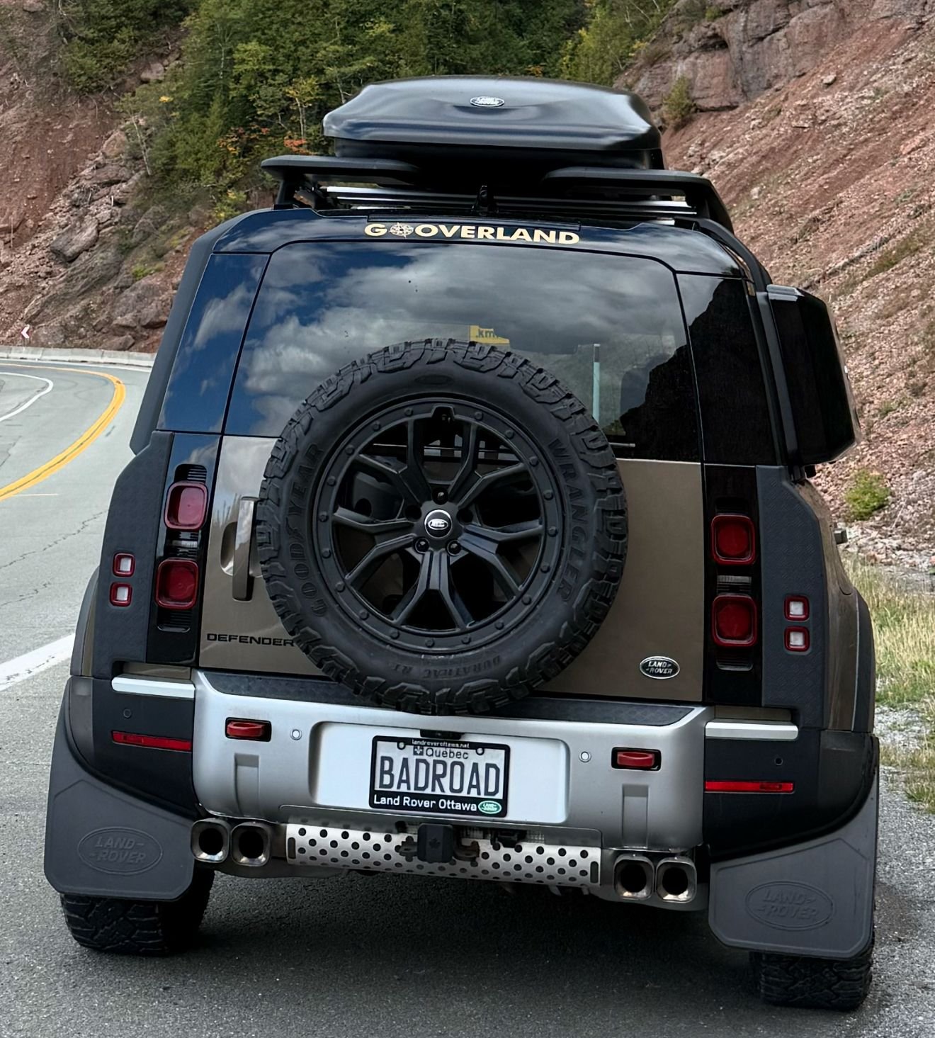

Are the tips part of the exhaust ?? I added the tips to mine and the tips themselves have an angle to them to correct the downsweep and make them straight out.
As for spacers, if you are good at maintaining your vehicle, then fine but make sure you use locktite, do not over torque them and check them twice a year. But I recommend getting wheels with the proper offset to make them outward a bit. +25mm comes to mind as tis is what my wheels have.

Yes the tips are part of the exhaust, I did the same tips to my prior Defender S, and loved it. I will rethink about the spacers, I may do wheels.
