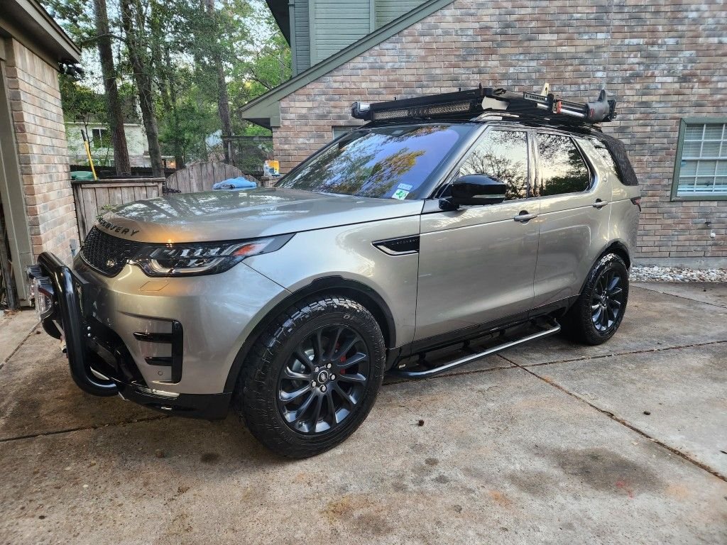

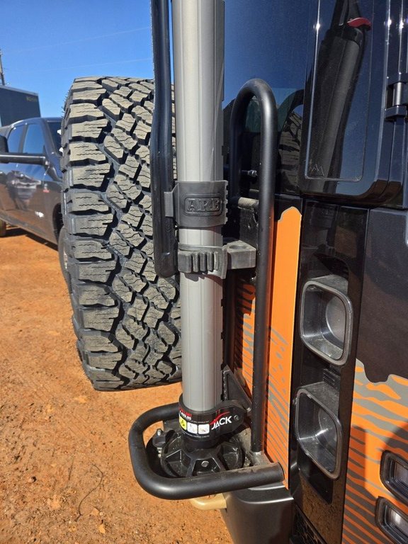

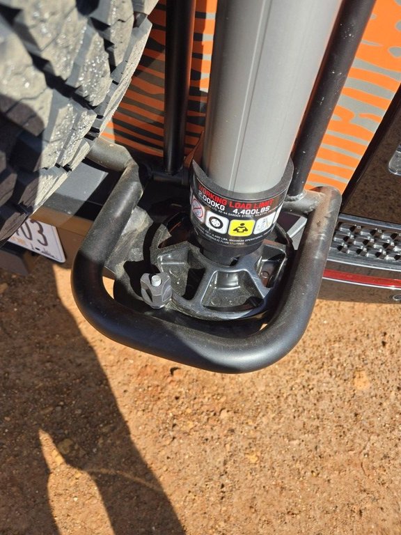

I had hi-lifts mounted on both my D2 and D5 on the roof rack. They always worried me pulling them down. The D2 was easier than the D5 which when mounted on the side of the rack sat just a few inches above the roof.(Picture for reference on what I am avoiding on the mount) On our new 130 I am still planning on a rack but will use LKY8s rear mount this time with the ARB hydraulic jack that I purchased late last year. A bit lighter to move around over the hi-lift but you do loose some of the functionalities that it offers. Also, more expensive for the ARB over a hi-lift but I was able to get it through Summit using a coupon and military discount. I snapped a few pictures of the Octapus's mount at SCARR.

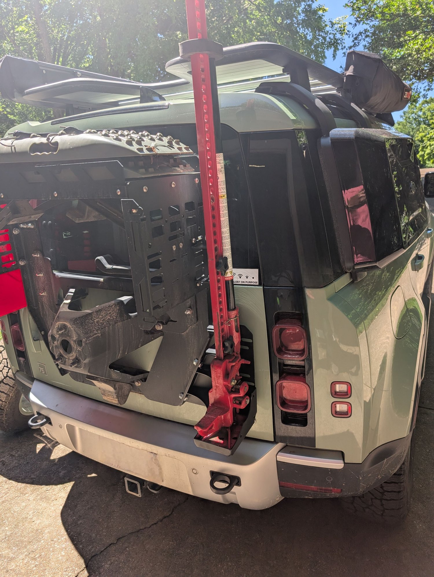

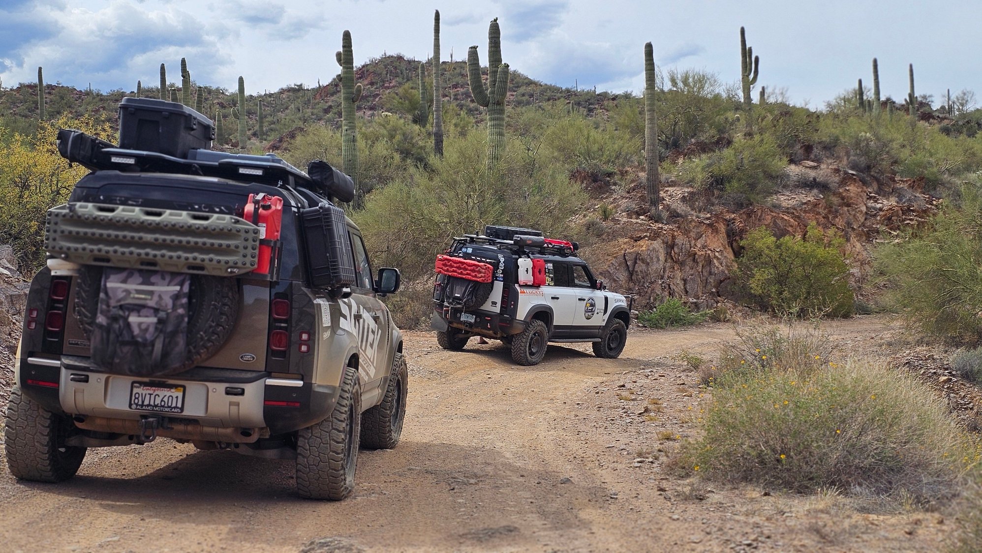

The weight "limit" has been a myth spread by misinformation over social media. Many of us have disproved it already. I been pushing the boundaries carrying over 100lbs of extra weight over the oem wheel and tire set up for years now. Here's our tailgate rack we designed for it and we have a hilift jack mount coming for it very soon.
Both defender have our tailgate rack. Our is carrying a  full jerry can that weighs 40lbs a propane tank that weighs 15lbs and the maxtrax extreme that weights 20lb. The rack itself weighs 40lbs and the 35s and wheel combo weight about 112lbs. Oem weighed about 75lbs
One of our prototype hilift jack mounts being tested out.
