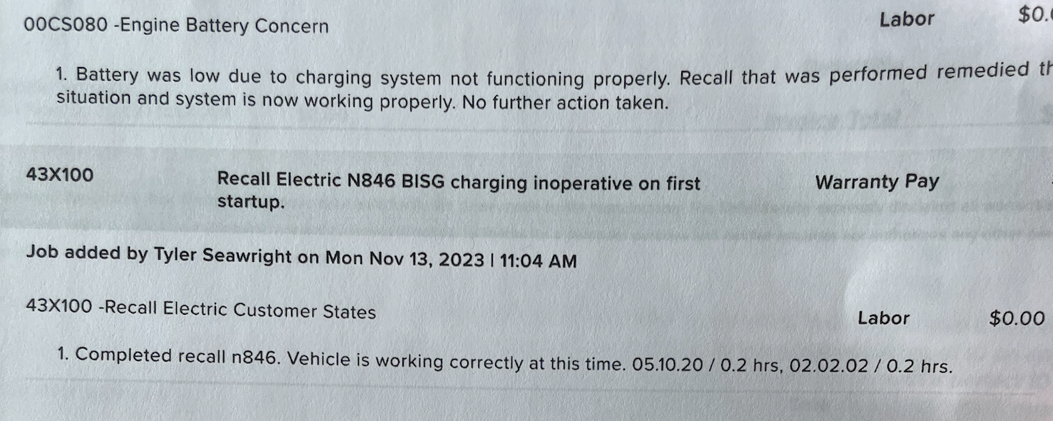

Ok I had my vehicle updated with the new firmware for the BISG. My issue had become pretty easy to reproduce so we will see within the next couple of days if the issue is actually fixed. I am hopeful given what it appears to fix seems to be the exact issue I was having. It looks as though this may end up being an actual recall vs. a TSB, at least given the work order calls it "recall N846". Had a great experience with the dealership here in Salt Lake City. Here is a picture of the pertinent info:
Thanks for the update. I checked Topix and my vehicle shows "N846 - BISG CHARGING INOPERATIVE ON FIRST STARTUP".
Seems like a few others are reporting the issue now.
I wonder if my issue might have been fixed with a firmware update rather than a new BiSG?
