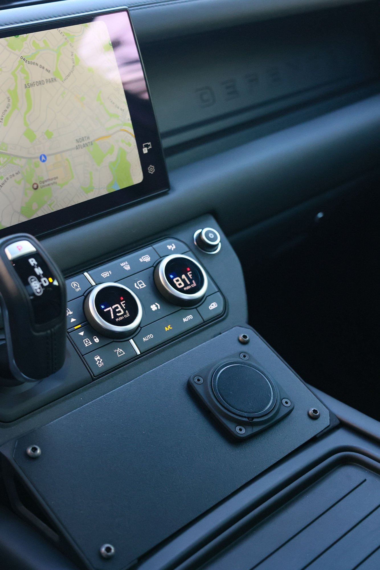

You can also go this route from powerful UK and install a rocker switch on the blank aluminum plate. Completely reversible so you’re not damaging parts on the car by cutting/drilling
