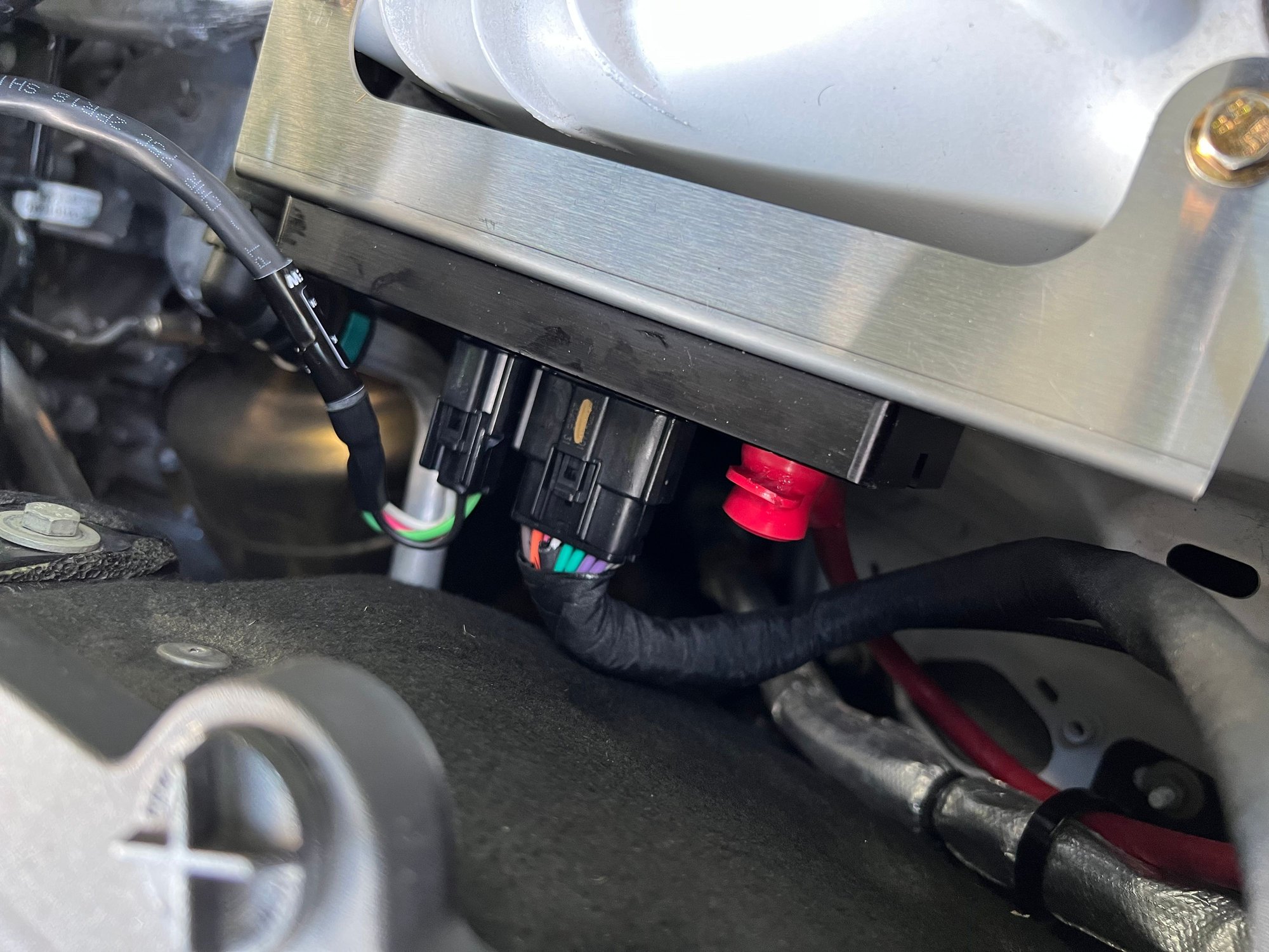

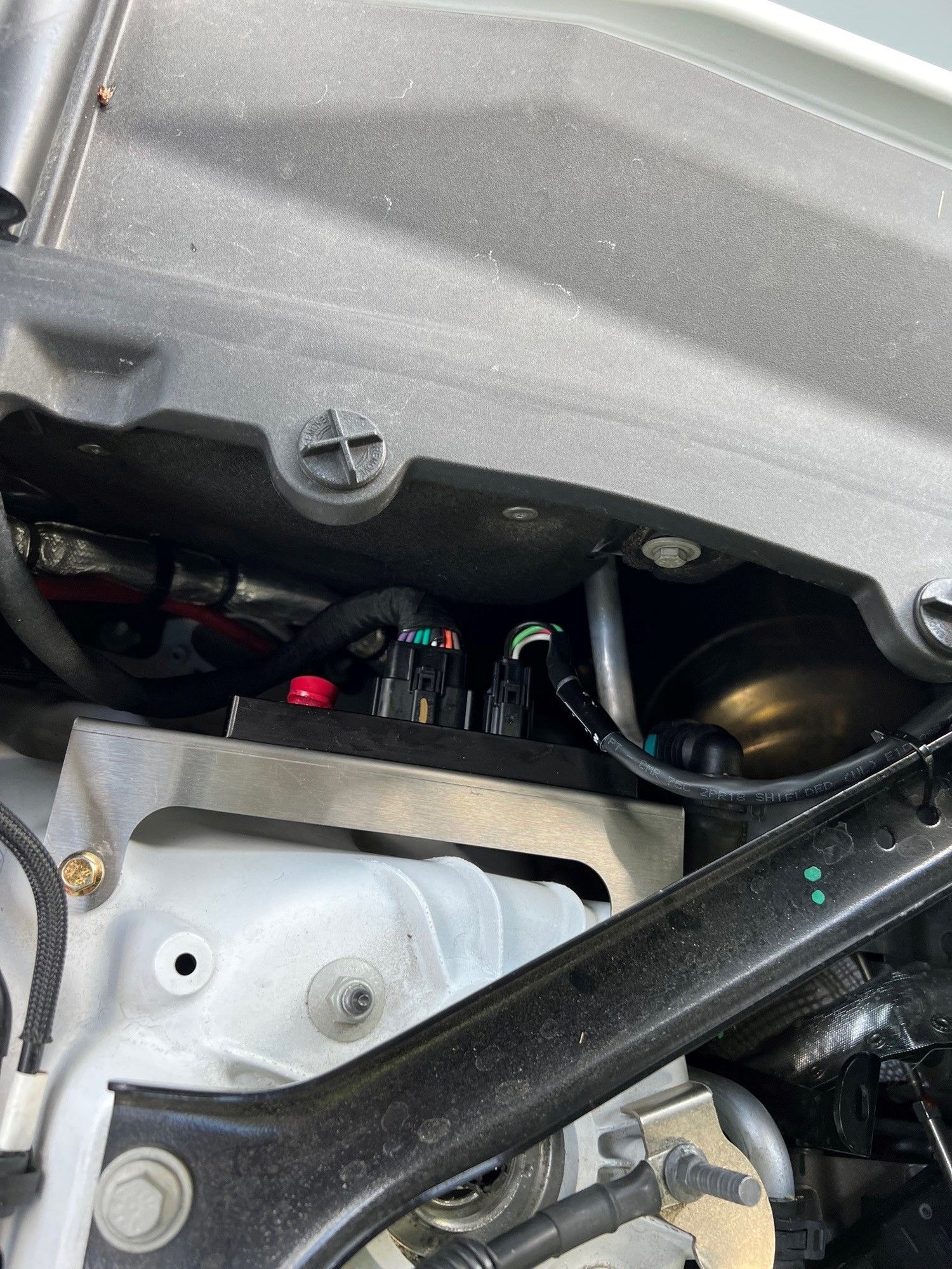

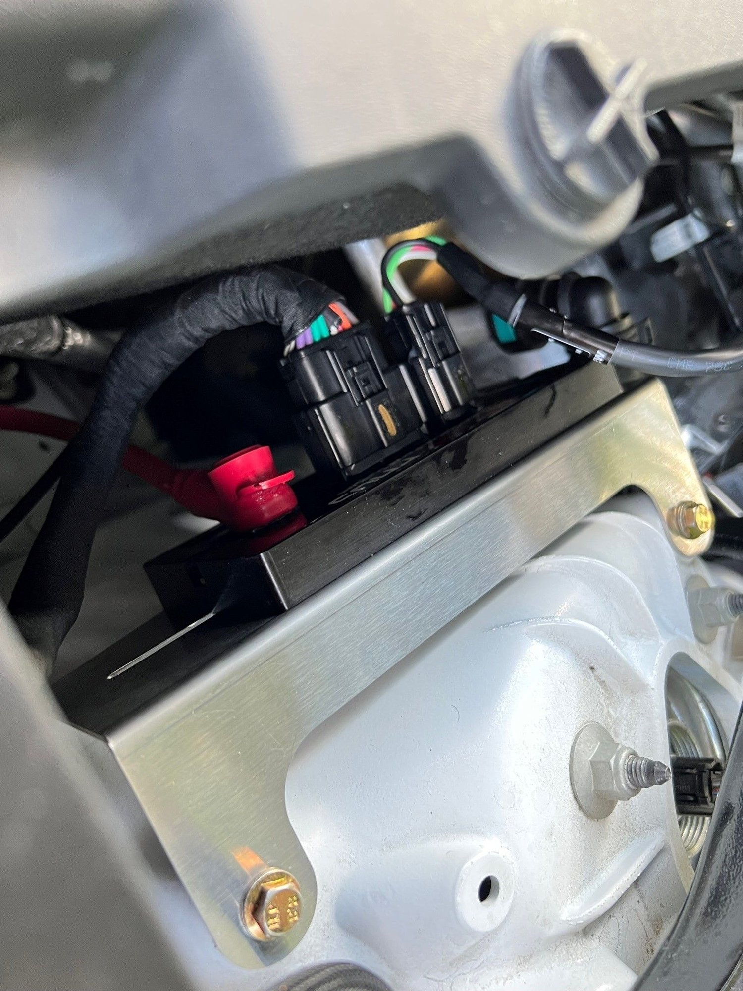

I installed the SP9100 into my 2022 110 P300 S using Saltek brackets and installation guide. It was mostly straight forward, I took my time and customized the wire harness so it matches the factory wiring under the hood. PM me with any questions.

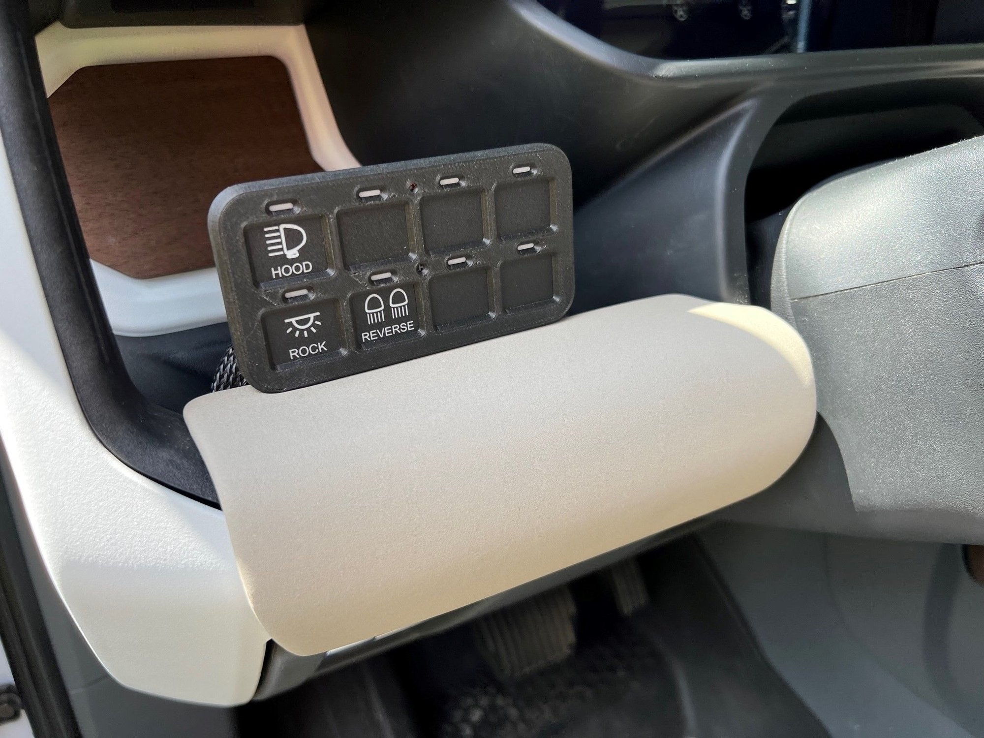

Perfect! How did you choose to mount the panel inside the cab? Did you use a bracket or did you drill in? Thinking something non-permanent so a mount with double sided automotive tape or something. Thank you for the update though! The car arrived at the Dealer yesterday so trying to find a slot to go get it. :-o

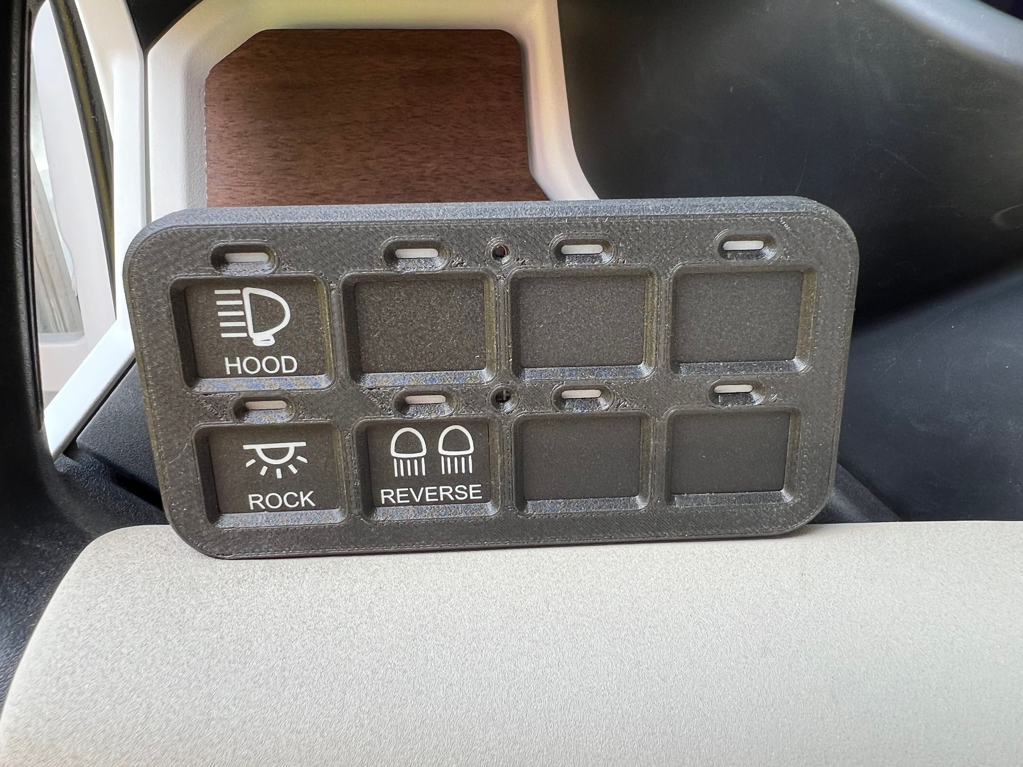

The Saltek bracket set came with the mounting bracket for the panel, no drill and reversible back to OEM. The wires from the panel come out the back, automotive tape will only work if you make some sort of enclosure for the panel.

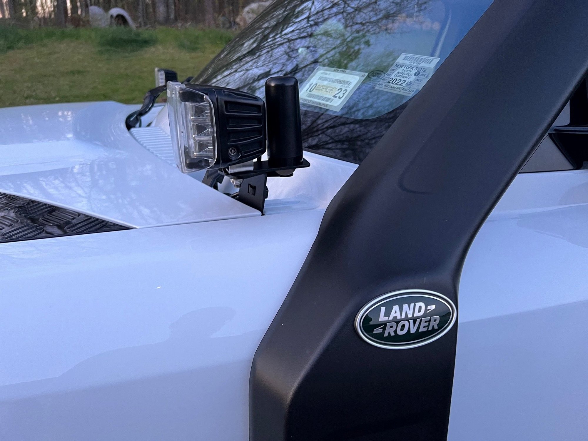

Saltek Motorsports makes a perfect mount for our Defenders, very high quality super sturdy, simple/clean install, and the cubby is still usable.

Wiring I used for the Switch-Pros
IGNITION Input (lt. blue wire) - F11 under hood fuse box
LIGHTS Input/T2 (White wire) - Passenger front marker light
TRIGGER 1 Input (pink wire) - Whatever you want
