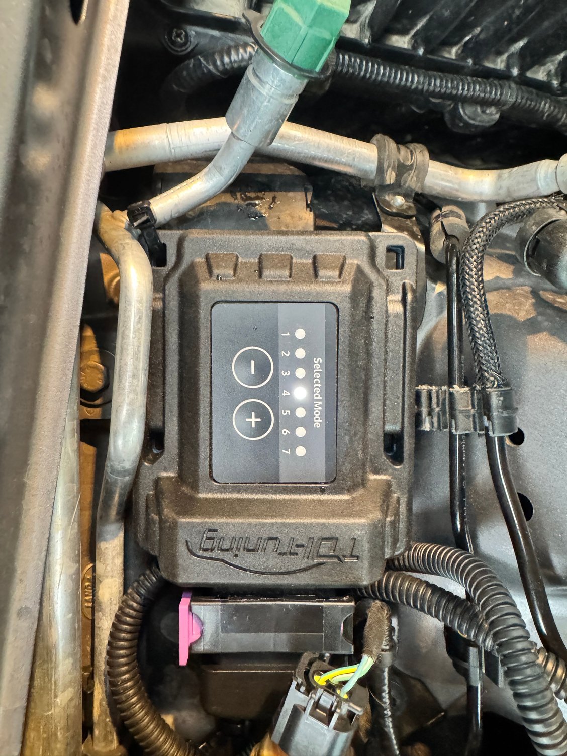

If anyone is curious about the TDI-Tuning box on the P400, here’s my experience over a longer arc rather than a first-day impression. This is not a full ECU remap which would be the most preferable tune (I have tuned modern V8 SC LR’s with great result but cost is in the thousands) -- but it’s also not just a crappy “Pedal Box” - Pedal boxes only change throttle mapping. This unit modifies engine inputs, which is why the behavior under load is fundamentally different.
I originally bought the TDI box back in 2023. Installed it, drove roughly 1500 miles, and genuinely liked it. Noticeable bump in mid-range shove and smoother response. No drivability issues while installed.
I ended up removing it because I had a dealer appointment coming up and didn’t want any questions or flags with the warranty when they saw the box underhood. Forgot I even had it.
One important hardware note:
When uninstalling it back then, the plastic locking tab on the tuning harness connector that clips onto the boost control valves broke. The OE connectors are robust; the tuning harness connector is not on the same level. I wasn’t forcing it, but the tab failed. I emailed TDI and, to their credit, they sent me the replacement harness free of charge.
Fast-forward to today: Warranty’s over. I found the TDI box in the attic. So I reinstalled the box using the replacement harness. You need to make sure the car is shut down (5 mins door closed, key not near car, hood open) before doing this, btw per TDI’s instructions. Then I drove about 20 miles on the middle setting (4 of 7) to calibrate it per those same instructions, then switched it to setting 6, which they describe as aggressive but not the full “fastest” setting.
After reinstall, everything works as expected. There’s a noticeable power increase (I believe due to higher turbo boost), especially in Dynamic mode with the gear selector in S. Also, It pulls harder in low gears around town or zipping up hills in 2nd/3rd gears -- in normal/comfort and with gear shifter in D or S.
I always felt the stock P400 is slightly weak on highway passing between 70-90 mph, unless it changes up gears and even then, it never really rocketed off. Unsure if it’s aero, the weight of the car or engine settings but -- at those highway passing speeds, faster acceleration is apparent now. It feels stronger. Maybe 10%-15% so?
If I had a quick take on this... something like:
-Performance gain is real, is repeatable. It’s not placebo.
-I monitored engine temps w/ IIDTool in real time before/after and didnt see anything change really.
-Install is simple. Reversible. Undetectable to JLR when removed.
-SO, harness connector quality is the weak point and deserves care and -I don’t know if it’s possible to remove these connectors without breaking them (on the TDI harness side, no damage to vehicle).
-TDI support was solid when I needed it.
One note: I do NOT think you could buy this, and should plan on infrequently uninstall it in preparation for every dealer visit. I don’t see how to undo the TDI-tuning harness-side connectors to the 2 sensors underhood without breaking the clips on the TDI-turning harness. (And yes, I know what I’m doing and all the tricks like pushing IN on the connector, not using screwdriver to force it, etc...)
Long term, I’ve tuned lots of Turbo cars and havent had longevity issues over time. Hoping this is the same. I’m running it at 6 setting, maybe 5 for a nice increase in power - probably won’t run it at 7. In 7, it’s definitely more wild.
Not posting this to sell anyone on it, but there isn’t very much L663 tuning or P400-specific feedback out. I’ll post back up after a period to update.

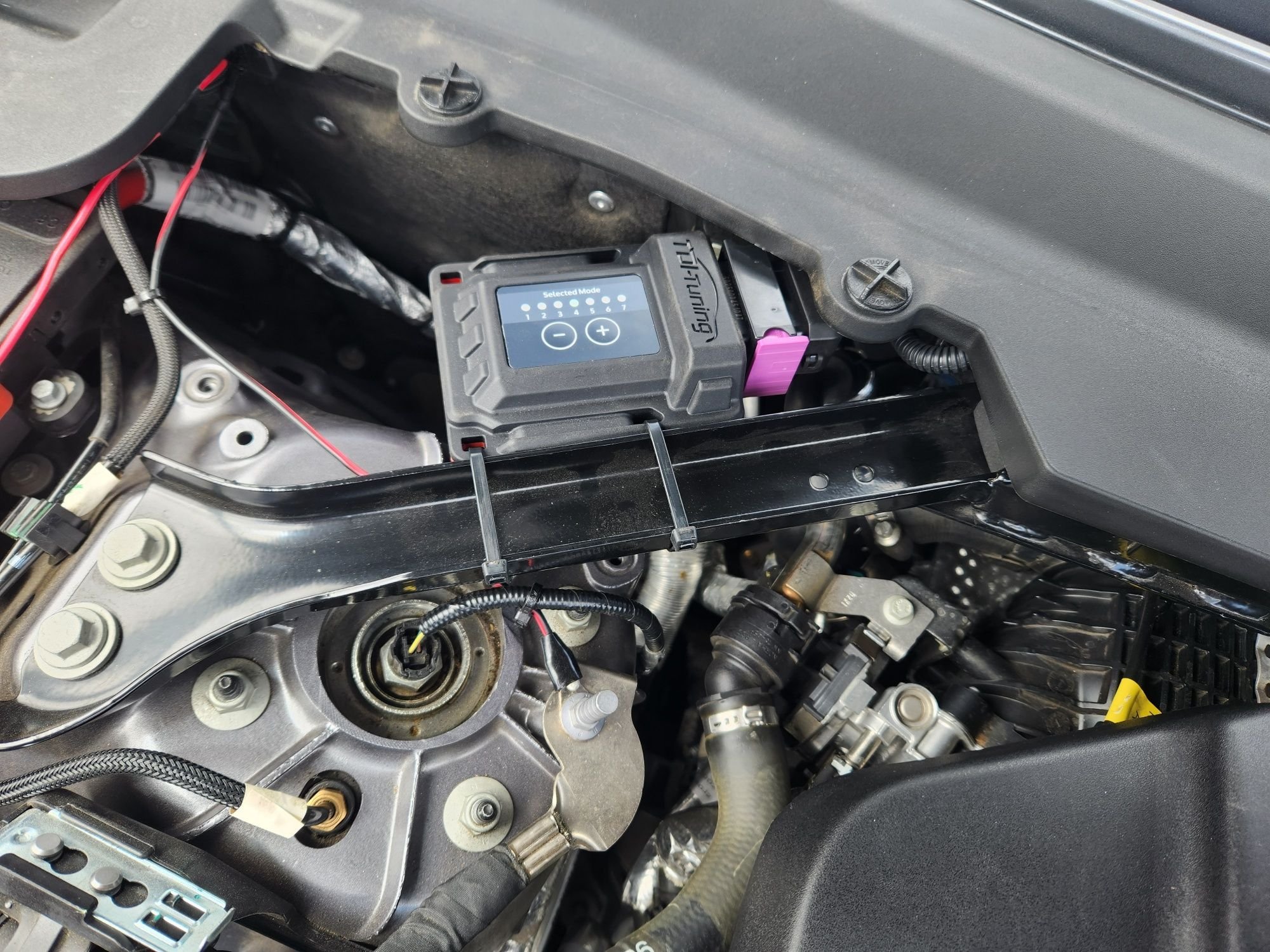

Installed on my 2022 110 SE P400 i6 today. Thus far on Level 4 with noticeable improvement in torque and a more linear throttle response. Easy install other than removing the rear harness (Boost 1) since it was a very tight fit for my large hands. Will have to see the impact on fuel economy etc.

@Ford Nice mounting location (I chose the drivers side b/c I have winch wiring / accessory wiring in the passenger area).
