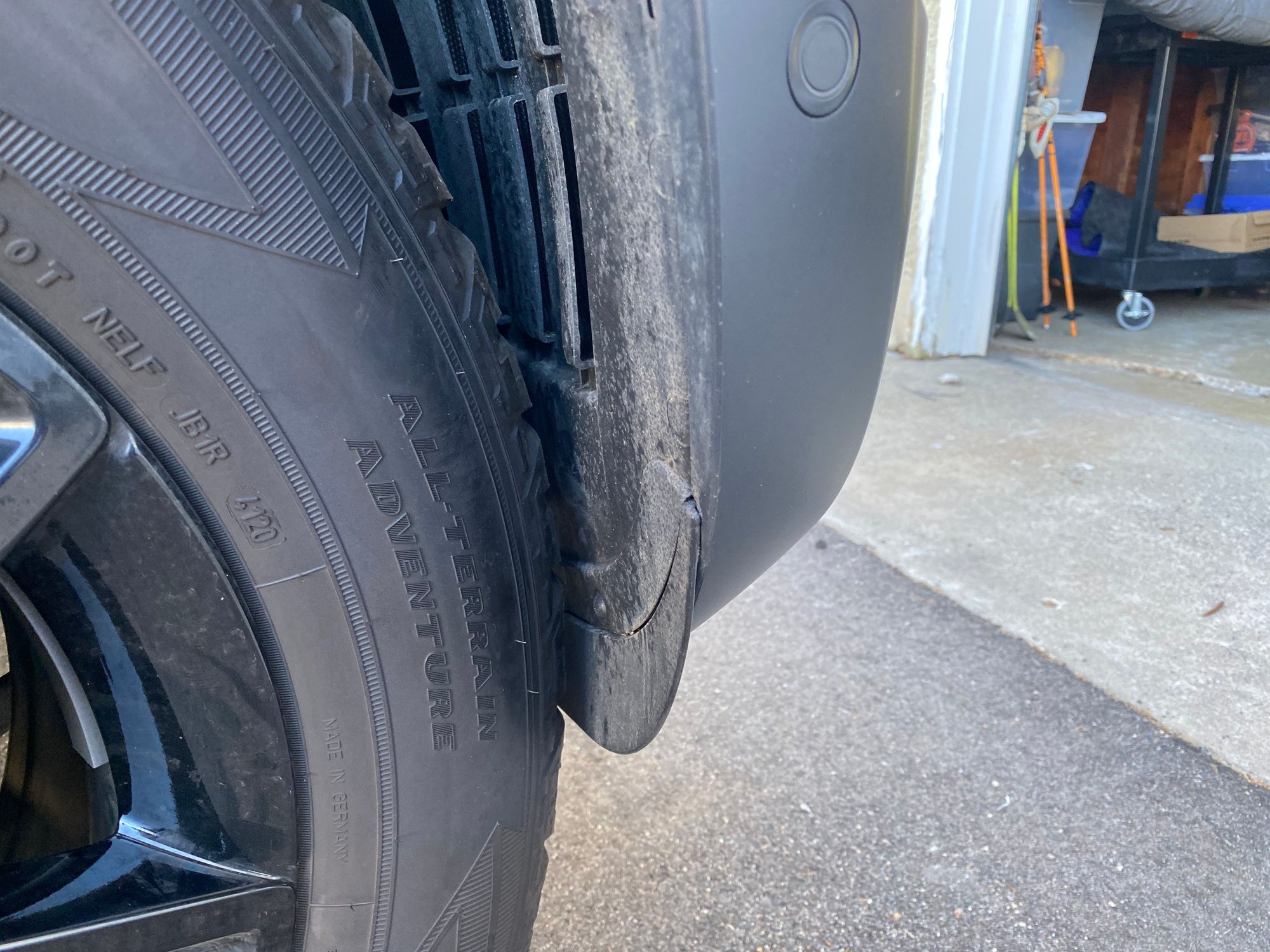

Sorry if this is super redundant but how the heck are you getting those to fit without rubbing? The photos below are of my 2020 with the stock Goodyear AT(ish) tires on the 19” wheels using a 30mm spacer and 1.5” lift rods. Picture taken at normal ride height and full left hand lock. I also put it in off road and it didn’t really change anything from a clearance perspective.
I’ve got Pilbarra Steelies waiting to go on with a bit more offset and was planning on the 275/70/18 BFG AT K02s but I just don’t see how they are going to fit, at all. Am I missing something? I know this has been covered off a million times but the general consensus is that 275/70 works with 1.5” rods, I just don’t see it working. Thanks in advance for any insight.

It probably will depend on which Pilbara offset you've bought. +27 or +44
With the spacers and Tuffant Pilbaras depending on the offset you've gone for, at their offset of +27mm you're really going to be close to the wheel liner.
OEM offset is +41.5. With ET27s and spacers you've gone to -3.0mm That's a big change.
I didn't go for the Pilbara's as my understanding from speaking with the good folks at Tuffant, was that spacers are needed to fit the brake modded P400. The 27mm is a newer offering I believe so that may be only applicable to the 44. .
I run 265/70 R18 ET+29 stock suspension so not quite an apples to apples comparison. Nothing to spare. Zip. Nada.
I do know others running 275/70 R18 fit on Tuffant Simpsons (same +27mm offset as Pilbaras) , no spacers and a 1.5" rod lift. No problems.
Apologies if my ramblings are irrelevant.
Edit: I like the AT(ish) description. These really are a highway tire in all but name.

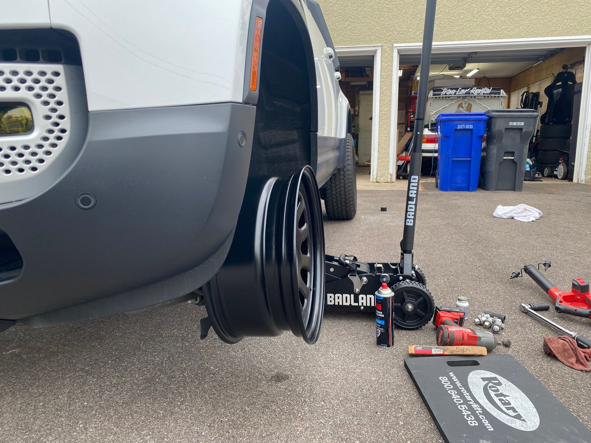

Thanks Gavin, I went with the +27 Thinking I could use them without spacers on my p400. But that didn’t end up being the case, they didn’t clear the face of front calipers or the rears. I went with the 30mm spacer just due to its popularity and availability, I might be able to step down to a 10mm and get the clearance I need without sticking too far out. Not trying to look like a Jeep owner 😆
This is the test fit with the spacers on the front:
Might just go with the 265/70 and see what happens. 🤷‍♂️

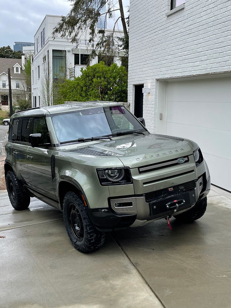

These are 275/70/18. Working on fitting 285/70/18
