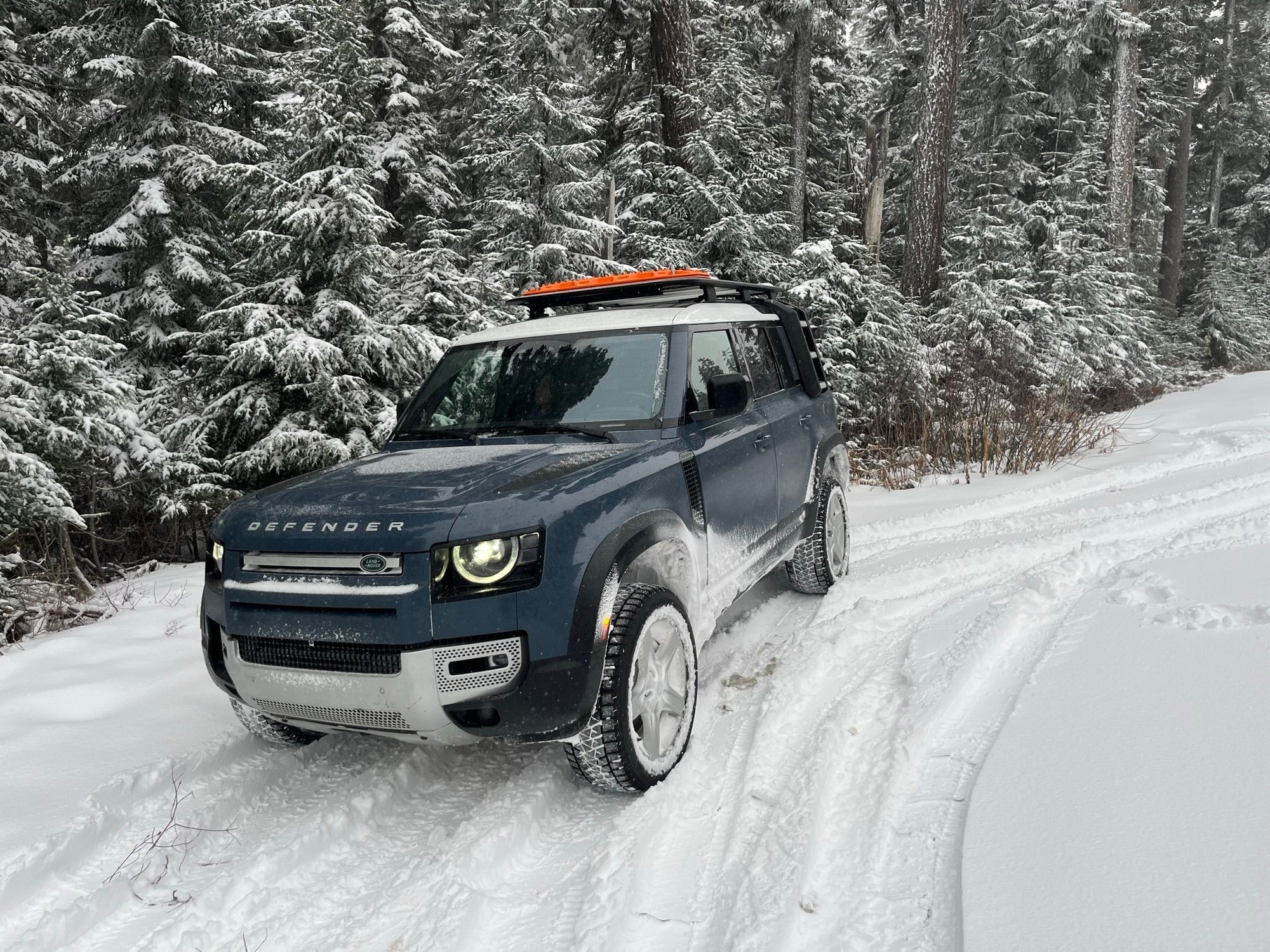

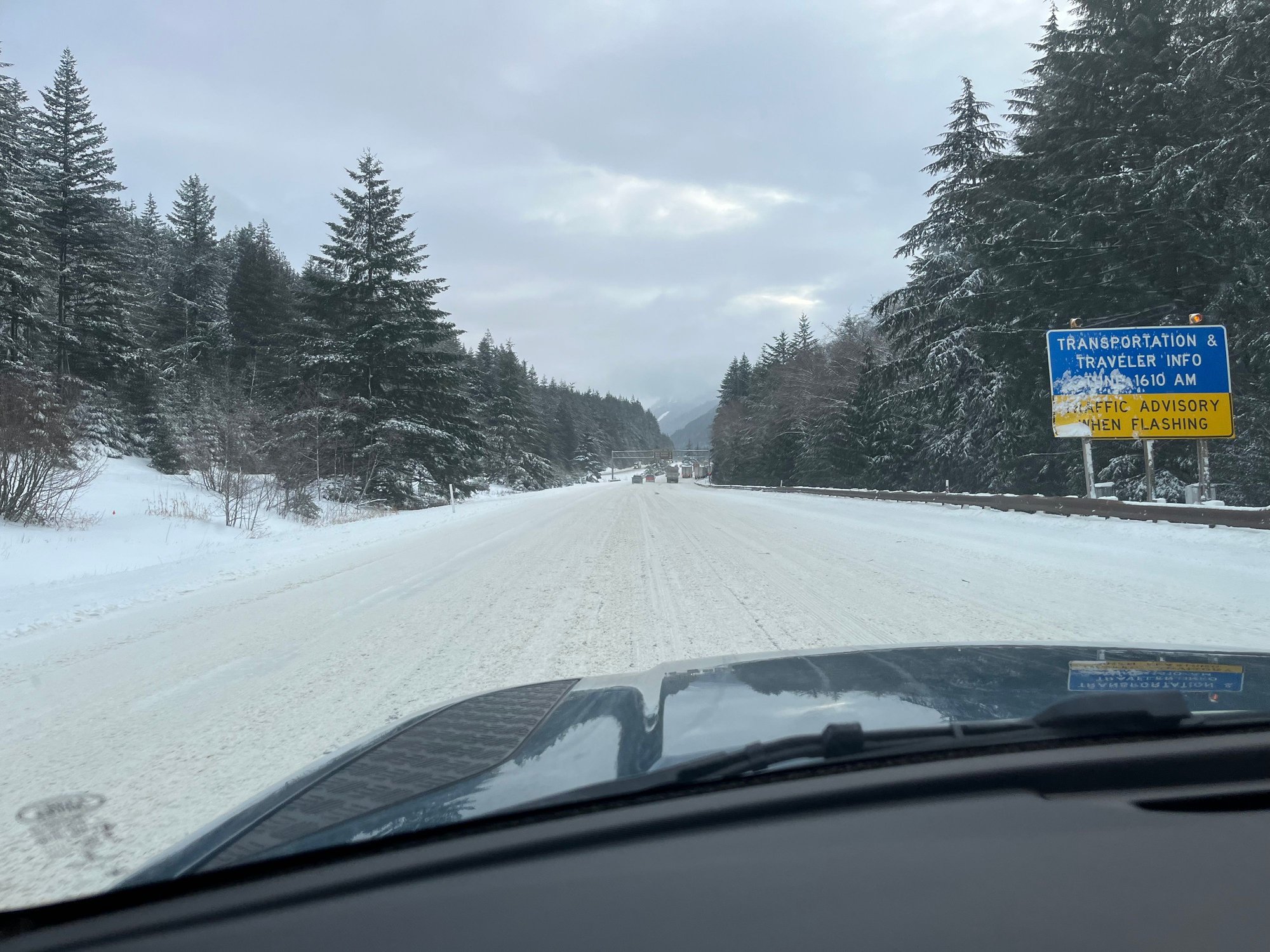

Snow tires
I’m a convert.
Best but of cash you can spend if your in the snow a lot. Traction for days.
