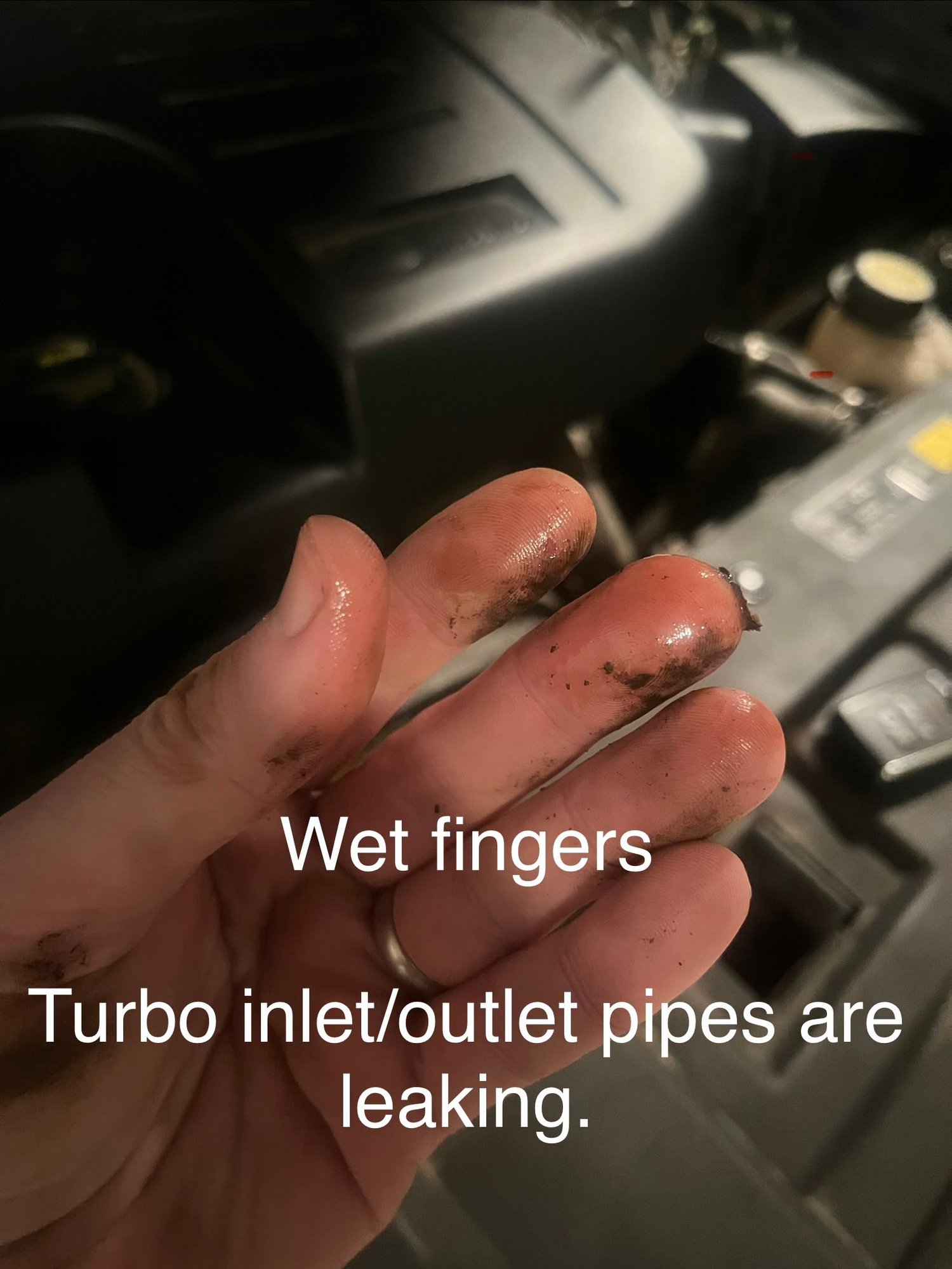

Old Mar 2, 2026 | 10:05 PM
GavinC's Avatar
Joined: May 2021
Posts: 2,582
Likes: 3,655
From: Kirkland WA
I have this issue. Thanks OP for sharing info.
I found my leak with ease. A quick reach around the turbo.
