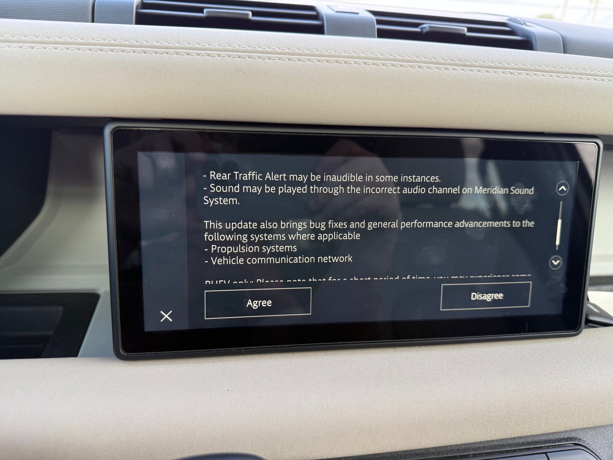

I just updated mine after I installed my wiper blade. Haven't driven it since the update was installed. I have my car coded to allow for auto stop/start memory, so I wouldn't have known this was a problem. I'll try it out, see what happens and report back, but I wonder if its powertrain related and has to do with the BiSG vs the traditional auto stop starter motor.
Adding in a picture I took of the changelog, which includes updates & bug fixes to "propulsion systems."

I agree it is surprising - It’s not just a PIVI infotainment update. It’s an OTA software update that is updating the modules in the car, in this case the “propulsion systems” which are updating engine management ECU’s. I’m guessing that’s what is causing my issue.
