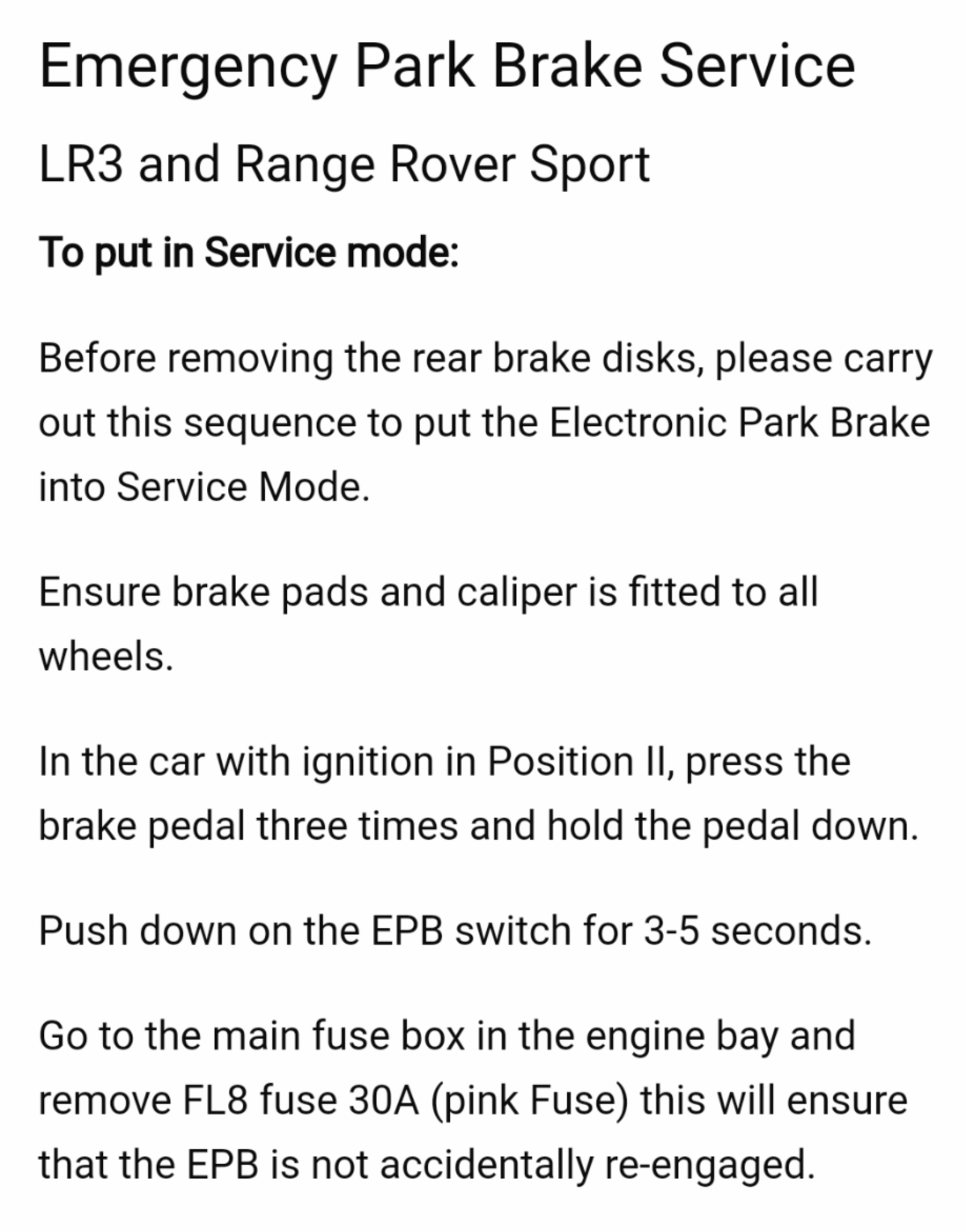

I, too, would love to see a video re: someone changing the brakes. Love that India forced the issue and would be interested in seeing how it works in the US. However, for now, you need what appears to be a very proprietary diagnostic equipment to unlock the Emergency Parking Break controllers.
The Defender Workshop manual states that Step #1 for changing the brake pads is: "Use the Jaguar Land Rover (JLR) approved diagnostic equipment to activate the Integrated Power Brake assembly mode. Refer to Integrated Power Brake Assembly Mode (206-00 Brake System - General Information, General Procedures)." Basically it goes on to tell you how to use the JLR equipment to set/reset the EPB before / after changing brakes.

Unfortunately the "Integrated Power Brake assembly mode" is a procedure that affects the ABS module and has nothing to do with the Electric Park Brake service mode (which can indeed be manually activated and deactivated in the Defender as in the LR4, although the step-by-step procedure is a bit different - see attached.) As far as I know, you can activate / deactivate Integrated Power Brake assembly mode only via approved diagnostics. Whether or not that's a mandatory step for a successful brake job remains to be seen, since that would mean indy mechanics / DIYers unequipped with LR's diagnostic software may not be able to ever perform simple brake jobs on this vehicle, and that kind of proprietary BS by car manufacturers is normally frowned upon by all sorts of consumer protection agencies here.
