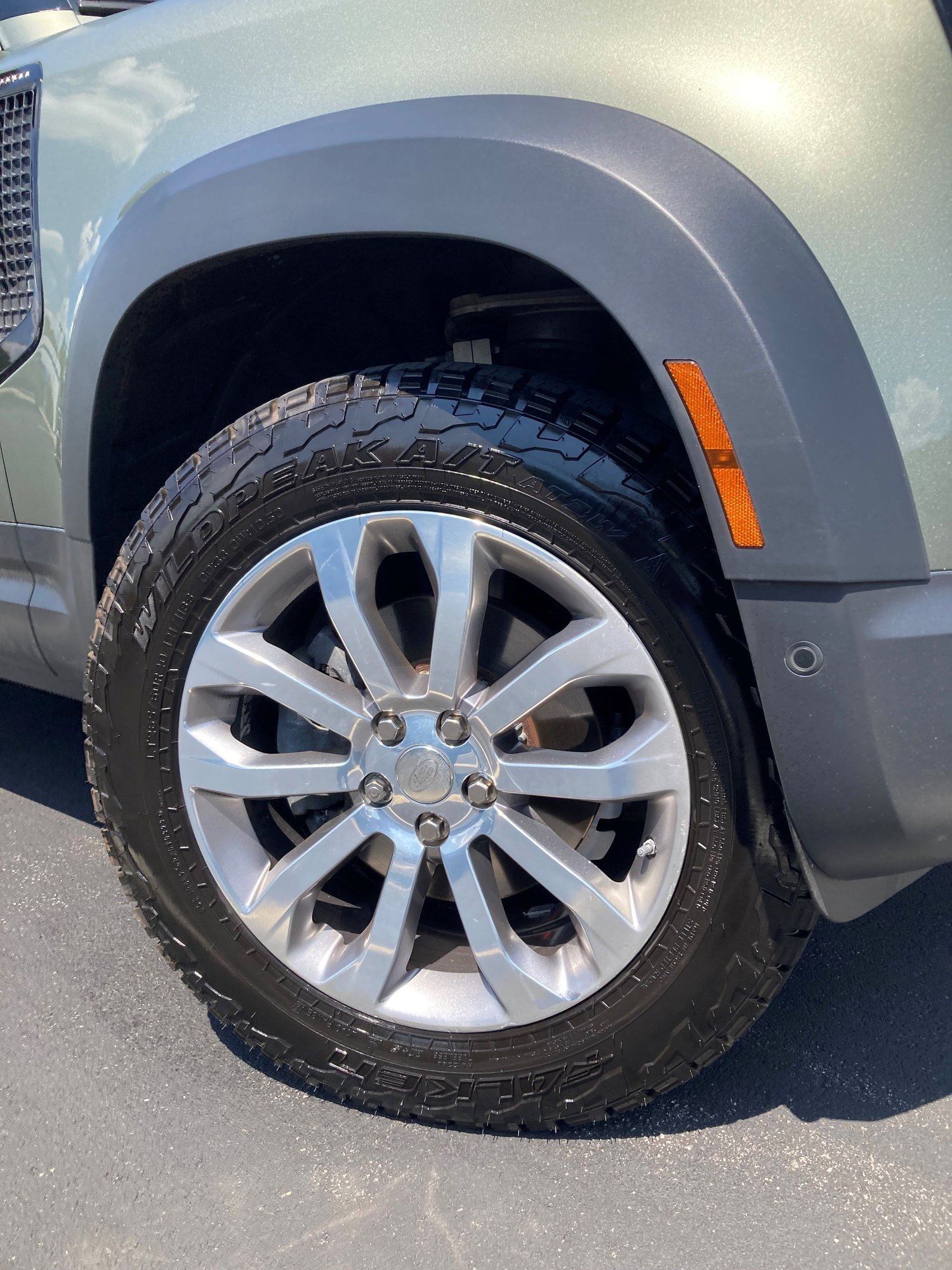

Assuming you have a P400, then yes, you will have to either grind or swap the rear calipers to make 18" wheels fit. 20" wheels are plenty fine for off-roading 80% of the time - you still have plenty of sidewall. The maximum diameter tire you can fit on a Defender without modifications is 32.6."
I originally specced the 19" wheels on my Defender, and that was a mistake. I swapped them out for a set of 20" Style 516 wheels from an LR4 XXV Edition on Falken Wildpeak AT3Ws sized LT265/60R20. They have a different offset to the standard Defender 20" wheel, but they fit just fine. I highly recommend the Wildpeaks - good on-road, excellent off-road, fantastic wet and snow grip and they aren't too loud at highway speeds. There are a quite a few other users on this forum that run Wildpeaks and love them.
