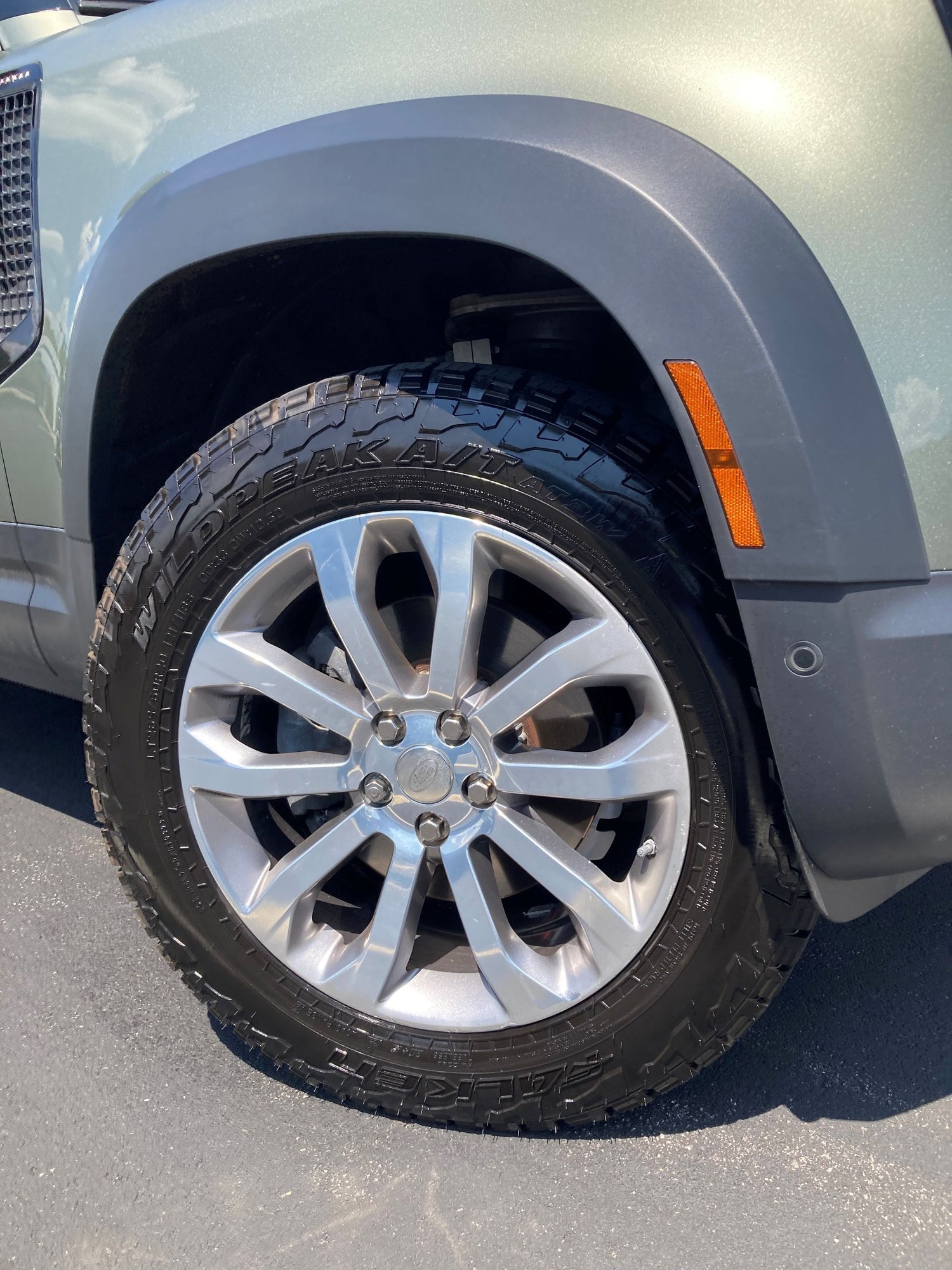

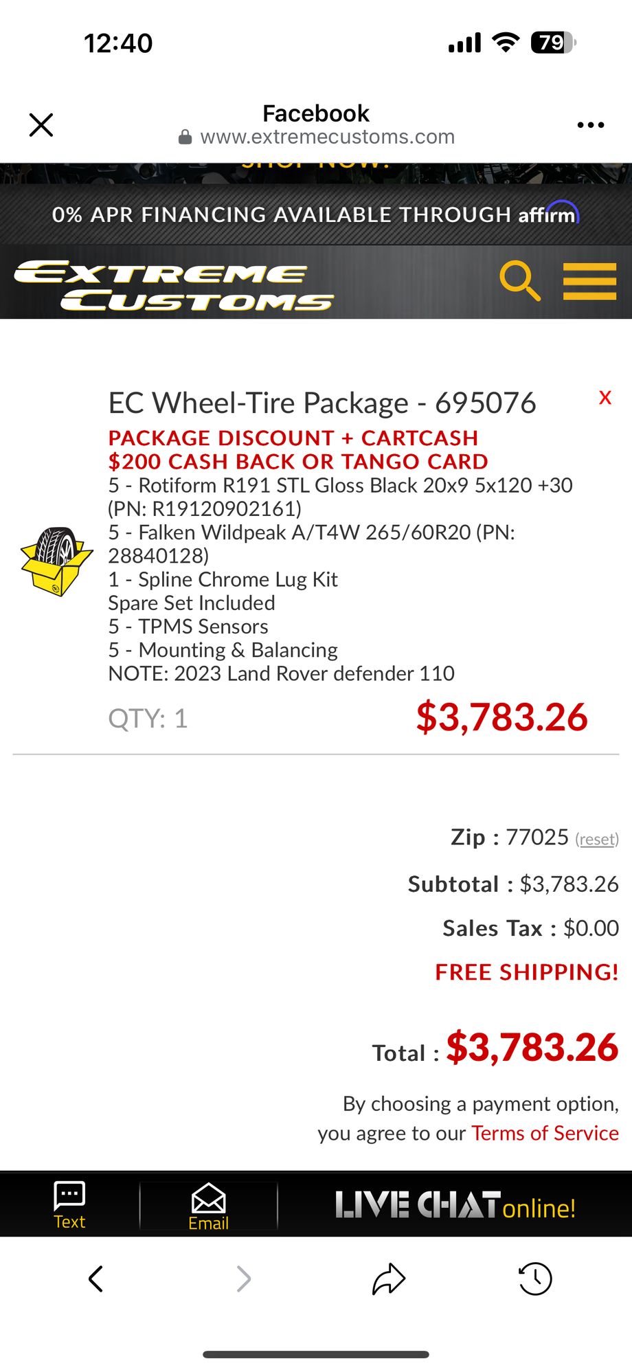

Hello colleagues, I have to ask the audience if that combination will work on P400 without modi
fication

It should work. I have a P300 and I'm running Falken AT3Ws sized LT265/60R20 on Style 516 wheels from an LR4. No issues. Of course I have the smaller calipers, but I think this should fit without issue.
