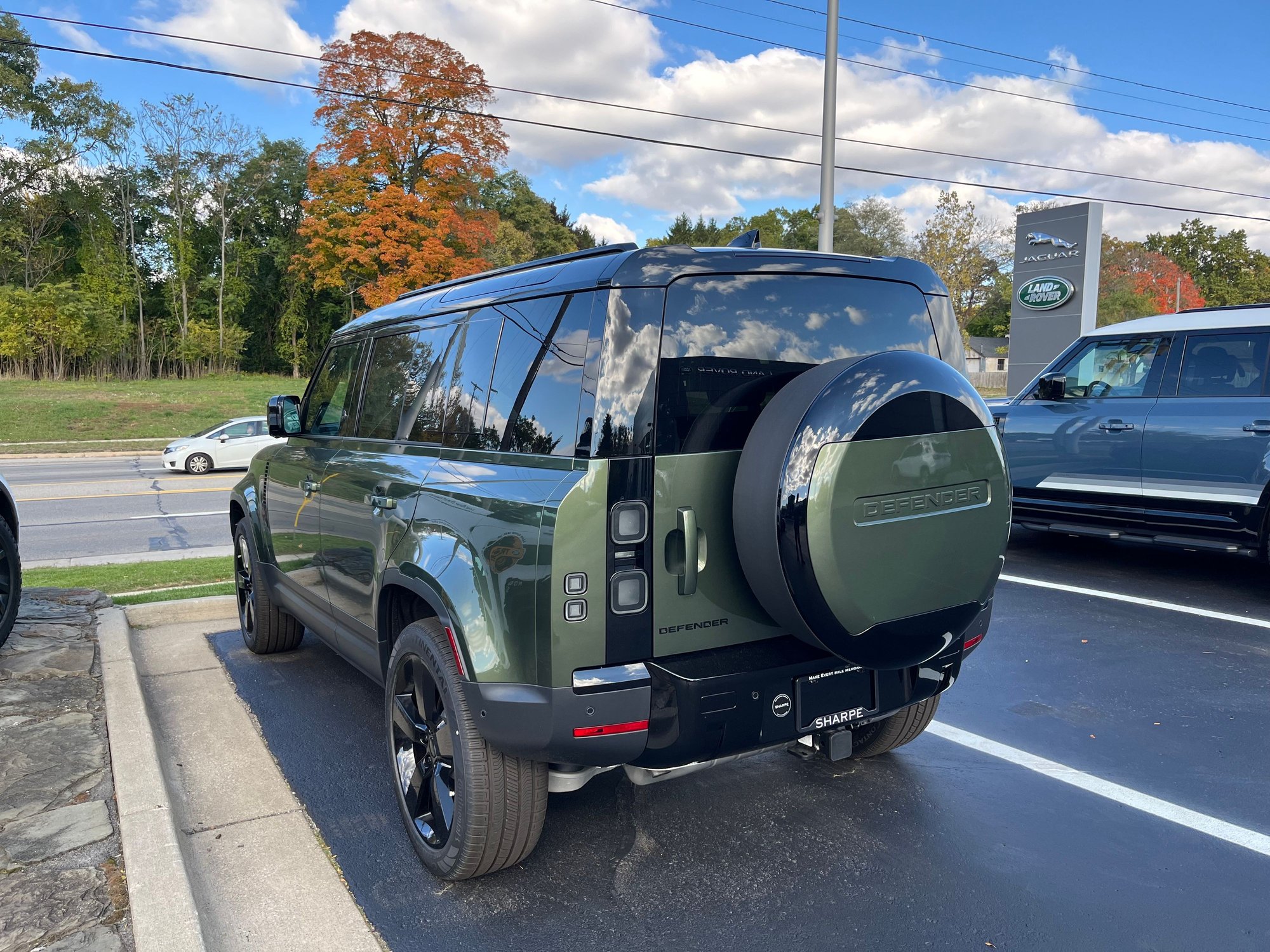

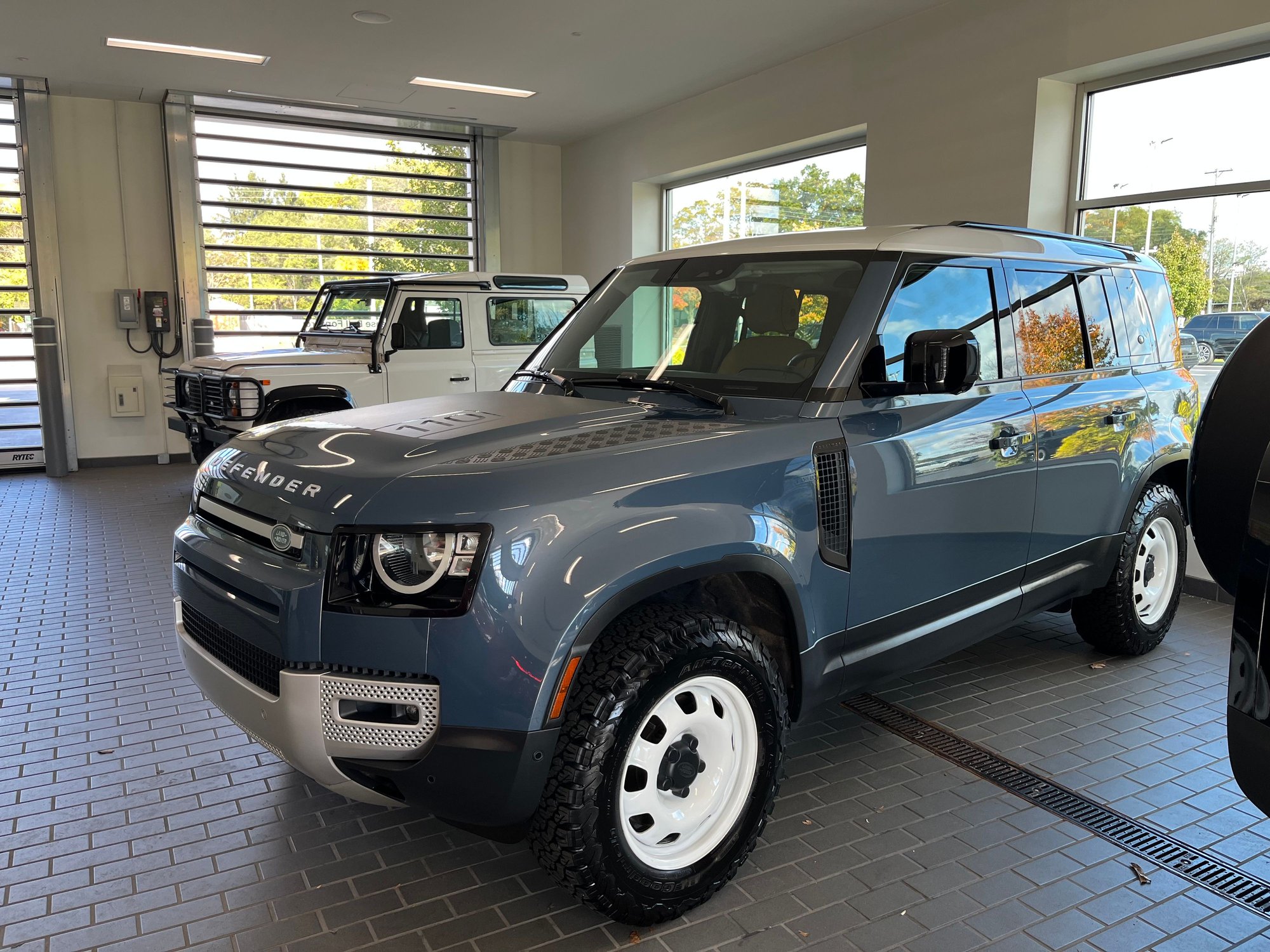

I stopped by my dealer today to pick up my 2023 after having it detailed (brought it back from a 5K mile trip thru eastern Canada quite trashed), and I took some pics of a MY26 Woolstone Green 110. I'd order one of these today (with a white roof, of course, and no shiny black plastic bits, and no hard spare wheel cover) if my 18" steel wheels would fit!
I don't care for the 20" alloy lookalikes, but even if I didn't mind that wheel, Land Rover decouples the white roof option if you select the lookalike wheels. Incredible. @Land Rover, please just let me order my Defender how I want it!
Anyway, my 2023 came back from detailing like new (almost) and I have two sets of the steelies for it (KO2's for summer, snows for winter, natch) so I think Land Rover won't be getting my money for a 2026 Woolstone.
Mine after getting the spa treatment at my dealer:
The Woolstone Green 110 on the lot. I don't care for all the shiny black plastic and the black roof, but otherwise I love this color!
