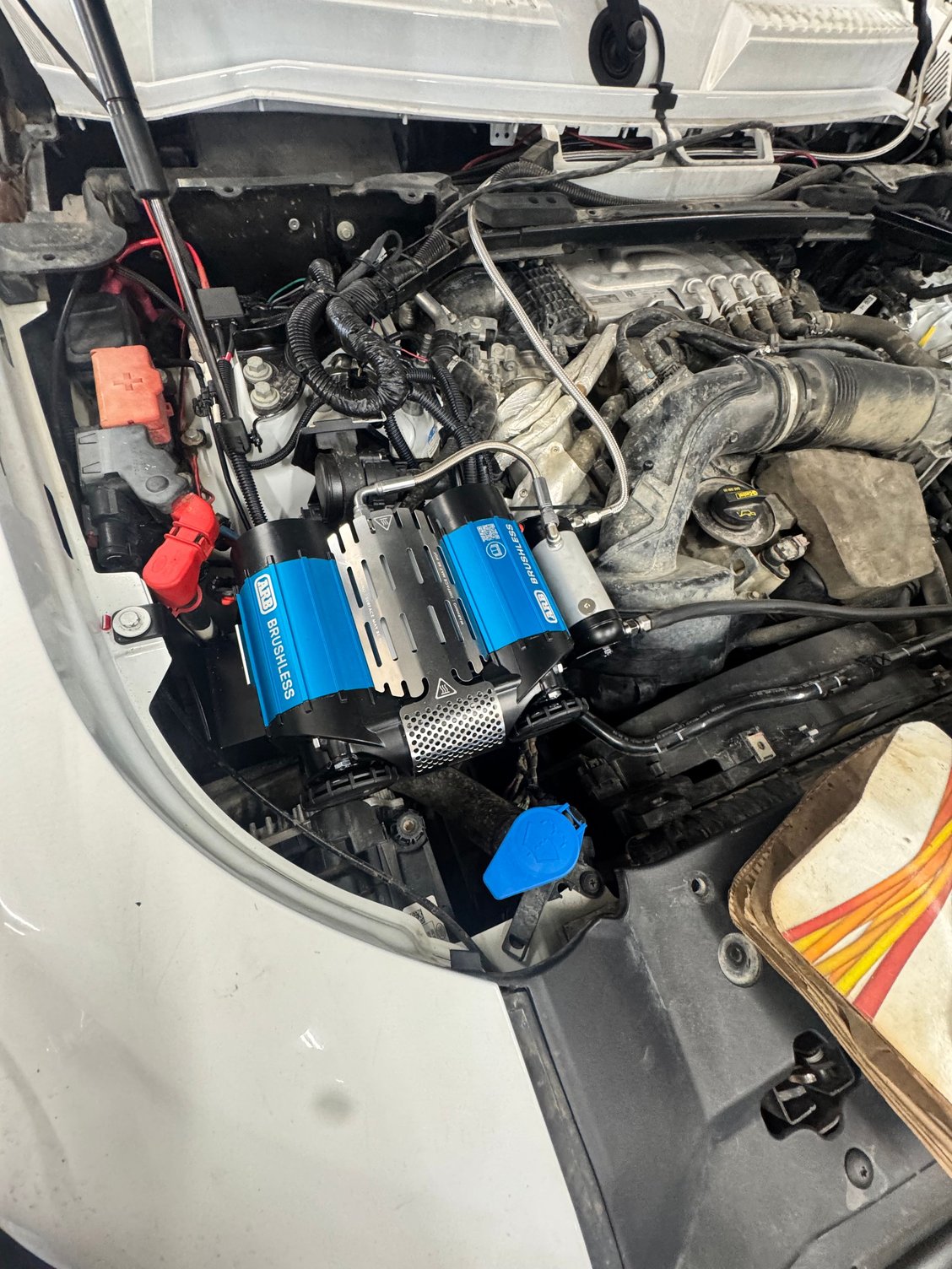

Be careful with the dual ARB brushless. In our testing, it got very, very hot. So hot in fact that it caused damage to a SMC (composite) hood under which it was mounted. It was very fast though.
Also, the harnesses that come with the ARB compressors are, not great. On the normal dual compressor model, the harness combines the two harness ground wires into a single ground wire after the connector. It also has a separate tiny gauge ground wire for the switch illumination circuit. ARB instructs you to connect both of these wires to the same negative terminal on the battery.
On mine, the splice in the middle of the harness was NOT SOLDERED. This caused one of the compressors to intermittently lose its ground, and it tried to go through the tiny illumination ground wire instead. No bueno. The tiny wire turned into a heating element, melted its insulation and was smoking. Doing some research, it seems that some other people have run into this same problem. After nearly catching my truck on fire, I took the harness apart, soldered that combined ground splice and removed the tiny black wire from the circuit since I don't use the ARB switch at all. Everything works as expected now thankfully.
In any case, with the amount of amperage we're talking about, I would only do a direct connection to the battery. There are definite rules as fair as Volage/Amperage over distance with regards to wire gauge that you do NOT want to violate (see my smoking wire above as an example). As far as the mounting location, have you considered perhaps mounting the compressor under the hood and then mounting an air chuck connector on the bumper or some other accessible area where you don't have to pop the hood? Routing flexible air lines is a LOT less risky than routing high amperage wire throughout the cabin of your nice Defender.

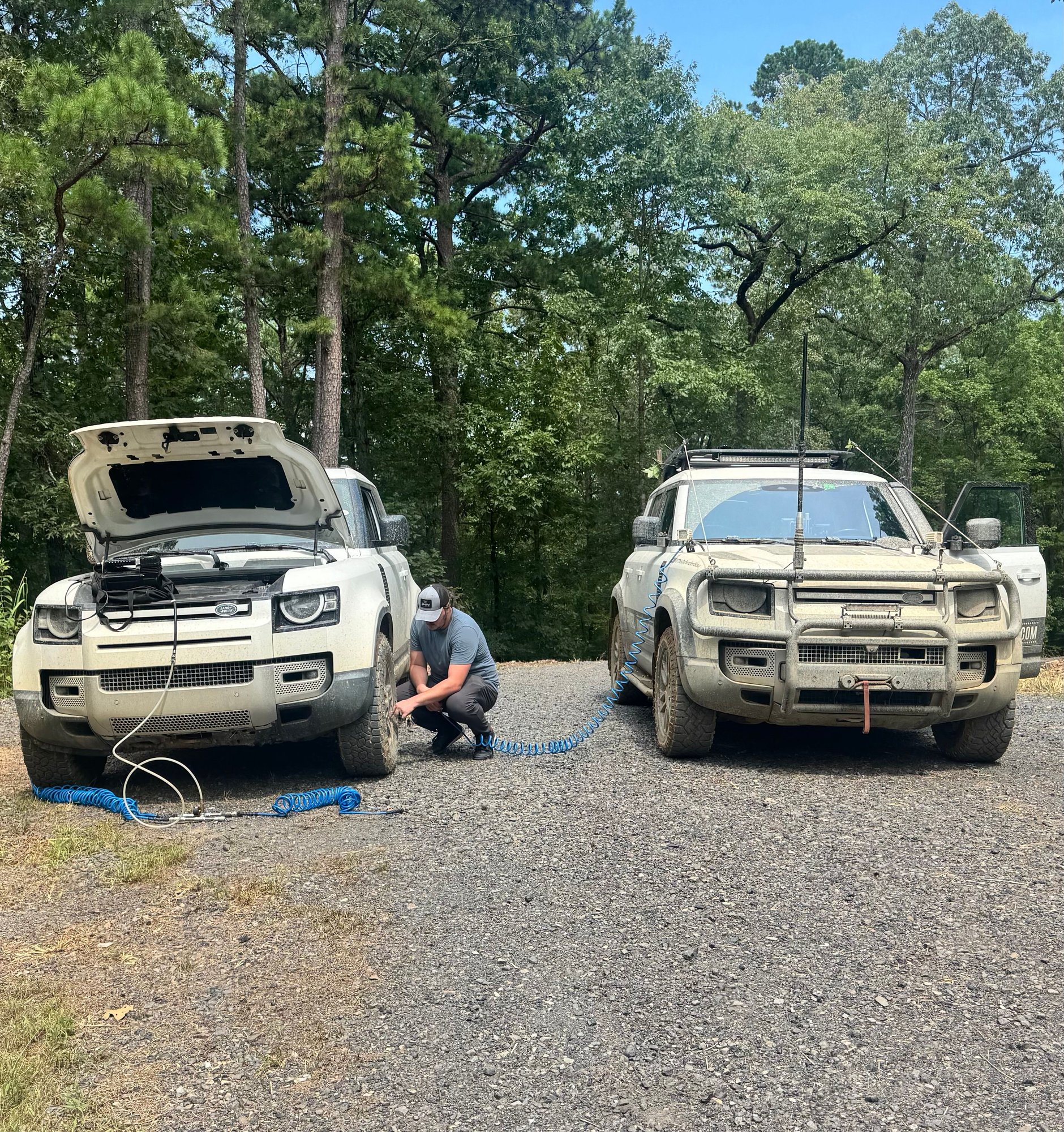

I don’t have a wired in compressor. Just the toolbox mounted ARB with my tire repair kit and deflators all in one place. I use it for other things like winterizing pipes, other vehicle, and the like.
Not at all useful for pumping stuff up without opening the hood so not what you’re looking for.
I saw a cool under hood mount for the ARB recently. It uses the faux air vent on the side as the spot for the air outlet. Very nifty idea.

I’ve got the Saltek under hood mount with the single ARB. If you’re a newbie - be careful wiring these up. They pull a lot of current. Even the single ARB is fast. 30 psi —> 45 in 15-20 secs, maybe less. I was able to wire mine to my existing sPOD controller - it goes handles 30 amps, and I’m right at the limit.
