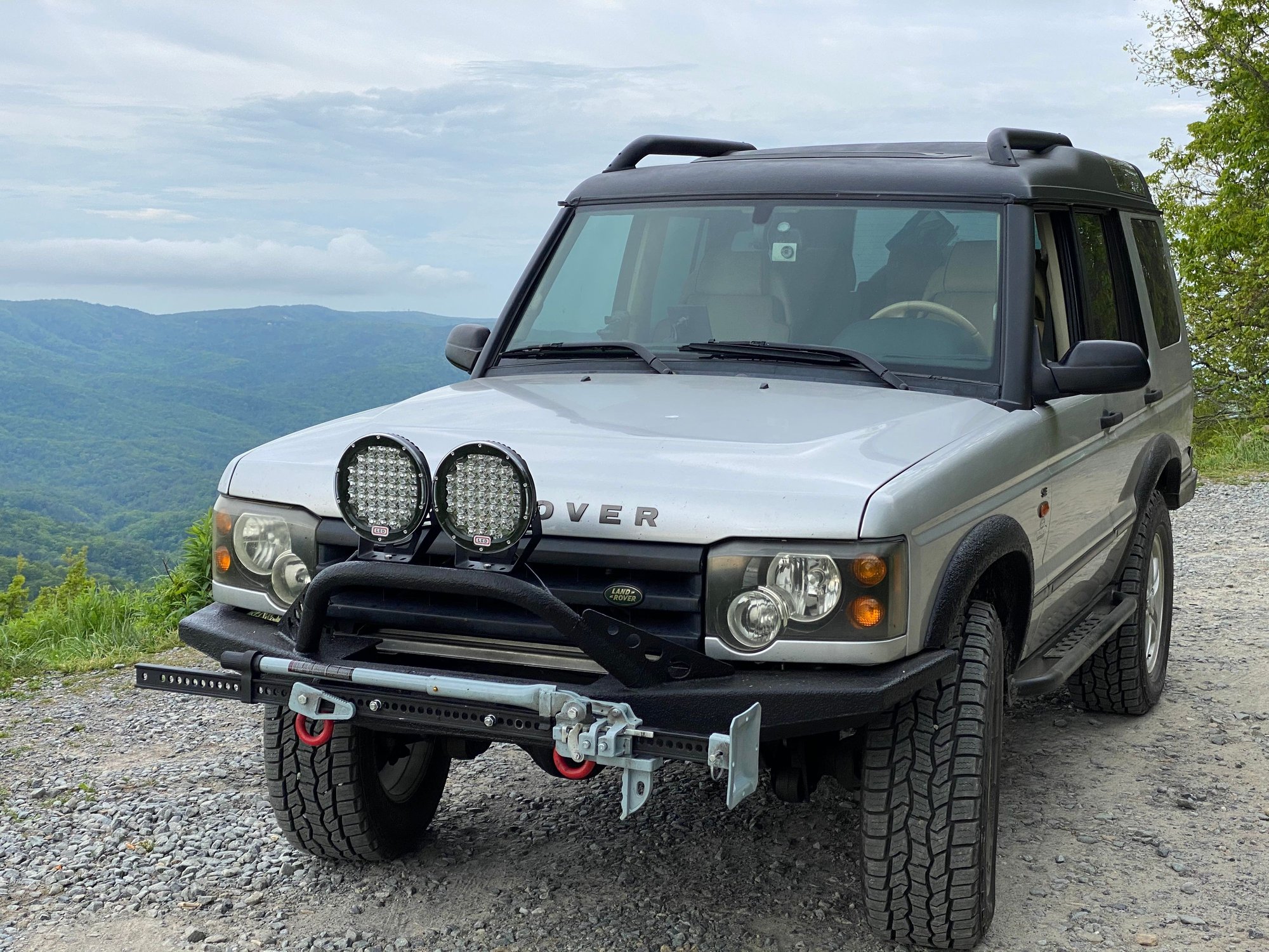

Left Thursday around noon to from Jax driving up through Atlanta. Engine was running real hot (for me) at 215 degrees. Turns out the two 9 inch lights i added pretty much blocked all the airflow to the radiator. Once I pulled them down, temps dropped to 207 running about 75 mph. No real issues getting up there - hit the trail outside of Crandall, GA just when it started getting dark. Drove for about 2.5 hours in the dark and those ridiculous 9 inch lights came in handy. National park camping was closed down but there were a number of state sites open. Most of the trails were forest service roads (gravel) and they were pretty well maintained.

I did have one repeat problem on the trail that I need some help with - occasionally when any of the wheels seemed like they were under stress, I would hear a banging noise from the wheel well. It was loud and sounded like someone was hitting the wheel hub with a large hammer. It seemed to rotate around happening in one wheel well and then later another. It was intermittent, only happened on the trail and I was in high range without locking the diff. I was usually only going 10 mph and could not duplicate it on demand. I strapped a gopro under there to capture the sound but it was so loud the mic leveled the volume so it just sounds like little rocks hitting the frame. I have looked under the truck a couple of times - nothing leaking, broken or hanging down. I suspect its the shocks or springs somehow causing the noise but that is just a guess.
