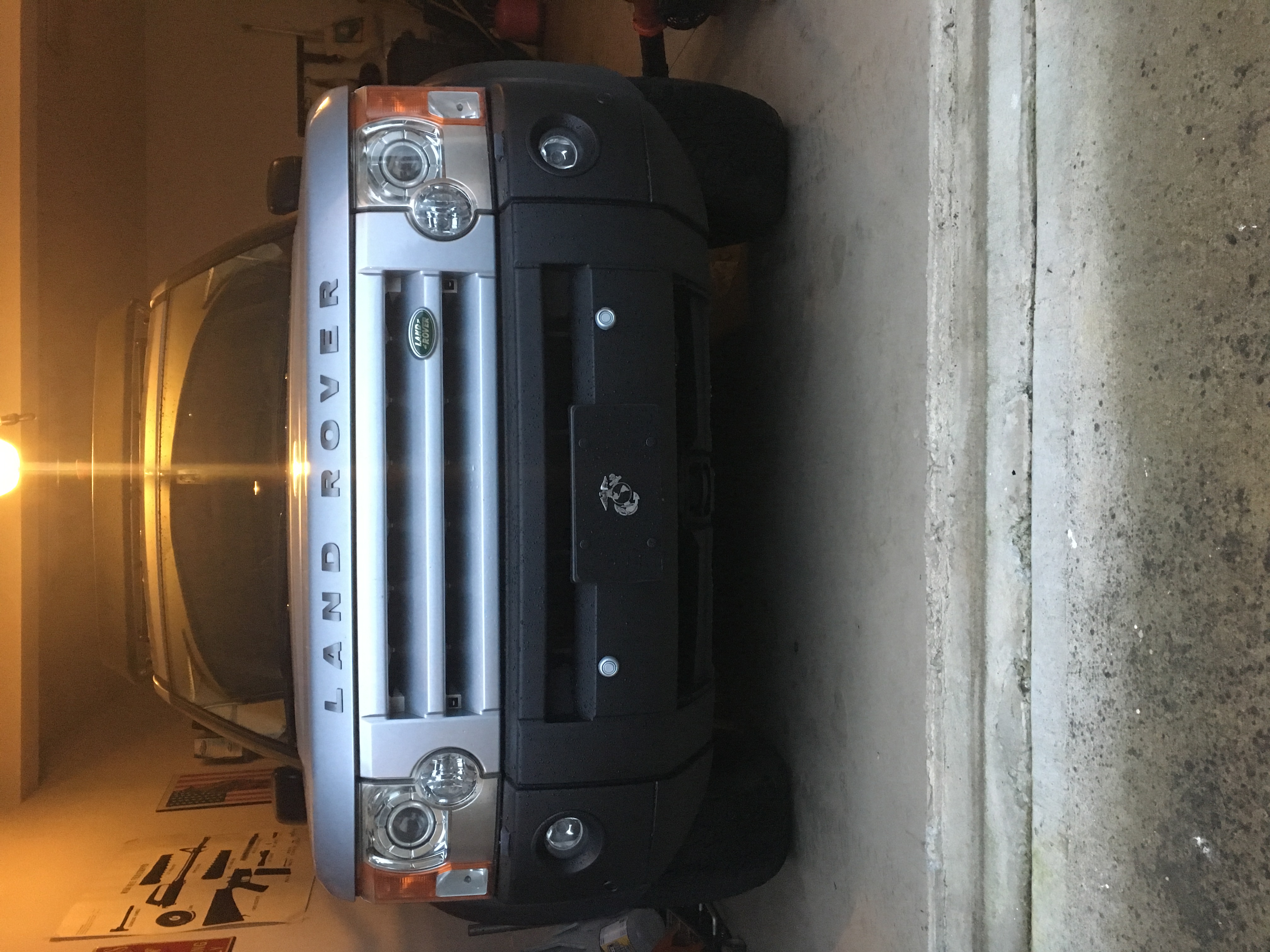

I coated the front bumper on my LR3 with DIY bedliner spray. Turned out great.
Attached Thumbnails Bumper Restoration-e03d1add-3aa6-4b04-aeb1-dbdb1082f9b6.jpeg   Bumper Restoration-dd62c0b6-6d7a-473f-b93d-40580802e126.jpeg
Old Oct 10, 2018 | 12:21 AM
wolframben's Avatar
Joined: Oct 2018
Posts: 12
From: Santa Clara, California
That looks great though.
