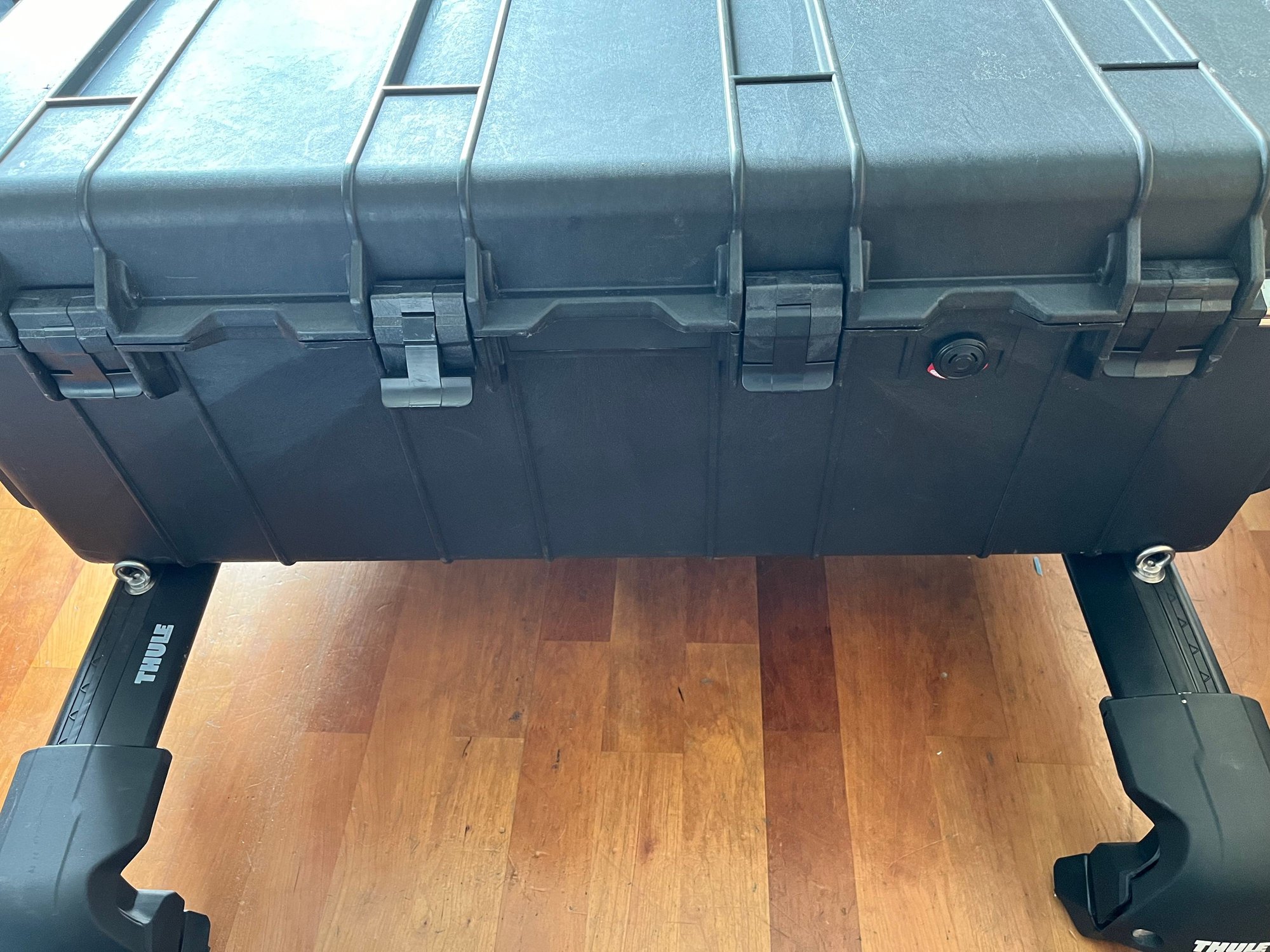

The 1730 has 4 large 2 inch deep nesting tabs to allow stable stacking of cases on top of each other - in this case I used these tabs to locate between the roof bars and prevent forward/backward movement by butting the tabs up against the roof bars. (space the roofbars approx 660mm apart).
Bars spaced at 660mm to allow the nesting tabs on the base of the container to fit between the bars.
The t-track eyelets served as stoppers for horizontal movement, with the case sitting in between these eyelets had very little chance to move unless it jumped up on to of eyelet. The eyelets also doubled as fixing points for horizontal straps to route over the top of the case. I used relatively small eyelets and paracord, but larger eyelets which could accommodate a full ratchet trap might offer even more horizontal security - both as a physical stopper, and for more strap strength.
eyelets butt-up against the sides of the case. Bars spaced to exactly fit the nesting tabs underneath.
Eyelet as a horizontal stopper, and nesting tabs on the bottom prevent forward/backwards movement
The 2 types of physical barrier prevented forward/backward and horizontal movement, but relied on the case being securely fixed to the roof bars. So I routed a ratchet strap through the front and rear case handles and beneath the roofbars, to attach the case firmly to the roofbars and prevent any vertical movement.
