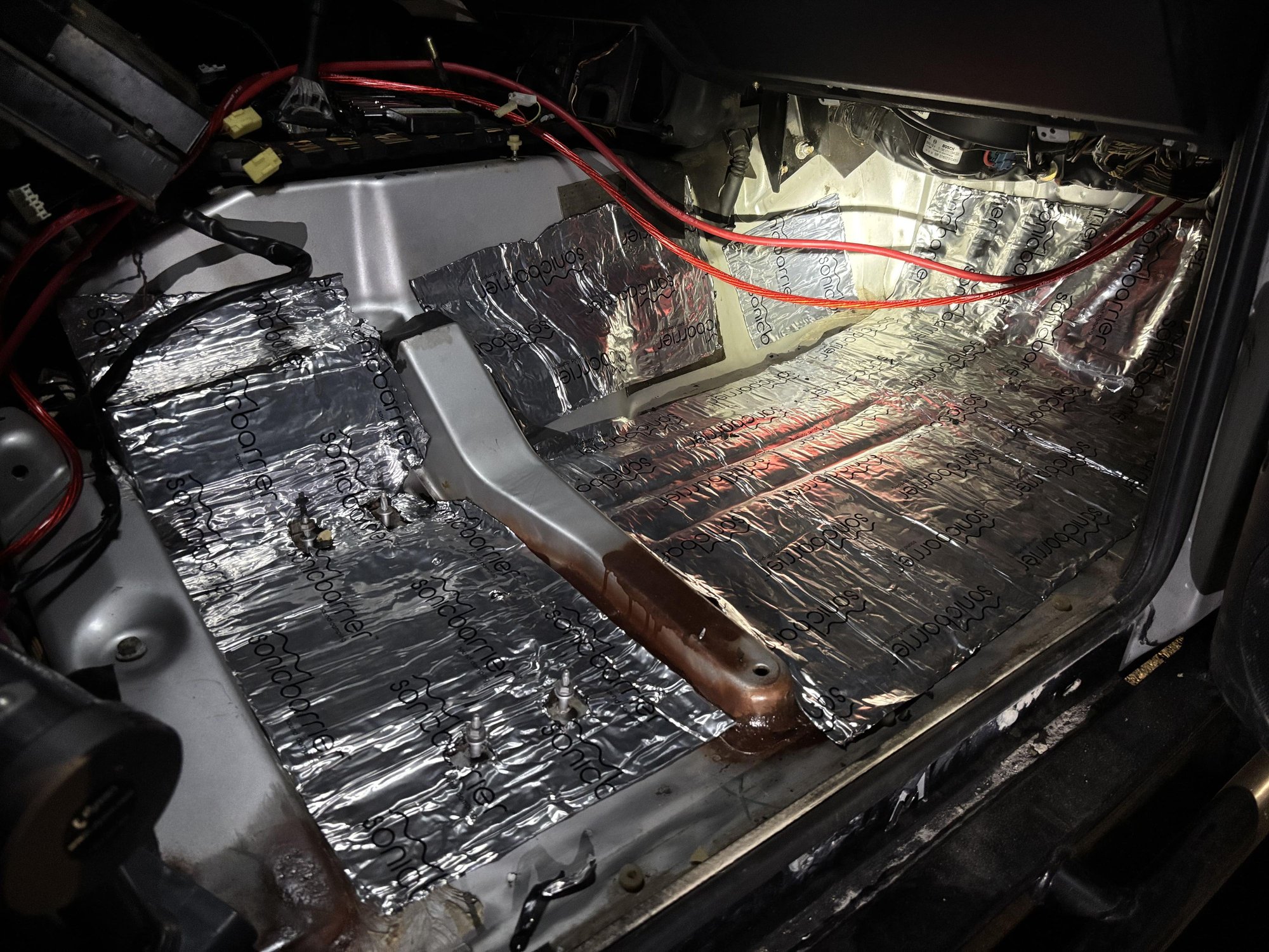

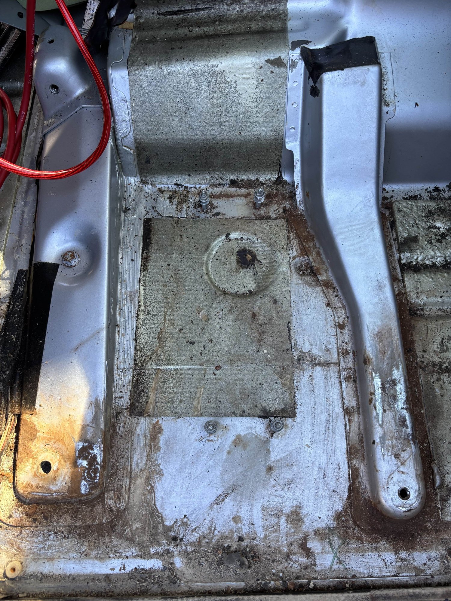

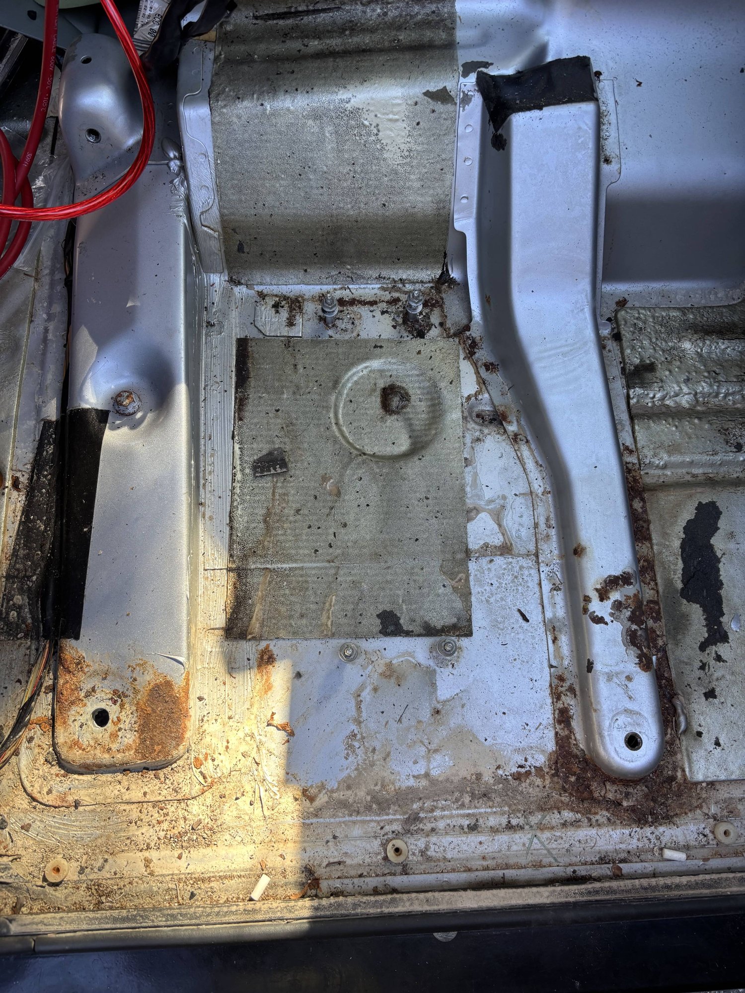

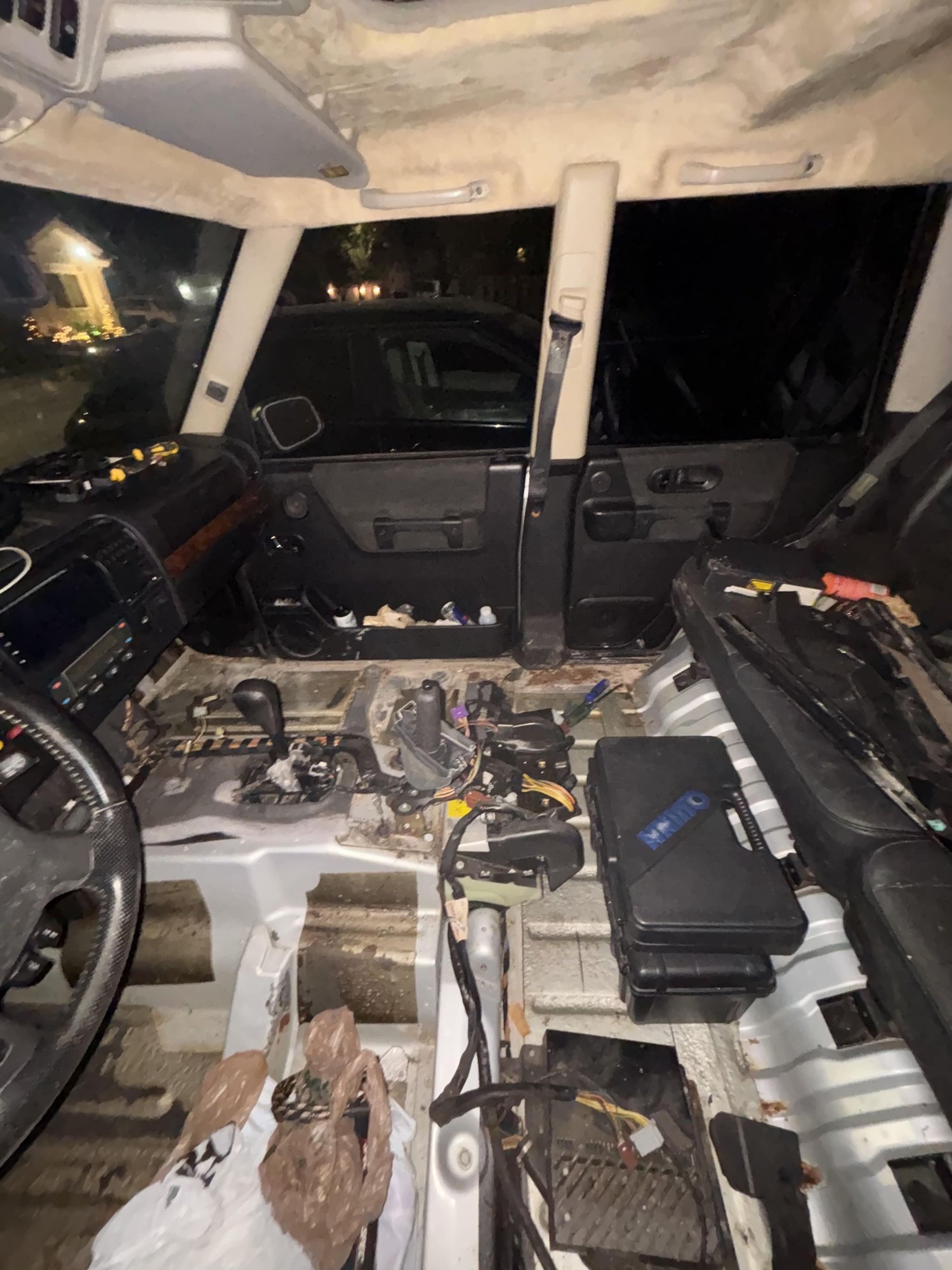

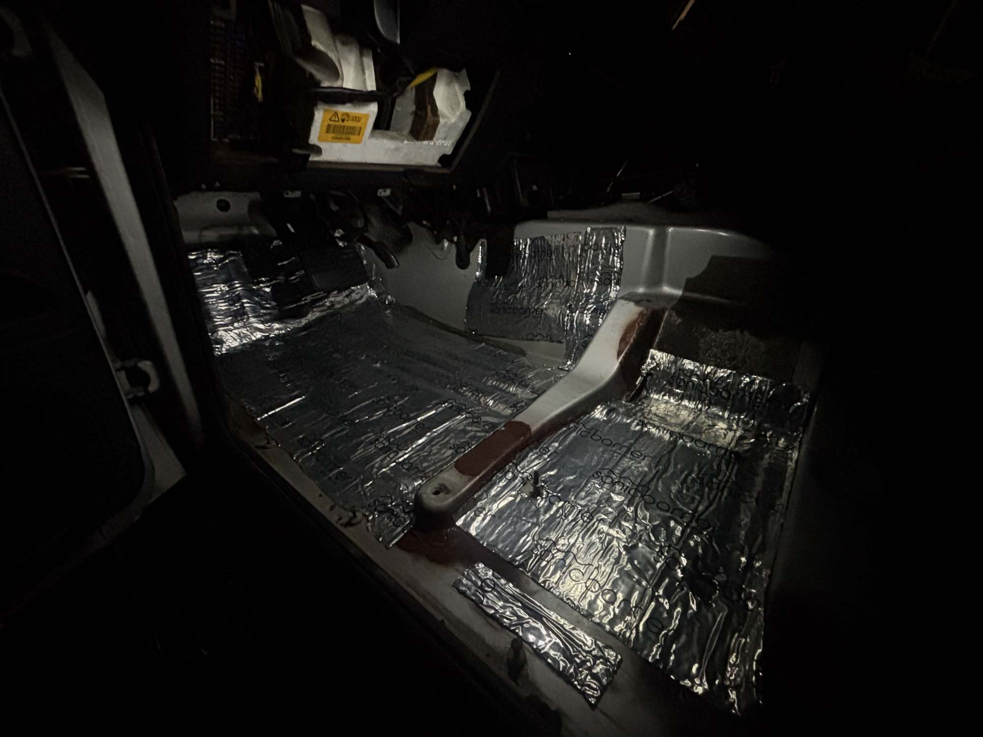

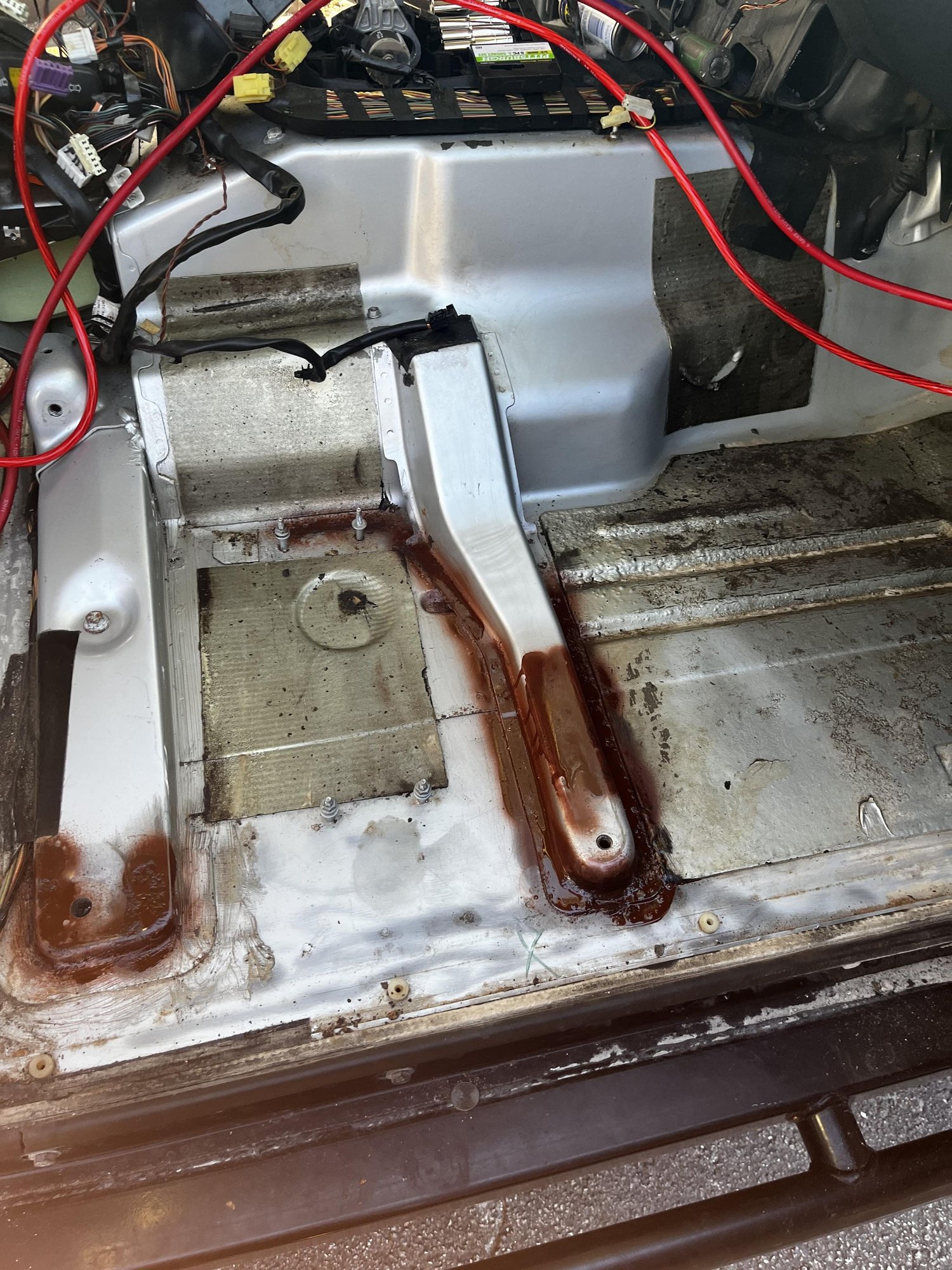

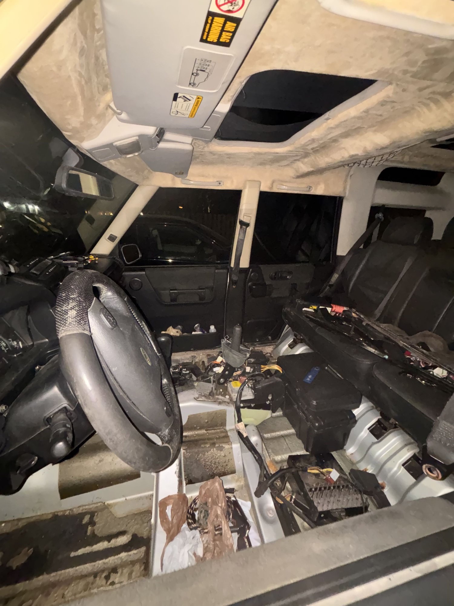

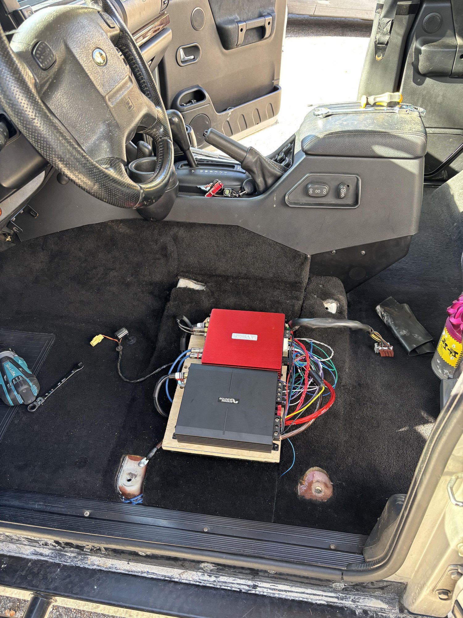

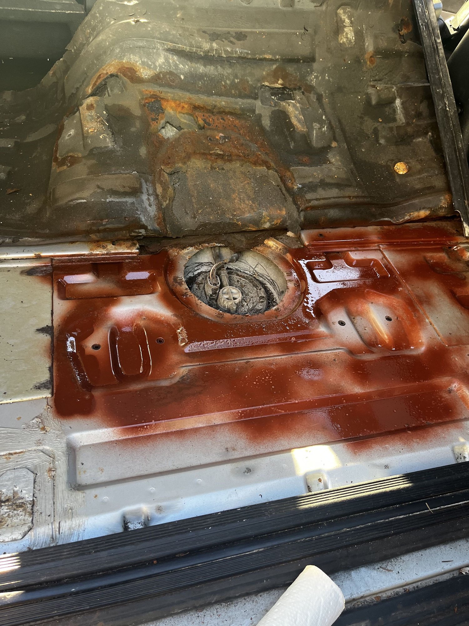

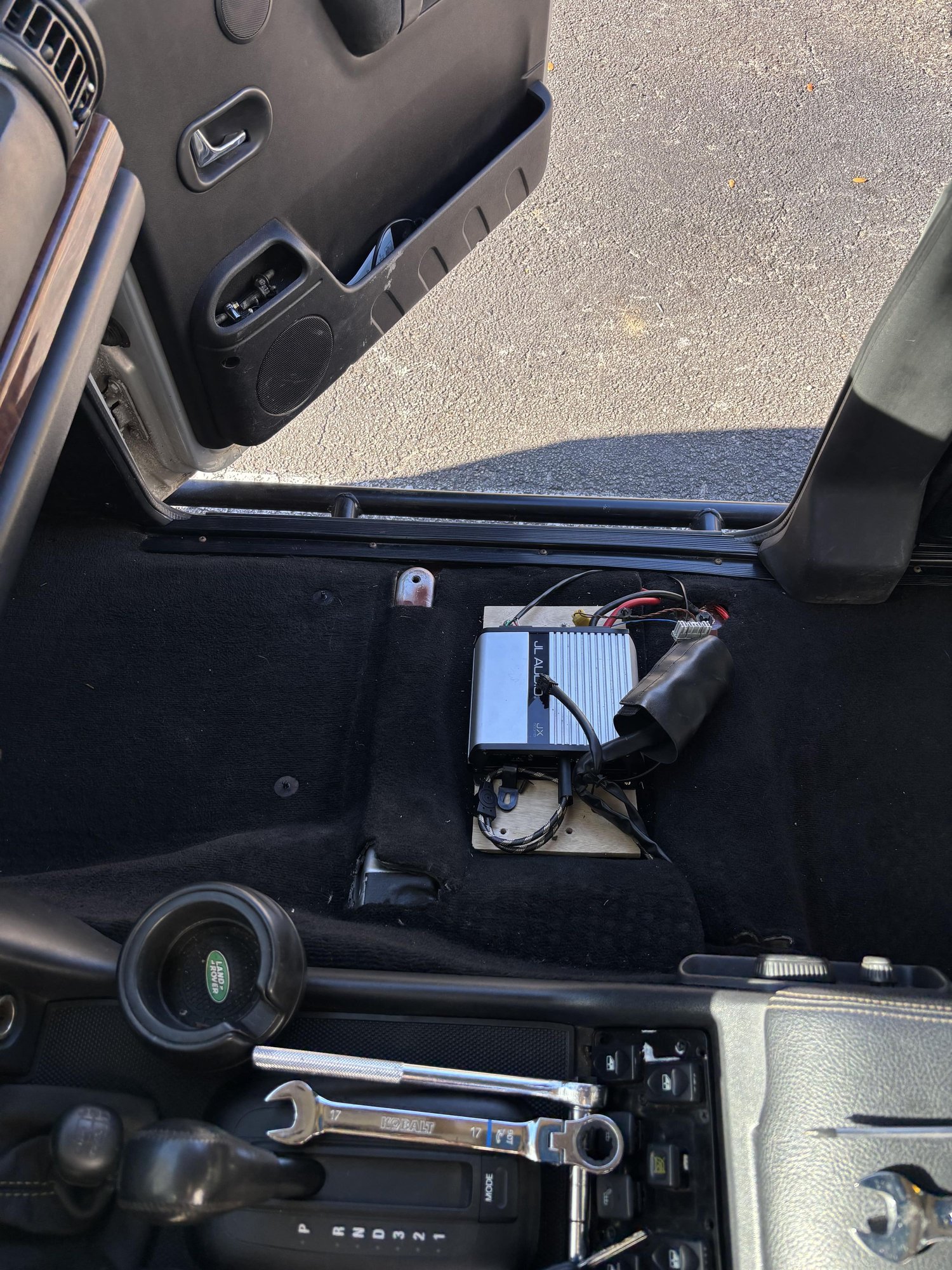

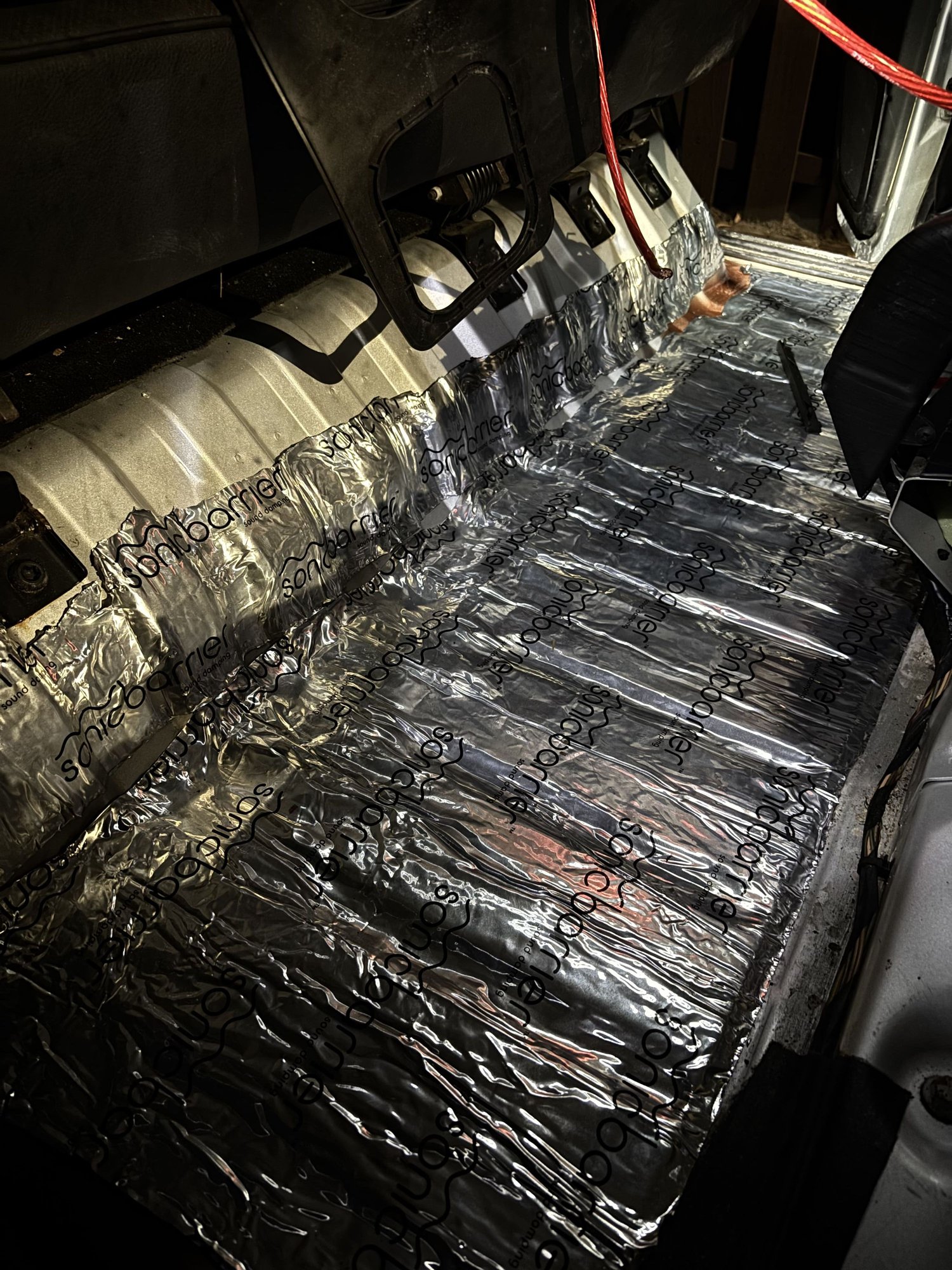

Hi All,
I've been installing a sounds system in my disco and just finished wiring everything and connecting the speakers tweeters and subwoofer to my amplifiers however I cant get my midrange speakers ( the ones on the bottom of the doors) to sound right. My father is EQ-ing them through the amp but the sound isn't really changing to his liking and suggests there is a capacitor affecting it (He's been in audio visual all his life and makes his own speakers so I trust in it not being User Error). I was wondering if anyone new where the capacitor locations might be or if y'all might have any input. My setup is detailed below:
(All of the amplifiers were wired using the factory cables that used to go to the factory amp)
Sound Magus C8-Pro: Using this one for the pillar tweeters and top door speakers (supposing they are Hi/Mid range) --Recieves input from aftermarket radio
Sound Magus CS1200.4 :Using this one for the bottom door speakers front and back doors ( these are Mid-low range)-- Recives input from SOund Magus C8
JL Audio JX: Using this one for the sub (low range)-- Receives input from Sound Magus C8
See Pictures below of the whole process I underwent
