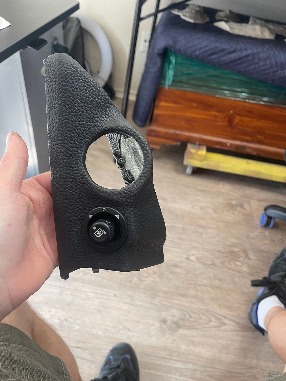

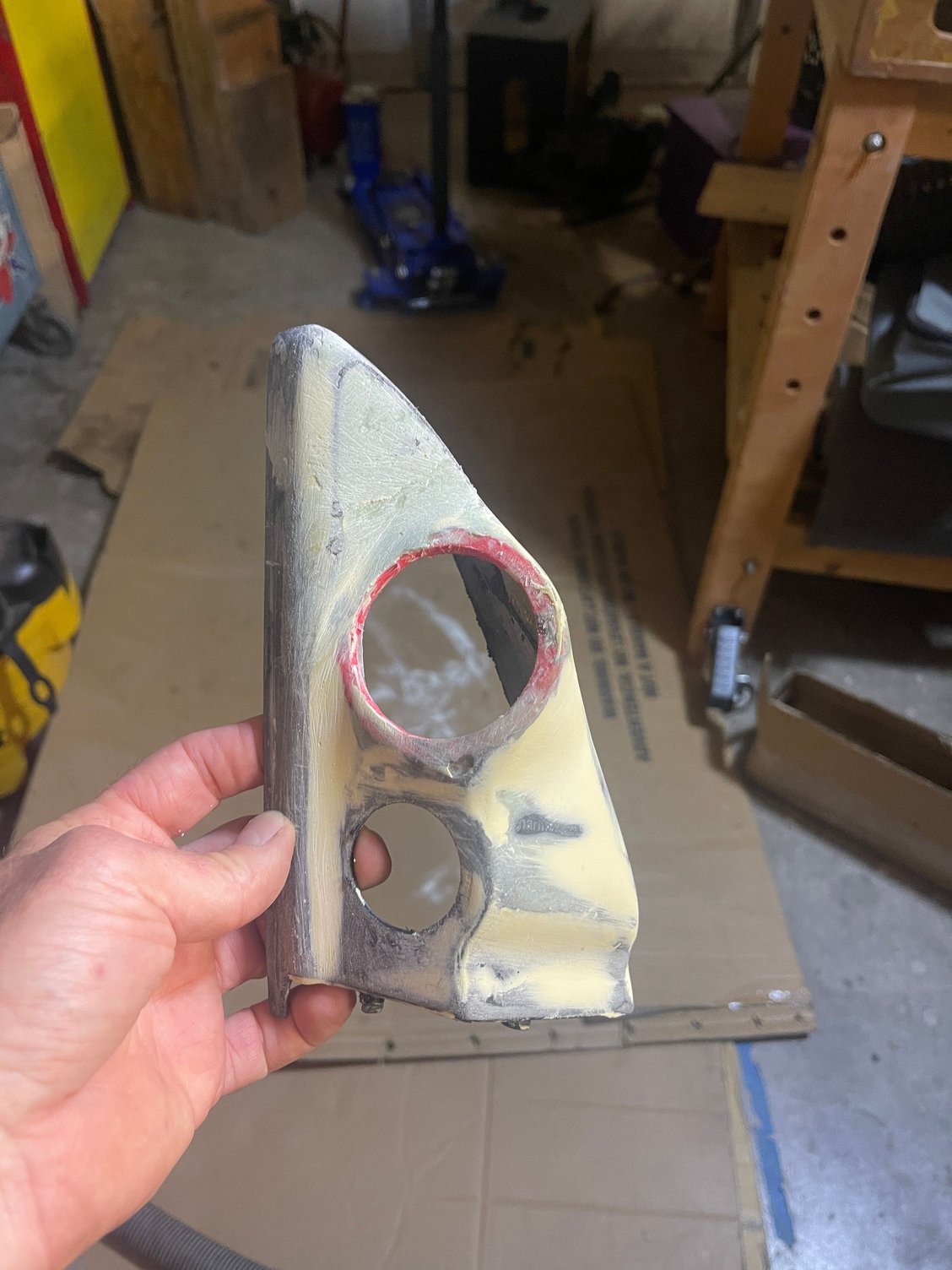

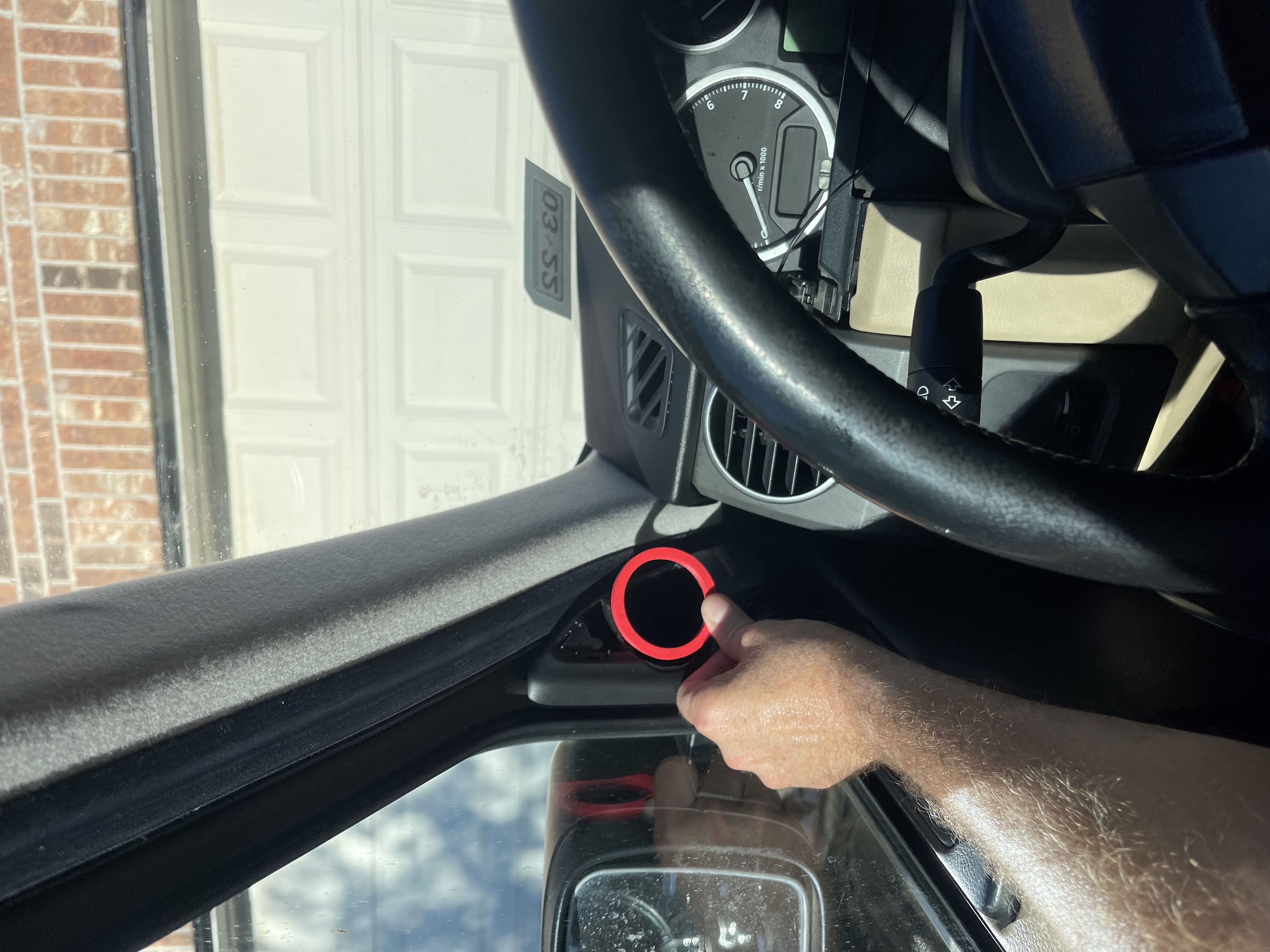

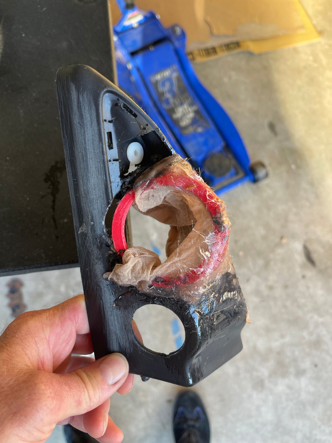

First lets address the tweeters. These tweeters are too big to fit in the stock location so we had to do some fiber glass modification
The red ring I am holding in the pic is 3d printed from a friend of mine
The second pic is a test fit after plastic welding the ring to the stock tweeter mount

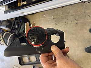

Here is the tweeter mount with some panty hose on it to create a base for the fiberglass
and the last pic is the tweeter mount with body filler, almost ready to wrap

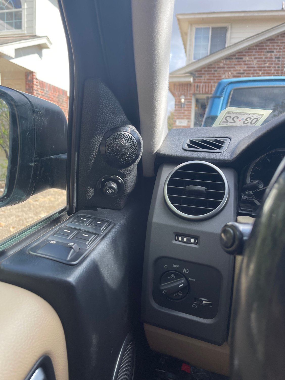

Ready for the vinyl:
all wrapped:
And installed
I did both like this so I’m not posting the passenger side. It’s similar

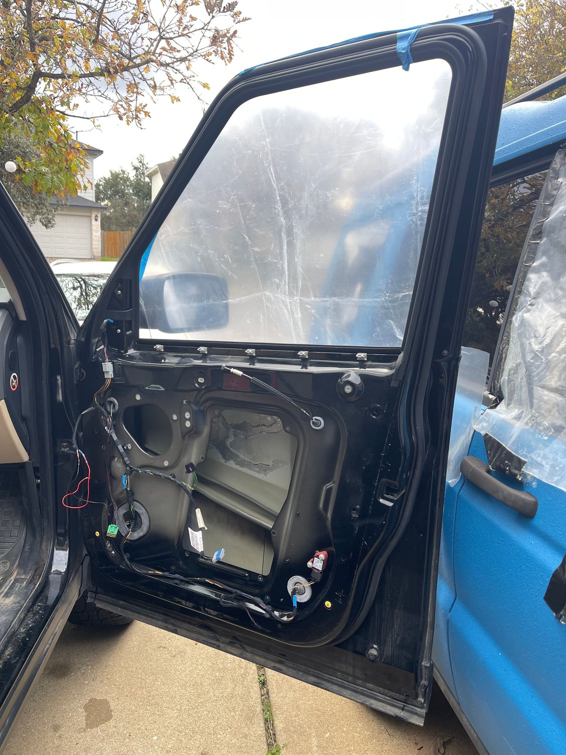

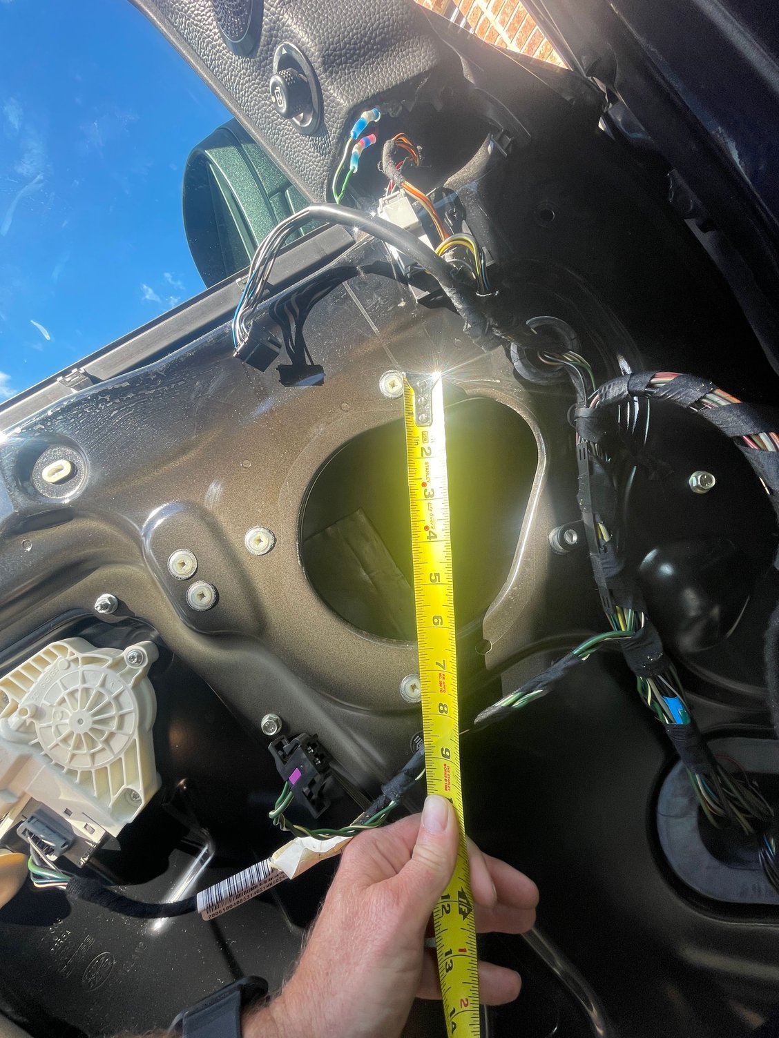

Next we’ll tackle the doors
while on the doors we may as well fix the damn actuators. I need to be able to lock the truck afterall

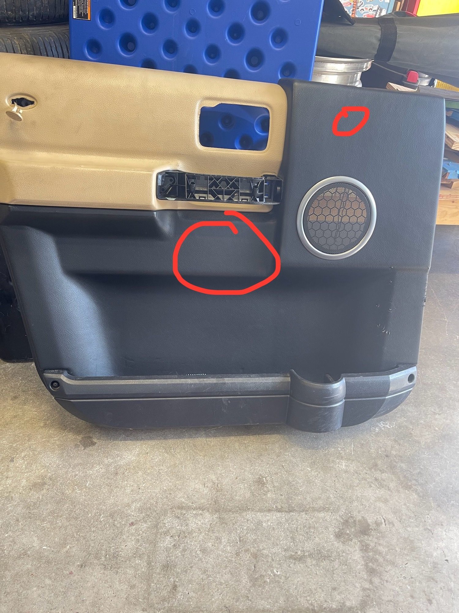

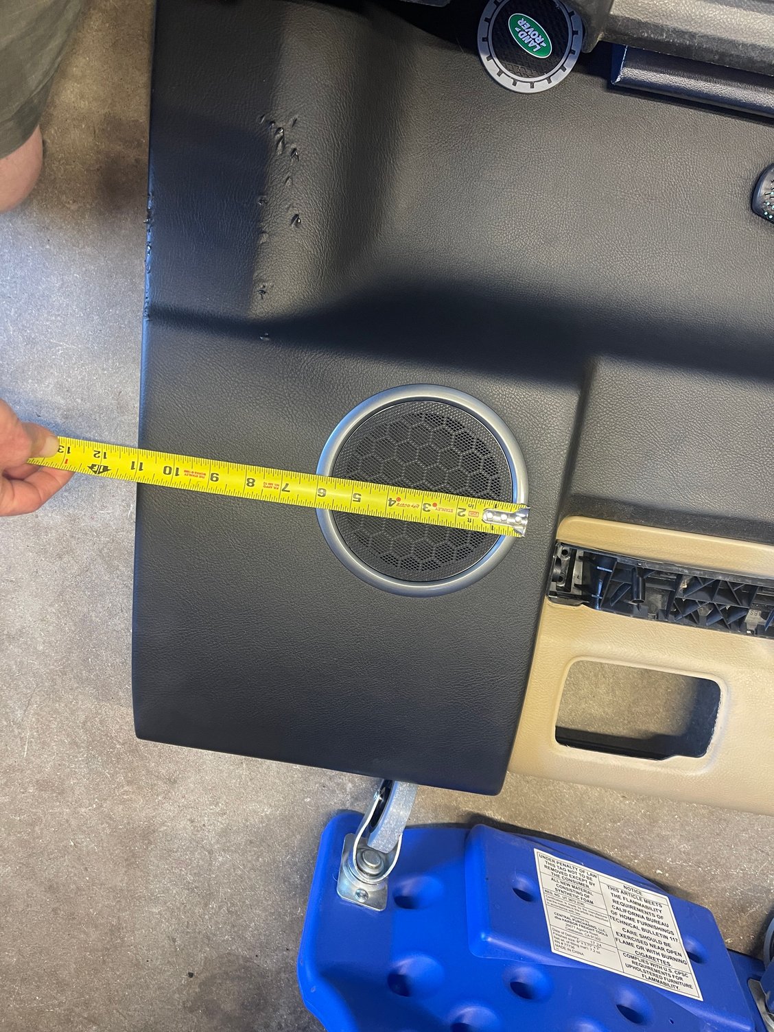

Those red circles were where I was thinking of mounting my new 8in midbass and the 3.5in midrange but after measurements, I decided against that
After some investigation and thought about where to install my 8in midbass, I’ve decided to stick them in factory location and trim the door metal. Pics of that coming
so the factory speaker grill on the door panel is only 6.5 in. So that will be enlarged to work for the new 8in speakers. I want that to look as oem as possible so that will be interesting

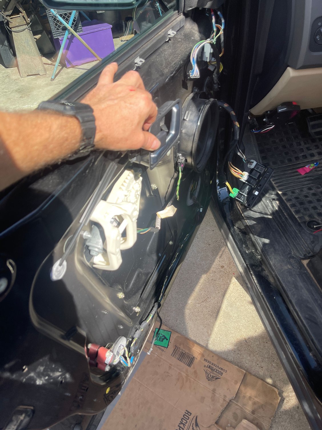

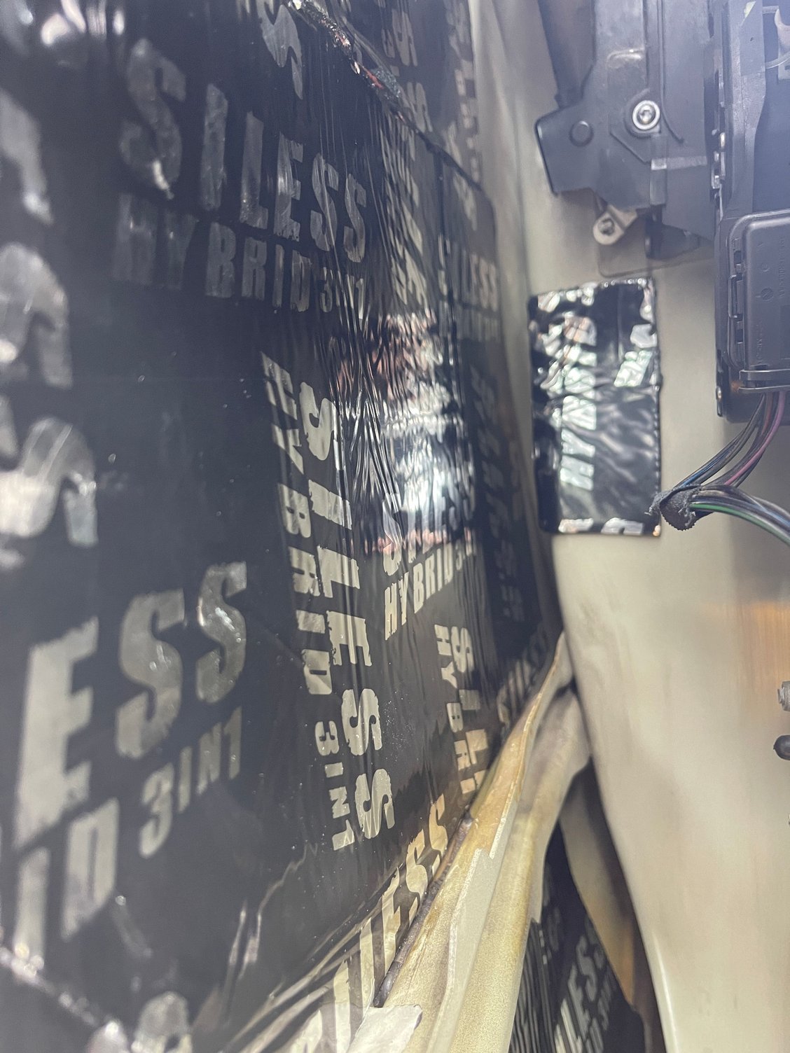

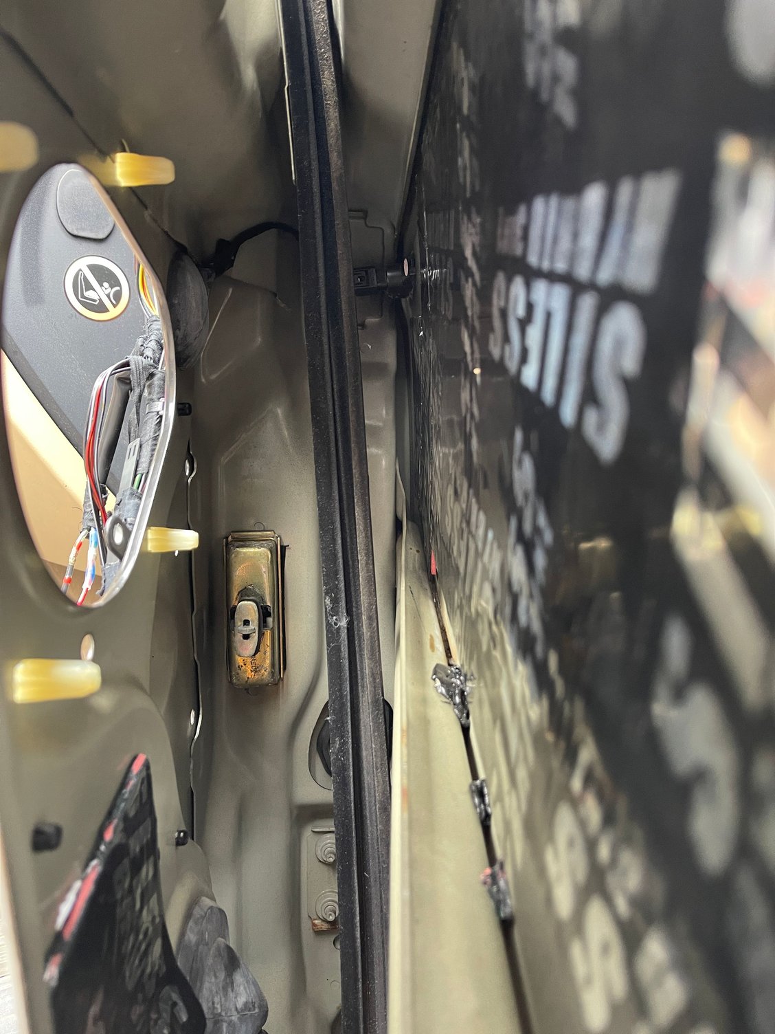

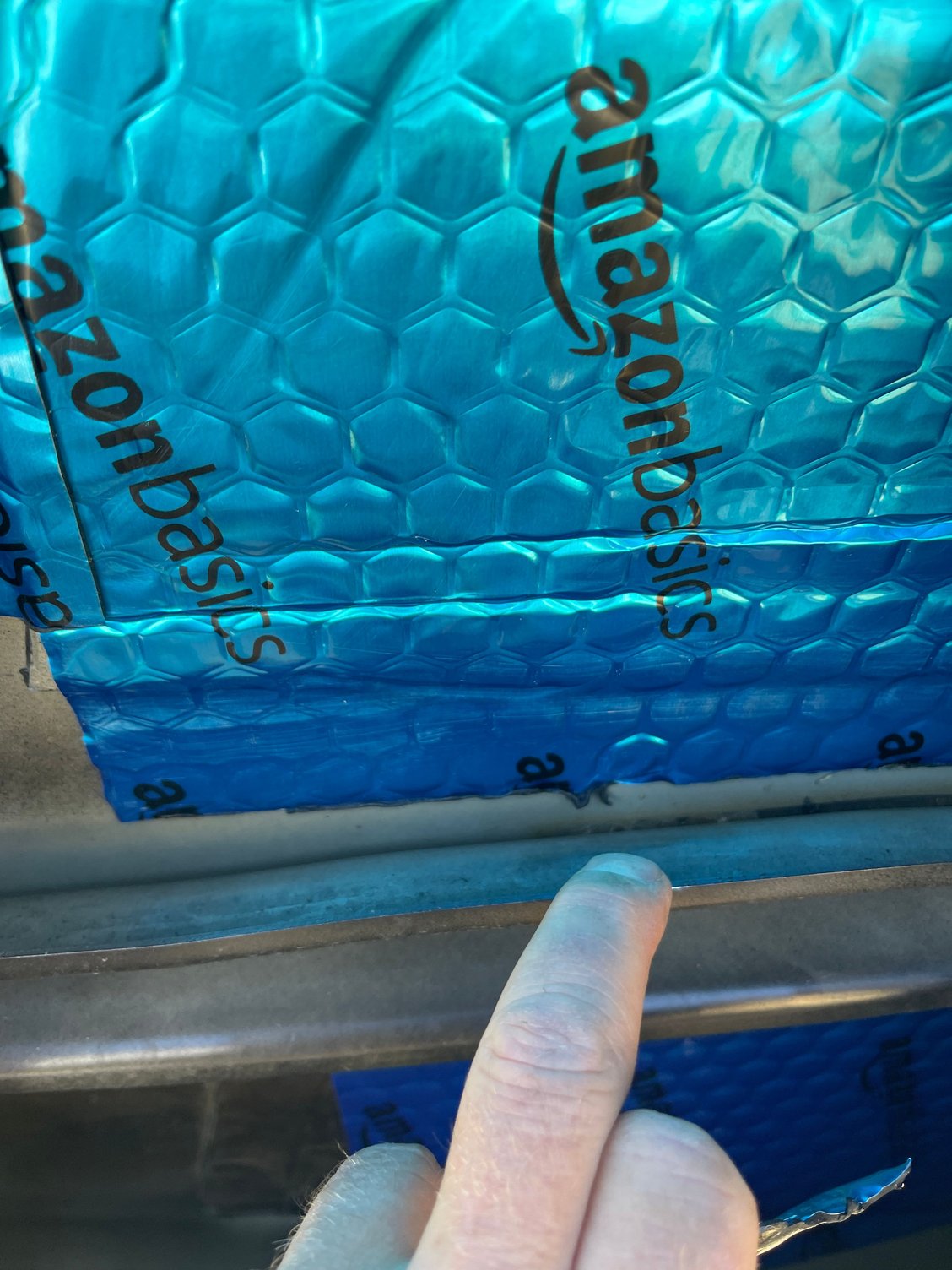

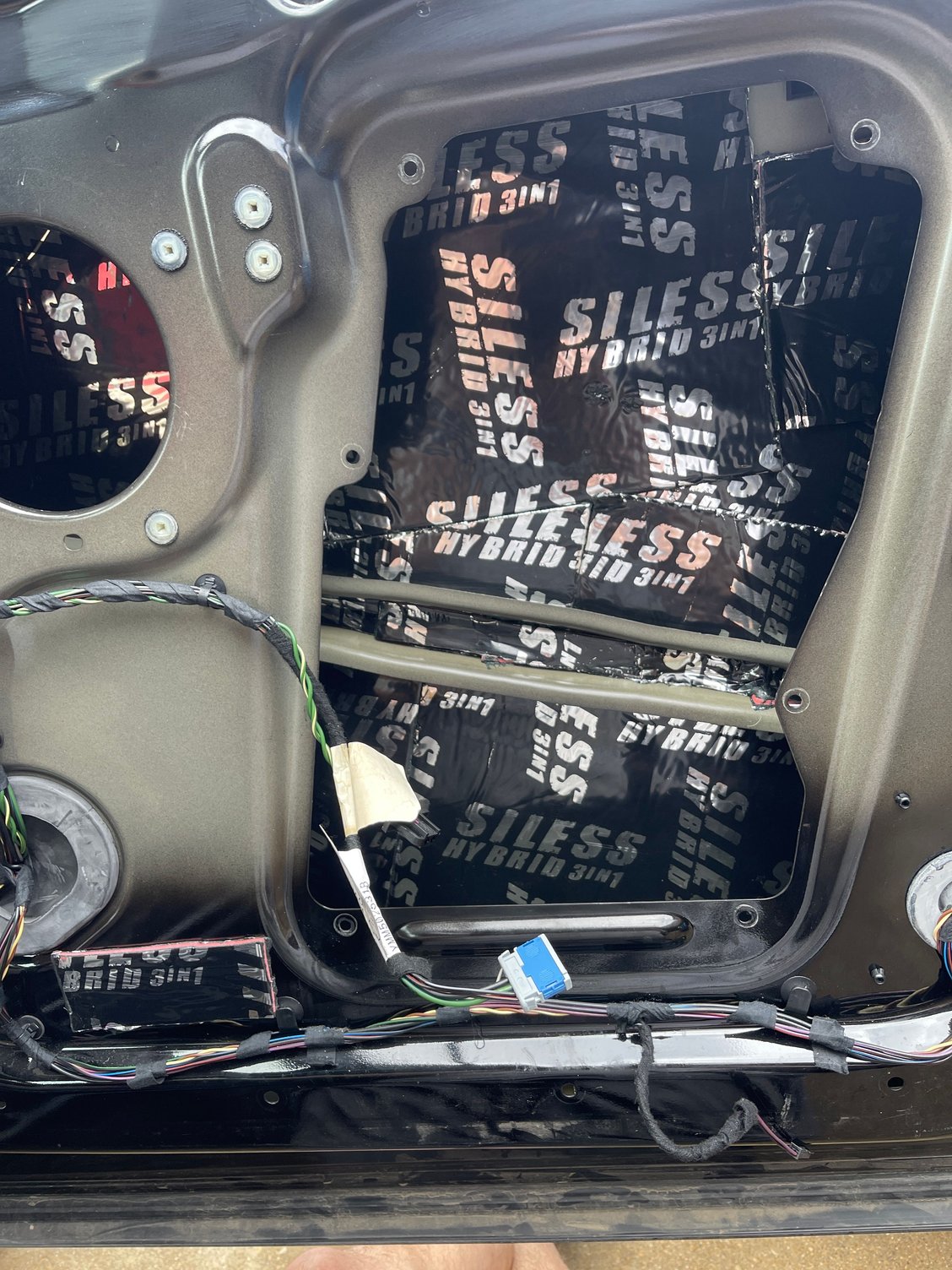

Before we do any cutting of the doors, let’s make sure to deaden them.
The sound deadner will help slow acoustic waves and lower the doors resonance. There is a product called mass loaded vinyl (MLV) that we will not be using right now . I mention it only because, if you want to reduce exterior noise, doing a layer of MLV would be the next step. If you are building an overland rig where you are camping inside, I would recommend it in edition to some additional insulating products.
I will eventually go back and add that.

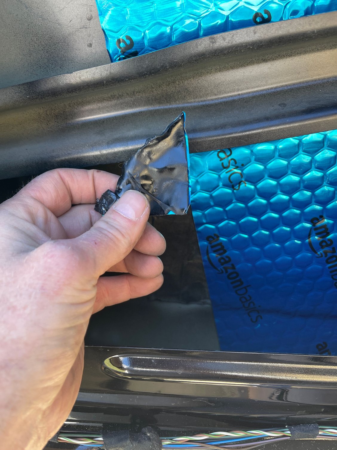

also a note for anyone doing this I suggest inserting butyl rope between the door impact bar and the door skin. But if you don’t have butyl rope, you can wedge some of your deadner in there. See below

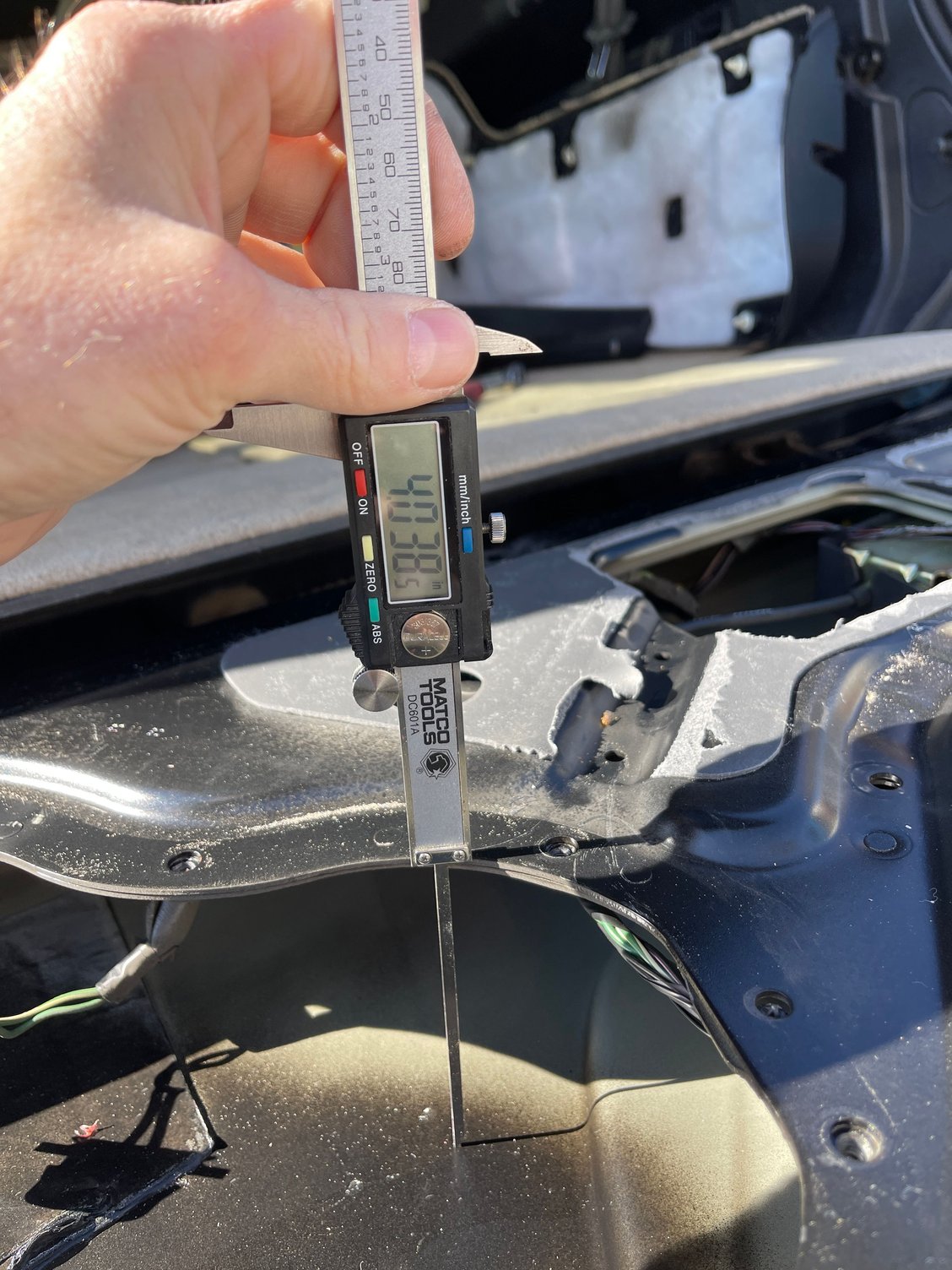

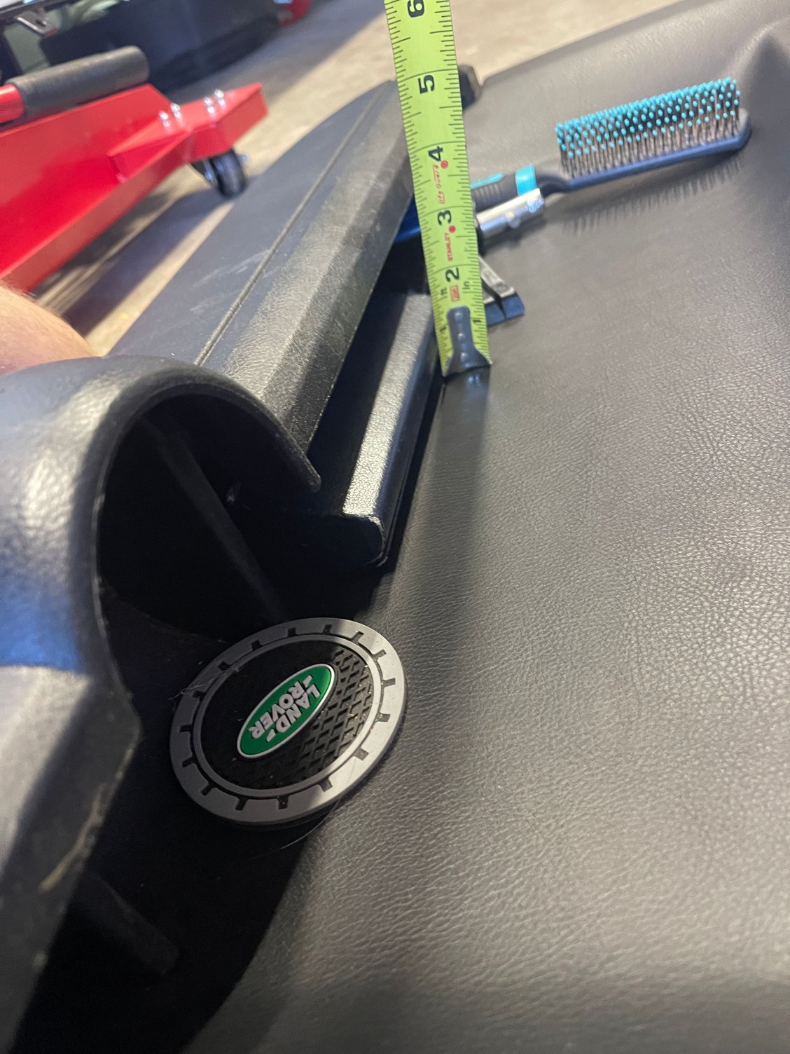

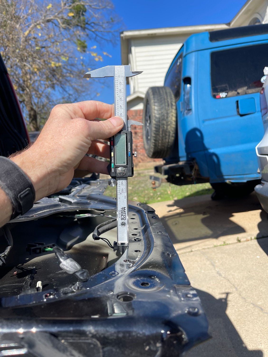

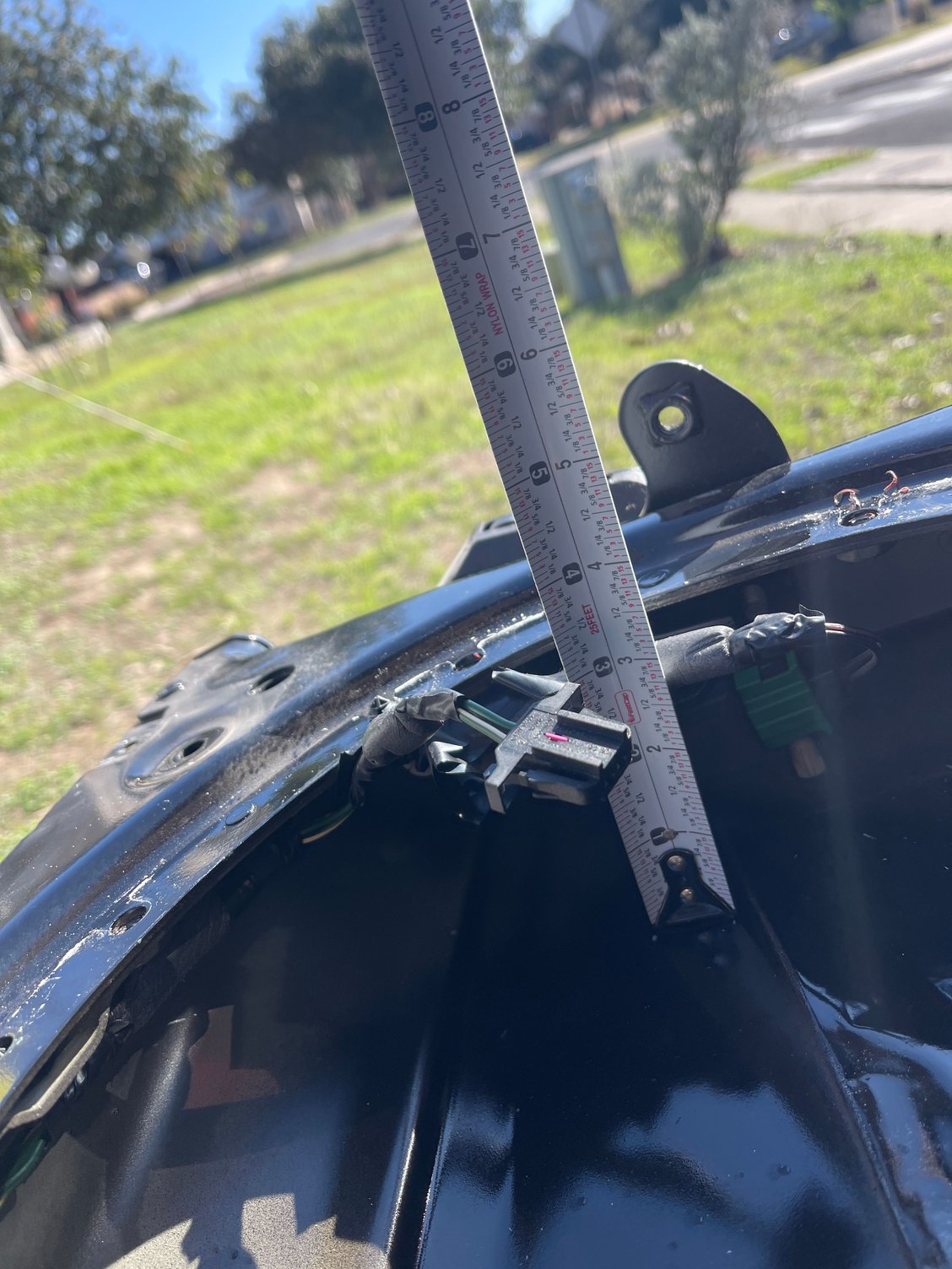

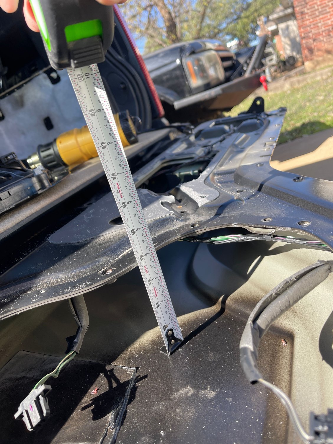

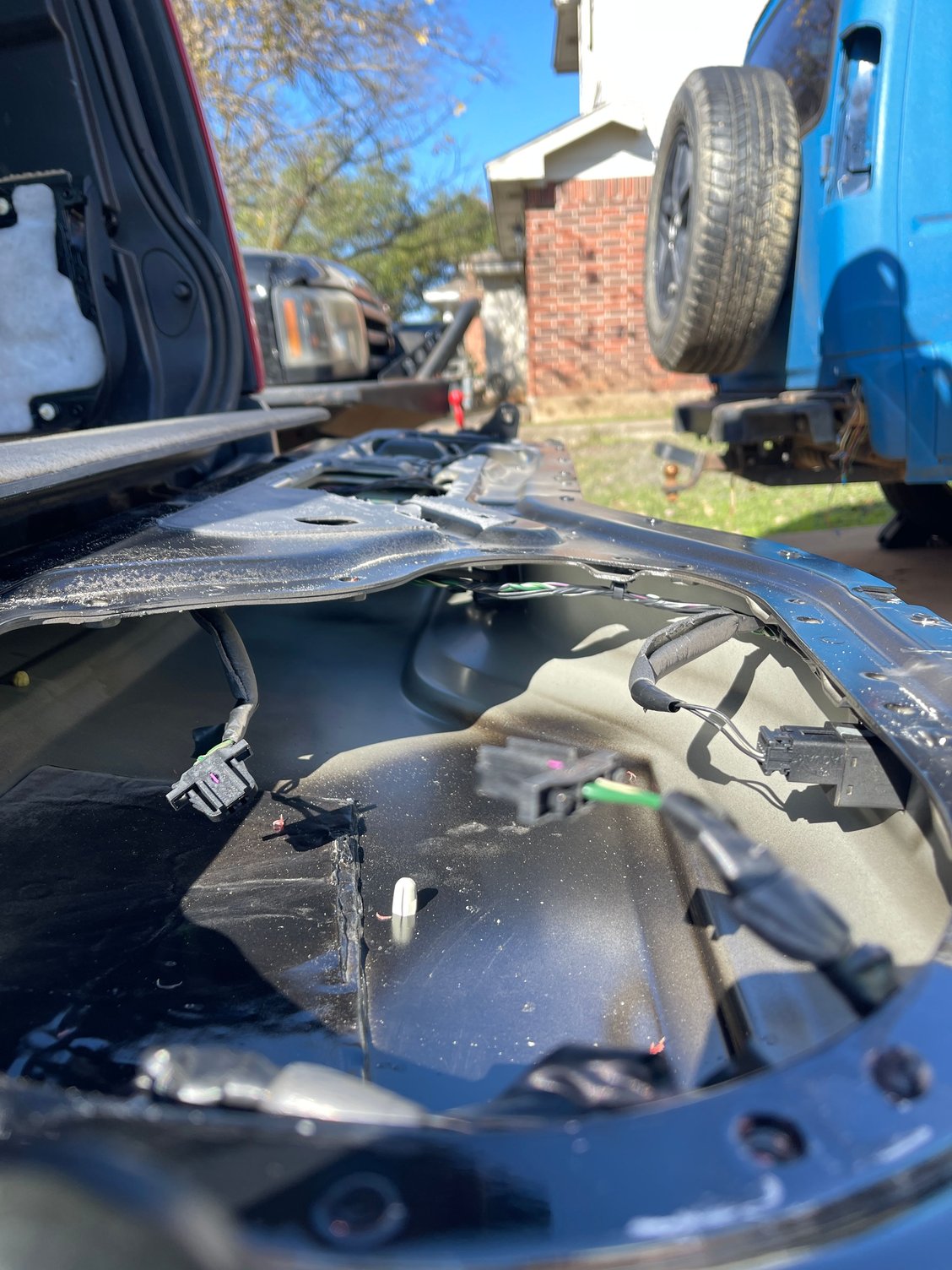

Here is some info about the rear sub in the liftgate
after removing the trim and some screws we get down to this
and we need to measure the depth..
basically, the depth is 3in at the bottom and @4 at the deepest. Without the added sound deadening. There are some holes in the panel that need to be sealed to make the lift gate door more like an actual subwoofer enclosure. So we’ll address that

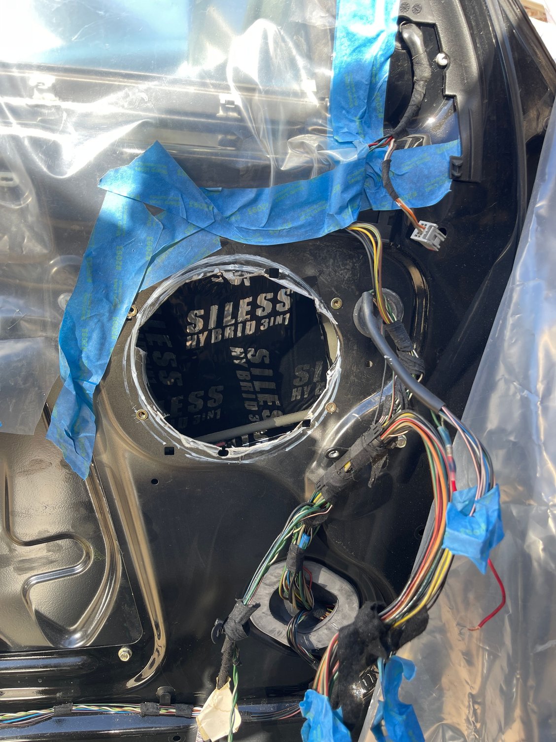

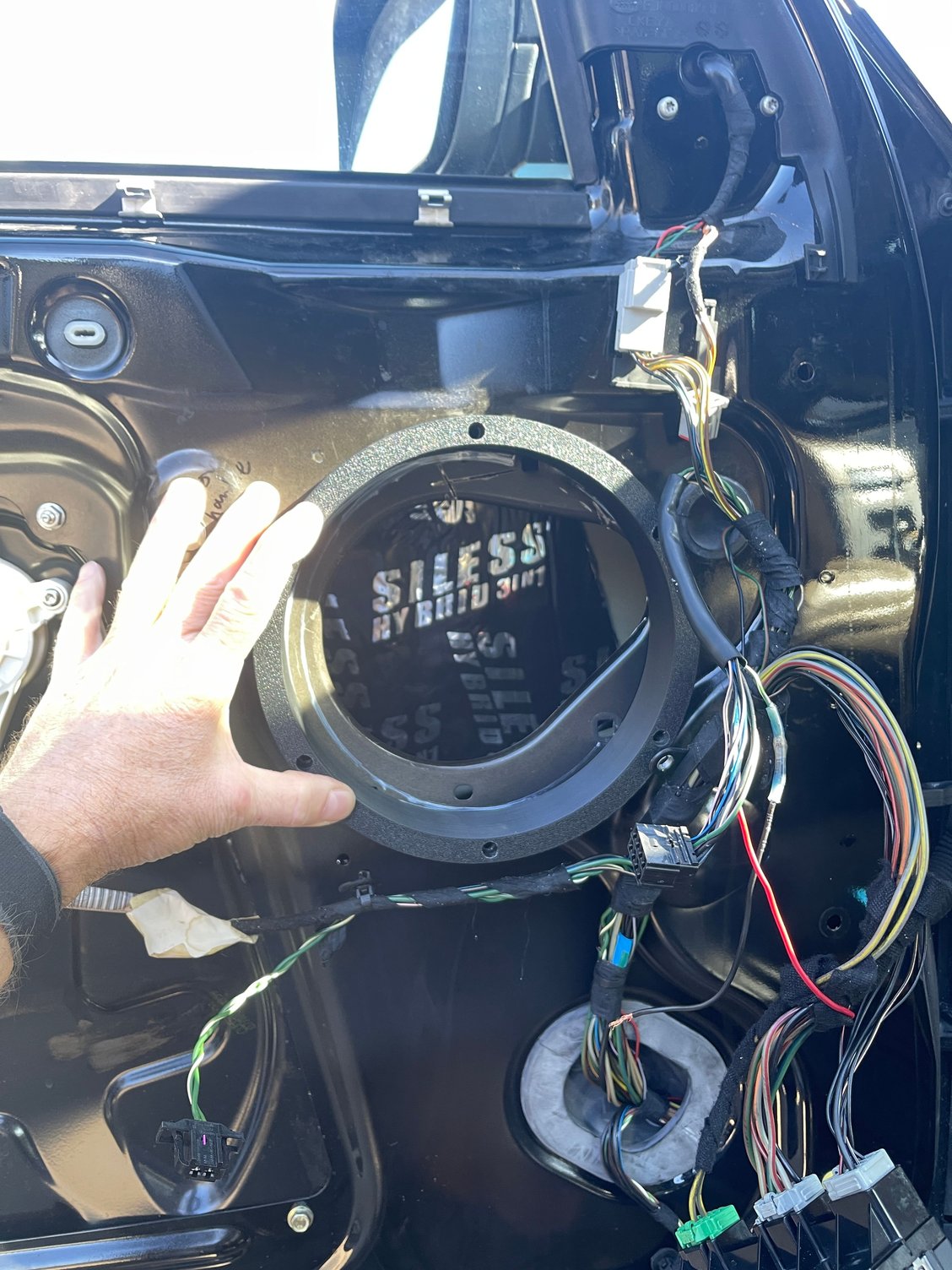

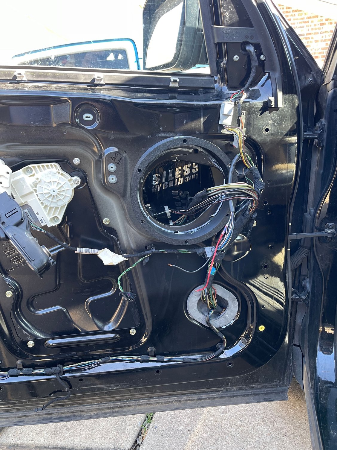

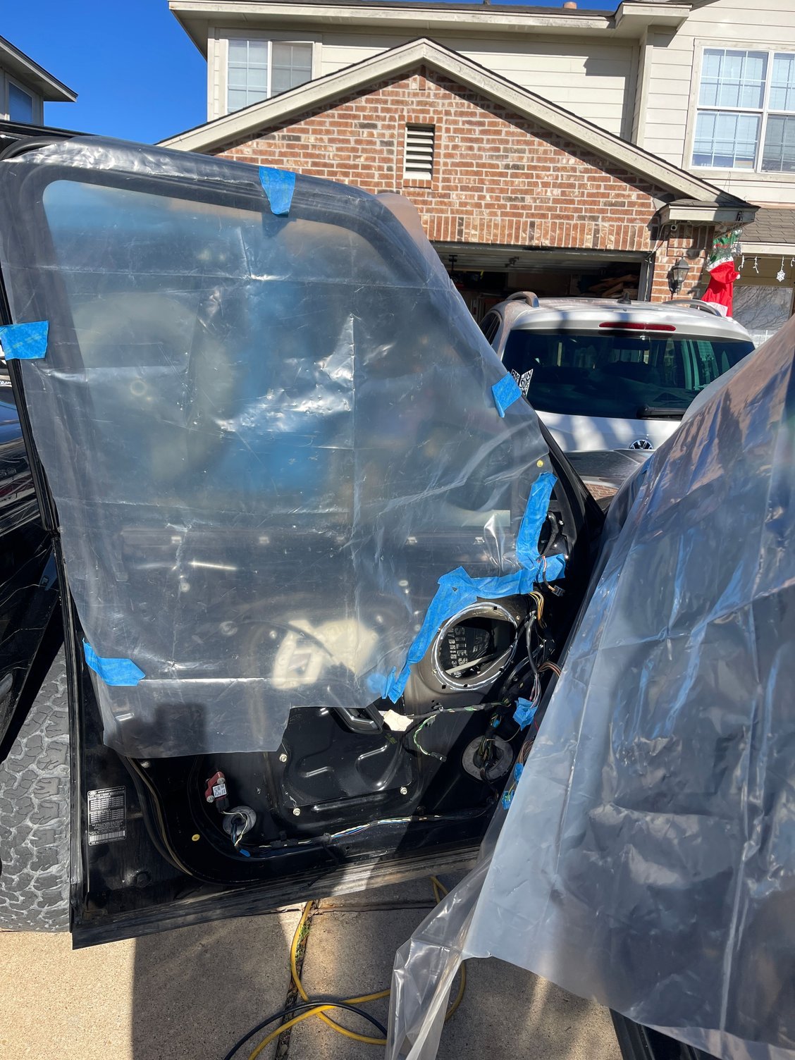

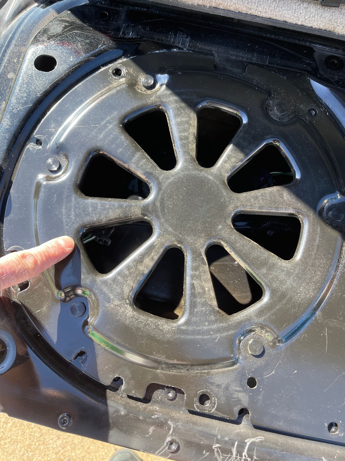

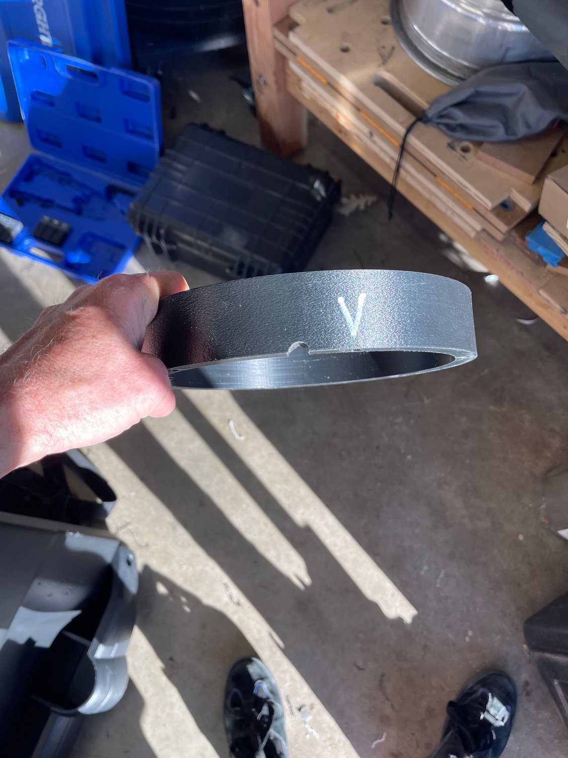

Let’s get back on the doors. First we’ll use our 3D printed adapter to draw a line and see what to trim:
then we want to use something to prevent metal shavings from getting in the car or damaging the glass.
You definitely need to cover the window because the metal shavings WILL pit the glass. Ask me how I know
so it’s cut and grinded and will need some primer. Well do that after we get a complete test fit in
and finally, we are putting a groove for the speaker wires to run behind the speaker. We are doing this because the lr3 has the oem speaker connected outside of the door on the side and the new speaker will have the connections behind it

We are attaching the adapter using rivnuts
in that pic you can barely see the m5 bolts we are using.

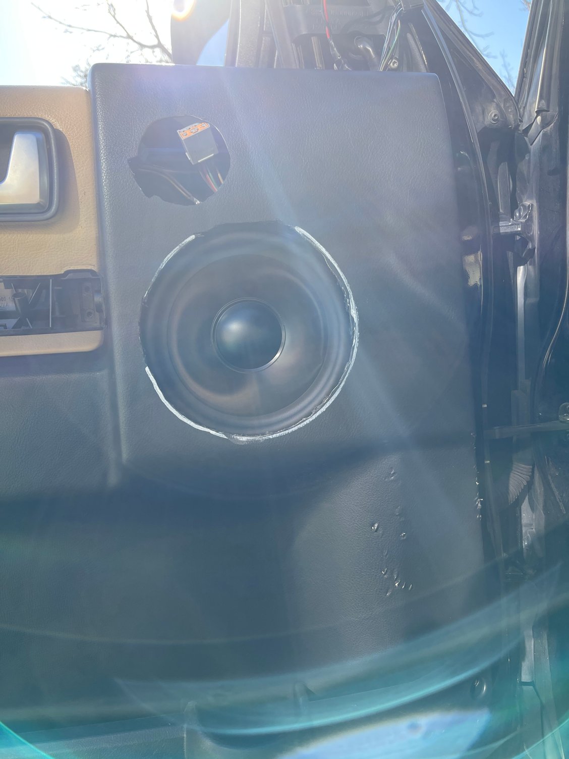

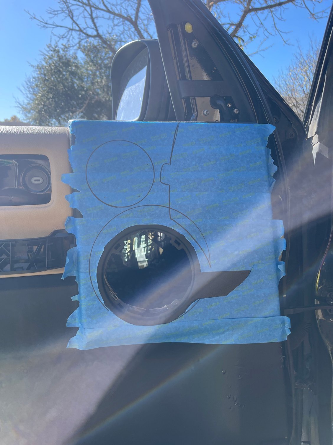

So this is a three way system so the plan is to mount the midrange in the door panel. With the midbass being in the door like factory
Best thing to do is put down some painters tape, close the door, trace door outline, and then use your speakers or adapter to make a template
And the mid bass is installed.
There will be a grill that looks oem going over it

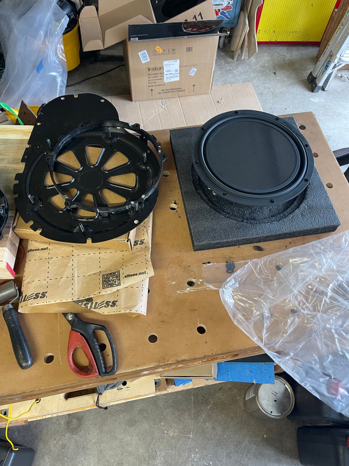

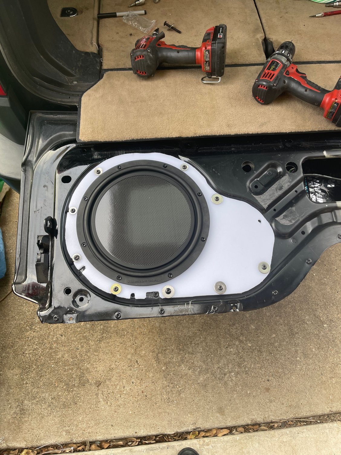

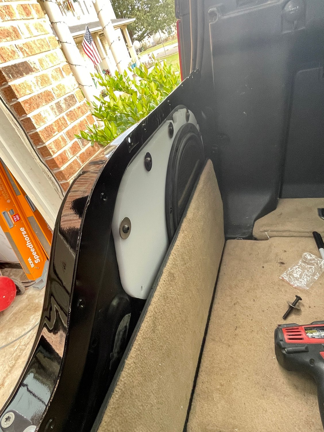

Doors are not done but we made lots of progress on the subwoofer in the tailgate.
The white board is hdpe. This stuff is perfect for making custom speaker mounts. The new subwoofer is just a little bit bigger than the factory one so we had to make a mount for the new sub. Because of this, the subwoofer sits just a hair higher than stock and we want to keep the oem look so some more custom work is coming for that
