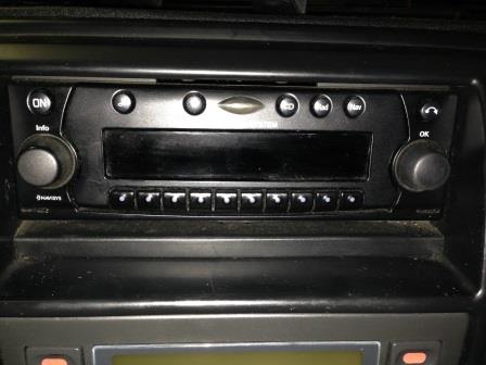

Long time lurker, first time poster.
I have seen all the youtube videos, read all the posts on how to remove the radio and I have made the folder hanger tools but I have yet to see one that looks like mine in any of the posts. That was fine until it decided to quit on me... There is a little light on when you open the CD "door" and it's on no matter what fuse is pulled. Other than that there is no one home and it's a brick.
Does anyone else have this head unit and if so how do I get it out?

The slots in the bottom left and bottom right corner of the head unit are where the removal tools go. https://landrover.service-solutions....val_Tools?c=18 that is the tool set...looks a little different than the ones for removing the standard radio.
