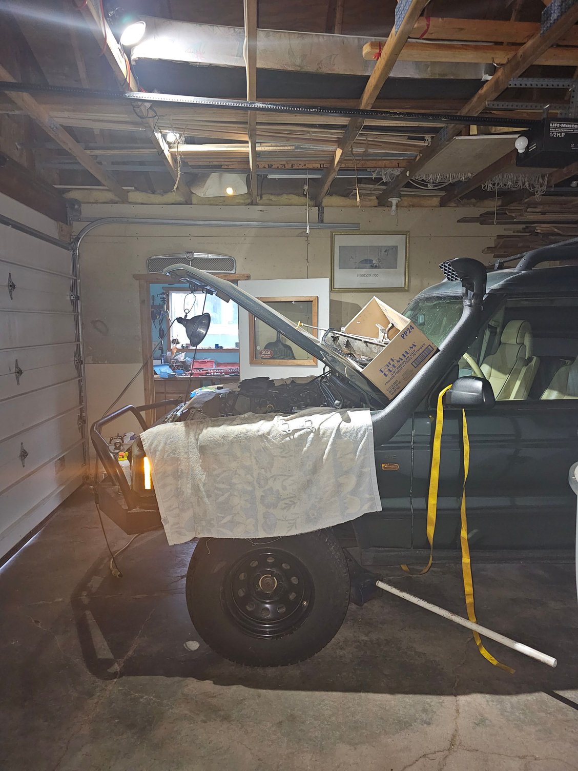

Fits just right in the garage

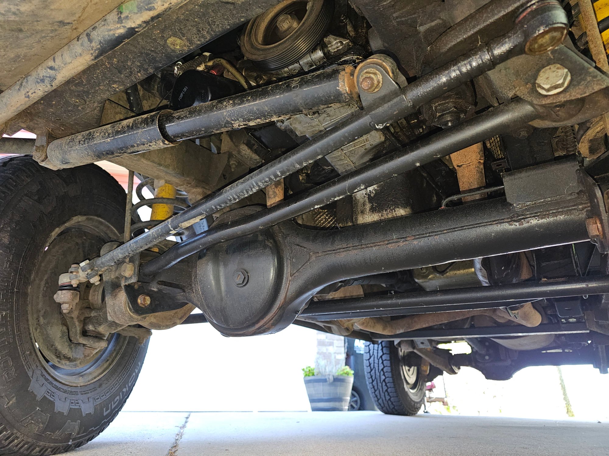

Relatively clean underneath. Original California vehicle and been up north for a few years from what I can tell

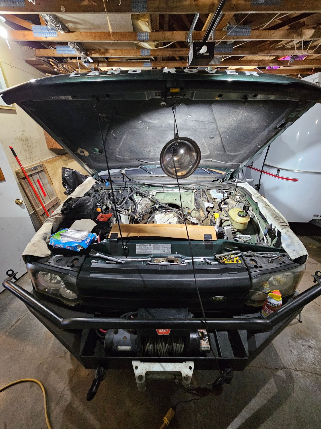

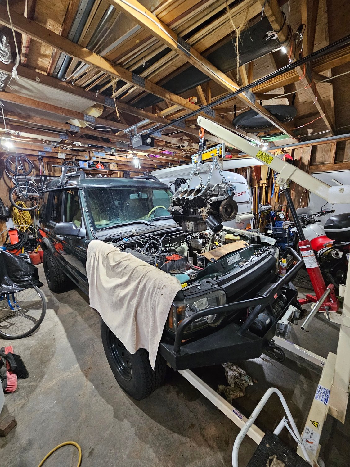

So in the past few days I pulled the motor, and will be freshening everything up apart from the block internals. One score on this disco was that in 2018 it had top hatted liners installed.
Managed to get the hood off and motor out by myself. Another set of hands would have helped but not horrible by oneself.

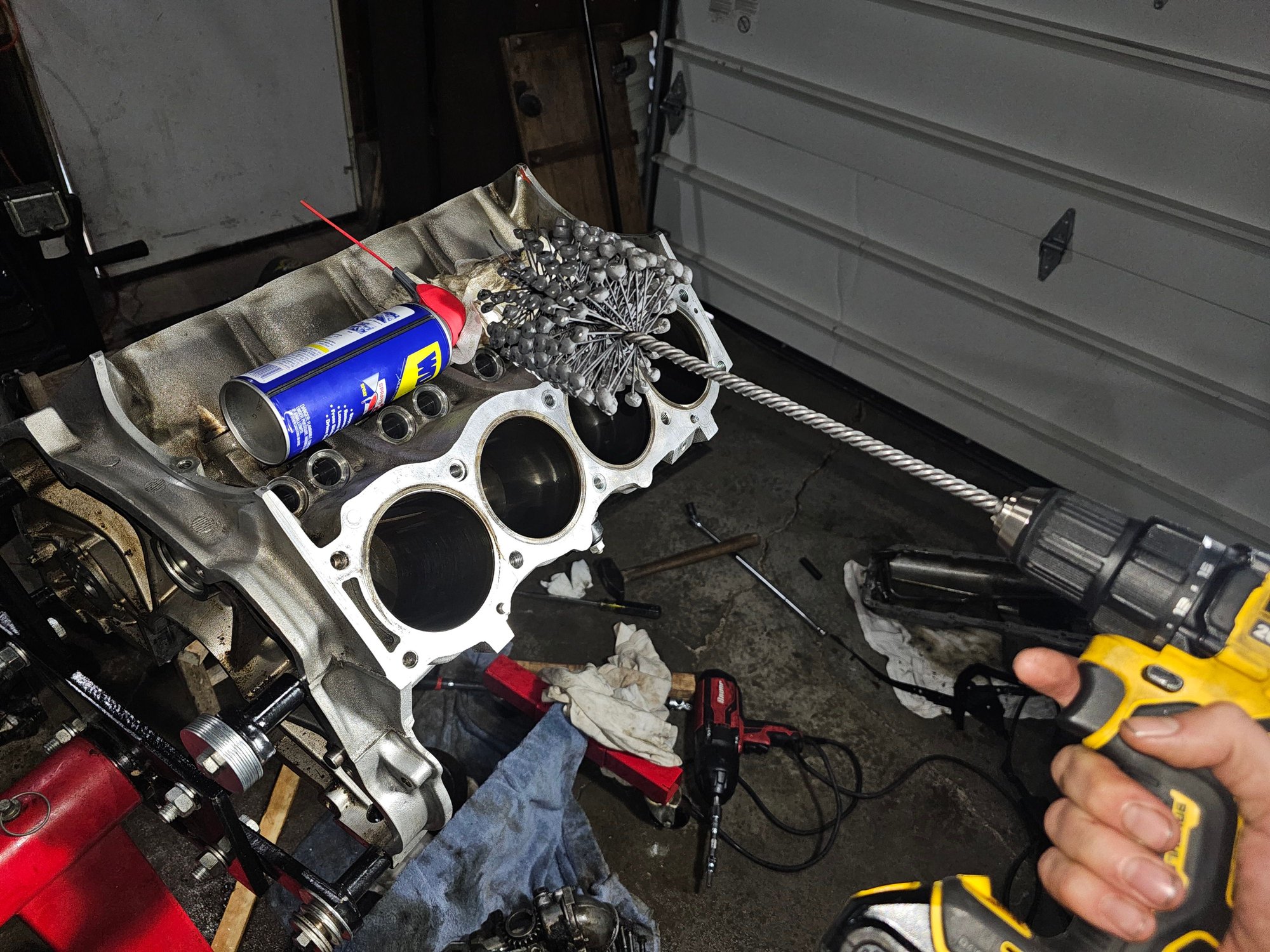

This was after some cleaning. Forgot to get a pic of it in it's complete filth.
Day 1 of cleaning

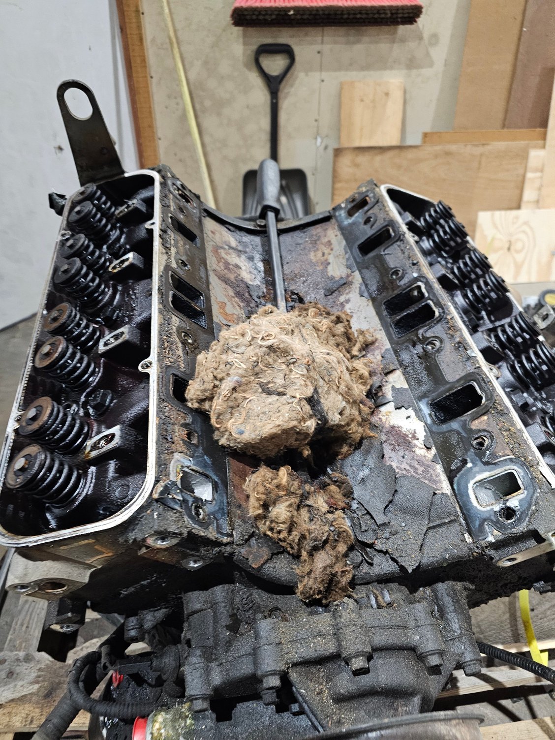

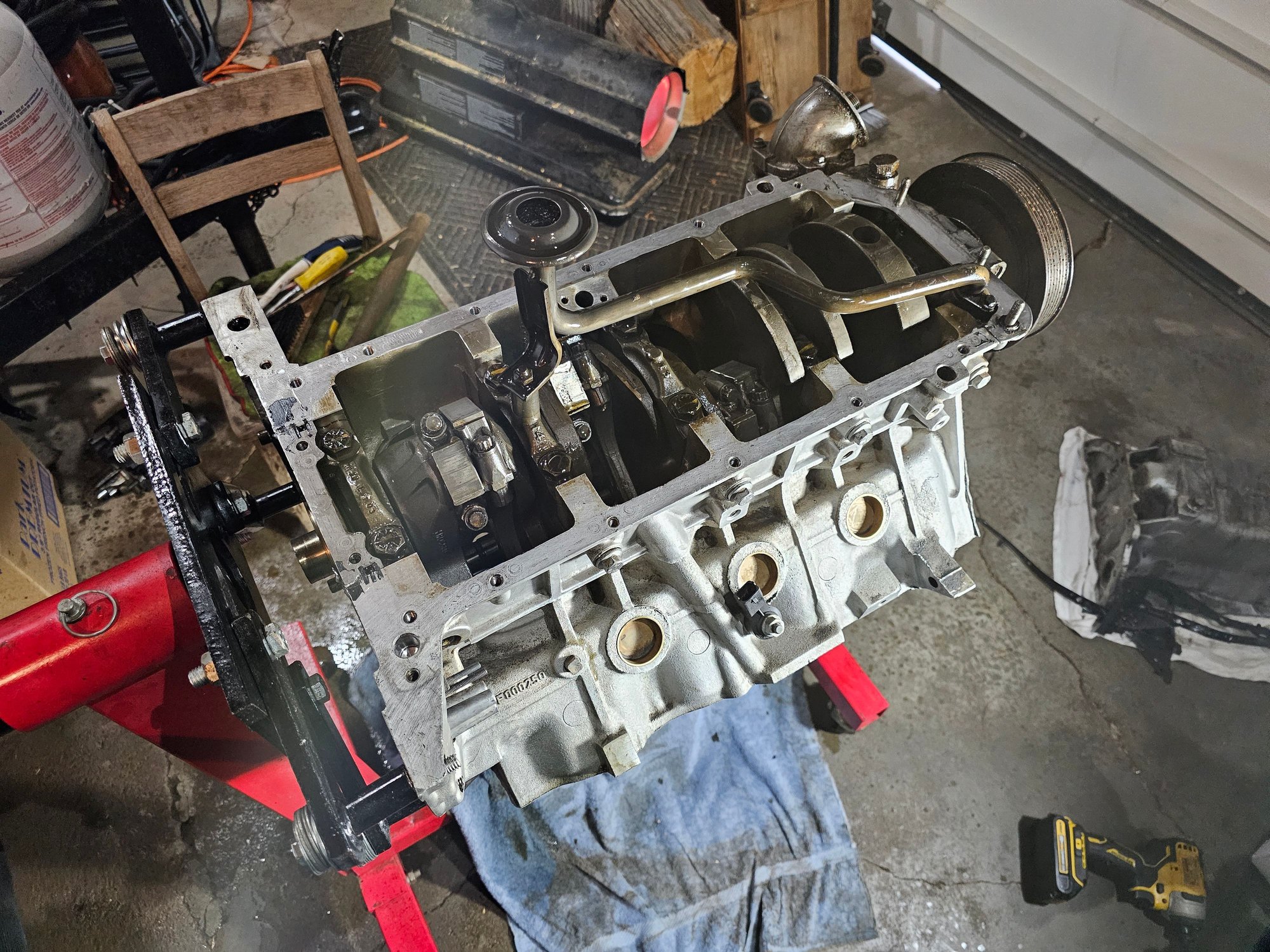

Noticed this protrusion on the left side of the block. Is a non-essential part of the block, but had me worried before removing the pan.

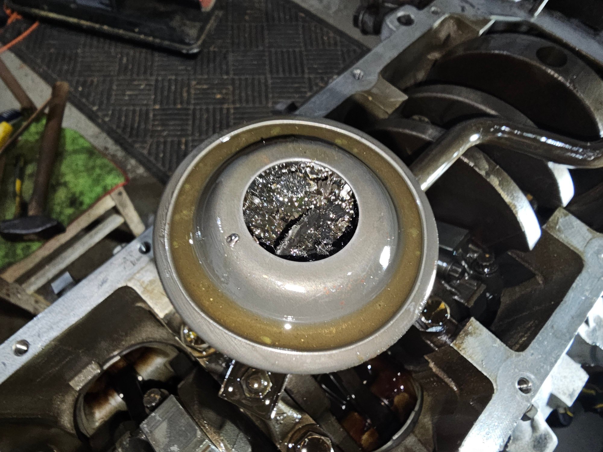

Oil pickup strainer is completely clogged. Glad I am pulling this thing apart. I noticed remnants of what looks like head gasket material. Hoping the internals are fine. Previous owner said it ran well and was quiet. Can't imagine the oil pressure was that great!
Getting cleaner! It's a dirty job.
End of Day 2 cleaning.

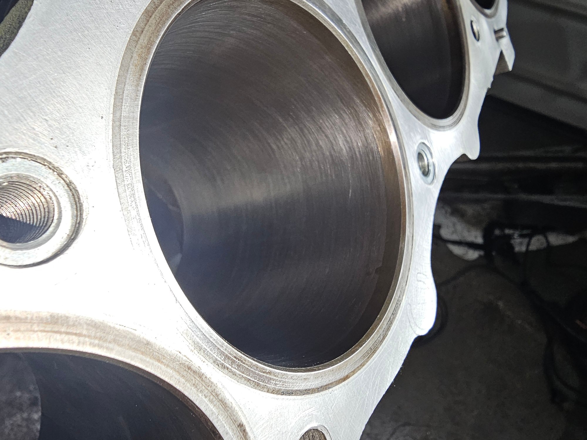

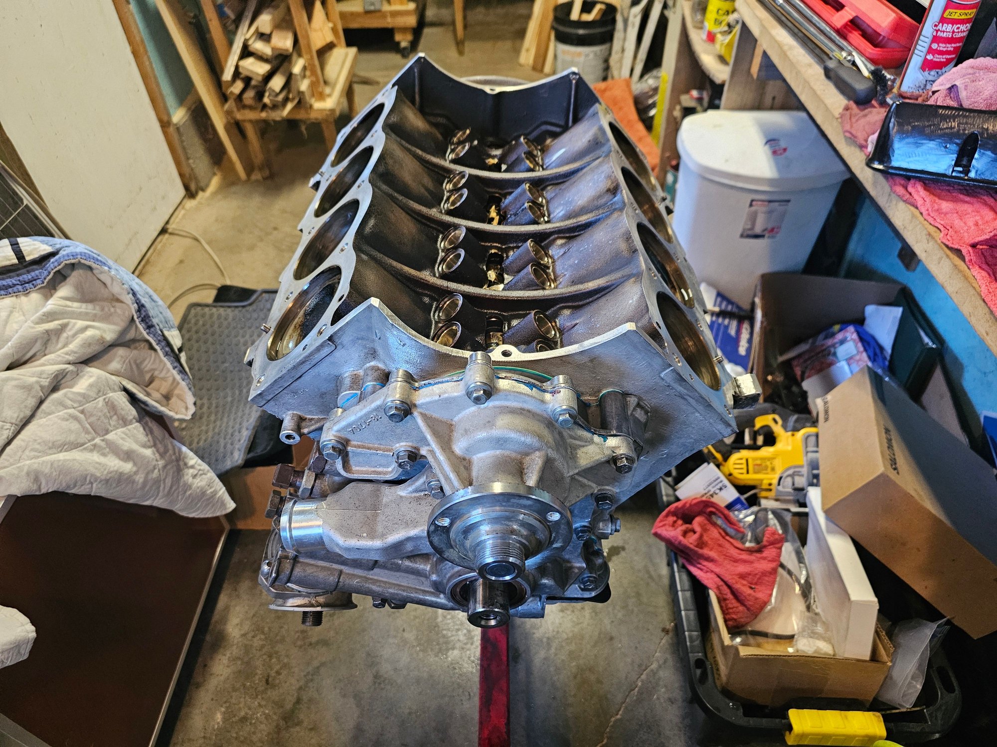

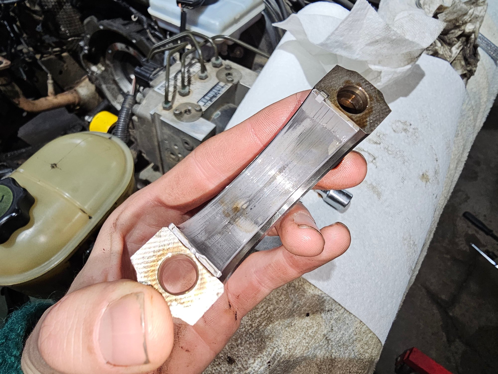

After more clear thinking, I decided to take the internals out for inspection. Crank looks good and is at machine shop for polishing. Will throw new bearings in for safe measure. Why not at this point?

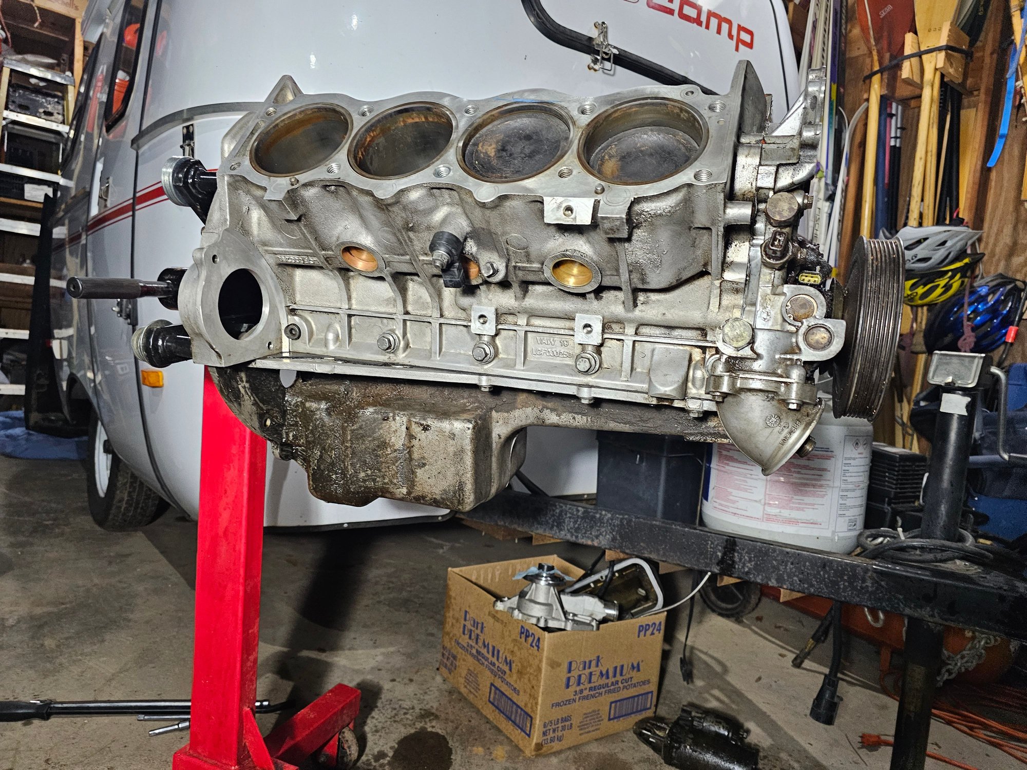

Well, fast forward a few months (see my other thread for updates), the build lasted a few thousand miles before the hgs blew out on the valley pan side. Turns out the block surface, with all the time serts installs just wasn't flat enough to hold.
I ordered a 2000 p38 engine from a salvage yard with 110k. It was really crusty looking, but I thought I'd take my chances. None of the pistons look steam cleaned so fingers crossed 🤞
​Tore it down and have my heads at the machine shop getting reworked.
A nice little present
Did I mention it was crusty??
Up onto the stand without a hoist
Swapped over my new timing components, cover, & oil pan. Waiting on the heads and then I'll drop this thing in!
