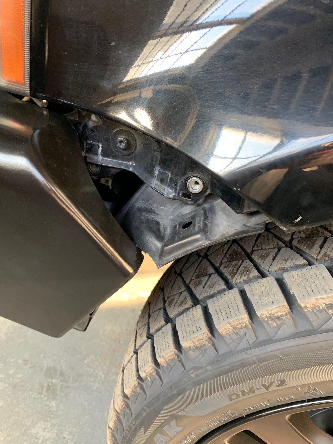

Appreciated Barry at Compomotive UK's assurances with the OEM 4piston Brembo/14.2" rotor fitment under these 18x8 et44 (29lbs/ea) PD1881's. Here's before and after we rotated the phonic dampers(I had seen on other threads where guys removed them completely, which brought out some squeaking of course. No need to remove them, just rotate them 180deg as CompUK recommends!).

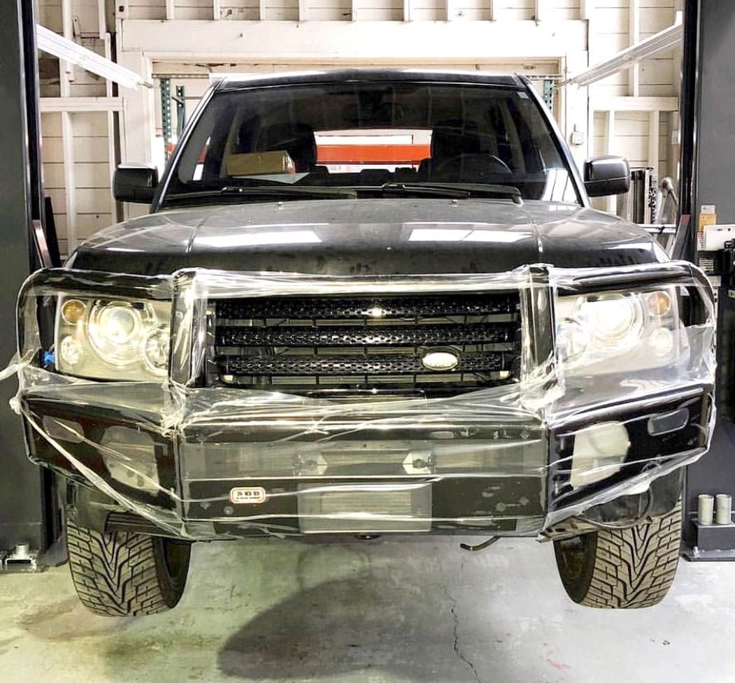

Note that this is the ARB Summit for the '14-16 LR4 (some have thought from the first pic that it was the '05-09 LR3 bumper); updated larger foglights, clear foglight covers, and different cut on the bumper's "side wings" as an LR4's fender flare wraps further down to the ground (compare this with the the LR3 where the upper bumper side edge is straight as it travels towards the tire). So, fitting the ARB Summit from the LR4 to the requires custom metal "inserts" to be fabricated, which will take up the space between the side wing and fender. Now, also depending on the tire size, you may have to make other mods. Currently finding that the large 275/70/18(33.16") tires now fitted, are contacting the ARB's "side wings" where they face the front tires(near wheelwell liner) and ARB lower bumper shrouds. Ugh.
Got the 2 ARB Intensity LED lights on. Curious to see them at night.

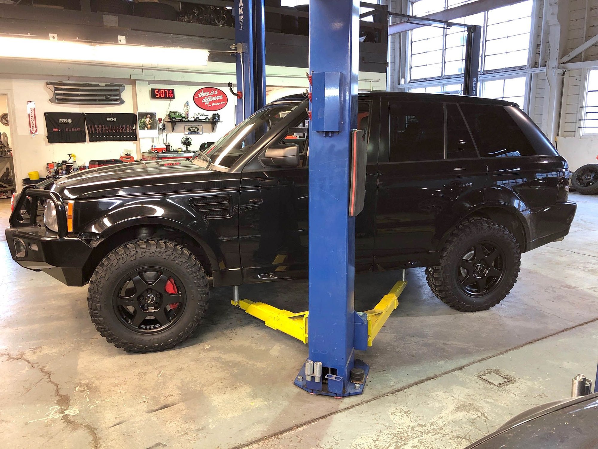

275/70/18 tires/Compomotive PD1881's are on. Experiencing some rubbing at full lock. Now Bryce says it's time for some slight trimming!
