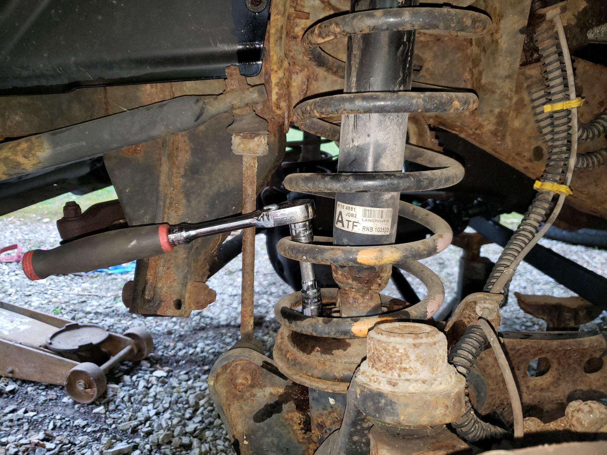

The LC springs were a little crusty but nothing a wire brush, acid and spray paint won't clean.

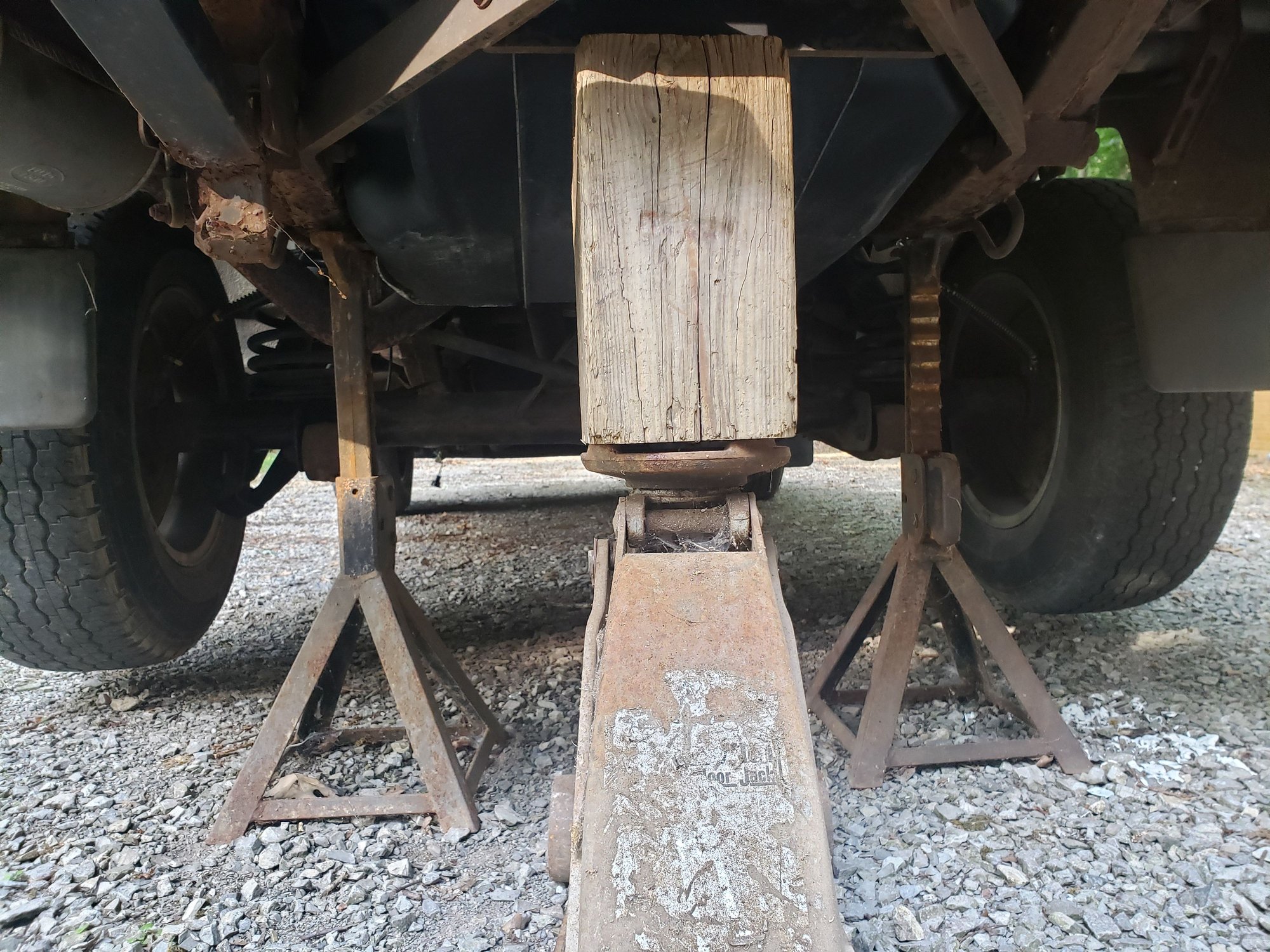

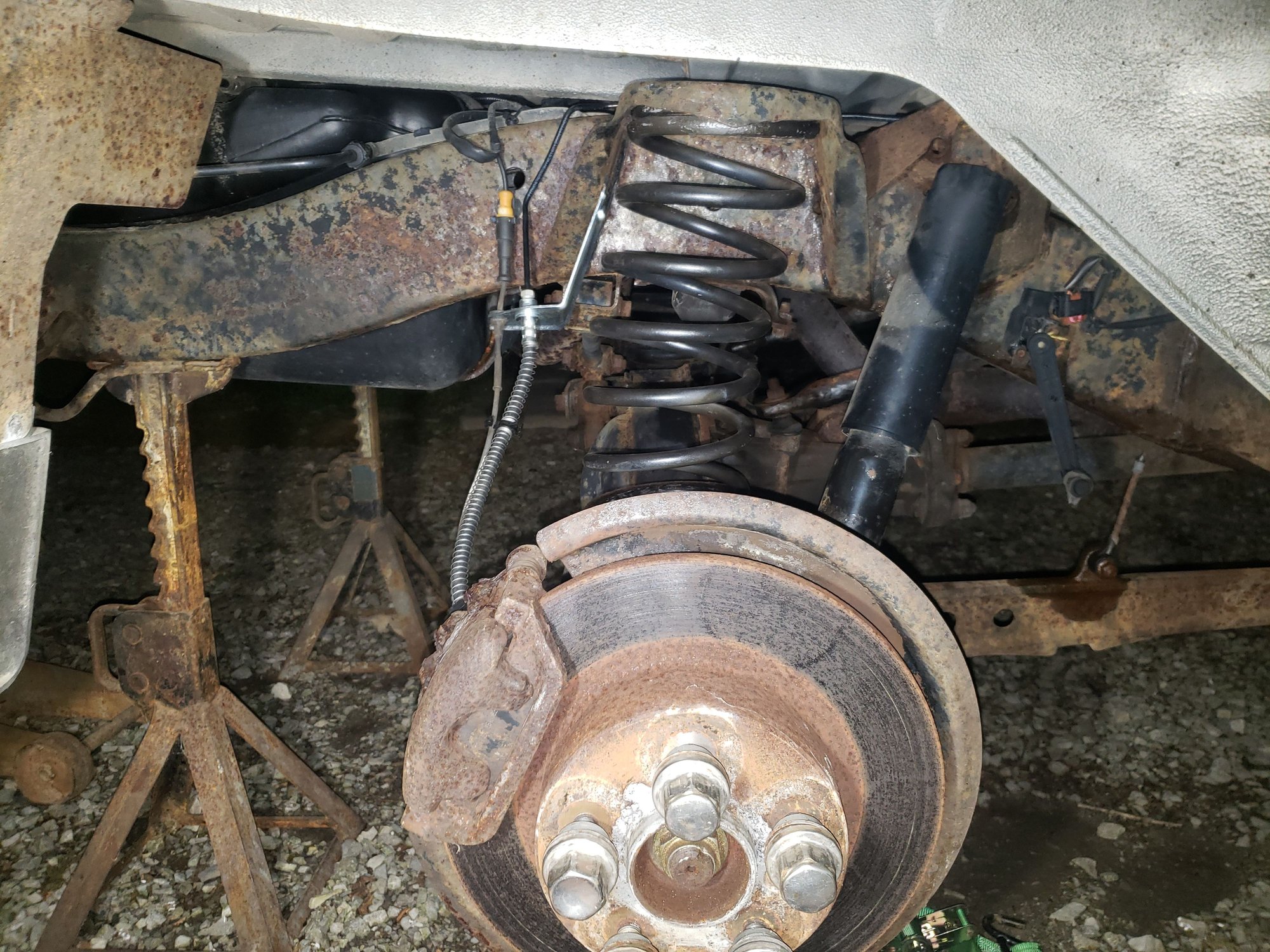

Default Cheap bastard lift

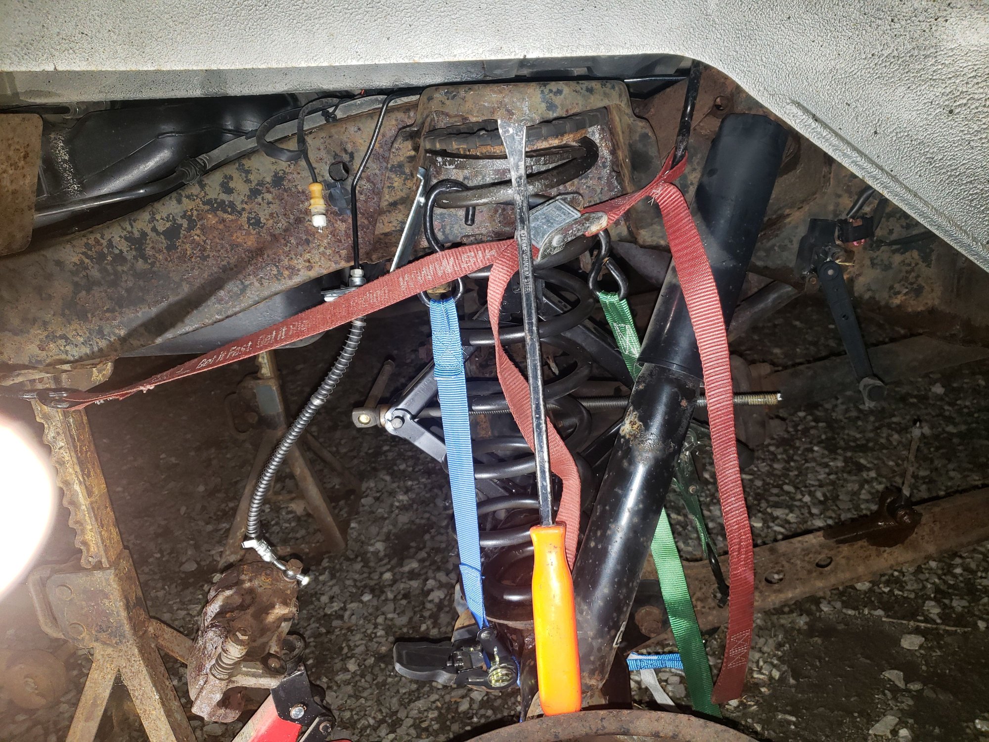

The threads i read made the spring swap seem easier than it was. The rears came out easily, the toyota springs are about an 3-4" longer and weren't so easy. I had to take the calipers off and since I didn't have my spring compressors, used a super sketchy combination of ratchet straps and pry bar to pop them in. ----dont try this at home---

Default Cheap bastard rear coil install

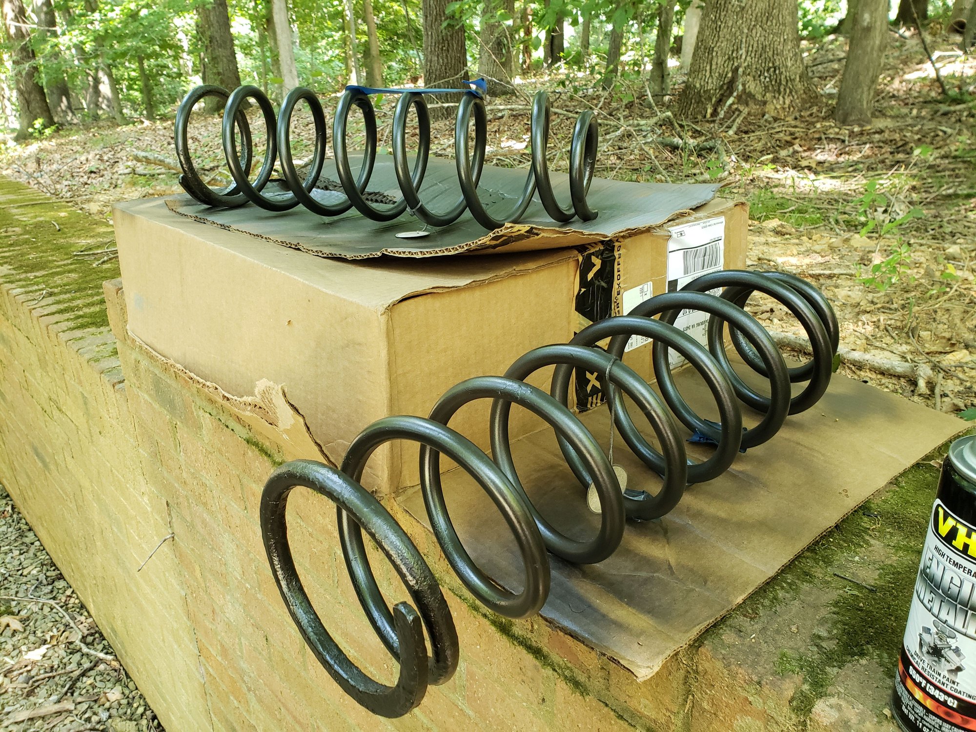

Default Cheap bastard lift rear D2 coils moved to front
The rear coils are a solid 3" longer with thicker winds. Because the diff is offset to the right side and the axle hitting the cross member, I couldn't drop the axle low enough to fit the springs. No way I was going to use ratchet straps again, so off to parts store for spring compressors. I also disconnected the brake line/ABS wire bracket from the lower spring perch and the sway bar link from one side and lifted the spring turret and shock out of the way.

Default Cheap bastard lift front
If I was going to do it again, I would remove the cross member.
Make sure you line up the lower spring beat bolt holes before you release the spring! It was still a challenge to start the bolts.
Make sure you have a variaty of extensions

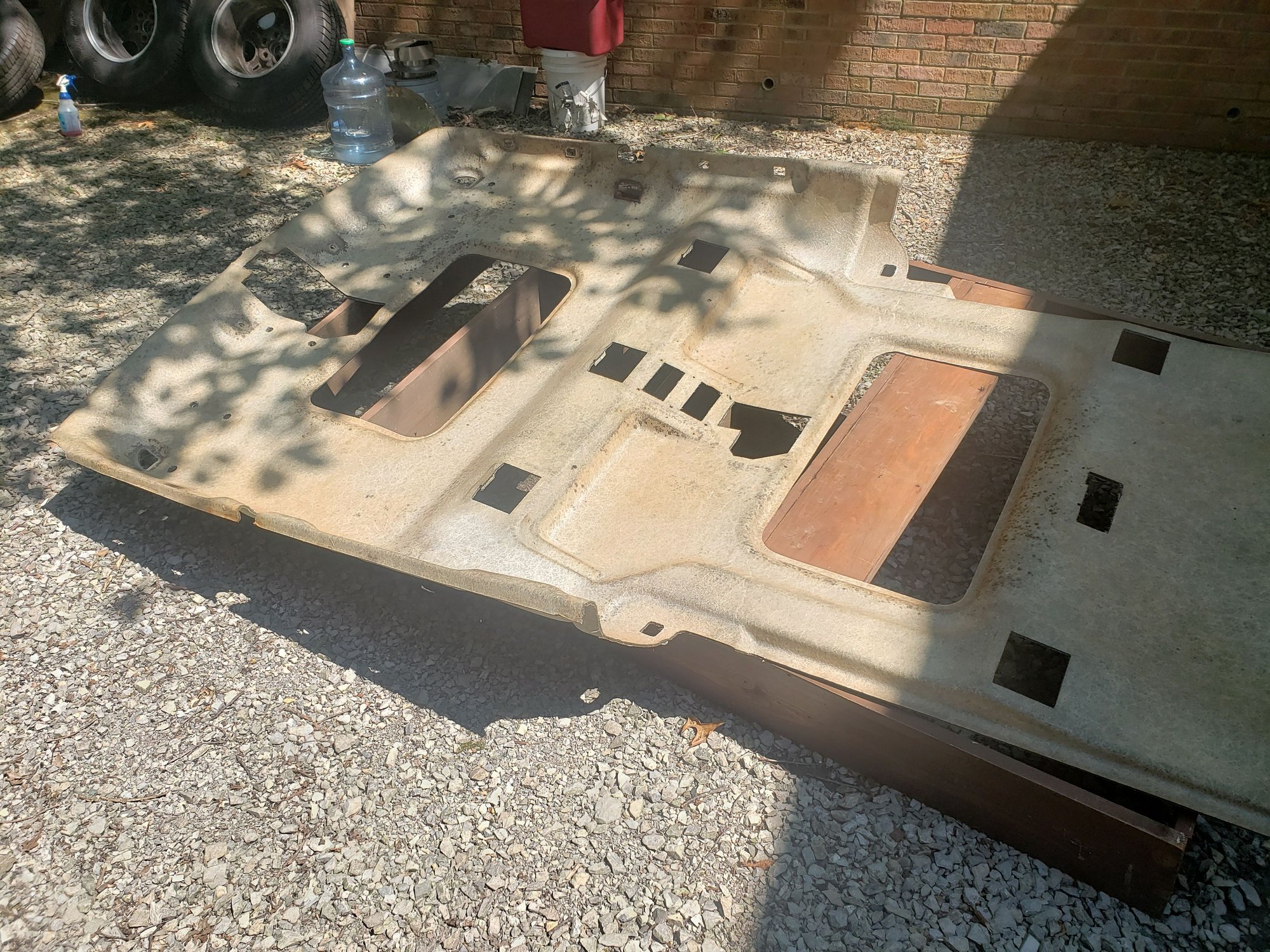

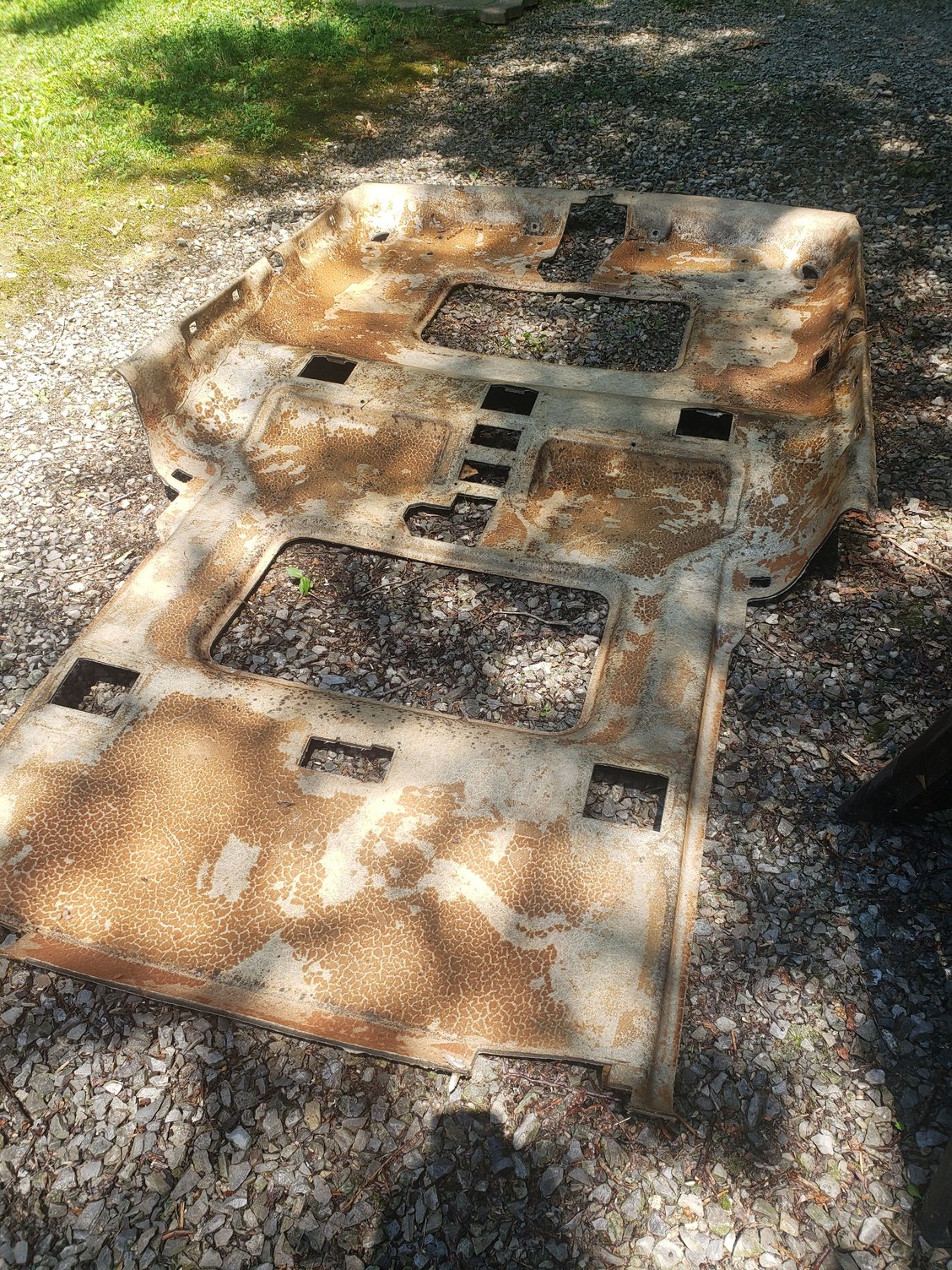

Default Head liner cleaned and ready for coating
My plan is to coat the head liner with truck bed liner but decided not to go with black (already have it) so I didn't apply on this visit. I did manage to clean the old adhesive off. A pressure washer made short work of it.
Before
After pressure wash

Normally, if l get a stubborn one...remove the front drive shaft at axle, instead of fighting with the ridiculous bolts on the crossmember (which usually snap off anyway).
