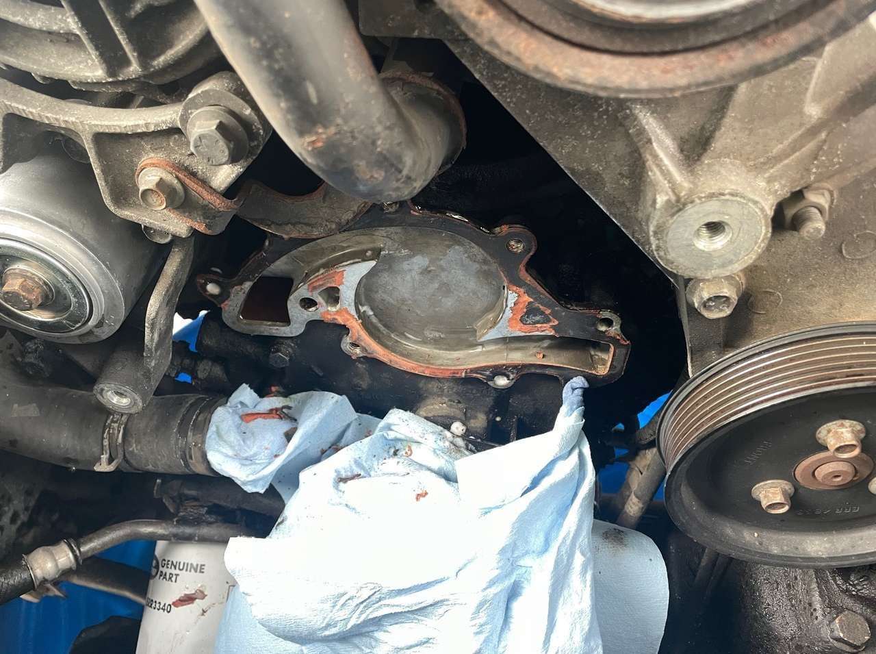

Started working on the cooling system overhaul. Got everything off just fine. A kiddie pool is the ticket for catching all the coolant. Here's everything off:
Made sure I kept the bolts in order:
This is as far as I got on removing the old gasket. This stuff just will not come off.

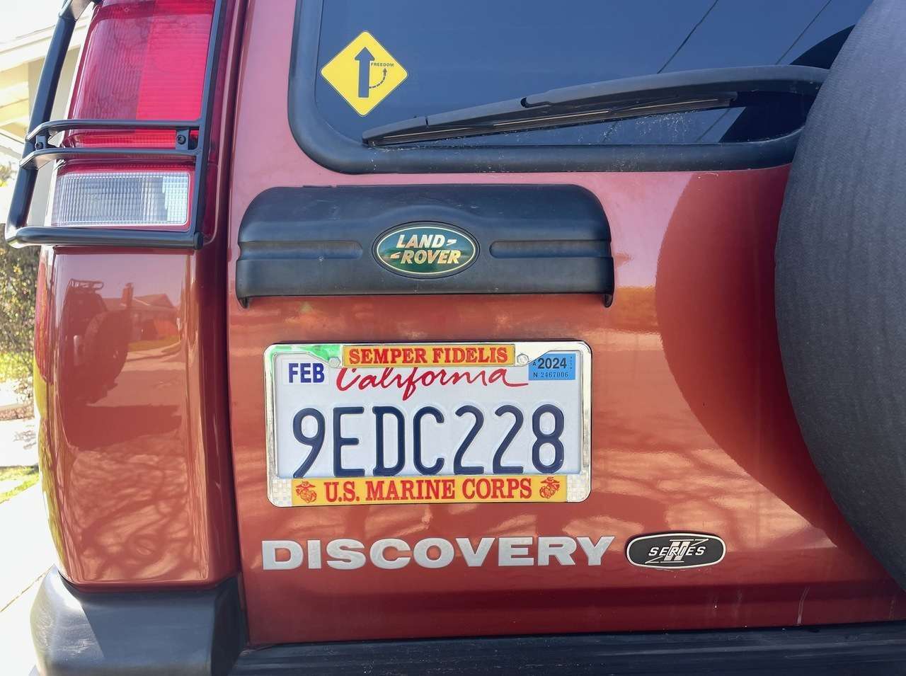

During a couple of breaks while letting the gasket remover do its thing, I installed a new license plate frame:

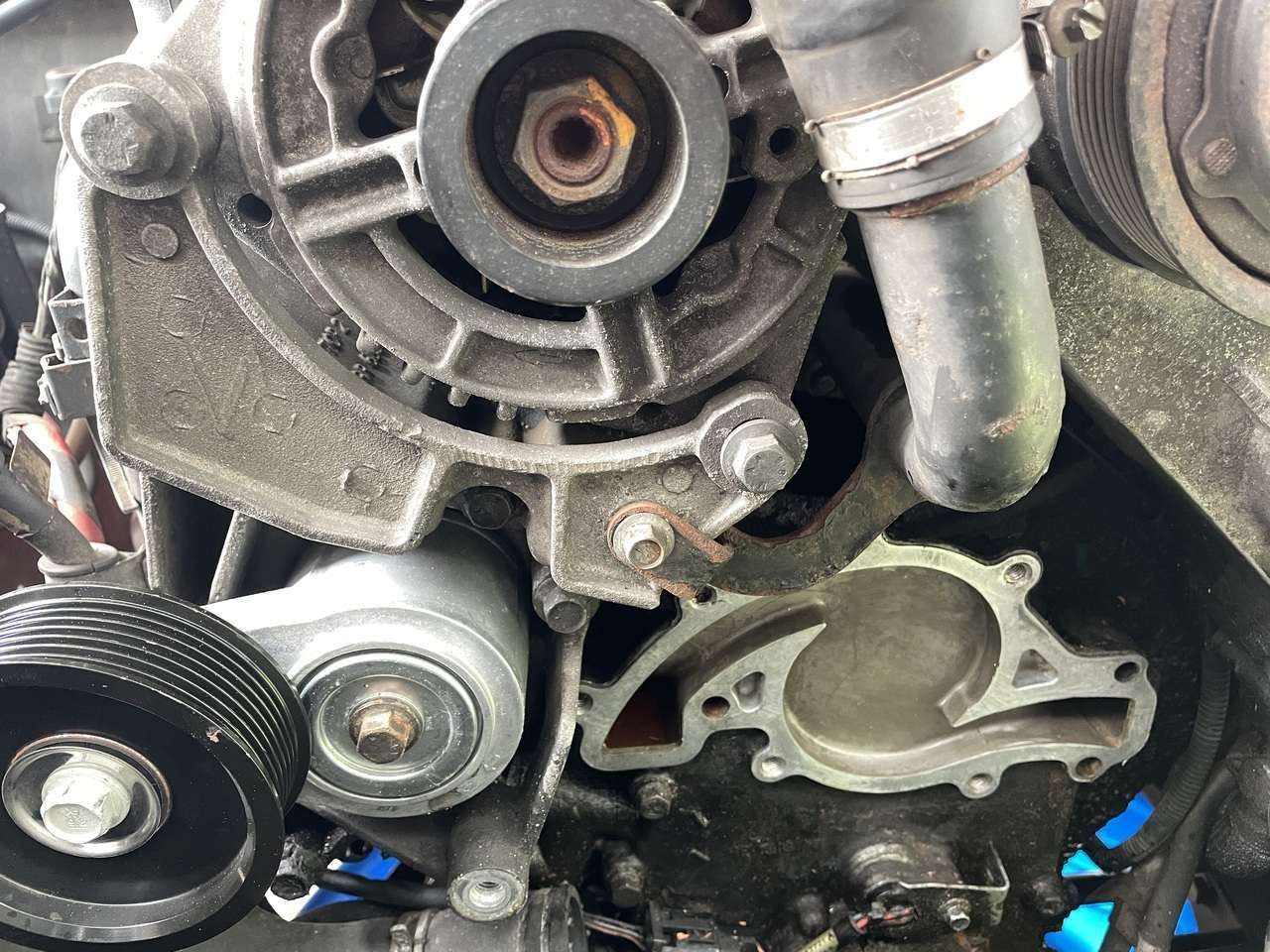

That gasket was a bitch and, as you may have heard, San Diego has been subjected to one atmospheric river after another. Finally finished removing the old gasket material yesterday afternoon:

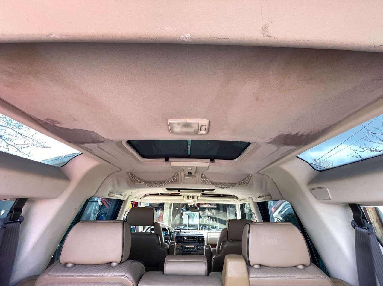

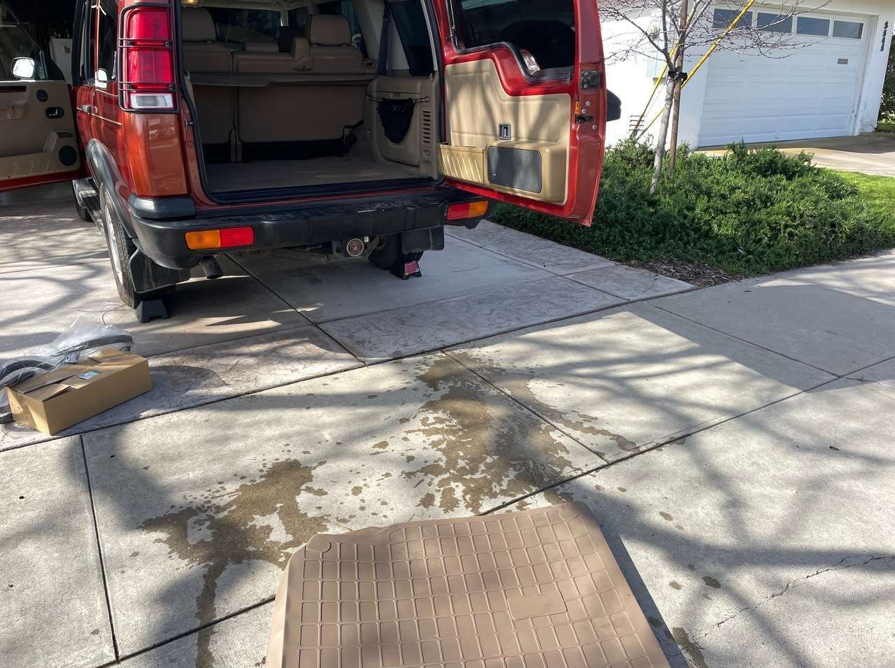

So this morning I went out to work on it and opened the rear door to get a part out and found this:
There was a small puddle on the Weathertech cargo mat. Looks like it's coming from the rear sunroof:
Is that where it would be leaking if the rear sunroof drains were blocked? Does anyone know if there's a way to unblock the drains without opening the rear sunroof? (Mine does not work right now) I had planned to have the headliner reupholstered and fix the rear sunroof anyways, but I guess those jobs got moved up the list.

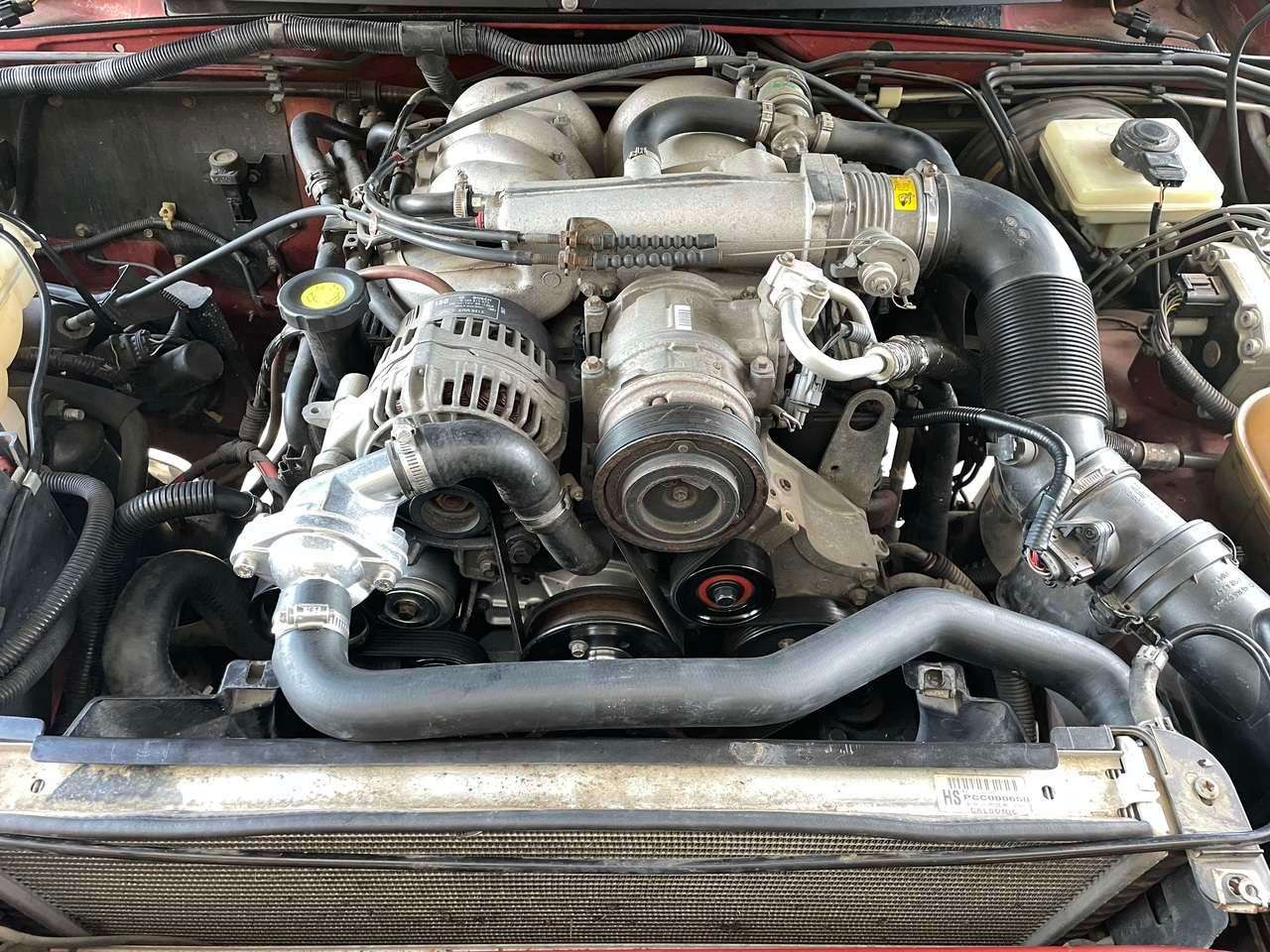

Made some real progress today on the cooling system upgrades. I installed the FlowKooler water pump, the Extinct Inline thermostat (without the thermostat), connected all the coolant hoses, replaced both idler pulleys, and re-installed the new serpentine belt. For once, everything went smoothly except for bonehead me installing the main hose across the radiator backwards the first time. :facepalm This weekend I'll flush out the rest of the Dexcool and replace it with normal coolant. Can't wait to have her back on the road.

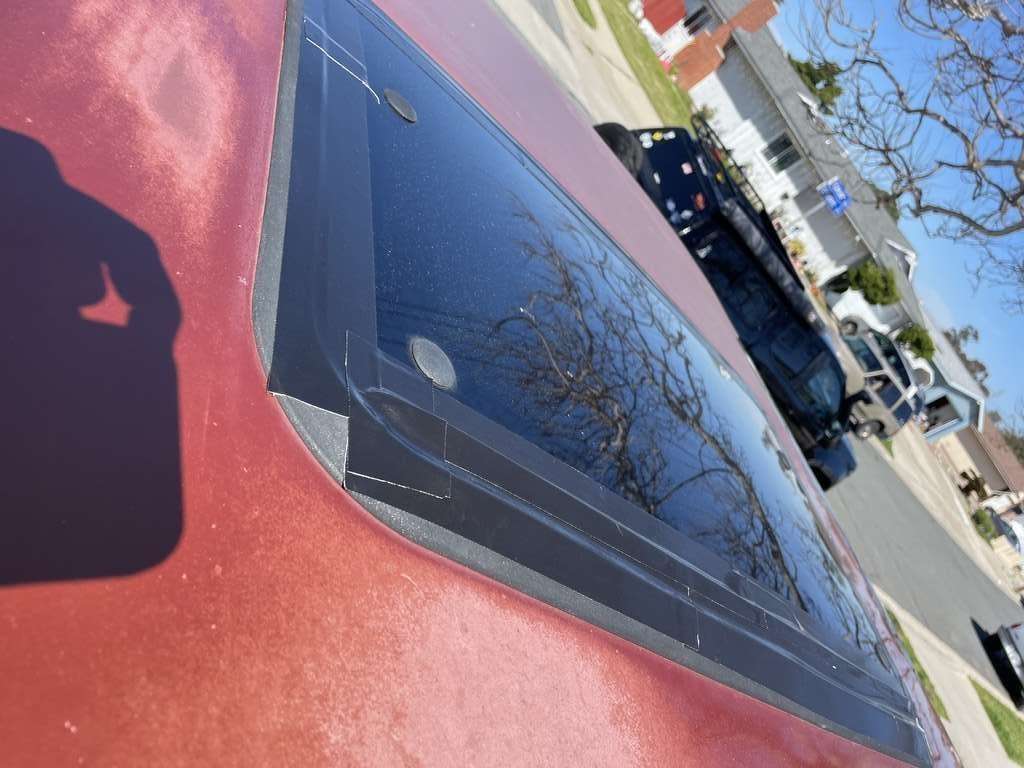

Since we're expecting to get hit by our 13th Atmospheric River this week (SERIOUSLY???), I did a little redneck repair to the sunroof seal. I'm not optimistic it'll work, but I really don't have any options. Gorilla Tape ftw?

I don't know if that tape job will hold I did something very similar and it still leaked so my dad and I just put a whole patch job of tape and covered the entire sunroof glass and everything and it's been waterproof for going on 2 years now. We also used "waterproof" tape too so that might have helped.
