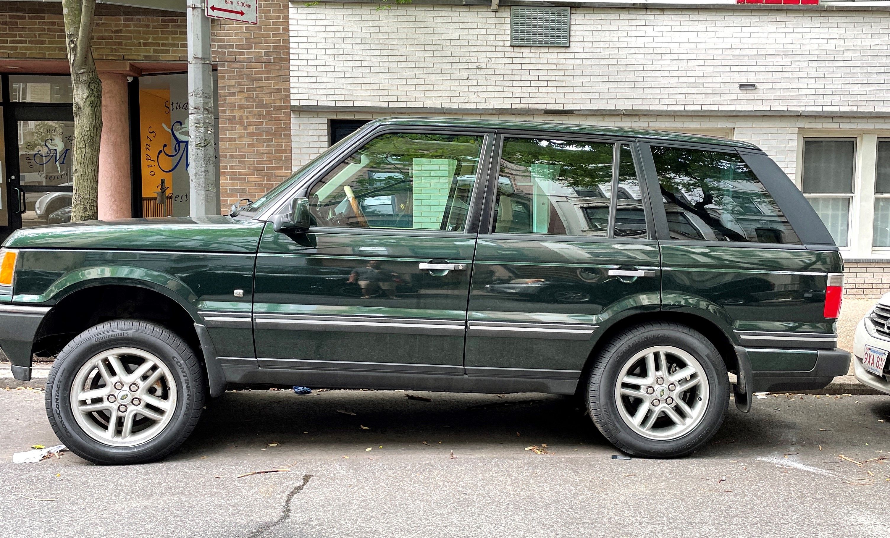

2001 Range Rover HSE - 141k mi

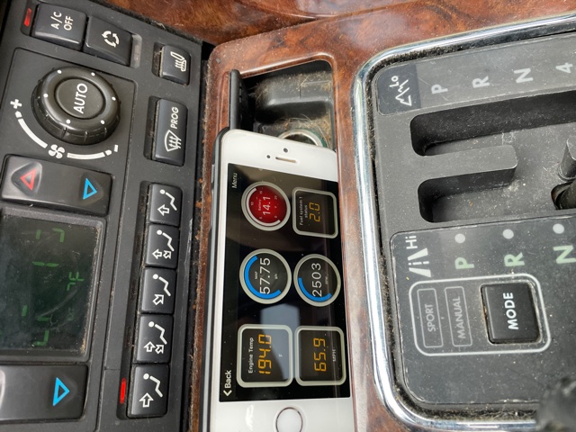

Previous owner had a stack of service records and took care of the car for the first few years of ownership. Then it sat only accumulating 10k miles in the last 10 years. The frame is clean other than some surface rust. It runs 194-198 down the highway on a 85 degree day.
Things already done: head gaskets, heater core, blend motors, EAS compressor, Ckps, Cps, rear window lifts, replaced transfer case, idler pullies, belt tensioner, water pump, thermostat
A/C doesn't work. Condenser leaking
HEVAC screen doesn't work
tires are a mix of cheap rubber
brake calipers are rusted
sway bar end links shot
oil cooler small leak
trans cooler possible leak
Wish me luck! I am sure I will be asking a ton of questions as I attempt to avoid going mad and wasting tons of money.

Gunk on the trans cooler likely from the A/C condenser and after everything has been reassembled. Now idles at 185 F.

A/C unit now functioning. HEVAC head unit tidied up. I love the two speed electric fans. At idle with A/C on (88F deg ~ 31C) the temp climbed to 206 F and then the trinary switch did its job and changed the configuration in the e-fans to speed them up (serial to parallel...or the opposite, I forget?) and the temps fell to 197F. Absolutely pleased with that.
