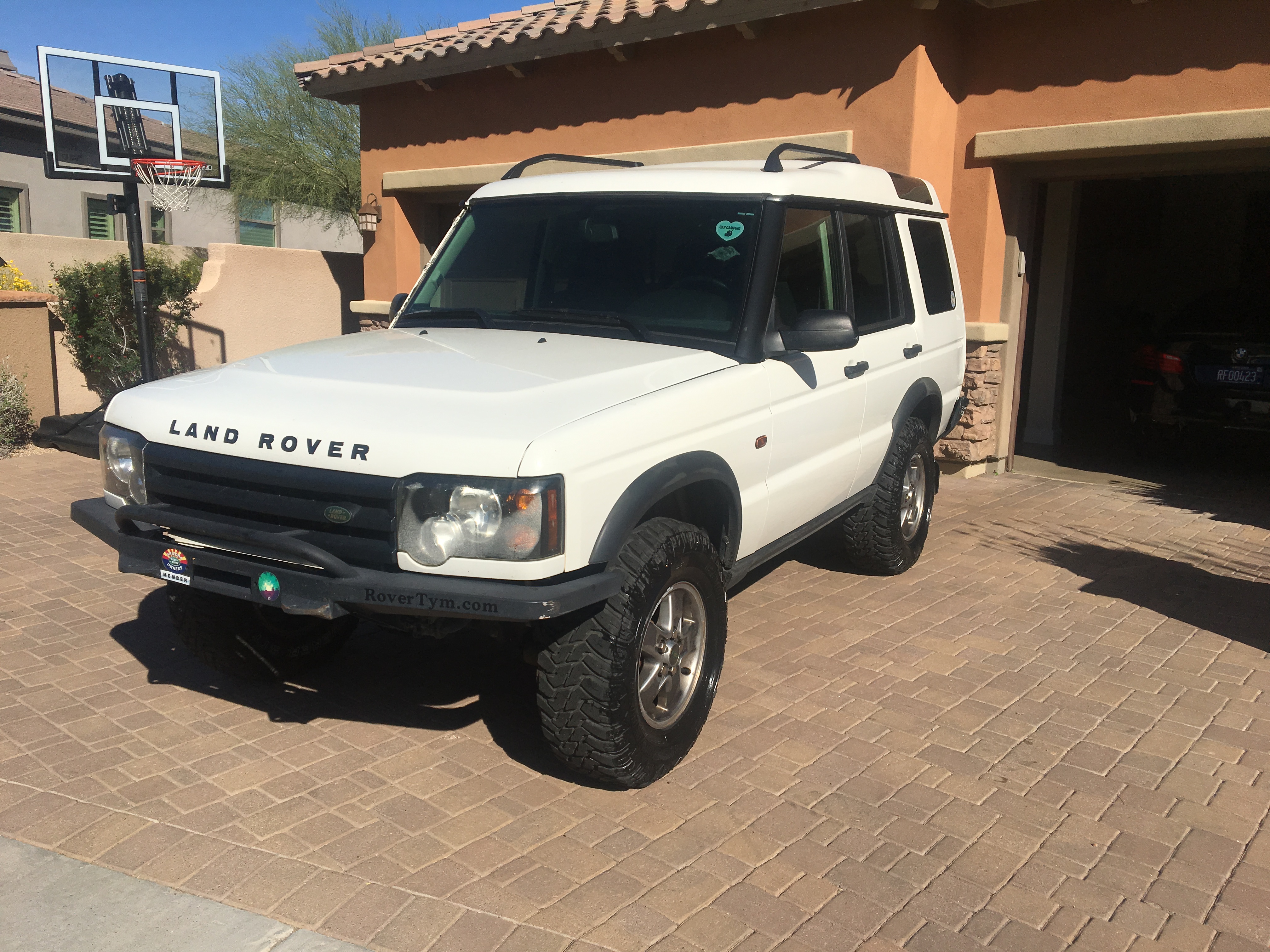

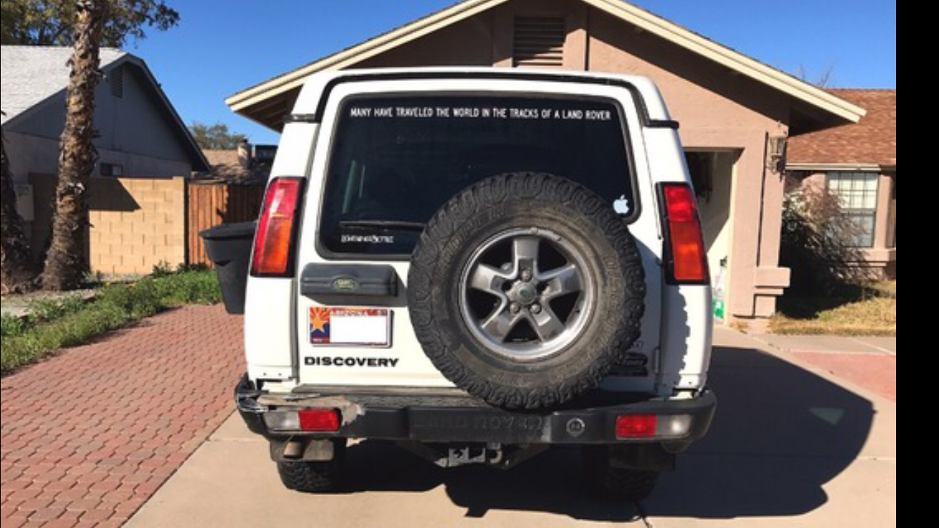

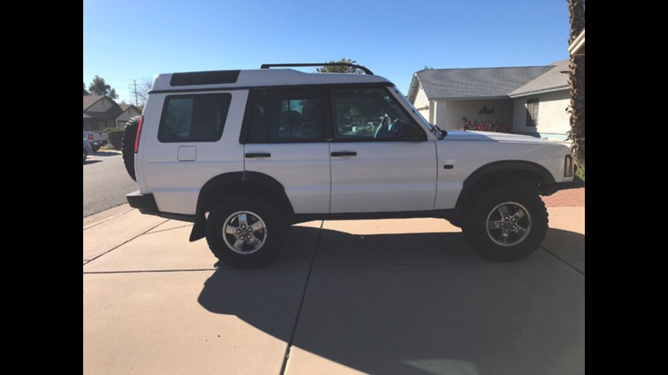

Last week, I had the good fortune to bring home a Disco that ticked the boxes and provided a solid foundation for my light build. Found it online from the original owner who drove it off the lot in 2003. He was a young man when he left the lot and it's had a life of love and use - which is perfectly fine and what I was looking for.
Basically, I will use the disco for 4-5K miles per year for fun, local commutes to ball games, off-roading, camping, etc. Not going for a showroom model.
The starting point - a few great things already finished.
The good:
- 2003 Disco II, 145K miles, S (no leather but the leatherette is in great shape)
- Chawton white with Kalahari 16" wheels
- Rover tech installed 2004 transfer case with CDL (pending lever)
- Rover-tym front bumper
- 5 Nearly new 265/75/R16 Cooper Discoverer STTs
- CB built in, with external tower
- Gasket replaced 25-35K miles ago
- New brakes/rotors all around
The bad & ugly:
- Broken rear bumper
- Some body damage on rear quarter panels
- Enough dog hair and dirt inside to plant a garden & knit a sweater
- Broken right mirror
- Missing right windscreen cover
- Severe weather and sun damage to external plastics
- Front driver and passenger door lock actuators seem stuck but the key works fine
- and of course I need a new headliner
I've taken care of a few cosmetic items and will post more as time goes on.
Starting point pics:

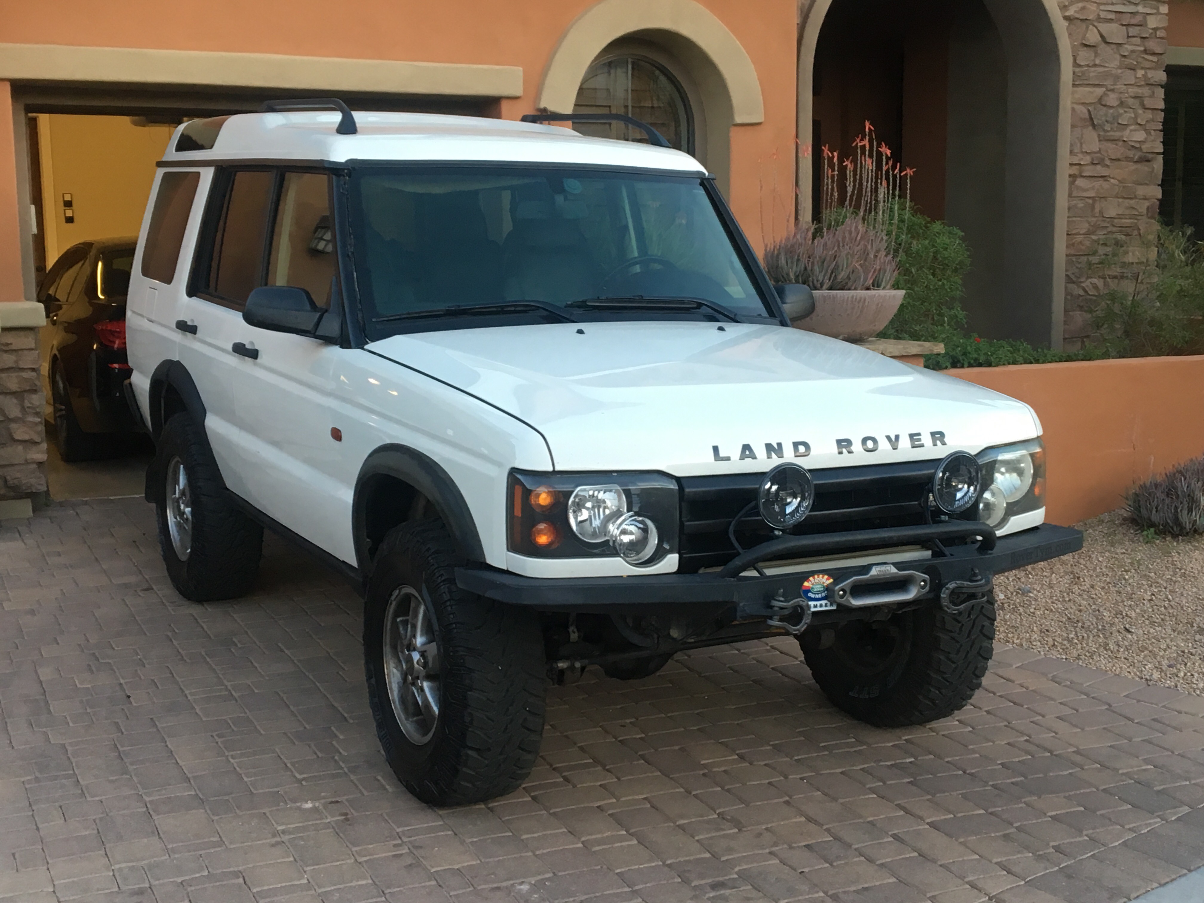

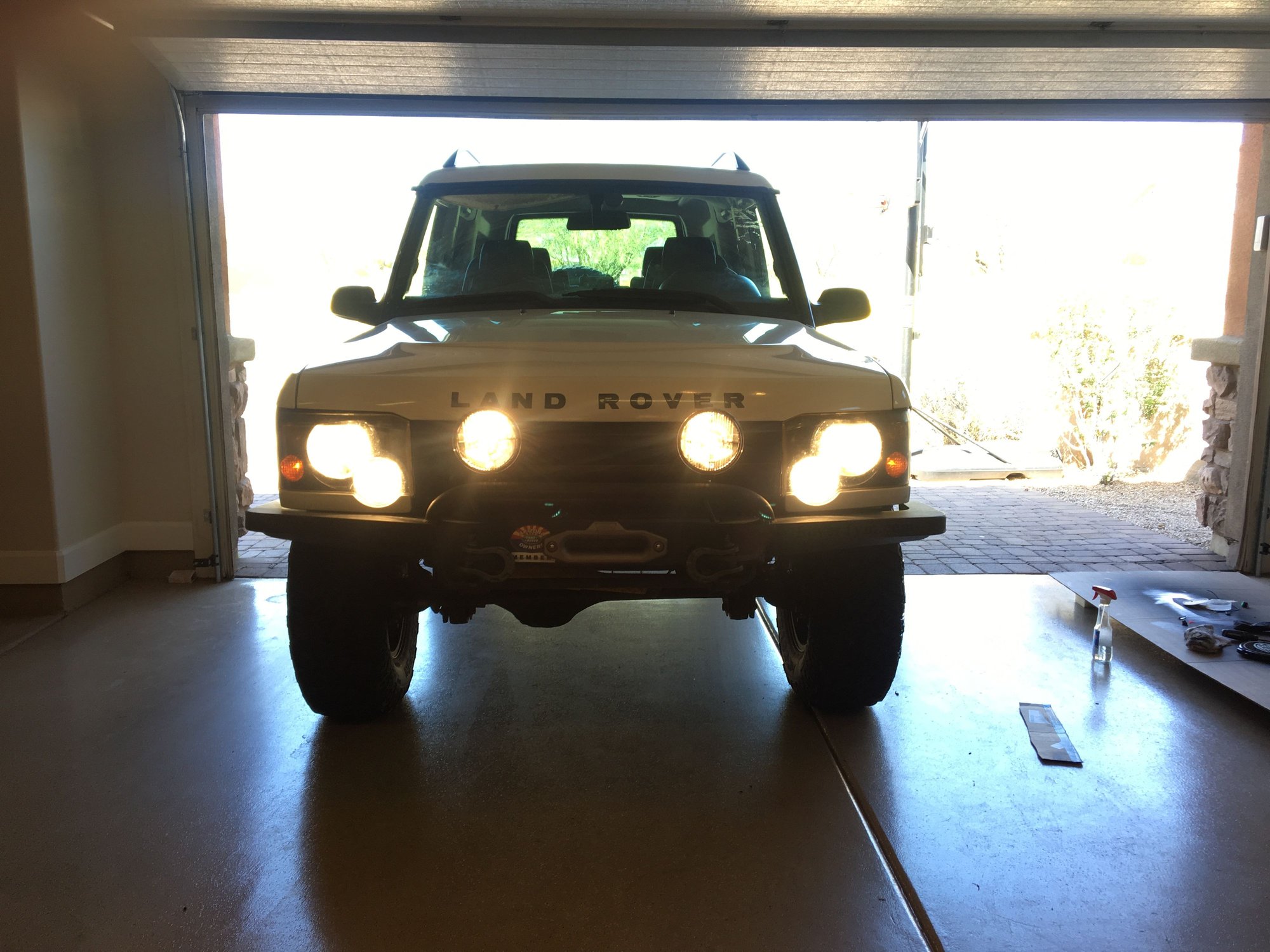

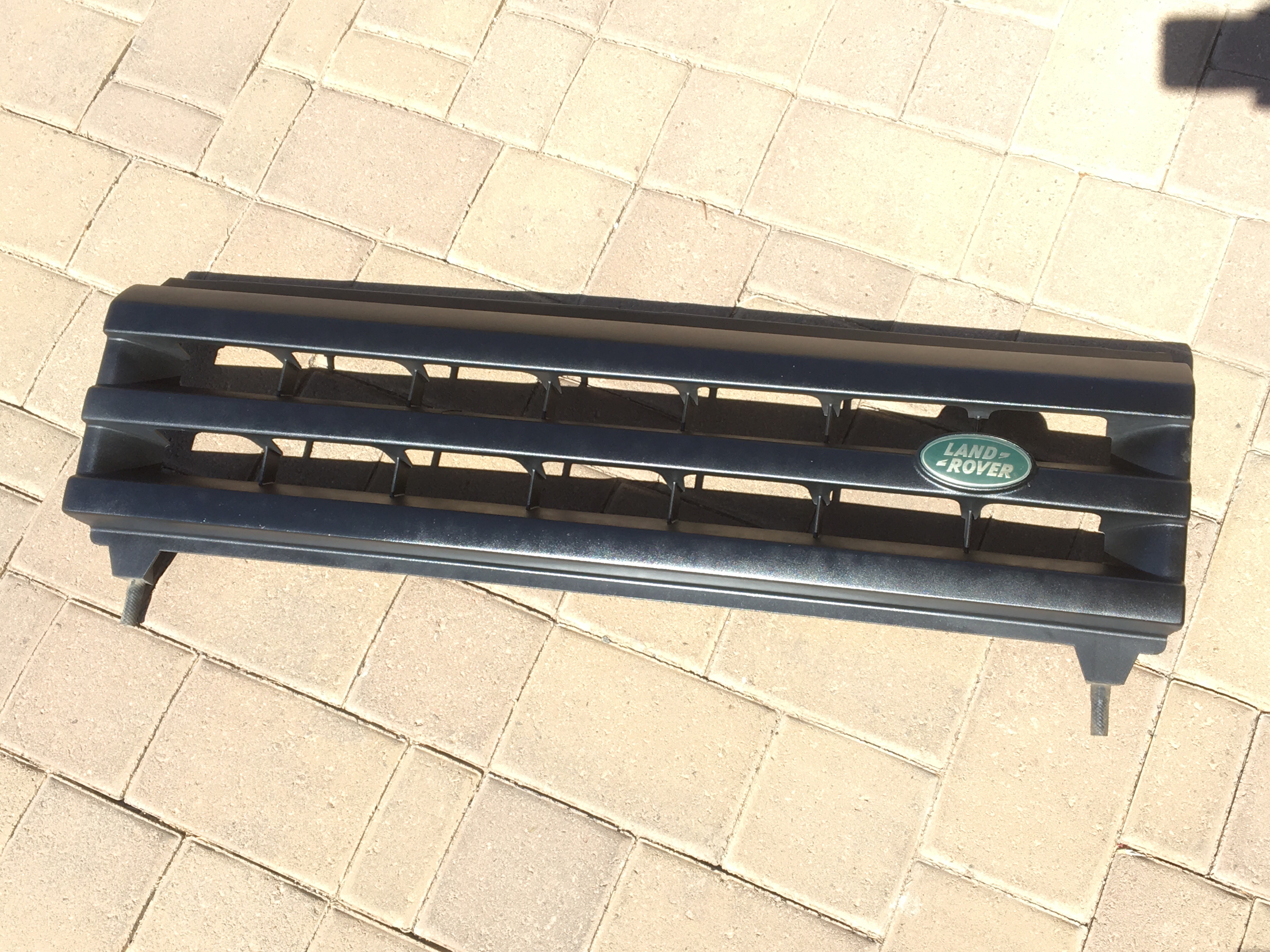

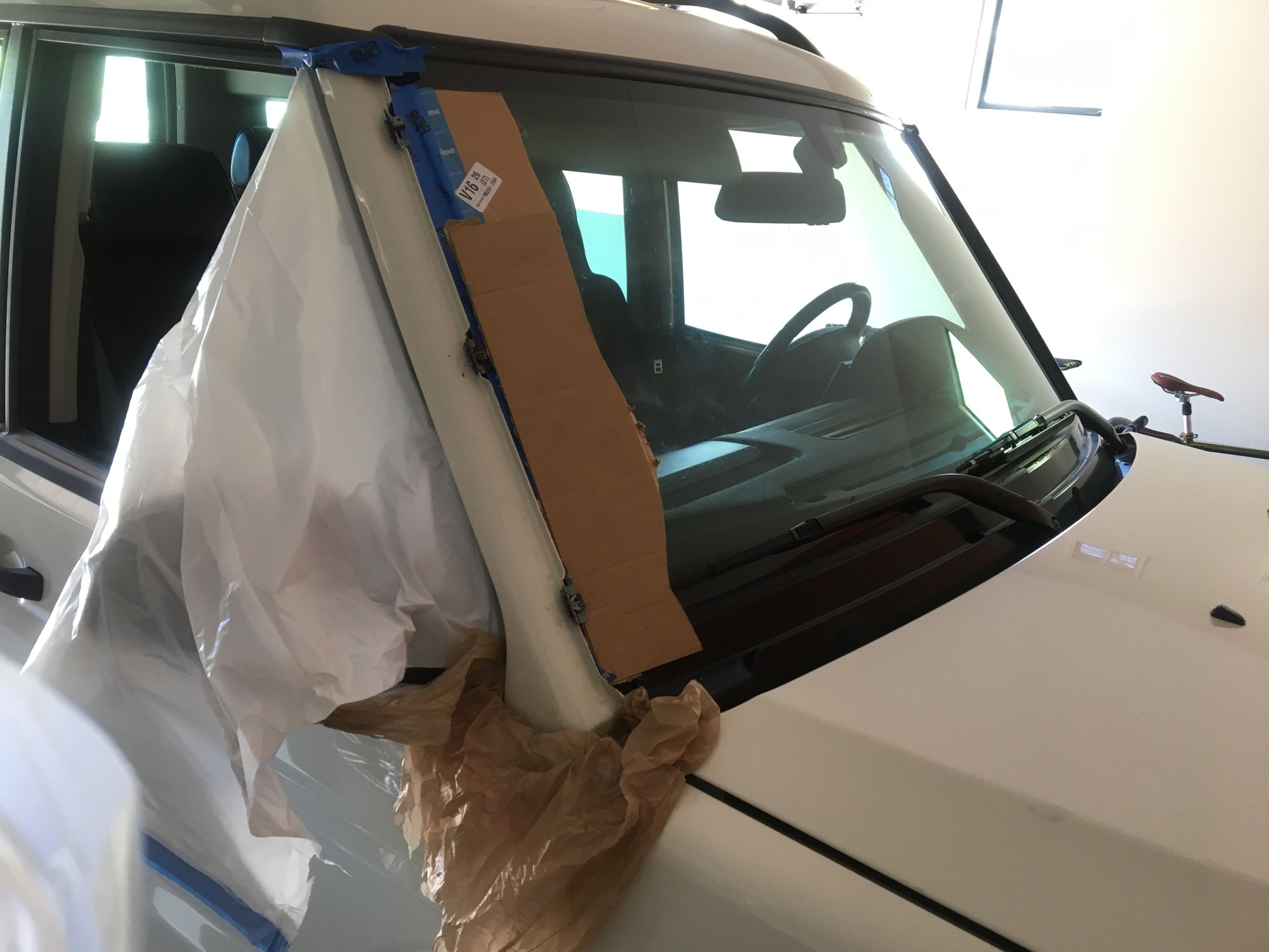

Spent a lot time this weekend doing a few items that were needed. Cranking out a lot of cosmetic tweaks and fun, quick impact items. Having a great time wrenching on the disco
- Driving lights: Installed Hella black Magic lights - I like the blacked out look when off, no effect on lights when on. Wired them to pop on when with high beams - a bit trick but easy once you find the high beam wire.
- Fixed CB - negative cable was broken, positive jammed into fuse box (?) wired directly to positive input from batt to fusebox.
- Sprayed external plastics with 3M rubberized under body sealant (good idea? Anyone done this before?). Looks great and gives a new plastic look to the trim.
- Painted grill - didn't think would make much of a difference but looks good.
- Painted right front windshield pillar (missing plastic cover and don't feel like spending $130 to order one - looks good for now.
- Warn Hawse Fairlead installed - Pending winch and couldn't look at that gaping hole in the front bumper.
- Warn 9T shackles
Next:
- Install Atlantic British rear bumper - arrived
- install TerraFirma Fender flares once they arrive.
A few pics of progress thus far:

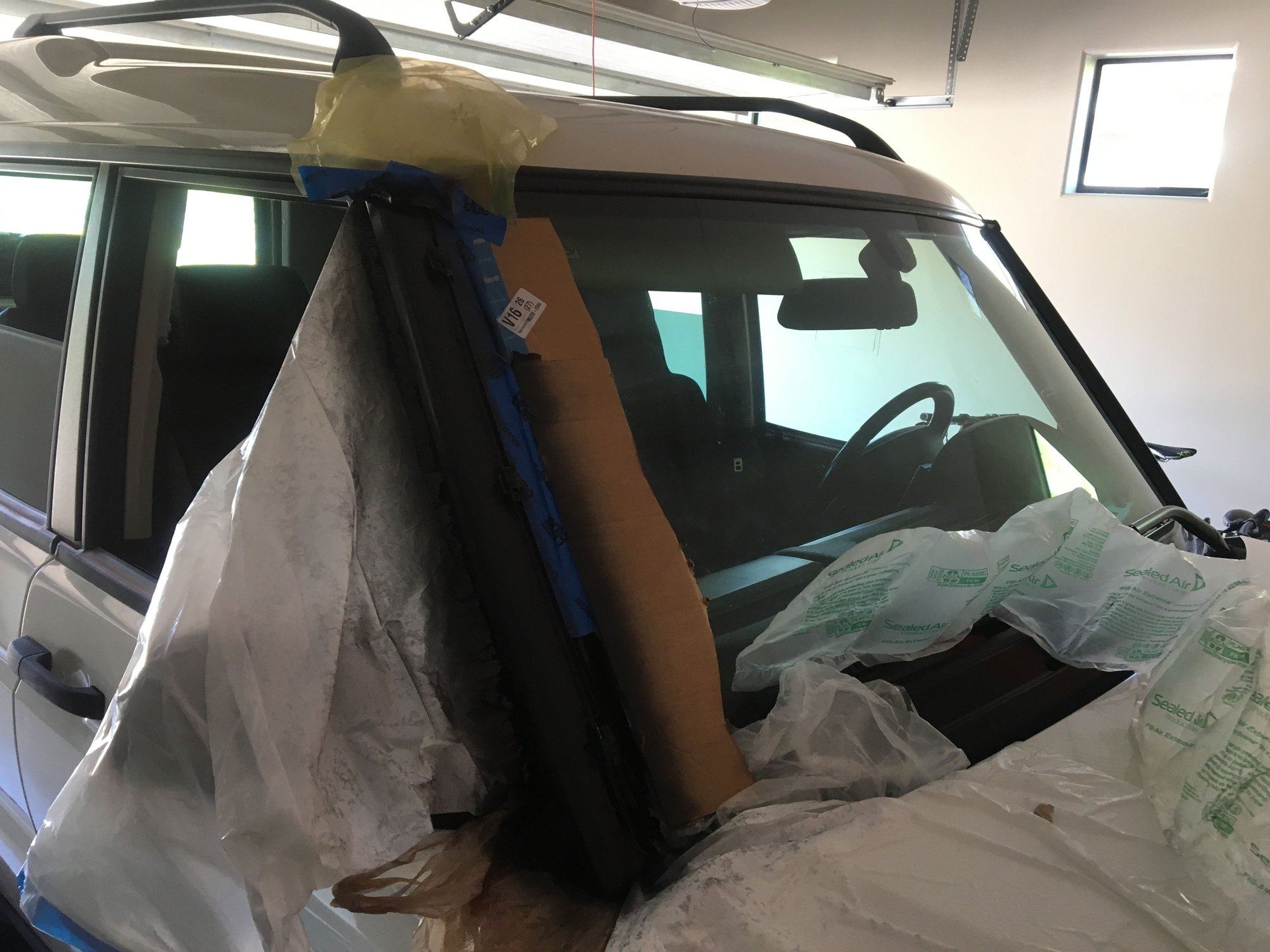

- Driving lights: Installed Hella black Magic lights - I like the blacked out look when off, no effect on lights when on. Wired them to pop on when with high beams - a bit tricky but easy once you find the high beam wire.
- Fixed CB - negative cable was broken, positive jammed into fuse box (?) - wired directly to positive input from batt to fusebox.
- Warn 9T shackles
Next update:
- 3M Hood vinyl
Attached Thumbnails 2003 Disco Build Light-file5.jpeg   2003 Disco Build Light-pillar-2.jpeg   2003 Disco Build Light-pillar-3.jpeg   2003 Disco Build Light-grill-1.jpeg   2003 Disco Build Light-grill-2.jpeg

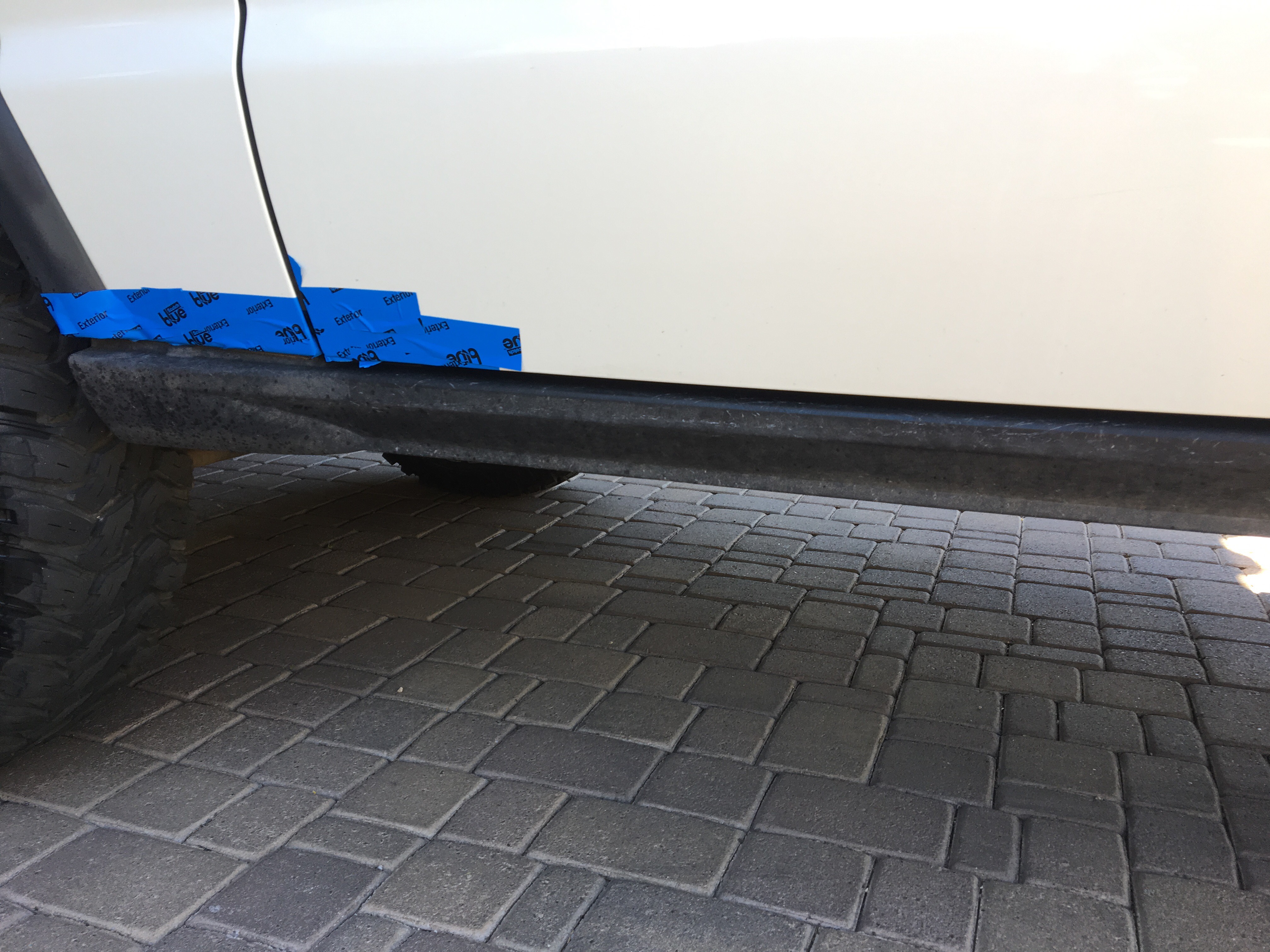

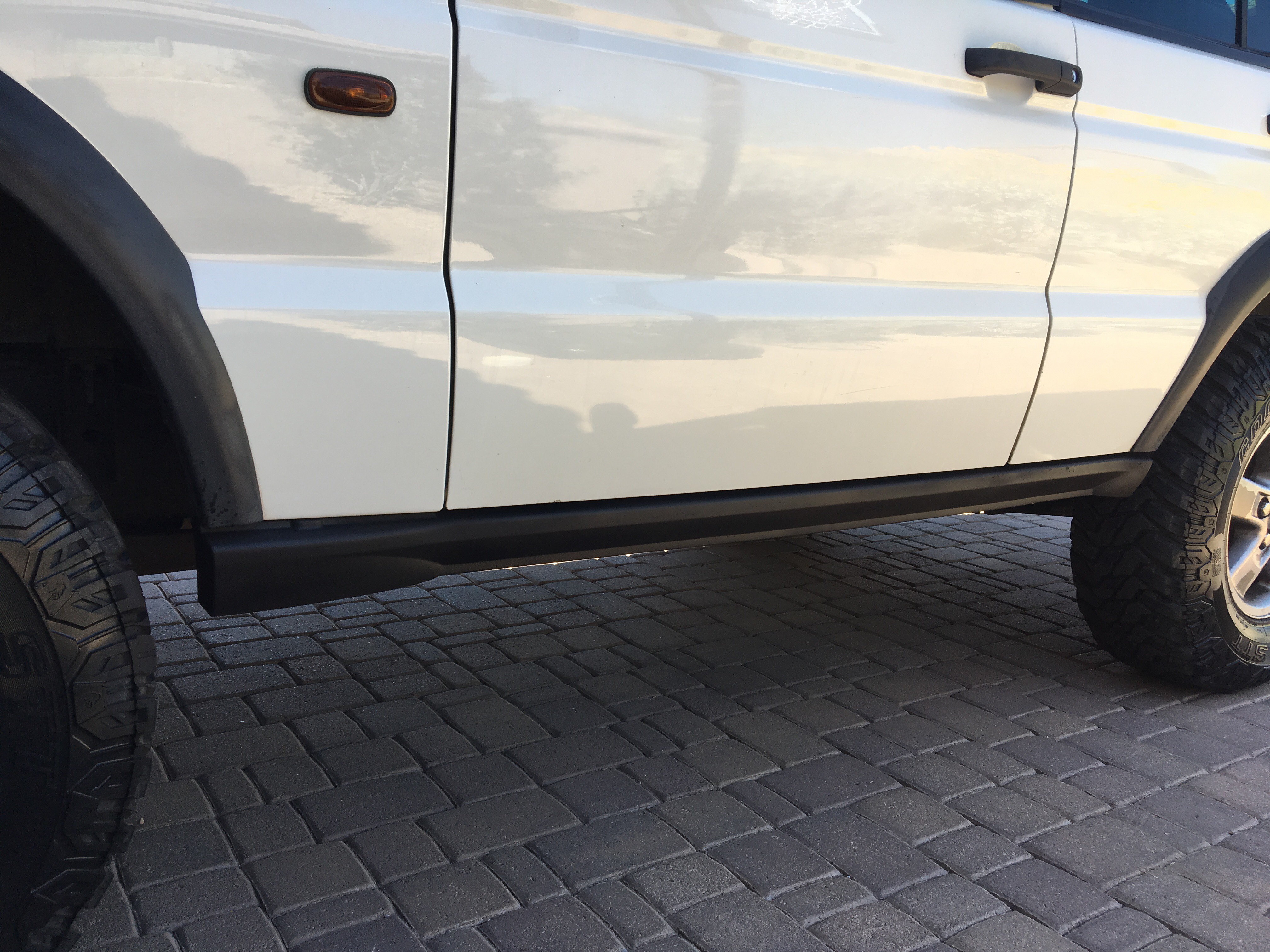

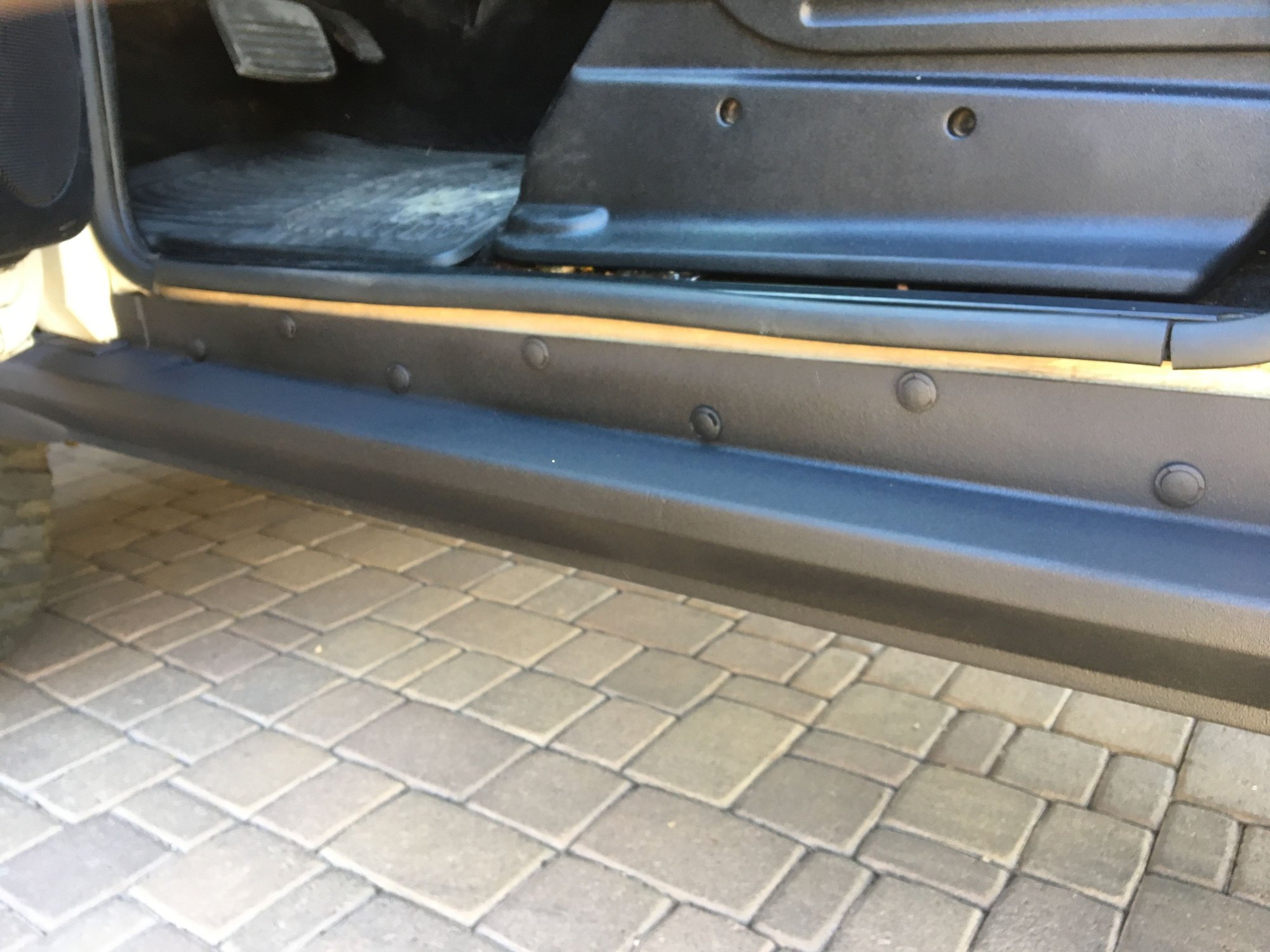

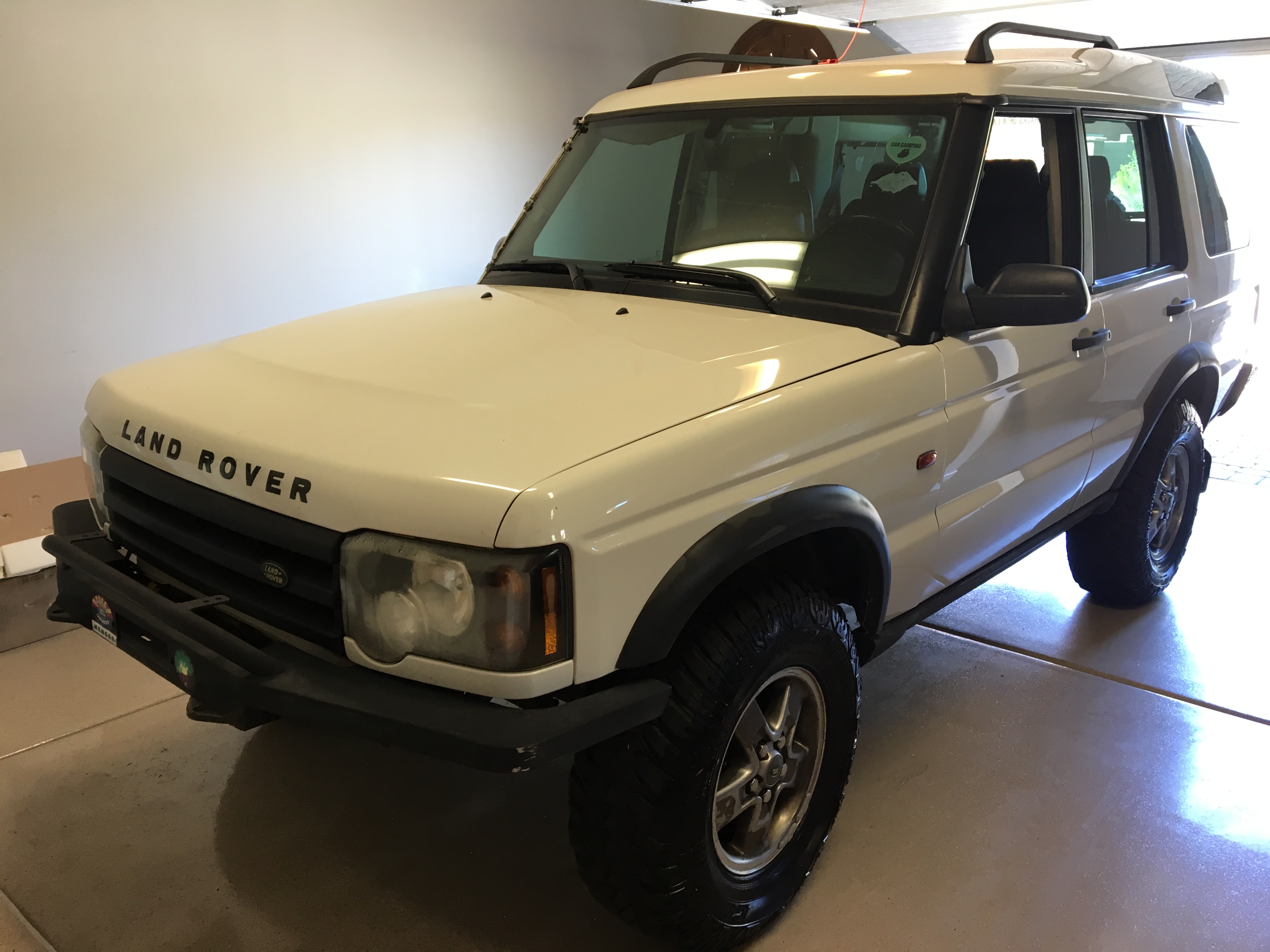

Cleaned and sprayed trim with 3M undercoat - Anyone else try this? Looks good, not sure how long it will last but seems solid so far.
Pics - Before & After:
Attached Thumbnails 2003 Disco Build Light-undercoat-1.jpeg   2003 Disco Build Light-undercoat-2.jpeg   2003 Disco Build Light-undercoat-3.jpeg   2003 Disco Build Light-undercoat-4.jpeg

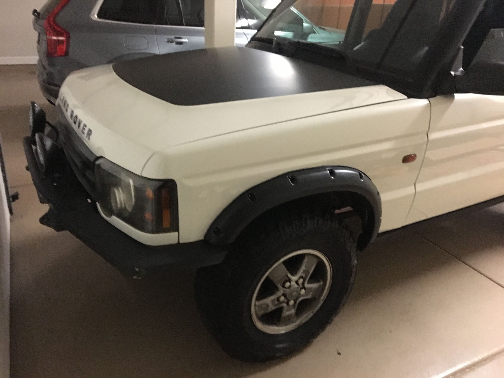

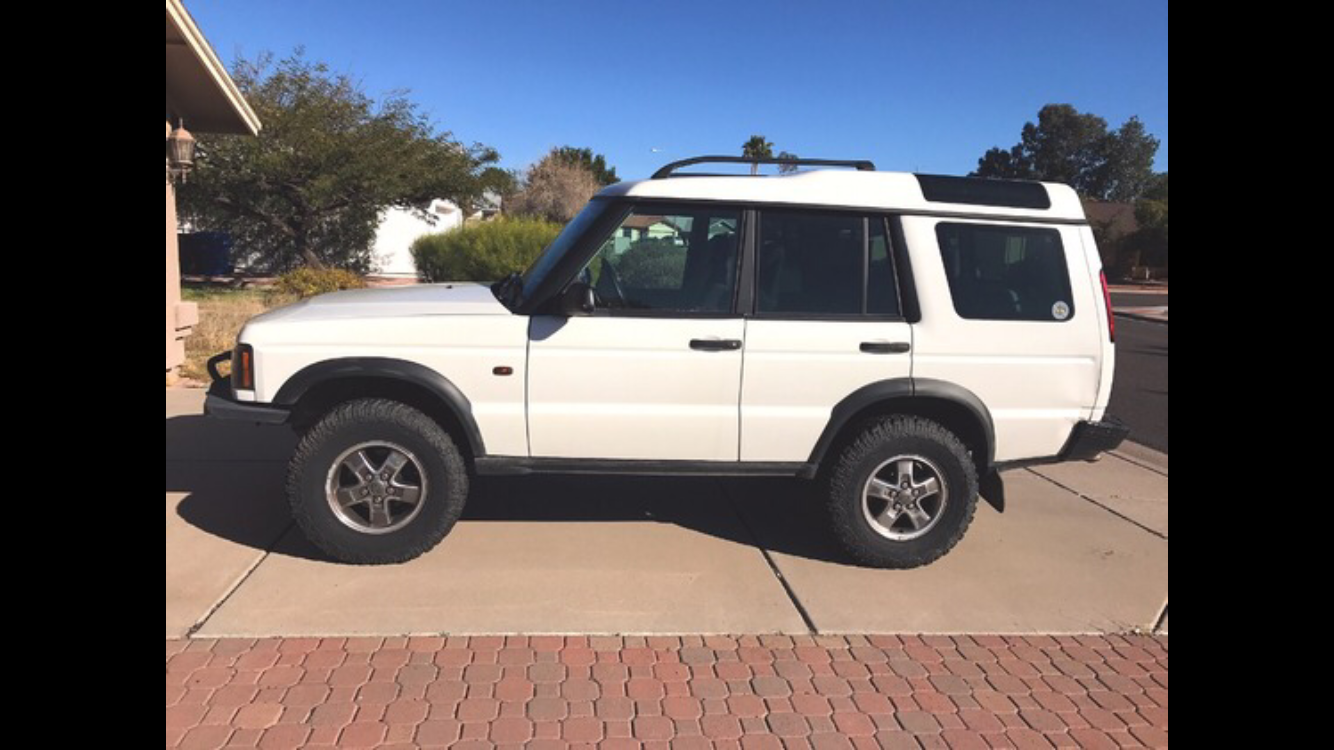

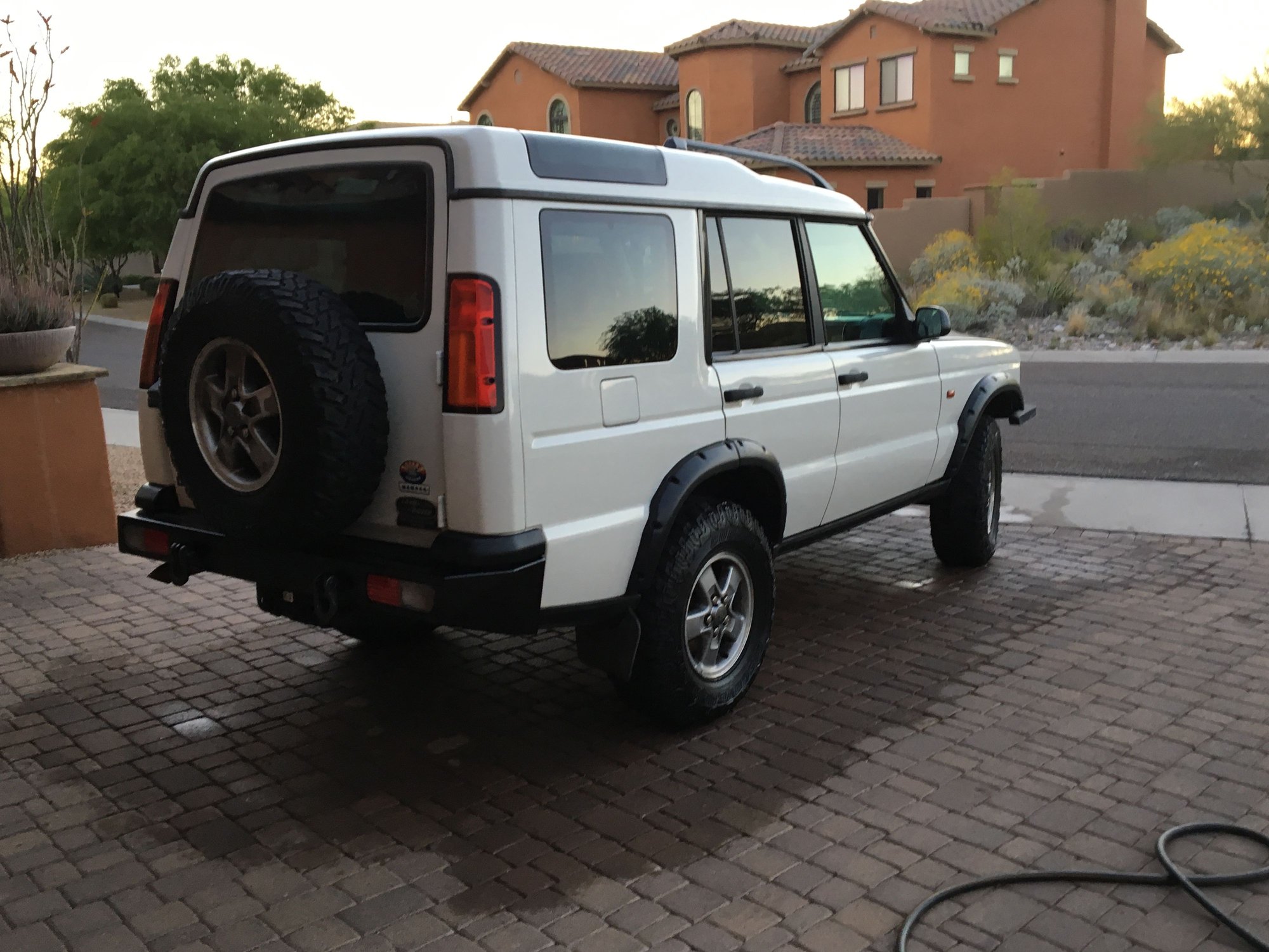

A few key items installed:
- Atlantic British rear bumper - Much easier than anticipated and was a one man job in about 45 min - needed to pry down the hitch a bit.
-TerraFirma Fender flares - this took a couple of hours to pull off the old fenders and and line up/drill the holes
Easy off bumper
BAtlantic British bumper with Warn Epic shackles
3M vinyl hood blackout
TerraFirma extra wide fenders installed
Cleaned and waxed...

Looking good. Did you have to flip or modify your rear wheel carrier to accommodate the large tire?
Brian.
Old Mar 27, 2017 | 03:08 PM
2oolander's Avatar
Joined: Mar 2017
Posts: 49
Likes: 34
From: Arizona
Thanks Brian,
Does not appear to be modified but honestly haven't pulled the spare off the back to look. There is very little room (1 cm) between bumper and 31" tire - just enough so it does not interfere. Definitely would not fit a 33".
