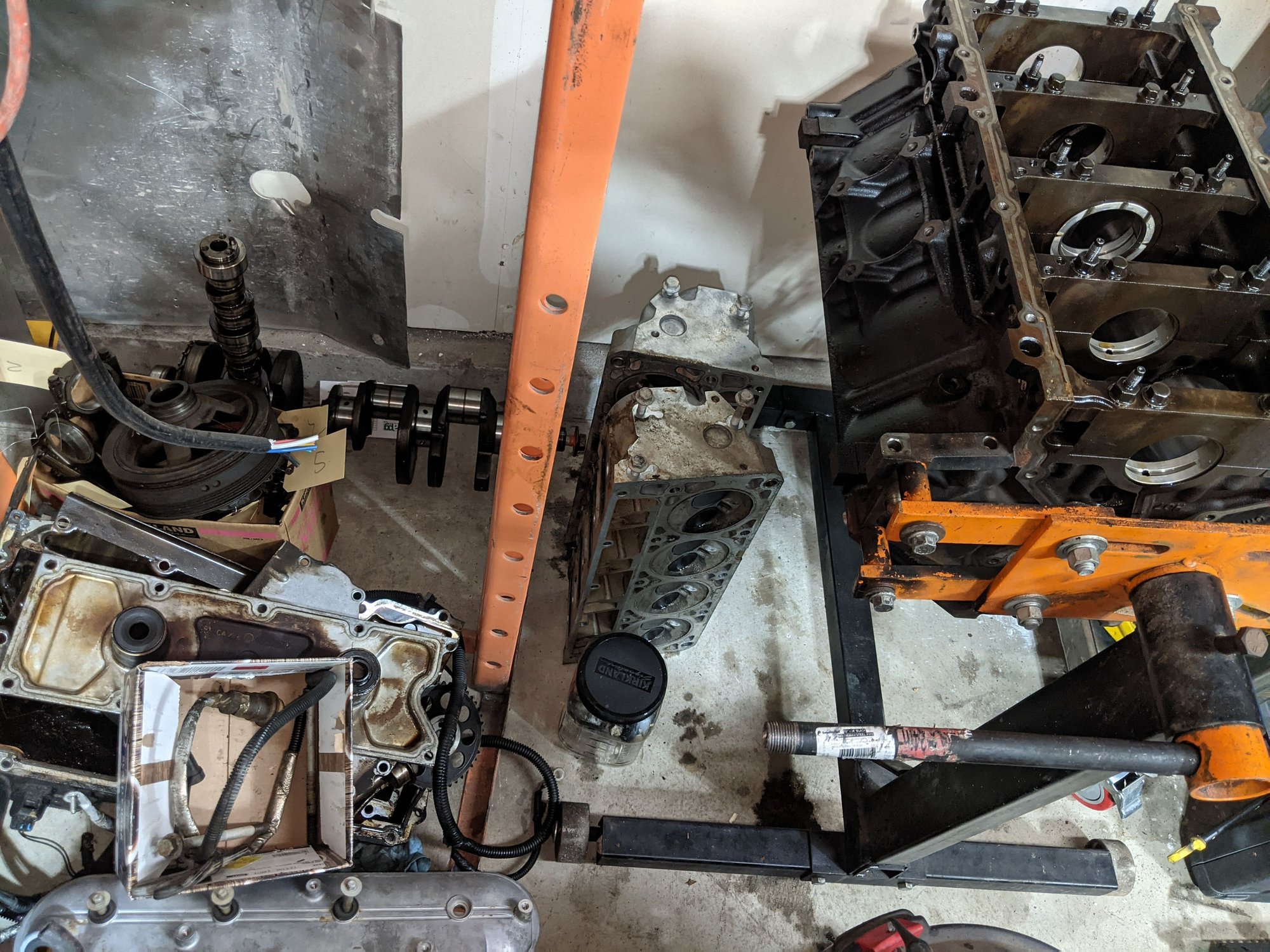

The back two cylinders looked nasty like someone used water to put out the fire instead of an extinguisher. I ran a hone over it and it isn't going to clean up. Looks like a bore is needed. I'll order some flat top 4.8 pistons and get it to the machine shop. The main bearings don't look bad, but I'll replace them and hand polish the crank. The rod bearings look rough and I will replace those too. The cam bearings may or may not fly. I need to inspect them a bit more. Good thing I have a cam bearing tool!
Heads don't look bad. I'll lap the valves and do a gas pour check on them and all should be good. I need to clean the valves and replace the springs with some ls3 springs anyway to work with the higher lift cam. New seals of course.
Tldr engine isn't as clean as the miles would lead me to believe and as clean as I'd hoped, but it makes raising the compression easy enough and I'll have a completely fresh 5.3.
Should be all good for 350hp or so with a bunch of torque down low. I'm expecting to get very familiar with rebuilding transmissions and I need to find a spare one sometime in this whole process before I get too throttle happy.
Pictures added for geeky motorheads that like engine part shots. The offending cylinders not shown in great detail and my pile of engine parts.

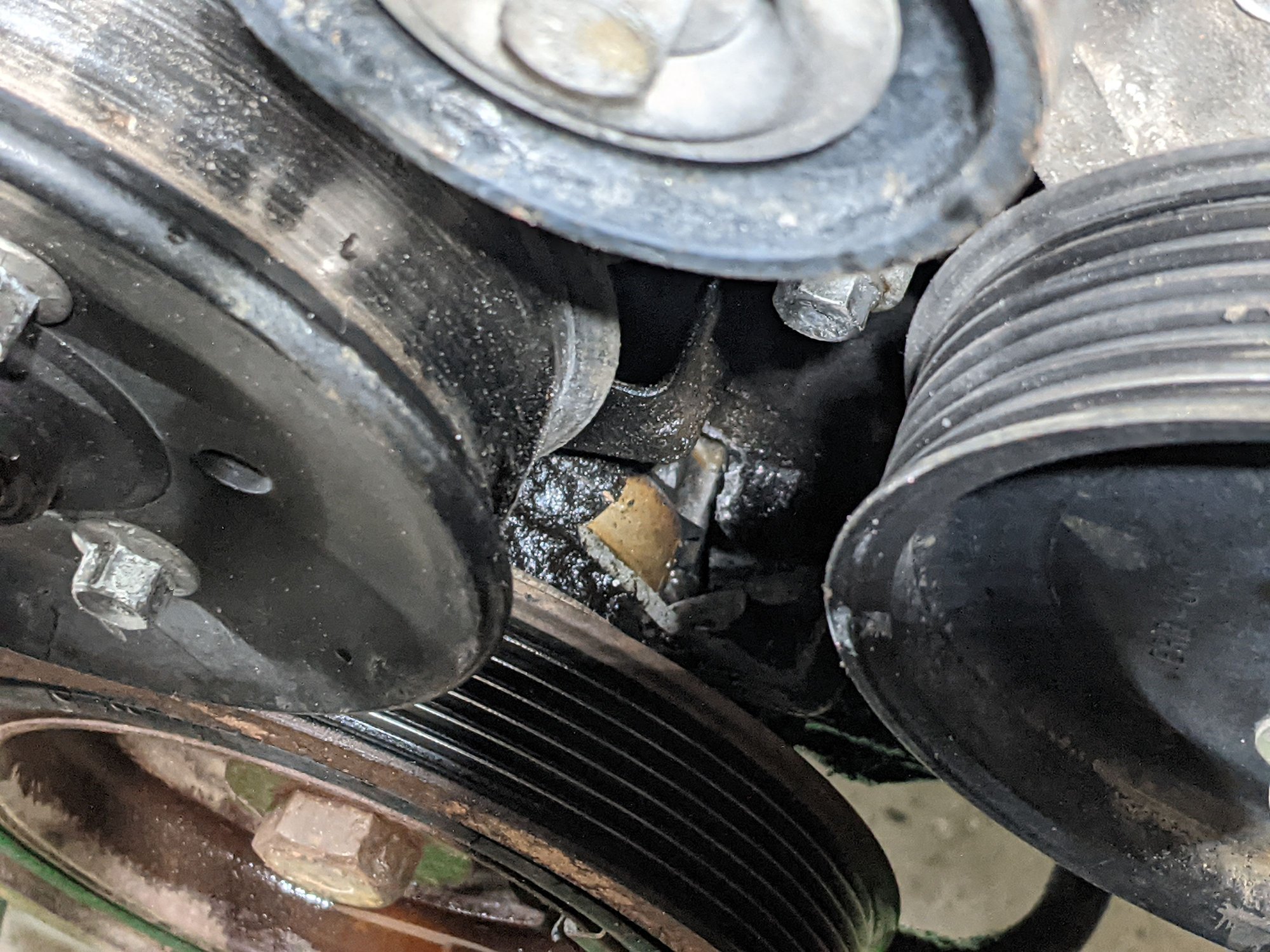

Don't think anyone is listening, but this is interesting. I think I found out why my oil pressure light was on and why my engine had a bad knock.
Also... I guess I need to pull the oil pan to remove the torque converter bolts? That's the only way I can see getting them. No inspection cover gets me close.

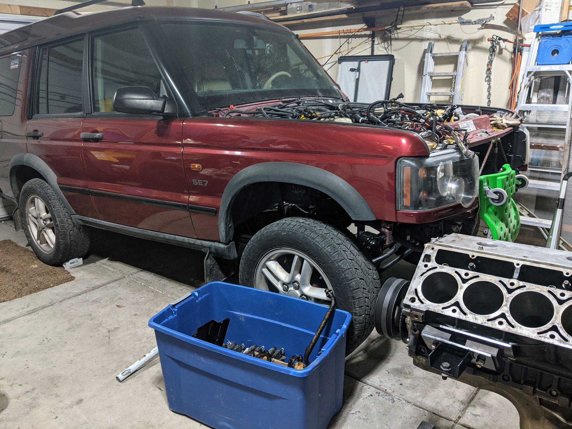

Waiting on my block to get back from the machine shop and I decided my front bumper wasn't in good enough shape to keep rocking with the shiny new engine.

Waiting on the machine shop. Thinking I'll try and take the vats off the pcm myself using a free program and LS driod or similar. I guess I'll cross that one later down the road. Engine bay is pretty clean though. Ls swap bellhousing is on too.
