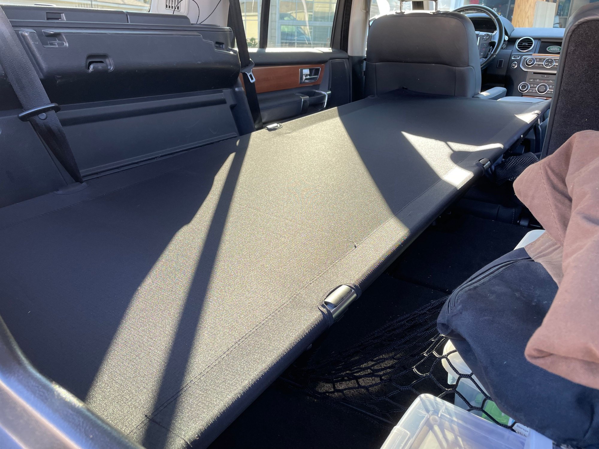

I have started figuring out how to setup my LR4 for overlanding and camping. I am moving away from my RTT largely due my and it's age.

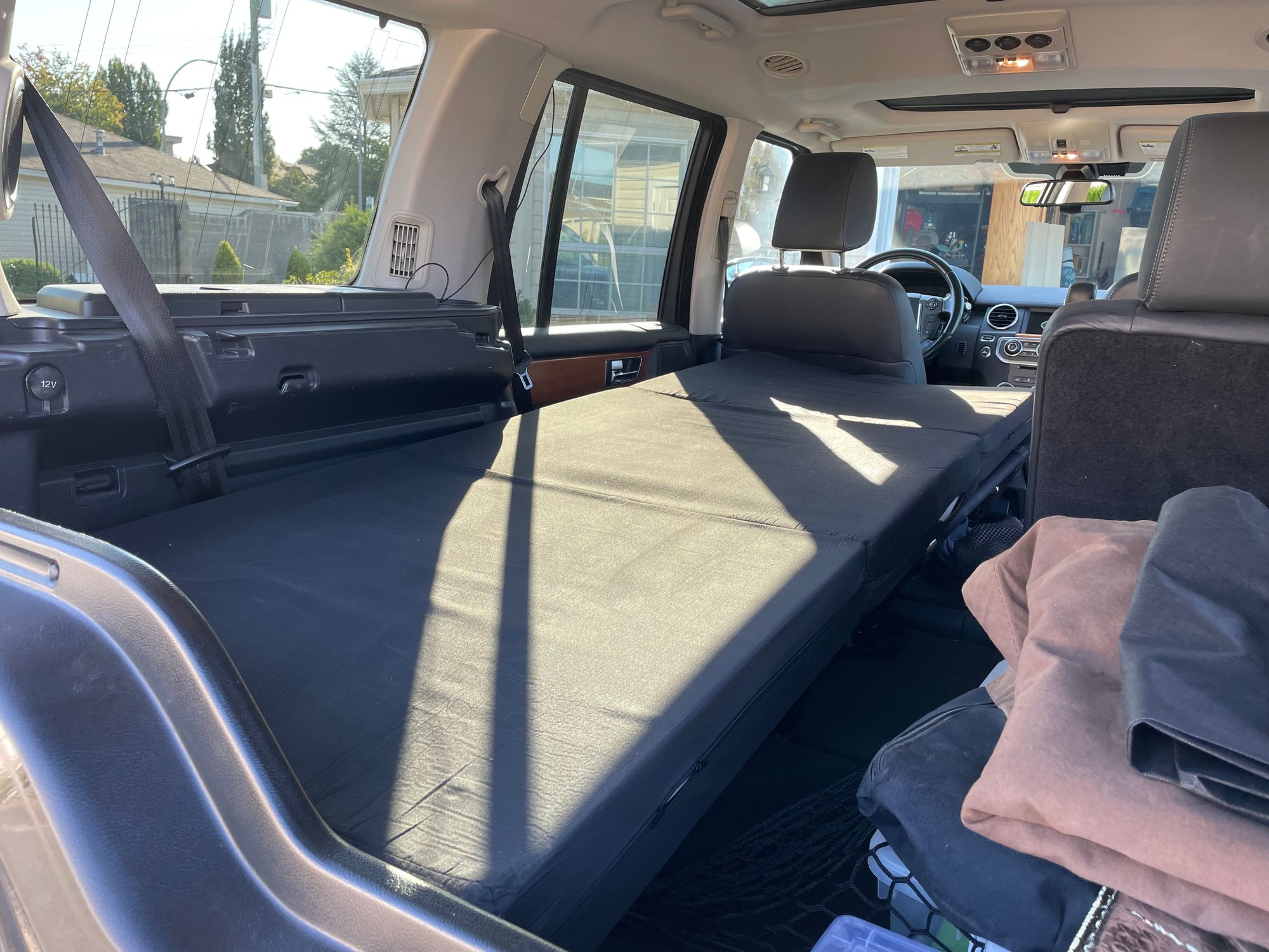

1st up inside sleeping
100.00 CDN Cot from Amazon (72 inches long)

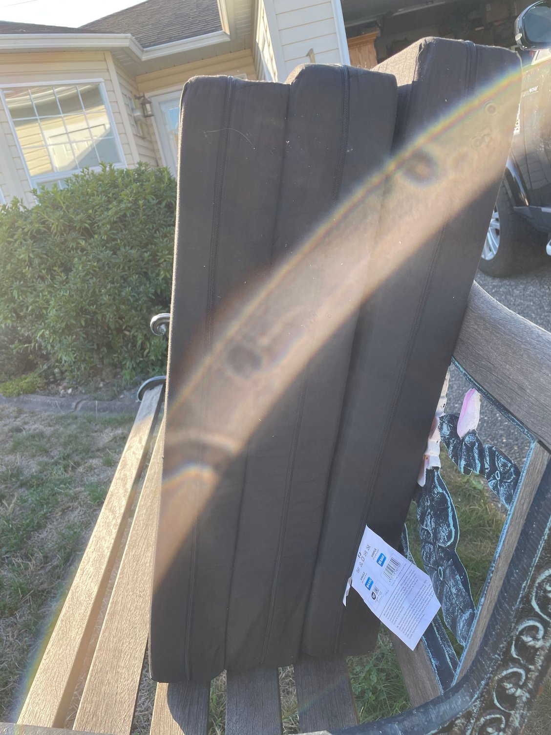

100.00 3.5 inch foldable mattress 100.00 CDN at JYSK 72 inches long.
Mattress and cot

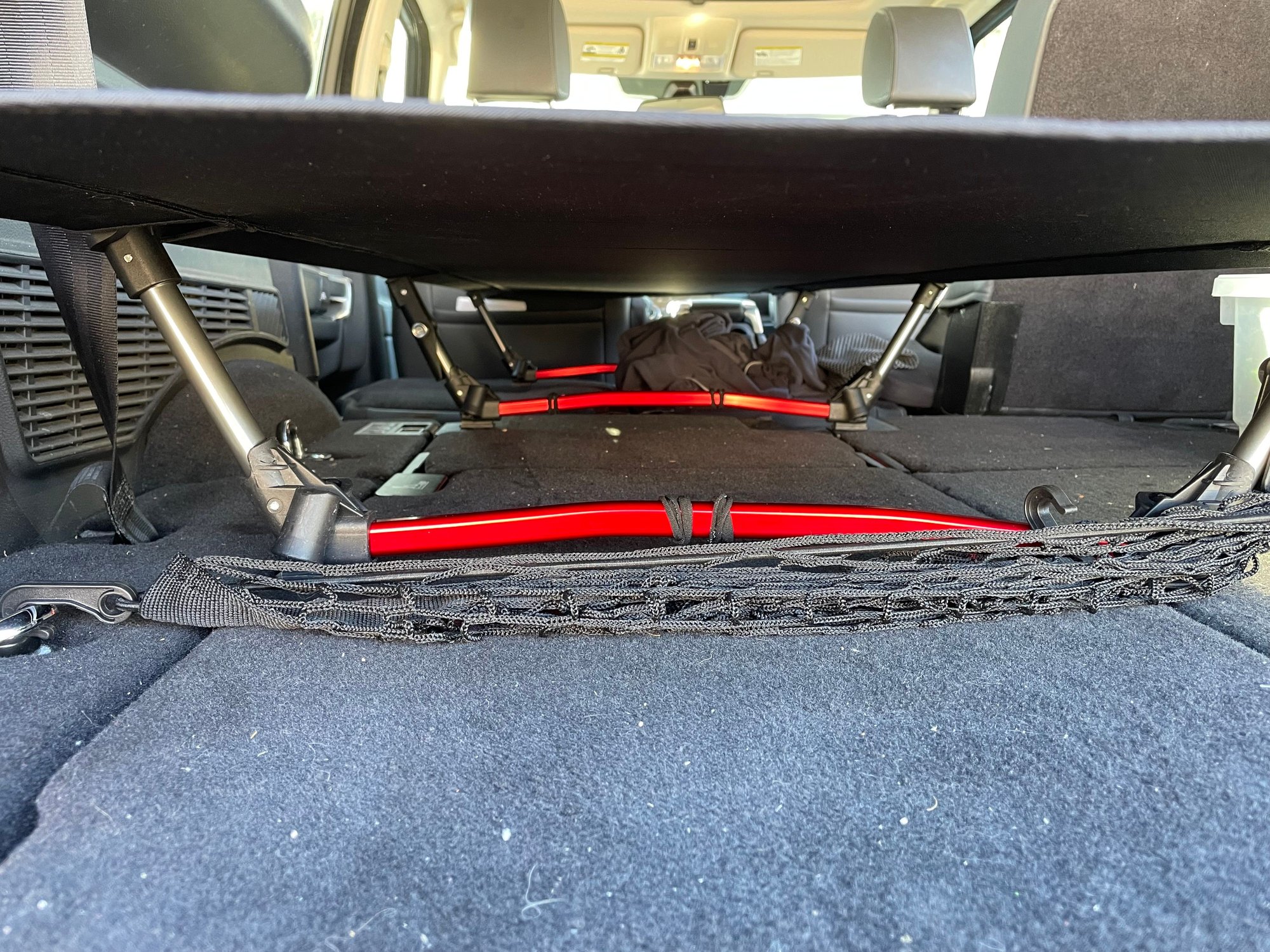

Underneath Cot
Underneath Cot

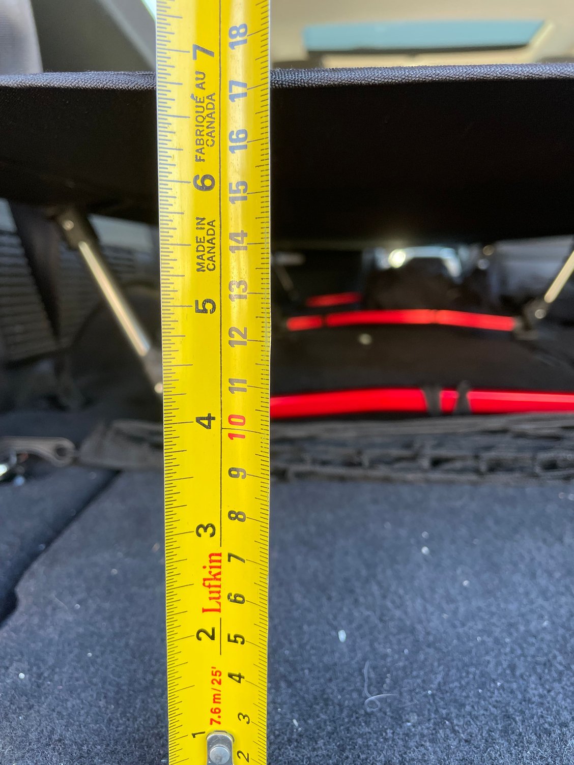

Height Measure
Height Measure
Mattress Folded
Mattress Folded

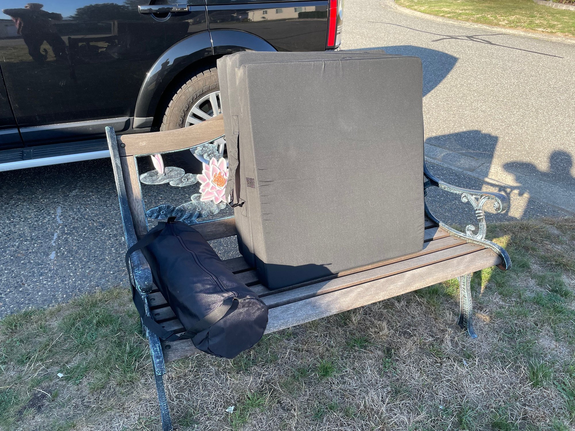

Cot put away and Mattress

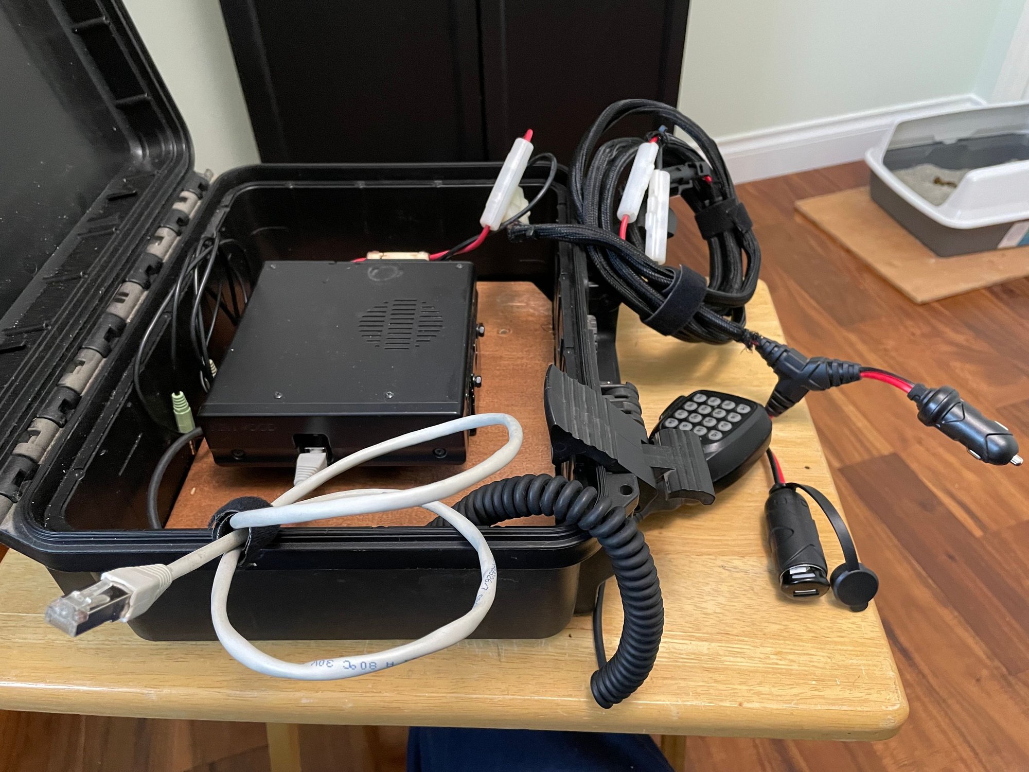

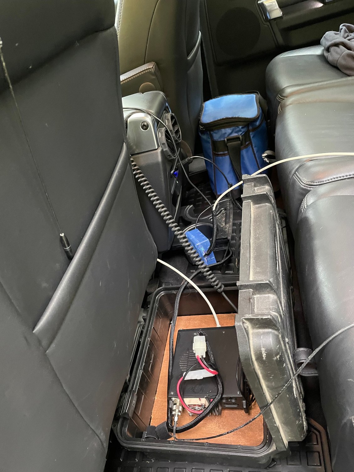

Next up is VHF radio install. Getting power to the cab in these is very difficult in the SCV6, so I decided to go with a radio in Pelican Style Case and run the power off the cigarette lighter as that is 30 Amp circuit. This setup worked perfectly on a 10 hour drive.
Here is everything in the box
The GPS for my APRS this is the only thing that I am having trouble locating, at this point it is just going in cloth screen that covers the rear sunroof.
Everything out of the box
The radio head goes is attached to a cup holder mount for a cellphone, I screwed the back plate for the radio to cellphone.
Radio head in location, it can also go into the rear cup holder
Radio stays in the box and just sit behind the drivers seat, once I get the fan installed it can be closed and sit up right.

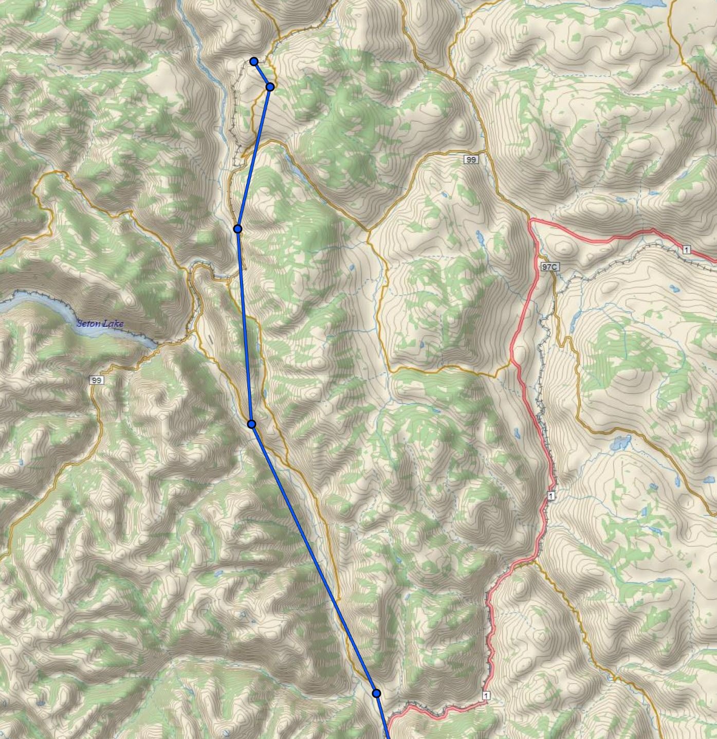

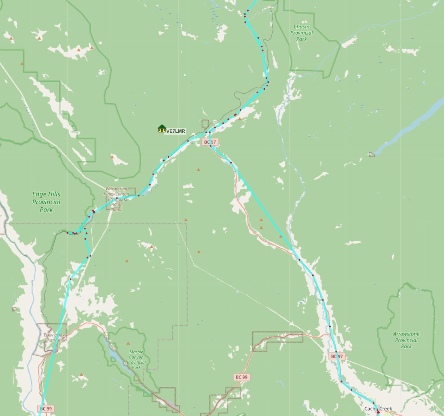

First up APRS

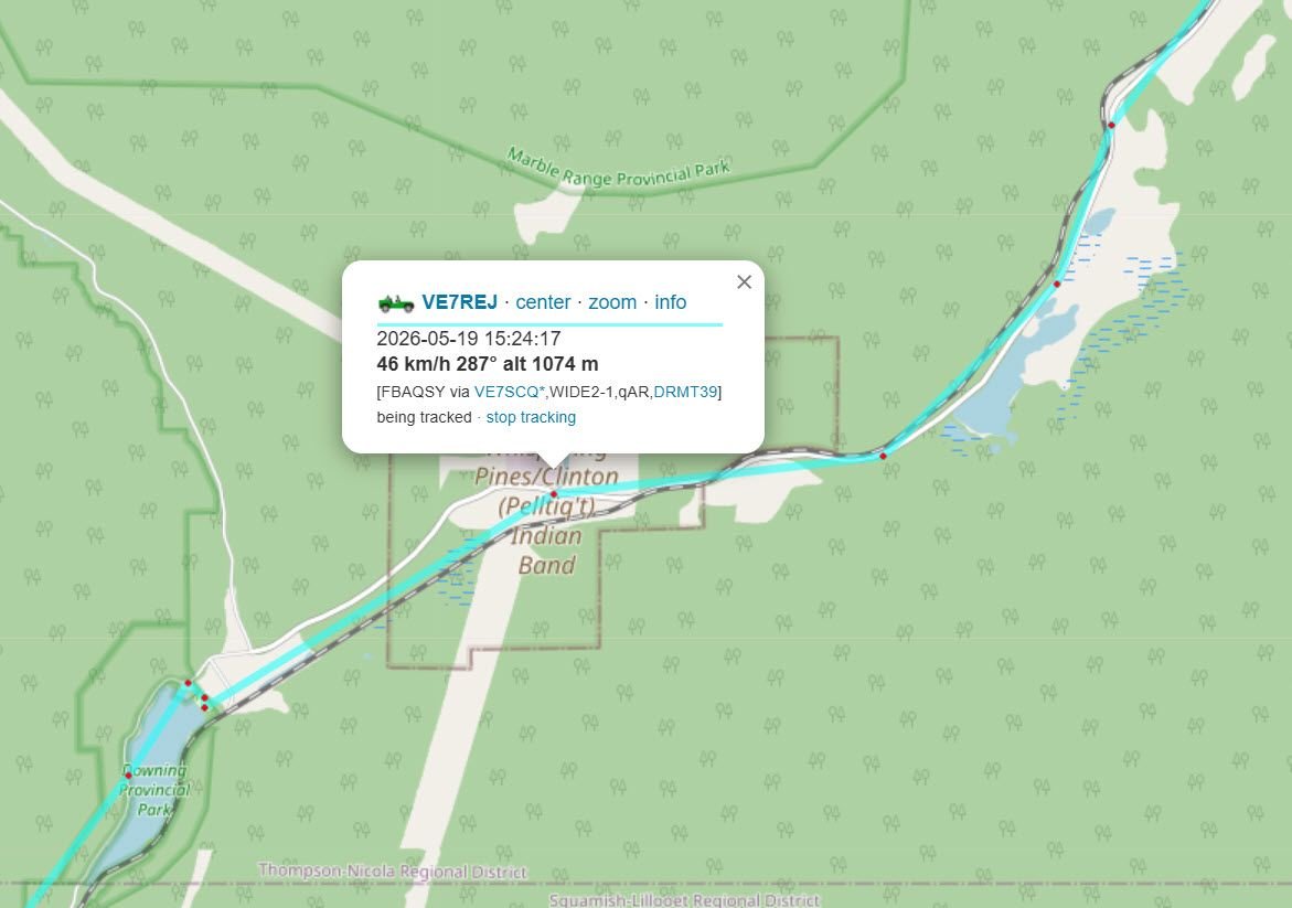

The red dots are tracking points as I traveled, the radio simply sends when it has a connection and after a short time between each point. I run a 4 foot antenna up top of LR4 which gives me excellent range, the shorter 18 inch is far less effective for this.
The lookup is simply at Google APRS, type the in the callsign and date range and off you go.
You can get more detail by clicking on one of the red dots.

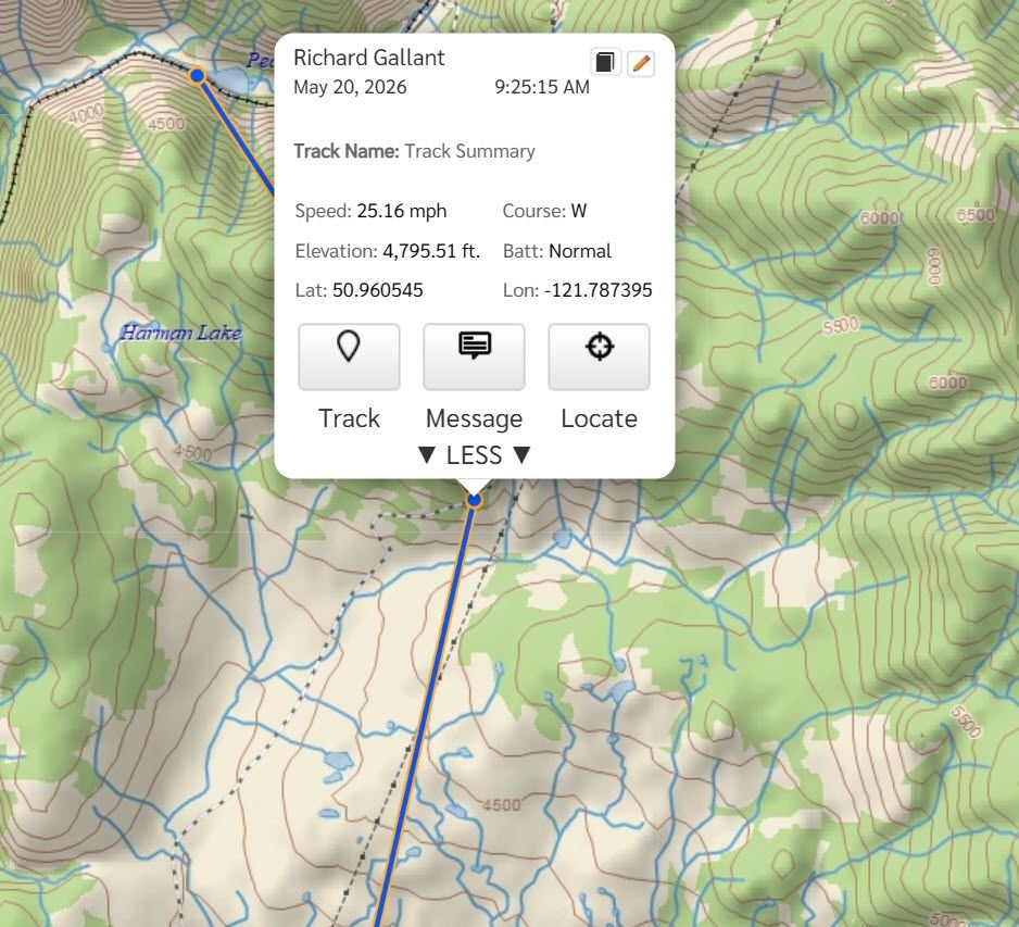

The Garmin in reach has similar functionality but as I go with the cheap plan each point has a cost so I limit it to every 30 minutes. The cost is not terrible 15 cents per point but it adds up fast if you are out for multiple days. The options range from 10 minutes to 4 hours.
On long solo trips well of the beaten path I go to 10 minute which runs about $9.00 a day, which keeps my wife happy., otherwise every 20 minutes, which works out to 4.50/day.
The Garmin map is better.
The Garman detail info is easier to use than the APRS as it show the location right in the point into, on the APRS it is in the upper right hand corner, so a little more complicated.
