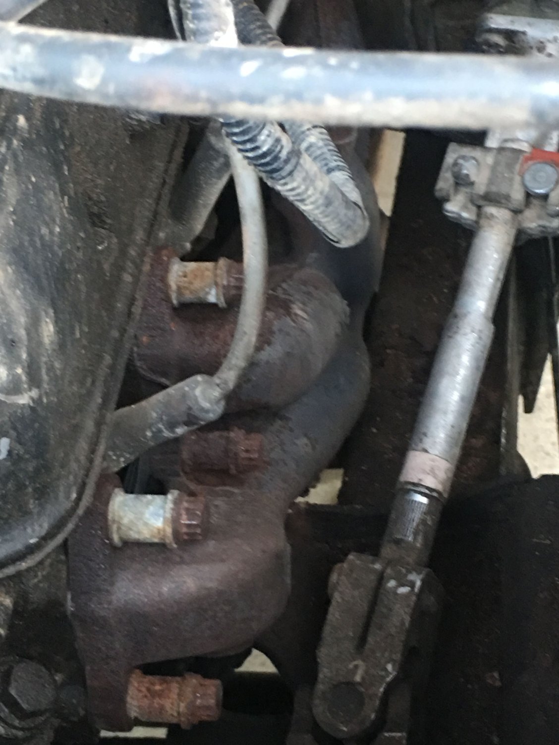

Had time to remove the old driver side exhaust manifold, and what was left of the gaskets. I had a spare 04 exhaust manifold ready to go, so I installed it with all new gaskets, and I used the D2 exhaust manifold bolts vs that crap that was on there. Drivers side is now whisper quiet and I’ll attack the passenger side next when I have some more free time.

Had to tap the socket onto a few rusty bolts on the exhaust manifold. Finished the passenger side as well today. Nice & quiet now.

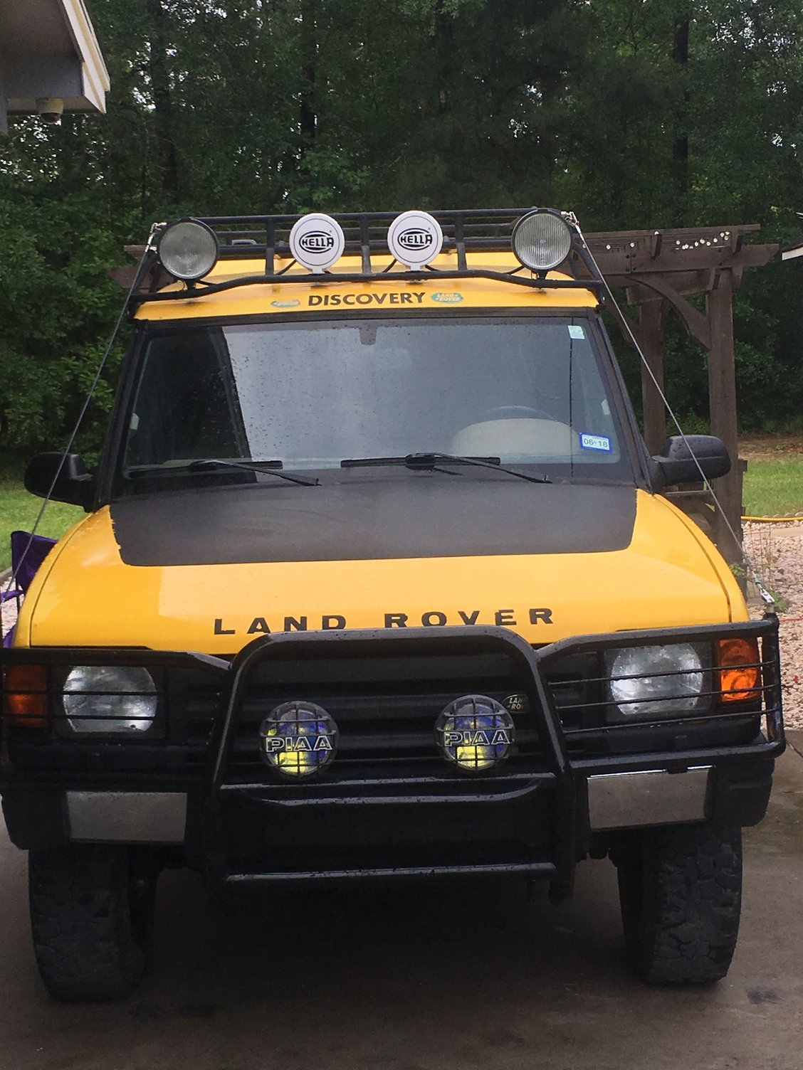

I installed some perfect condition spare bumpers I had off my 98 LSE. Yes they are chrome & yes I am using them. To any XD perfectionist I am sorry, but the stock bumpers on my XD were completely trashed F/R and IMHO looked far worse vs perfect chrome ones. I honestly have always liked the chrome bumpers on a well kept LSE or RRC. The LSE front bumper had it's center plastic piece (XD unit didn't have one), so I cleaned it up, then used a heat gun on it to bring back a nice black color vs faded grey. I did the same thing to the rear bumper end caps and they look much better vs faded grey.
I'm saving up for the Pro Comp ES9000 Shocks as we speak. So far I haven't dumped any extra $$$ into this XD. Everything I've done has been with stuff I have in my shop or from my parts D2. I'm going with a pair of 3inch Rear Shocks (going to use them in the front with D2 shock towers), and a 2inch pair of Rear Shocks in the rear. That should give me the same amount of travel, but I can switch over to D2 shock towers and eliminate those bushings that always fail up top on the D90/RRC/D1 style front shocks.
I did order a set of new rear bumper lights from Lucky8 (lets see if that order can get messed up...) the original units were cracked and the right side unit was blown to bits from the bumper being crushed badly on that corner.
