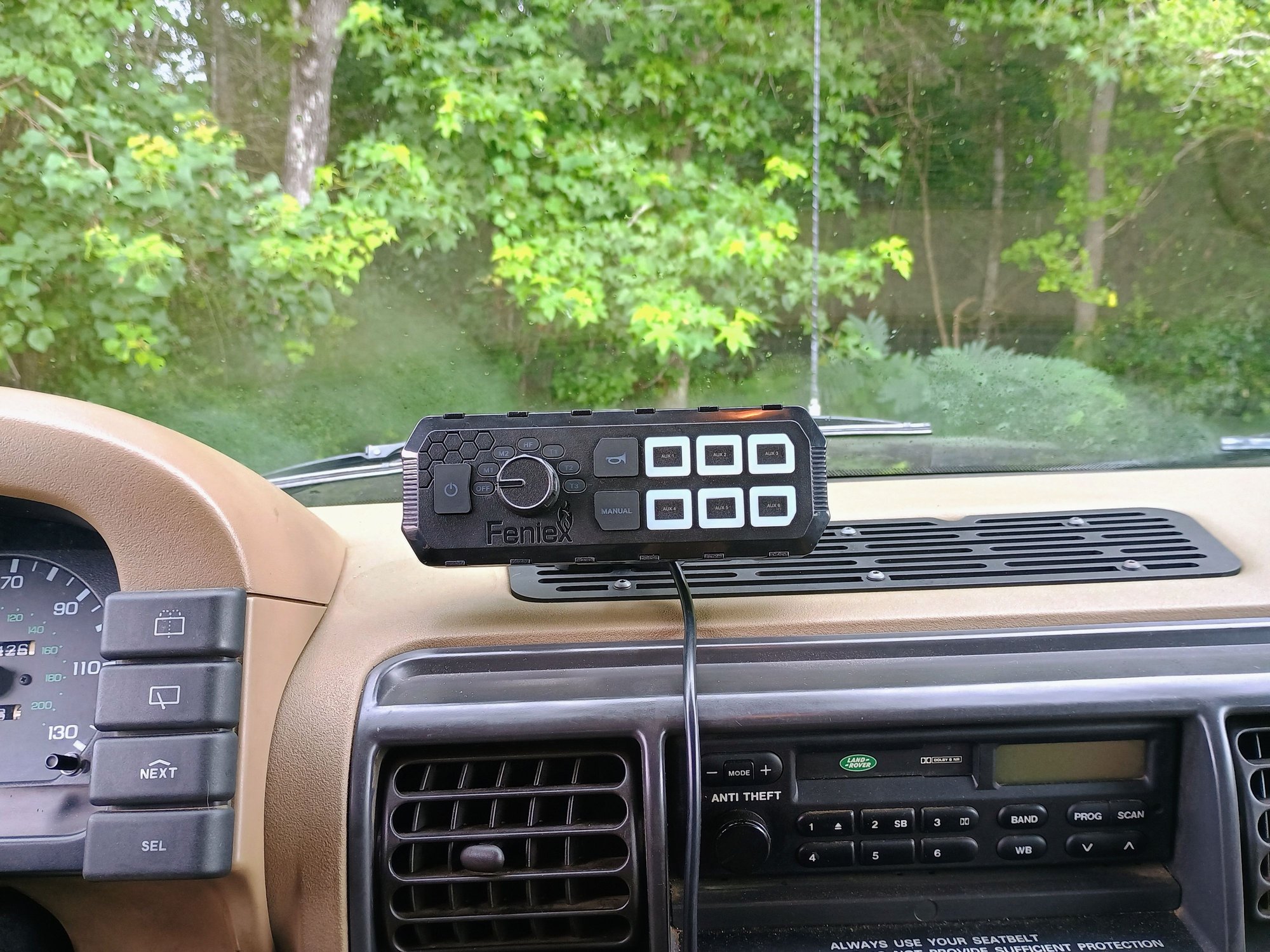

Clean looking unit, does it basically control additional electronics?

From: Beaumont, TX
It can control 6 Aux devices rack lights, rock lights, or whatever to trigger a relay. It also has a PA and 20 something police sounds. Since I'm either a trail leader or tail gunner most of the time the PA could come in handy. The police sounds might come in handy during an event to get someones attention or if a blind person can't see my AA Yellow XD going down the road.
