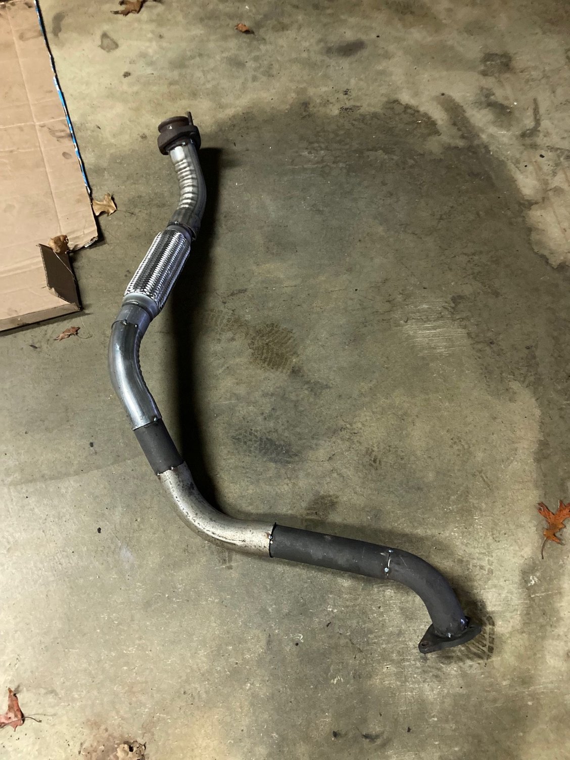

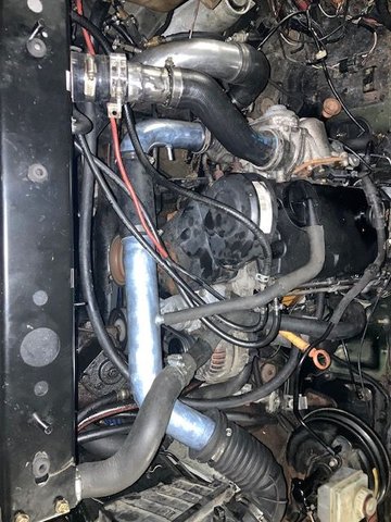

At this point allot of work was being done but not many pictures taken. The Beetle computer was sent out for an immobilizer delete and stage 2 tune (should be around 180hp and 280lbft). Wiring loom was pulled out of the beetle and paired down to what's necessary to run the diesel. I figured out that it's just too tight out front to run a air to air intercooler. So I came up with this water to air setup TDI turbo to the land rovers muffler and tailpipe out of scrap from the V8's down pipe and a few off the shelf exhaust parts.

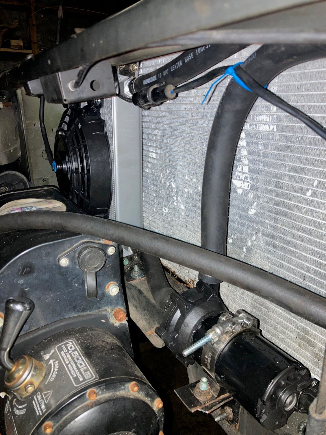

Had some time yesterday to get out in the shop and play. I finished getting the water to air intercooler setup.
a little bit janky but secure. I also repurposed the aux cooling fan wiring for the A/C condenser that isn't there anymore to run the cooling fan for the heat exchanger and the water pump. So now when I turn on my A/C it runs my intercooler pump and fan.

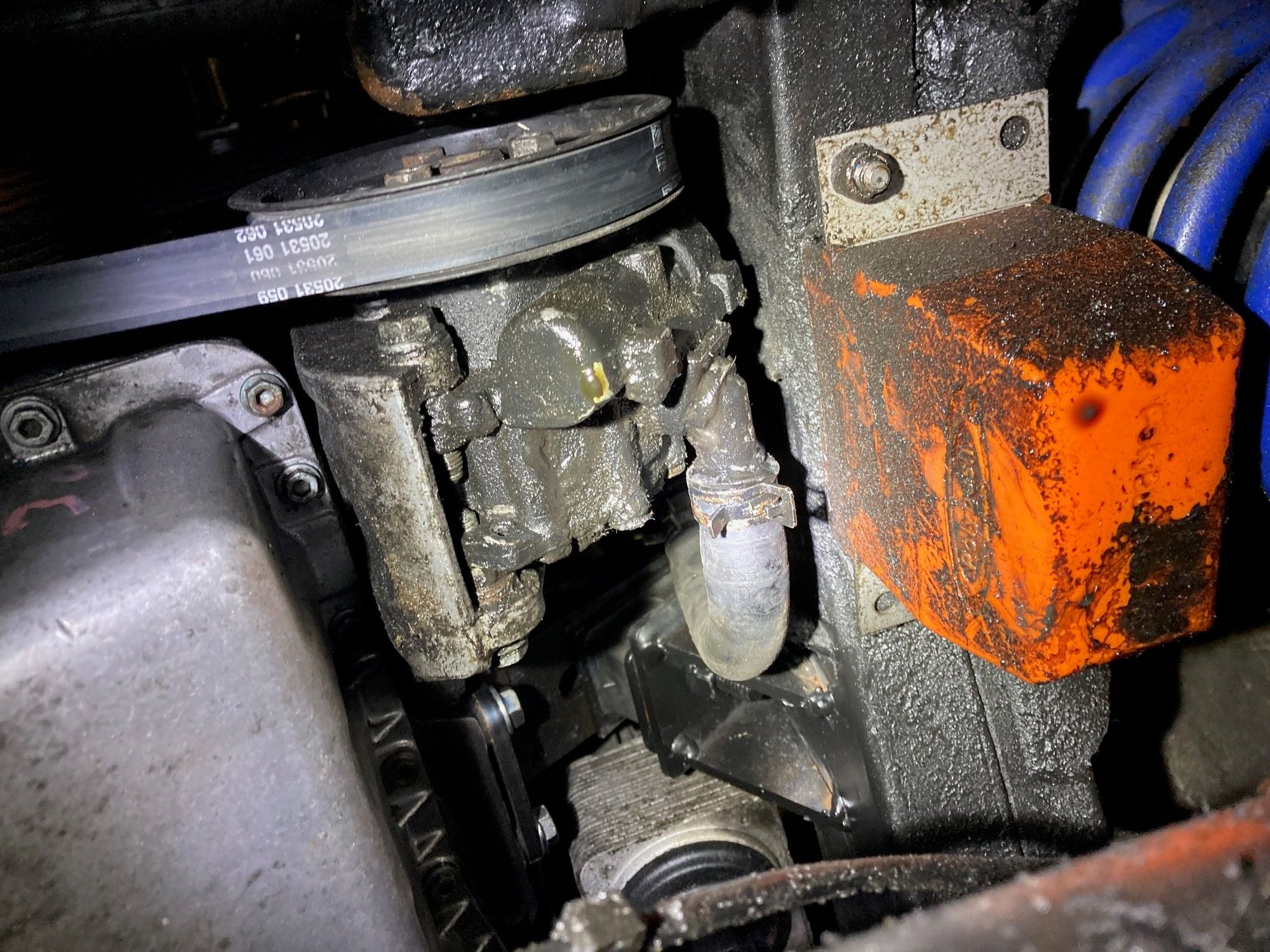

I also took this picture from under the car so you all can see how of a fit the power steering pump is between the frame and steering box.
pardon the mess, both the disco and the donor car had leaking return hoses.

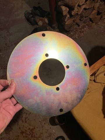

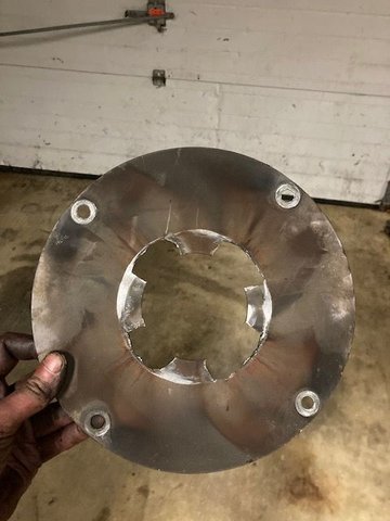

Thanks for the reply. Yes it has the v8 torque converter and on that topic It's even gone as far as to absolutely destroy the flexplate.
It started getting painfully loud after a couple hundred miles when it had do load on it and had me so freaked out I actually dropped the oil pan to make sure I didn't spin a bearing.
I'm really hoping I don't have an alignment issue and that the fatigued old rover part was just not up to the task.
It's pretty sad when the chinese replacement part is beefier than the stock one.

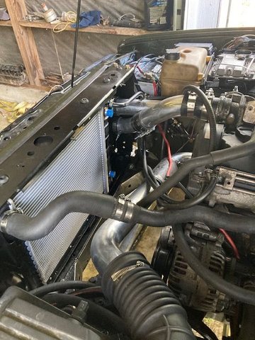

Being a trail rig build, I'm looking for simple and strong as possible and I had a lot of sketchy reroutes and adaptations to make the VW run in the v8's place. plumbing and hoses everywhere, my fuel filter was just sitting on top of the steering box not secure, as well as the weird crossover tube for the lower radiator hose flopping around. So time to change it up.

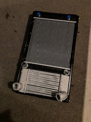

The solution I came up with is to rearrange the radiator and intercooler from a 300TDI from this
to this
by drilling new holes in the outer frame to relocate the retaining bushings in the new correct spot.
Don't get me wrong its still not a perfect science but so far it seems to work but it did take some bending and messaging.
What I really like is that the inlet and outlet for the radiator now match the VW TDI so no more cross over tube, but also no more need for a seperate pump, fan, heat exchanger, and coolant system for the intercooler. I also finally had room to mount my fuel filter. You can barely see it there on the side of the battery tray using the factory mount from the VW.
So here is the current arrangement

test drive follow up. Better but not ideal. I was hoping for 20ish* from ambient temp. today is round about a 45-50* day and air temps hovered around 100* cruising and would creep up to 140 on a long pull. Like I said, better but not ideal.

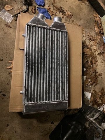

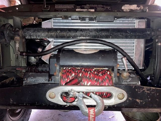

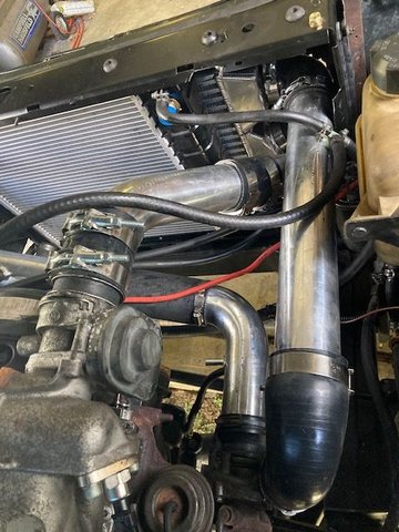

Round 3 and hopefully third time's a charm. Big chinabay intercooler.
I chose this one because it was the biggest one that looked like it would fit after taking some measurements and gestimates. Also take note, factory condenser for AC no longer an option and that being said I pillaged the condensers upper mount for the new intercooler.
its slots right in place without too much fighting and messaging.
Old Apr 21, 2026 | 02:42 PM
aka"thedude"'s Avatar
Joined: Jan 2012
Posts: 33
Likes: 26

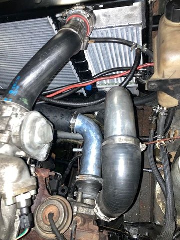

I also bought a 2.5" universal intercooler piping kit. I'm pretty happy with how simple and straightforward the intercooler piping is.
and don't sweat it if you don't have a bead roller. I was able to get away with using a cheap set of wire crimpers to get a small bead on the ends of the tubing I cut. this was the first one a tried and they only got better as I go tmore practice.
I got a quick test drive in and we are definitely making big leaps in the right direction. Normal cruising is around the acceptable 20* over ambient temp, on the 48* day it hovered at an air intake temp of 66-68* at idle and low boost, and even on a long pull up a hill it only went up to around 100* and quickly came back down after the high demand situation. EGT's also seem to be better especially at highway speeds while climbing hills. Along with the bigger piping comes more turbo noise, and its back to whistling, shuddering, and chirping like it did when I first ran in on a cone filter but not nearly as loud. Power is fantastic! Makes me wonder what it would run like with a bigger turbo.
