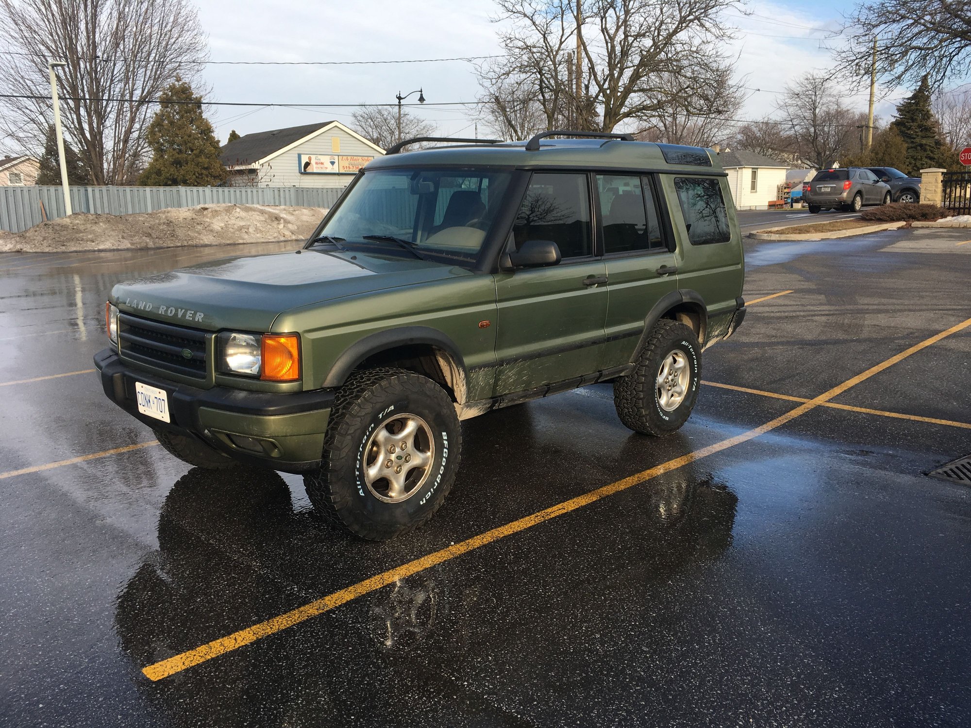

I started with a 3” heavy duty terrafirma lift kit from lucky8 during last years christmas sale
Old Dec 19, 2018 | 04:24 PM
Looks like new brakes while you were at it. Oh and about time man

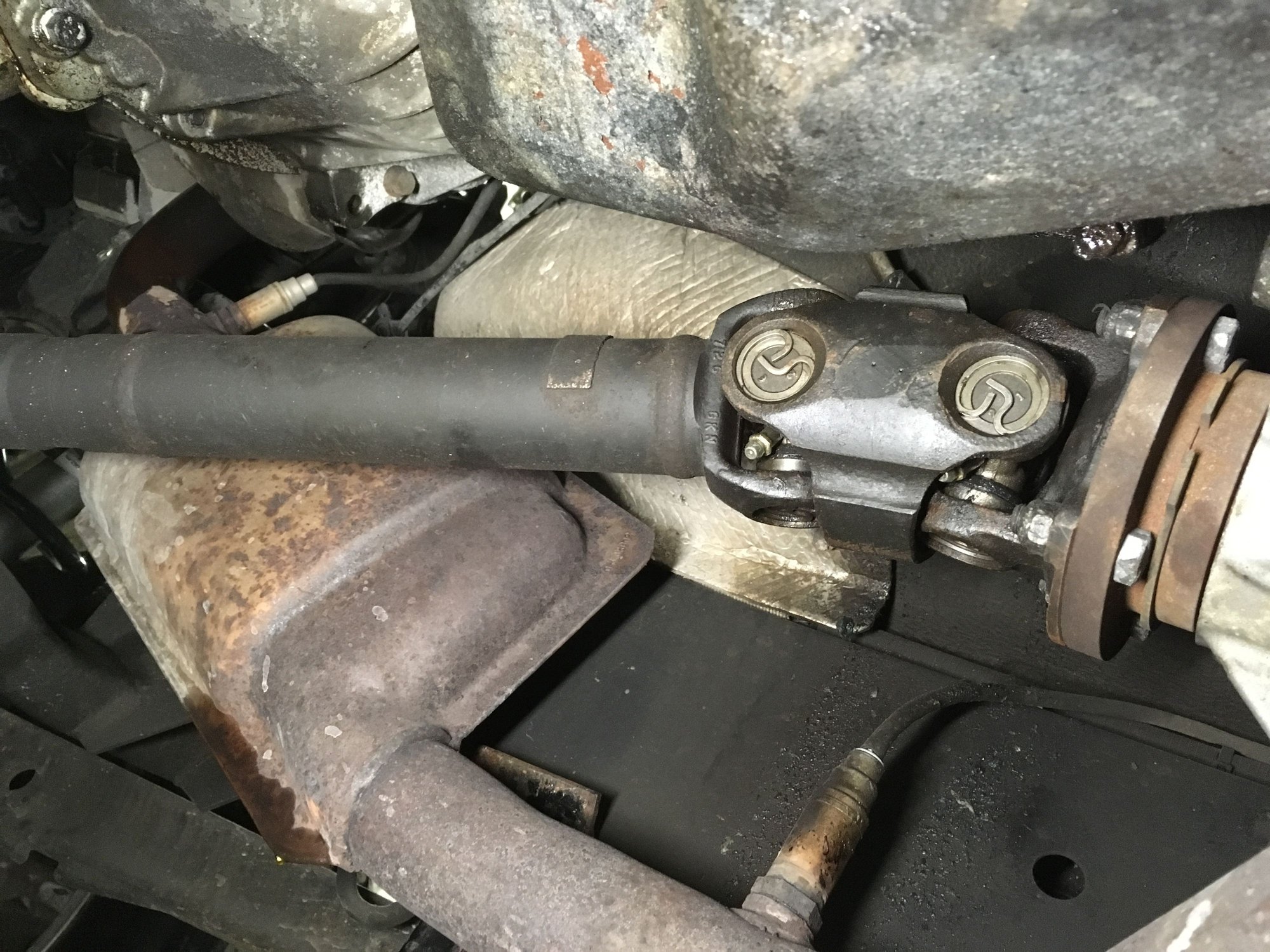

I also installed a tom woods front shaft, all new brakes and changed out all the cooling lines under the hood. Changed to green antifreeze. I figured out the truck was originally from Atlanta, never saw salt yet. So I had it oil sprayed when I safetied it

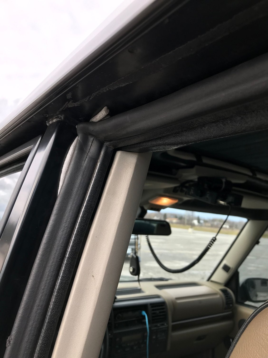

I ll probably forget some of the work I’ve done, I rebuilt the drivers side window regulator with parts from another truck, pulled the headliner down and sprayed it with bedliner, installed a cb, installed a newer radio, redid the throttle body heater, put on some used running boards for my kids and wife to get in and out, installed a turbo muffler, new pulleys and belt.

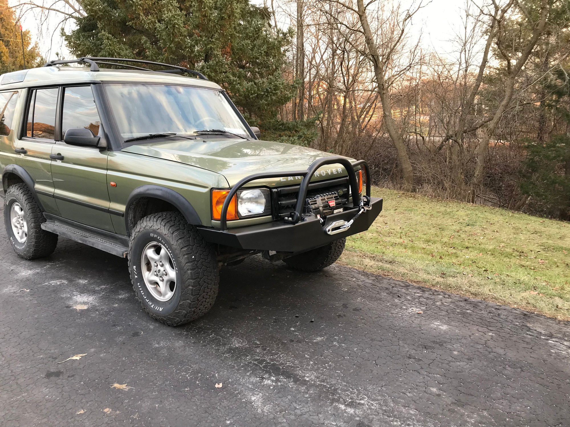

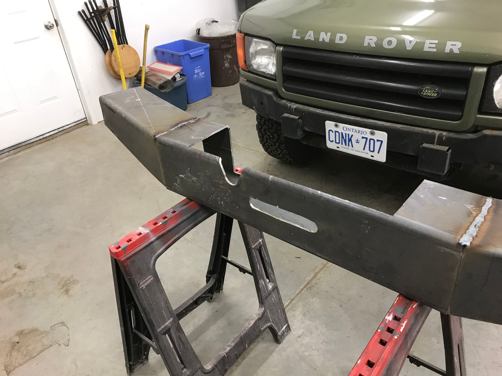

I built my own front bumper out of a chunk of 1/4” wall 8x8 square tube, made some bull bars from pipe, and put in a warn power plant 9500 I had picked up used.

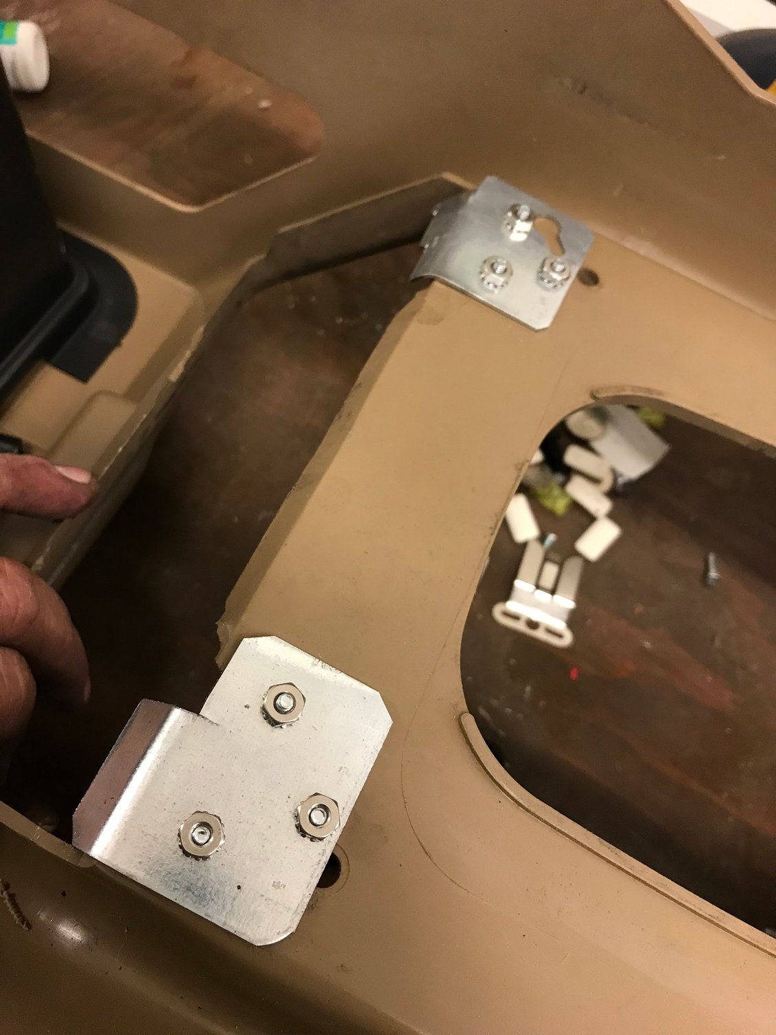

I reinforced the center console for the switch bezel
