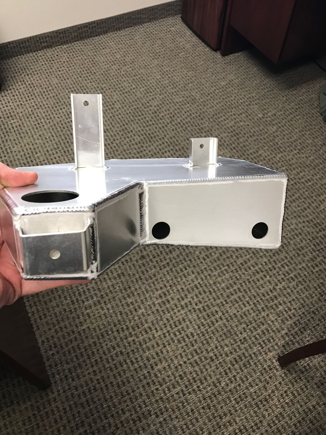

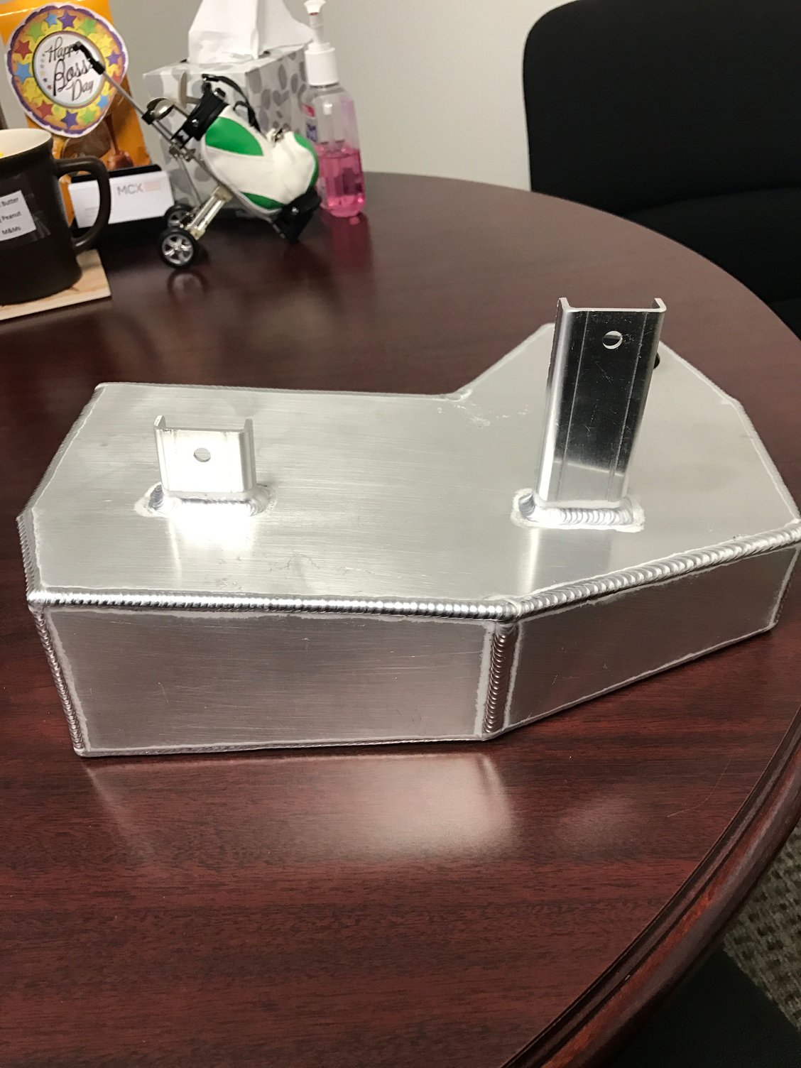

On a positive note, the new washer fluid "bottle" came in from Devon 4X4. Excited about getting this on.

Loving that washer resivoir. Just checked on one for my disco. Enjoying watching the build. Interested to see what you do with the roof. I'm looking at linex'ing mine and then wrapping the rest of the vehicle in matte black (original color is white gold). Keep up the great work man
