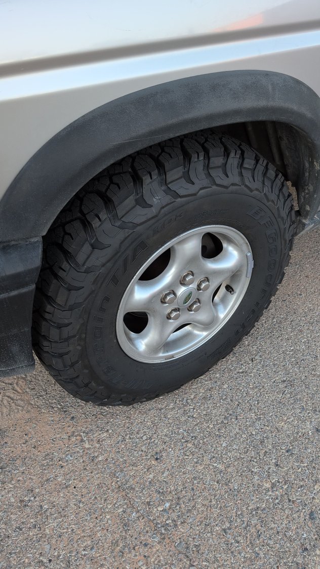

New BFG KO3 tires in 265/75/r16. There's a tiny bit of rubbing, but the planned lift will fix that.
