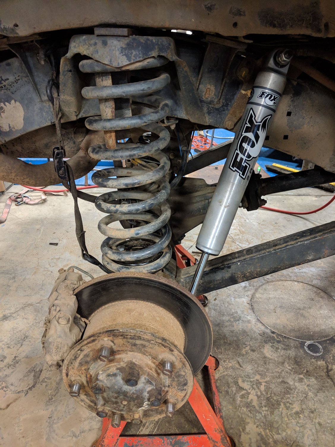

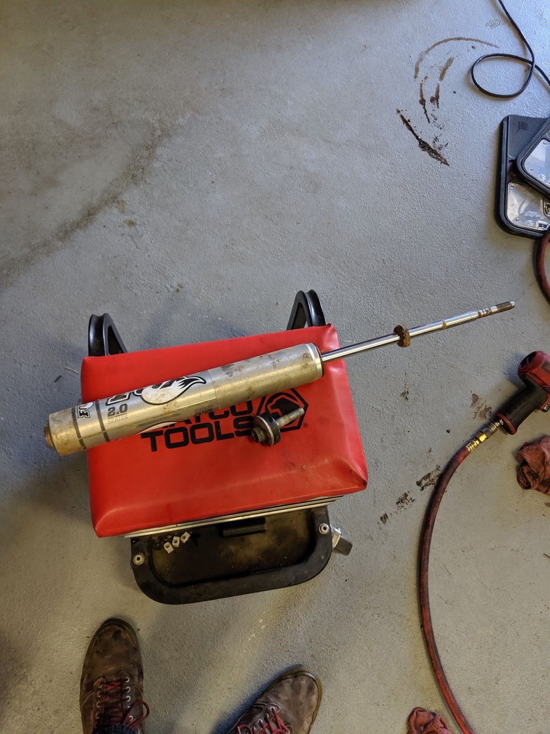

Now onto some pictures. First things first when my friend was towing me to the shop the rear end of my Disco kept hopping and bouncing all over the place. I figured all the rear bushings were blown and the ball joint was probably broken but it ended up being that the shocks that were install were almost 3" too short for the lift that was installed!!

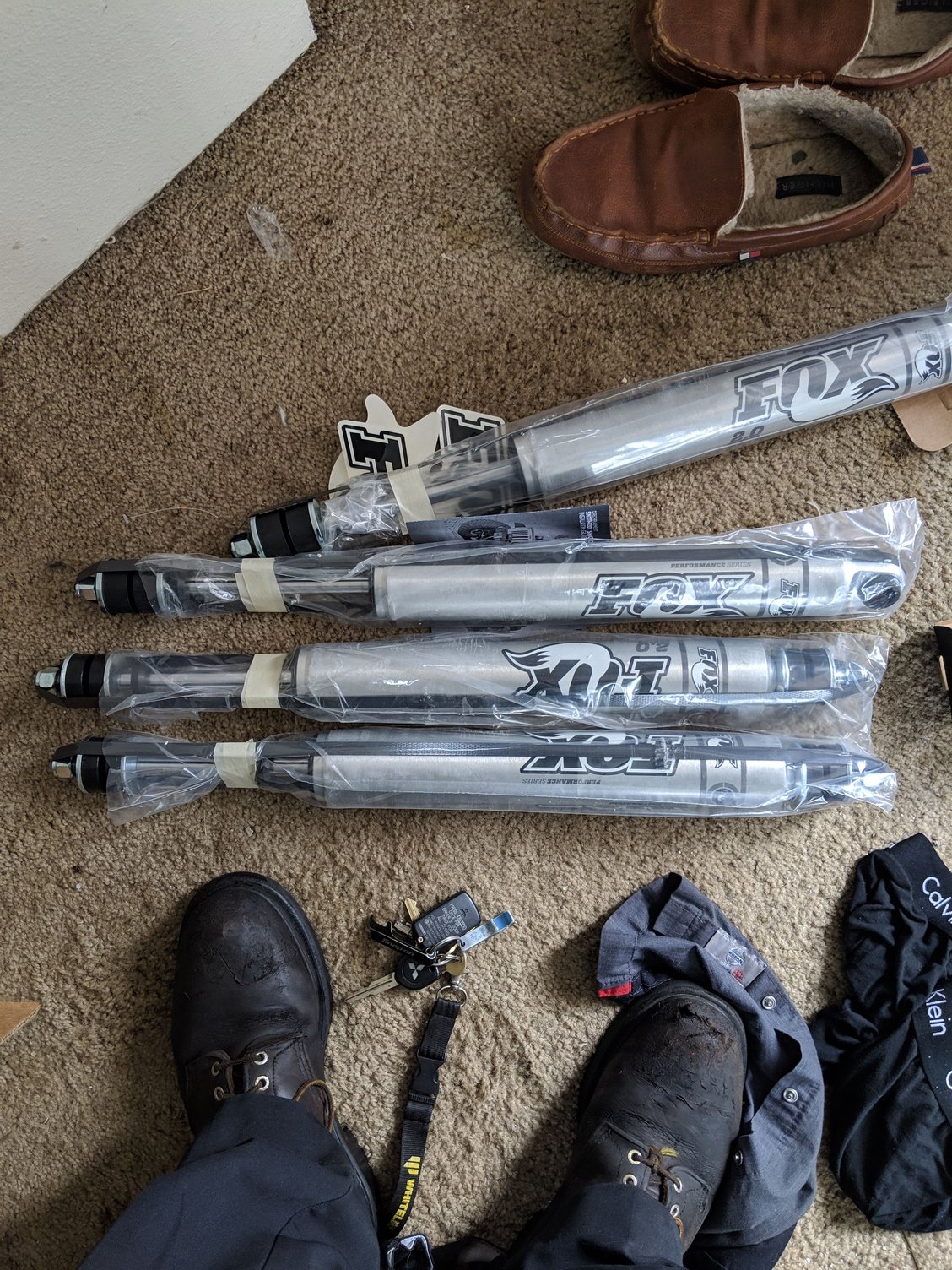

Always a good sight to see. For the two weeks leading up to the trip it seemed like i was was getting parts every single day.
Shocks was something i was debating for a long time and talked to many different people and shops about what to get. I was gonna go Terrafirma, then Bilstein, then decided to say screw it and go custom shocks to take full advantage of my axle travel but then i saw the price tag. Ultimately i only wanted about 3" of lift and i want to fit 35's with lots of travel. And you have to do a lot of cutting ti stuff 35's in with 12" of travel. So i went with these fox shocks that have around 9" of travel but LK8 says that are valved to match the weight of a Disco. I"ve had Fox shocks on Downhill mountain bikes, motorcycles, and our Can Am side by side has Fox 2.5" 3 way adjustable coilovers so i was expecting them to ride nice, but i was blown away how well these shocks ride. On the Dunes they just floated over everything and back home on my ****ty streets they just absorb the pot holes and it rides like a Cadillac. Shout out to LK8 for helping me make a decision and i could not be any happier.
Got the Disco on the lift and pulled the rear shocks and springs off. I'm glad we went with two screw jacks instead of a single trans jack under the pumpkin because the shocks were limiting the axle and as soon as i loosened the nuts for the rear shocks the back up the vehicle raised up almost 2". You can also see the spray in foam i put in the rear doors. When one of the previous owners cut the fenders they also cut way up into the door, so for the sake of having heat i threw in some expanding foam
You can see here just how much shorter the Rancho's are, which were made for a 2" lift, than the Fox shocks, which were made for 3-4" lift. And this truck had a 5" lift installed!

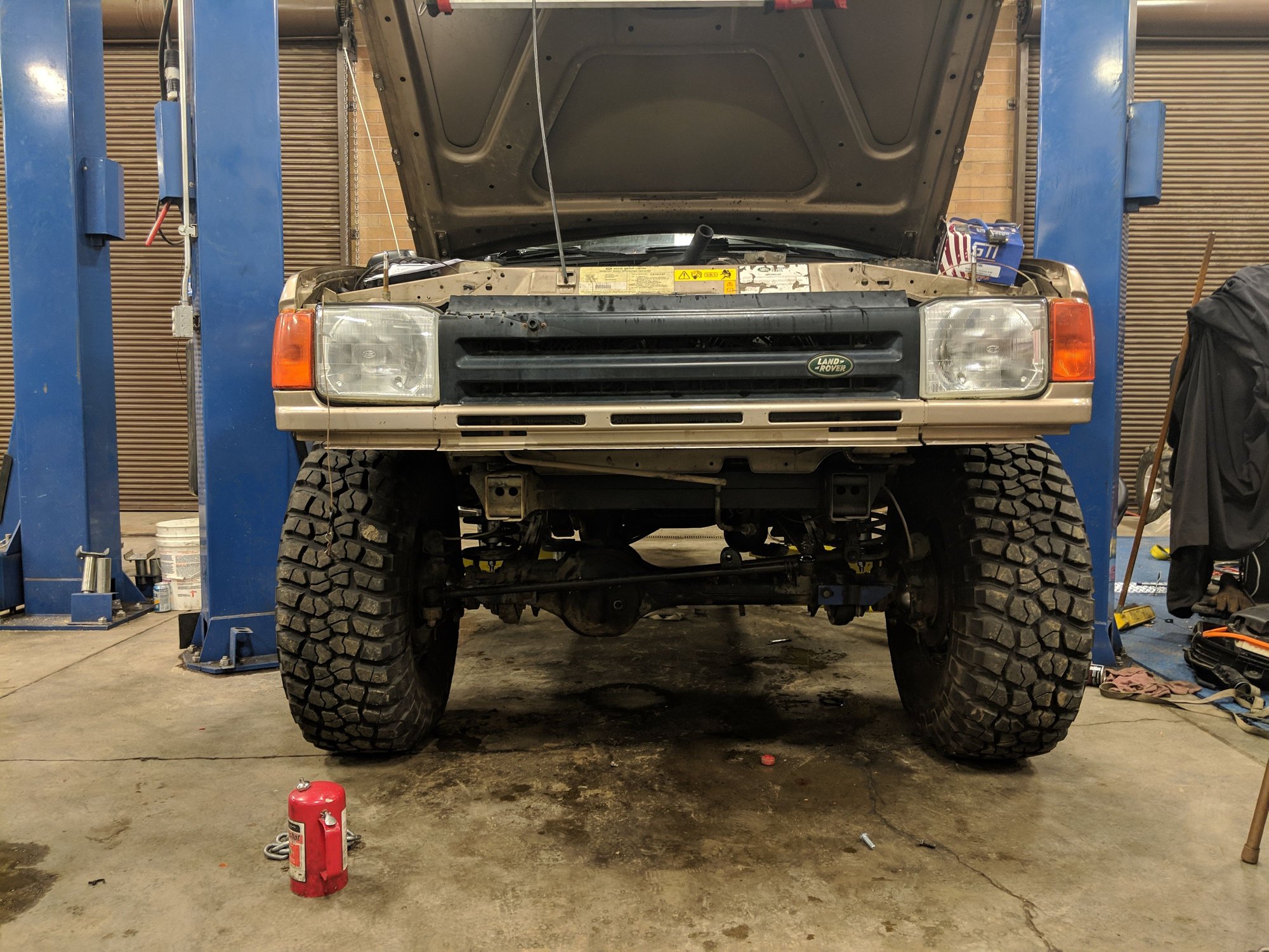

So now it's on to the Front Suspension. This is where even more excitement happened!
Supported the front axle and removed the Springs, and the Dual front shocks. The Driver front Shock tower was actually cracked where it met the frame so I wanted to get it welded up while we had the suspension apart.
You can sort of see the crack here. So With all the Suspension off i prepped the metal and called over my friend to throw some metal on it.
So he welded it up as best he could and then i put on the terrafirma HD Spring retainers and put it all back together.
So here is how it sits. Knowing i was going to the Dunes i figured i was going to lift of the front and didn't want to blow my new shocks so we cut up some chains and installed them where the front shocks in the dual shock setup would go.
Here's a better pic of the front shock with limit chain installed. They definitely did their job but the bracket isn't as strong as i thought it would be and its starting to bend up so i'm going to try and see if my friend can weld in some support brackets to beef it up. I'm still trying to figure out where to mount rear limit straps so any ideas are appreciated!

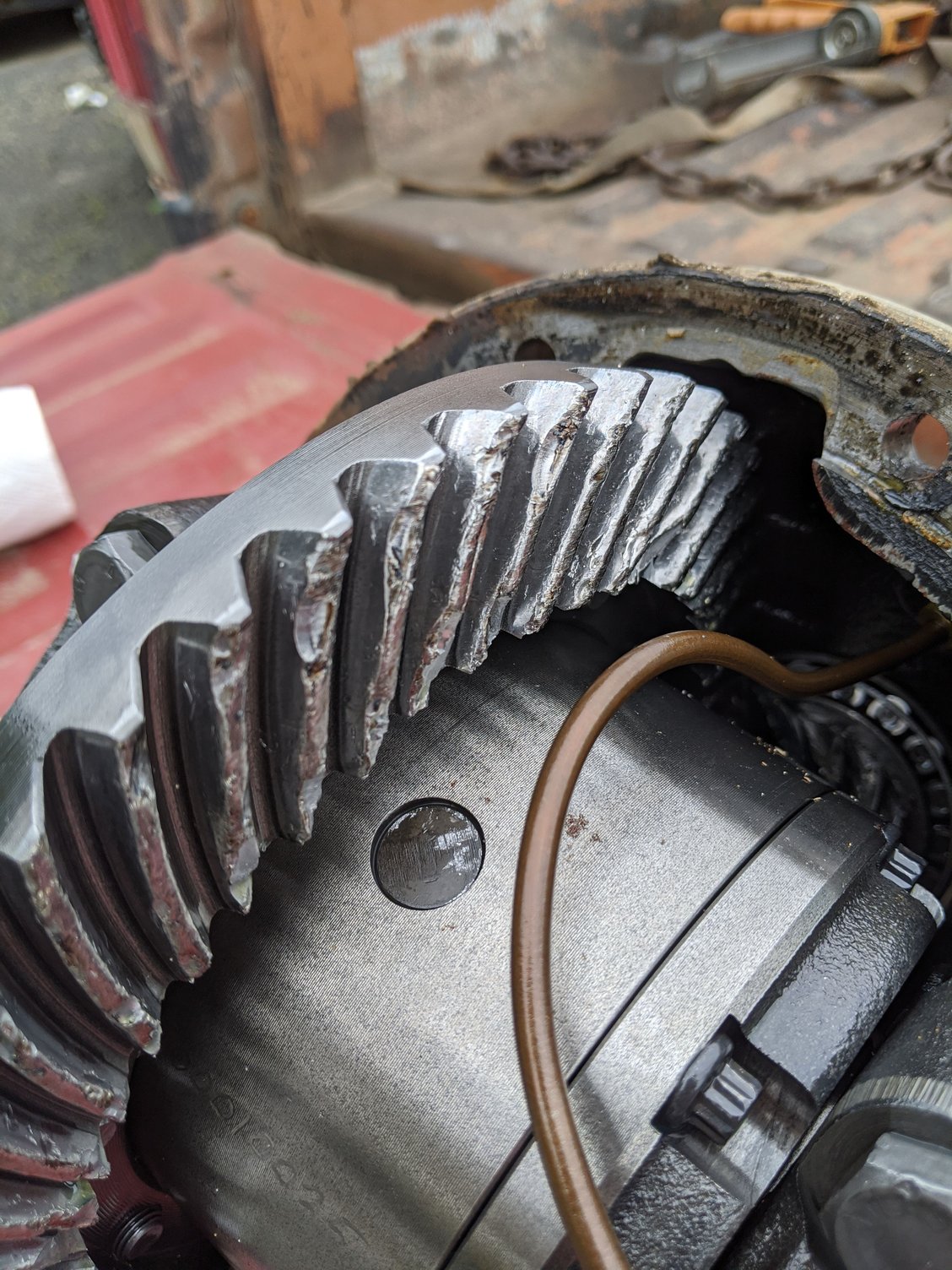

Stripped all the teeth off the pinion gear and destroyed and chunks out of the ring gear. And i was 400 miles from home and had to go to work the next day. I ended up pulling out the rear axle shafts, removed the rear driveshaft, and drove it the 400 miles in 4 high locked. Was interesting because it got 14mpg while in front wheel drive mode. But since i had plans to go camping i bought an ebay diff and swapped them out.
Now the plan is Ashcroft HD 4.75 gears with reverse cut front for added strength.

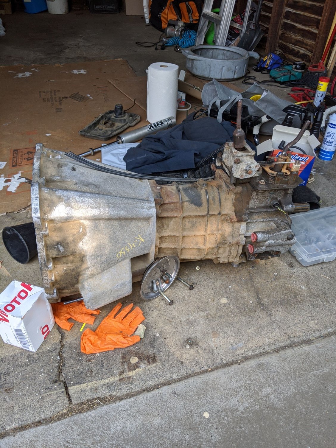

I also just picked up an R380 with pedal assembly and shifter.
Currently on the hunt for a v8i flywheel so if anyone has one let me know! its the last piece of the puzzle i need for my manual swap. ALso i'm thinking about getting 1.4:1 transfer case gears for 4 High, but not sure if i'll need them with 4.75 diff gears and the manual trans. IF anyone has experience with running different transfer case gear ratios i'd love to hear it. But while i'm waiting for parts we keep taking the Disco camping and besides running hot she hasn't let me down.
