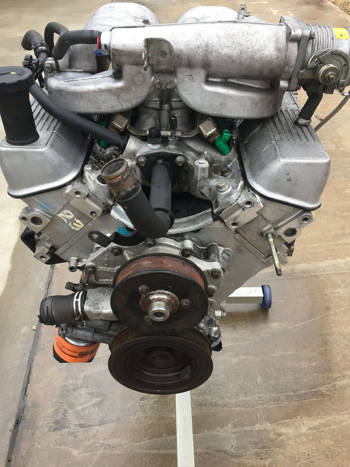

Picked up the 04’s replacement engine. It was out of a very good running 03 D2, but a tree fell on the D2 and totaled it. When I went to pickup the engine the first thing I noticed was the front timing cover. It was a P38 style vs D2, so I honestly think the original 03 engine took a dump, and it was replaced with a 4.6L out of a P38 RR. If it was just the timing cover most of the time a D2 style like what came off is installed.
I’ll be very happy if it is indeed out of a P38! I’m going to remove all the auxiliary hardware (ps pump, alternator, AC compressor), and the destroyed wiring harness & misc cut lines. Then I’m going to do the HG’s while it’s out of the D2, and inspect/replace the oil pump gears. After that I’ll start getting the 04 ready for it’s engine removal, and go from there. Not in any kind of rush, so we’ll see how it goes.

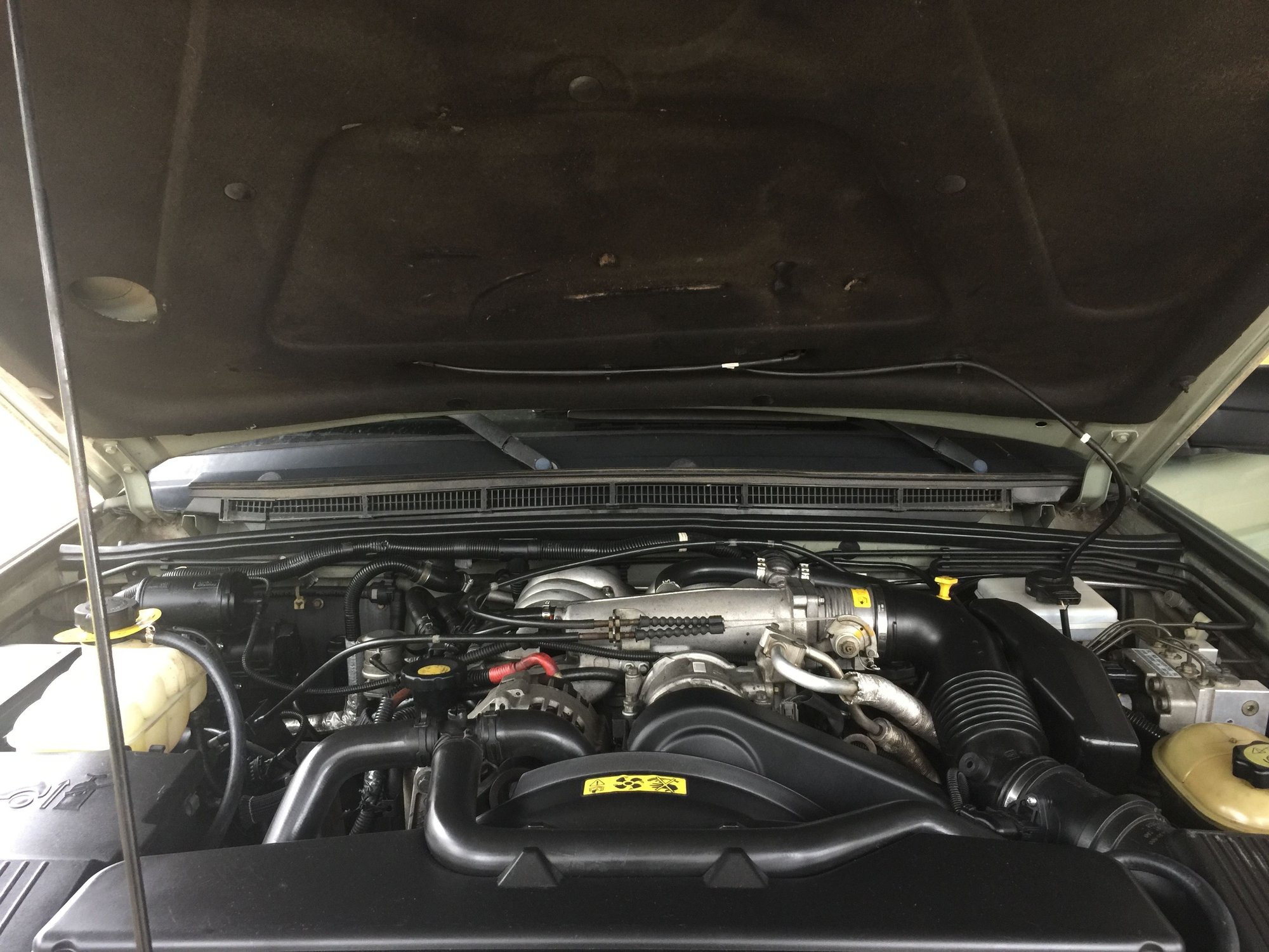

Had time today after work to remove the old wiring harness and all the accessories. I’ll be ordering the HG Kit, and Front Cover Kit this week.
