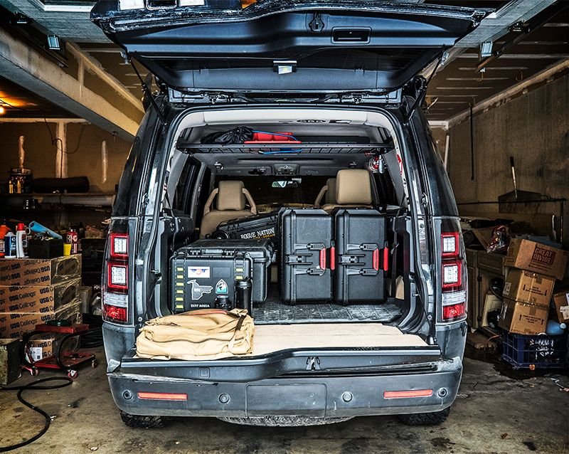

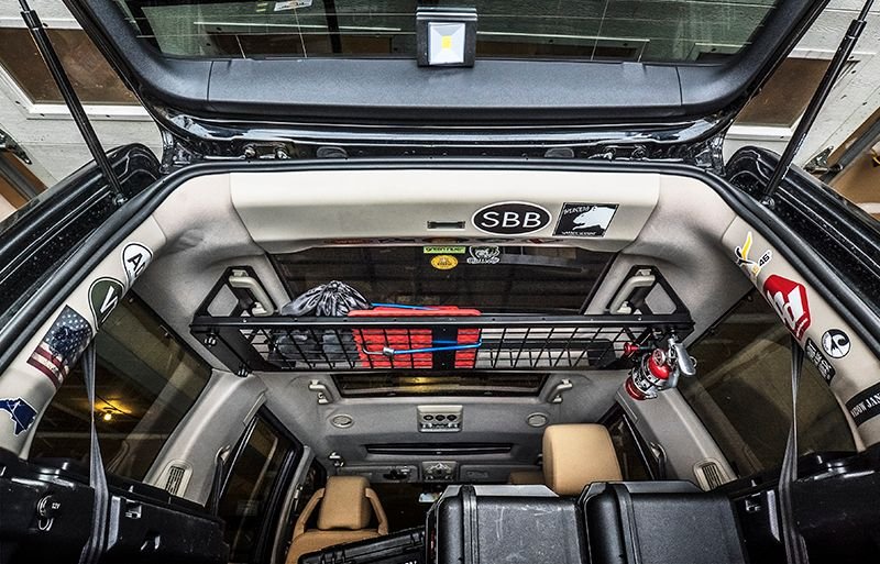

A few shots of the Mantec Rear Luggage Rack and extinguisher:
  • Had some issues with it rattling loose when I first installed it.
    • Locktite solved that problem per usual.
    • But anytime some cargo is really pushing up against it it loosens up a bit and starts to rattle.
  • Drilled my own holes for the Drake Mount:
    • Great quick release. Works perfect.
    • Had to add some gorilla tape here and there to silence a few rattles.
  • COB LED mounted to rear window for some extra working light.

That rack is pretty cool.
If you don't use the third row of seats, I'd recommend it. And even if you do, the basket comes right off with thumb screws.
Been keeping recovery gear and an air compressor strapped to it for easy access.

Old Jan 2, 2018 | 10:07 AM
Works even better if you don't have a third row. To bad mantec went under.

Awesome pics, that rack is a great idea. I have toyed with making something similar before for my D1 but in the D3 would work better, i have a cargo barrier which means i can load it to the roof when we go away.
