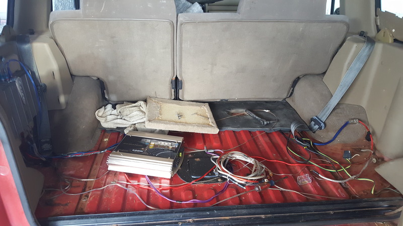

Yoinked out the Bazooka tube sub, two amps, and spaghetti wiring.
For now the sub/amp is staying out and the regular stereo amp will be relocated under the passenger seat.

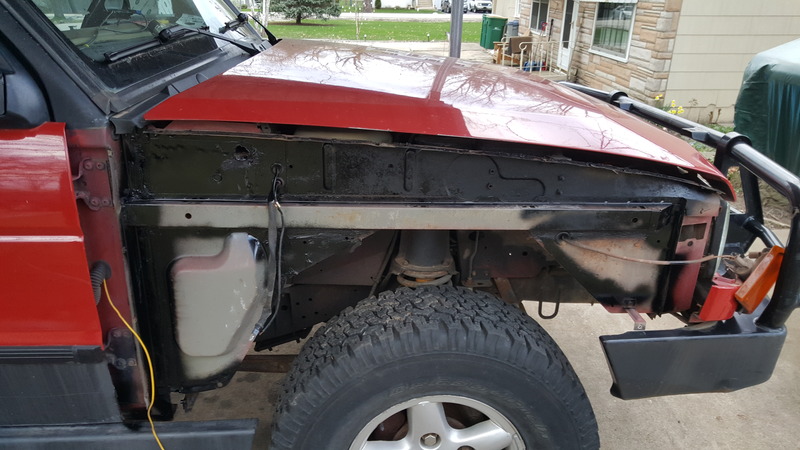

Started to address one of the areas of water ingress to the cab.
Removed all the old sealer and rust and painted. Next step will be applying some Leak Sealer spray per the TSB.

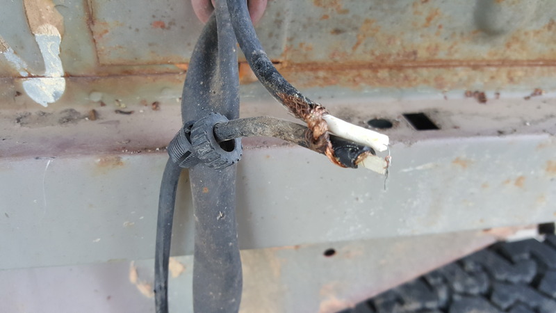

Along the way I figured out why my radio reception sucked ***.

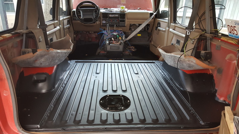

And pulled all the seats, and that bastard foam insulation. I POR15'd the front floor pans and a couple other slightly rusty spots, then used an oil based Rustoleum paint.
