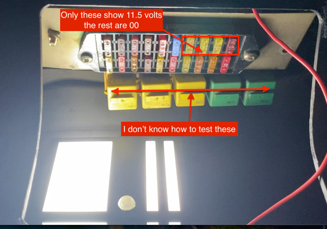

1992 110 300 TD - Was working on hooking up my trailer lights - standard hookup - Wire Colors (G) green (RT) Yellow (LT) Brown (Tail Lights).
I blew a the (Tail Light) fuse due to a short, replaced it then rewired to a brown Defender wire, blew it again and now the whole system went down and the truck won't start? I get no voltage on most of my breaker panel see attached?
Any ideas
Thank you in advance!

Check fuse box in engine compartment.
