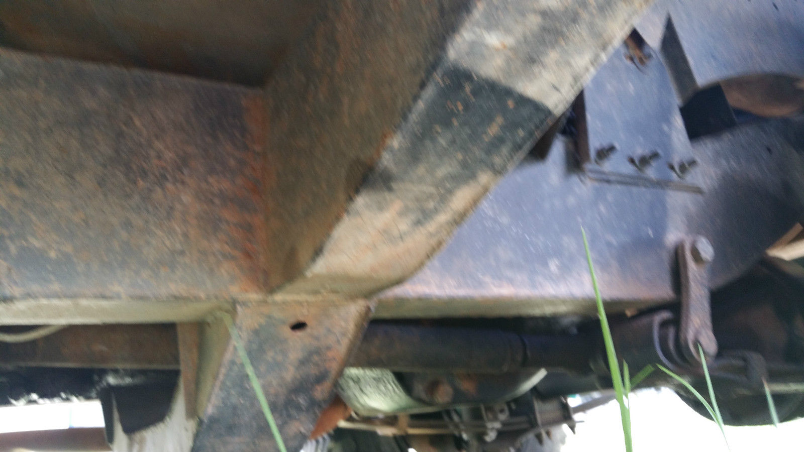

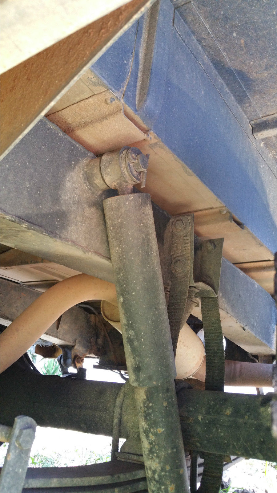

Also, the 94-98 Disco axles appear to fit perfectly. However, if I stay with the leaf springs I will have to cut off the leaf spring mounts and make some other minor modifications to the axles. It would not be greatly difficult to buy the factory parts to convert to coils.
The most impressive aspect is there is literally no rust!

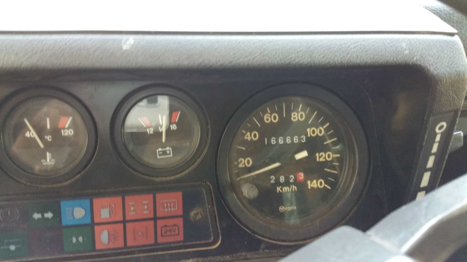

Based on the looks of everything at 166,000 kilometers, about 103,000 miles, I do not suspect much has been changed since new.
