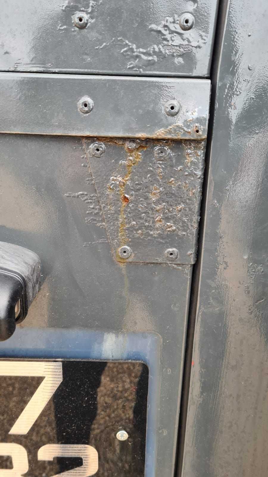

Hi guys,
Any idea what is causing this rust and how I best treat it? Is it the rivets causing the bubbling or something elses?

aluminum and steel don’t play well together.
https://en.m.wikipedia.org/wiki/Galvanic_corrosion
