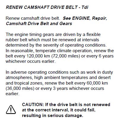

In the defender manual for the 2.5na and 2.5td is says 60,000 miles. I don't have a newer manual that has this info for the 200 or 300... but in the disco and rrc manuals, it shows 72,000 miles.
