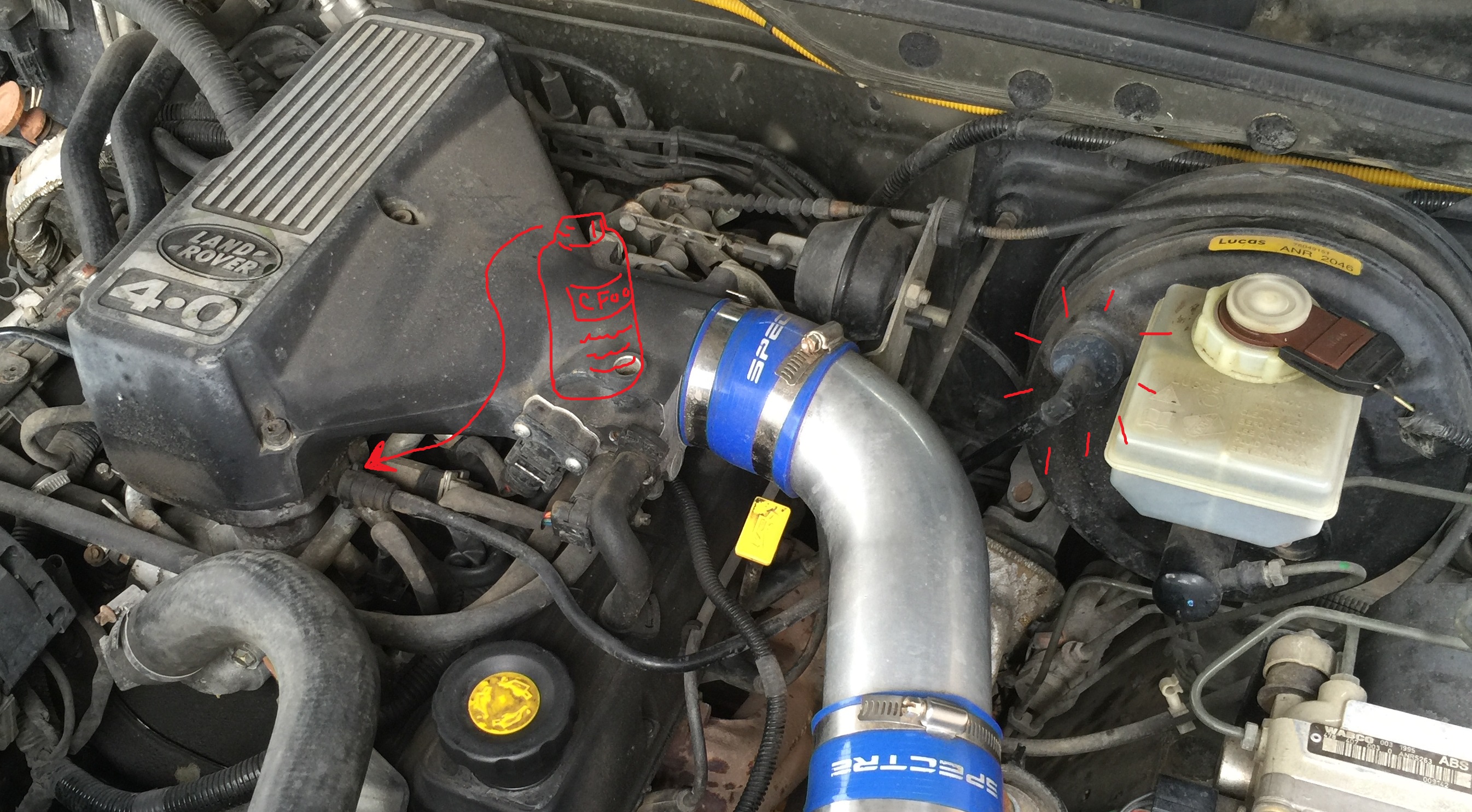

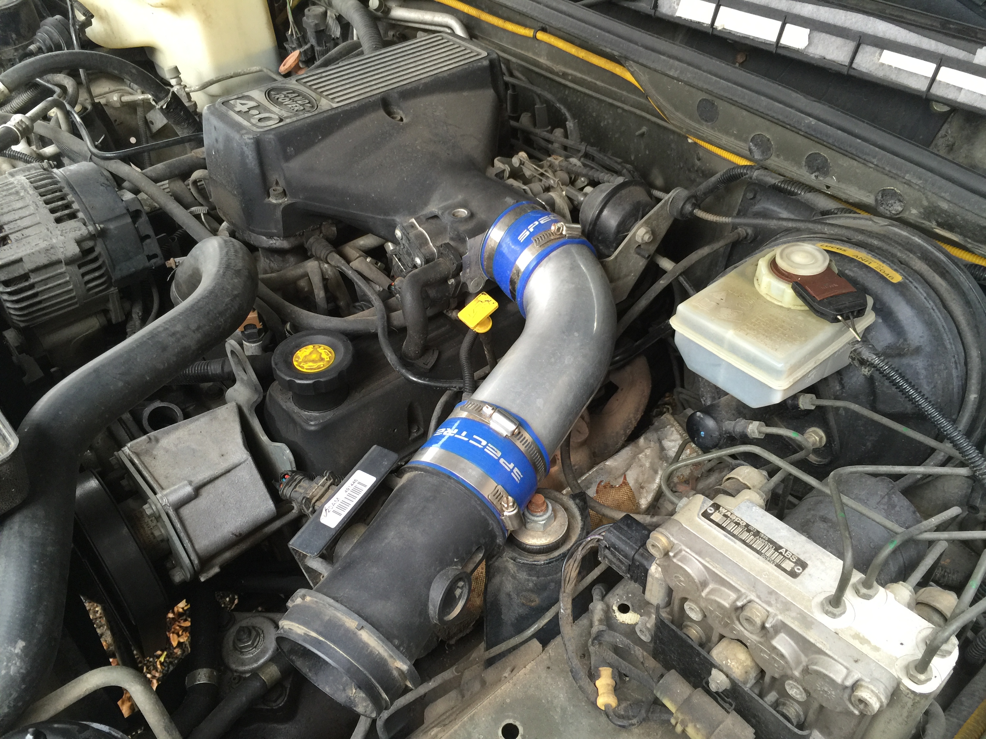

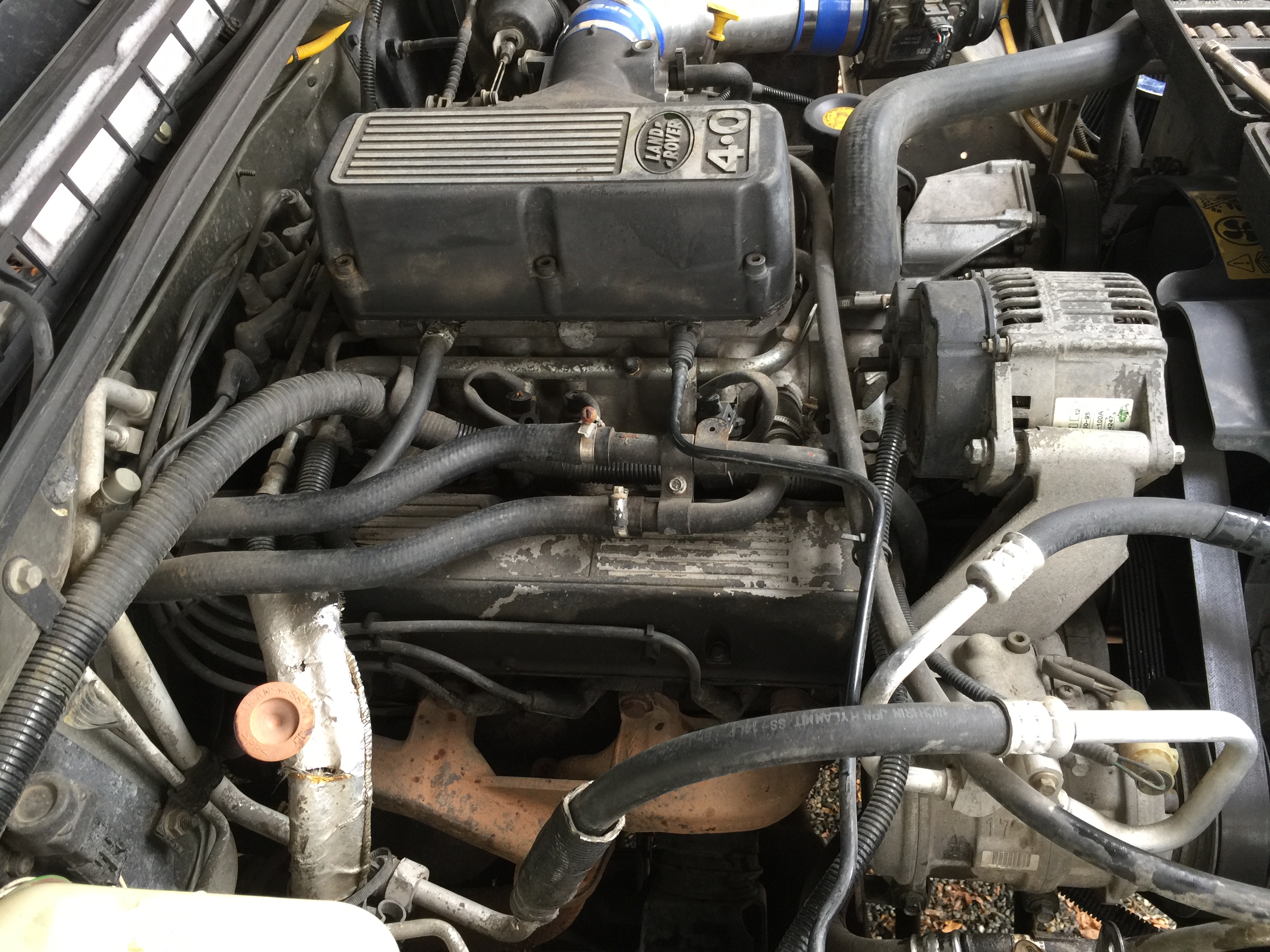

I'm game if you think it might help. Can you point me in the right direction as to where to dump in the Seafoam? (See attached) Do you just add it bit by bit and work your way through the can?
I took those shots of the engine today while yanking out the coolant overflow reservoir. It was leaking at the emissions testing place the other day, so they wouldn't test us. I took it off and cleaned the seams and put JB Weld all around there to try and seal it up. There seems to be a bit of pressure in there...is that normal? When I remove the cap, you can definitely feel it.

You let the engine vacuum suck the Seafoam from the can, brake booster vacuum line. Direct shot into the intake and gets where it needs to go in large quantity. Do not jam the vacuum hose in the can, it'll kill the engine like now. Do it slowly, like feeding a baby formula, little at a time. The exhaust is going to turn pure white as your doing so, just let it roll. The original expansion tanks split at the seam, common issue. I suggest buying an aftermarket cuz they're better.

Here's the line where I'm assuming the I'll be feeding the baby....

Squirt WD40 in the seat switch, it doesn't get used as often as the drivers does. The drivers window sticks for the opposite reason, it gets use more often and you either have a missing tooth on the window scissor mech or it's well worn. Yep on the baby feeding line.... exactly.
