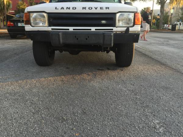

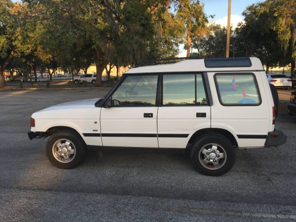

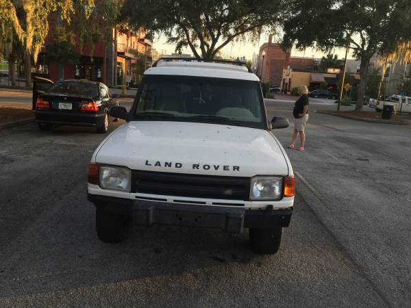

Hey Everyone,
Let me start out by saying thank you for all the wonderful and helpful information on here. I have spent the last four days reading about seven years of posts. I recently purchased my first Land Rover, a 97 Discovery SD for $800. When I purchased the Disco it would fire right up and idle steadily. In park or neutral it will rev up just fine, although it does have a slight hesitation when you hit the gas. When it is in drive though, it will not rev out and is very sluggish. If you can get her up to 40mph you are lucky.
My first thought was the cats being clogged, so I pulled the y pipe from the manifolds. This produced a stronger response from the motor, but the hesitation is still present and I have not had time to drive down the road yet to see if it will run correctly. ( My guess is it doesn't, will try tonight).
I am going to go ahead and remove the cats since I have the pipe out. I also ordered spark plugs, wires, air and fuel filters, and stuff for oil change. Should be here Monday.
When I first purchased it the codes read
P0118 - ECS out of range
P0125 - ECS warm up
P0116 - ECS falling temp
P0181- Fuel Temp Sensor signal error
P0150 - O2 sensor cycle fault
I cleared them after reading and have not tripped anything on my start up tests or drive around the field.
I still have a pile of dealership and mechanic receipts to look at and get an idea what has been done. I am worried about the VSS for sure. Still have the Rear window motors to deal with (need to stop at radio shack), the drivers side window regulator is messed up, and the headliners sagging low. I am hoping to finish removing the Y pipe tonight, clean the MAF, and throttle body tonight.
