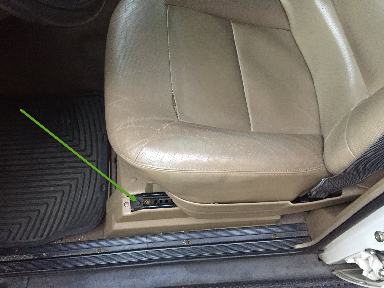

I managed to fix the hole in the driver seat last night. It's a matter of removing the front seat (2 10mm bolts in front and 2 torx bolts in back). All the connectors under the seat had to be disconnected, along with the seat belt connection which were the same torx.
Then a trip the smog shop and then AAA for title transfer. In California, you have to smog the car before you can transfer the title.

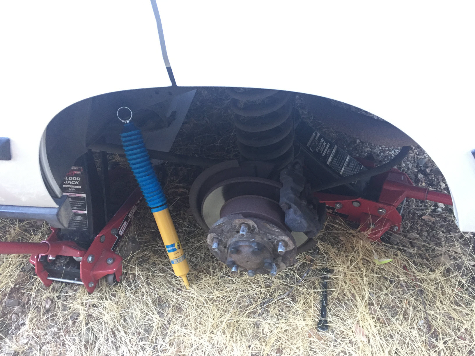

I got 3 projects done this weekend. Rear shocks and transfer case fluid and tire rotation.
The rear shocks were to replace the Bilsteins that had 73,145 miles. The new Billy's feel a small bit stiffer than the old ones. Not much improvement there so I'll call it preventative maintenance.
Since the rear wheels were off, I decided the rotate the tires and measure rotor thickness.
Front 12.9mm (13.0 min)
Rear 11.8mm (11.7 min).
I ordered some rotors and pads at O'reilly's and picked them up today. Now I need to find that 52mm socket to do the End-Float adjustment on the 2 nuts.
Procedure:
Tighten first nut to 61nm
Back it off 90 degrees
Re-tighten to 4nm
or just turn it by hand a bit and you can feel it 'nip' up a bit.
Then put on the lock-tab washer that bends
Then tighten the lock nut to 61nm.
I ordered the 52mm socket hub spanner tool and it should be here in a week.
Then I drained the transfer case of 75w-90 Royal Purple Gear Oil to put in something thicker. I put in some cheap 85w-140. I tried pretty hard to remove the inspection cover so I could re-seal it but the dam thing was glued on pretty good. I couldn't find even a small edge to pry the cover off. I concluded I would have to break the inspection cover to get it off. A new one is 6,000 miles away in the UK for $60. I'll cut my losses. Actually, the bolt-holes are where it leaks so I put some orange Permatex RTV on the threads and snugged up the 10mm bolt heads, then pumped the case full. I got to the end of 2 quarts of gear oil and it still wasn't coming out the fill hole. I reached in there and could touch the fluid with my finger easily so I called it full and plugged it up. I really didn't want to go back and buy another quart and use 5% of it.

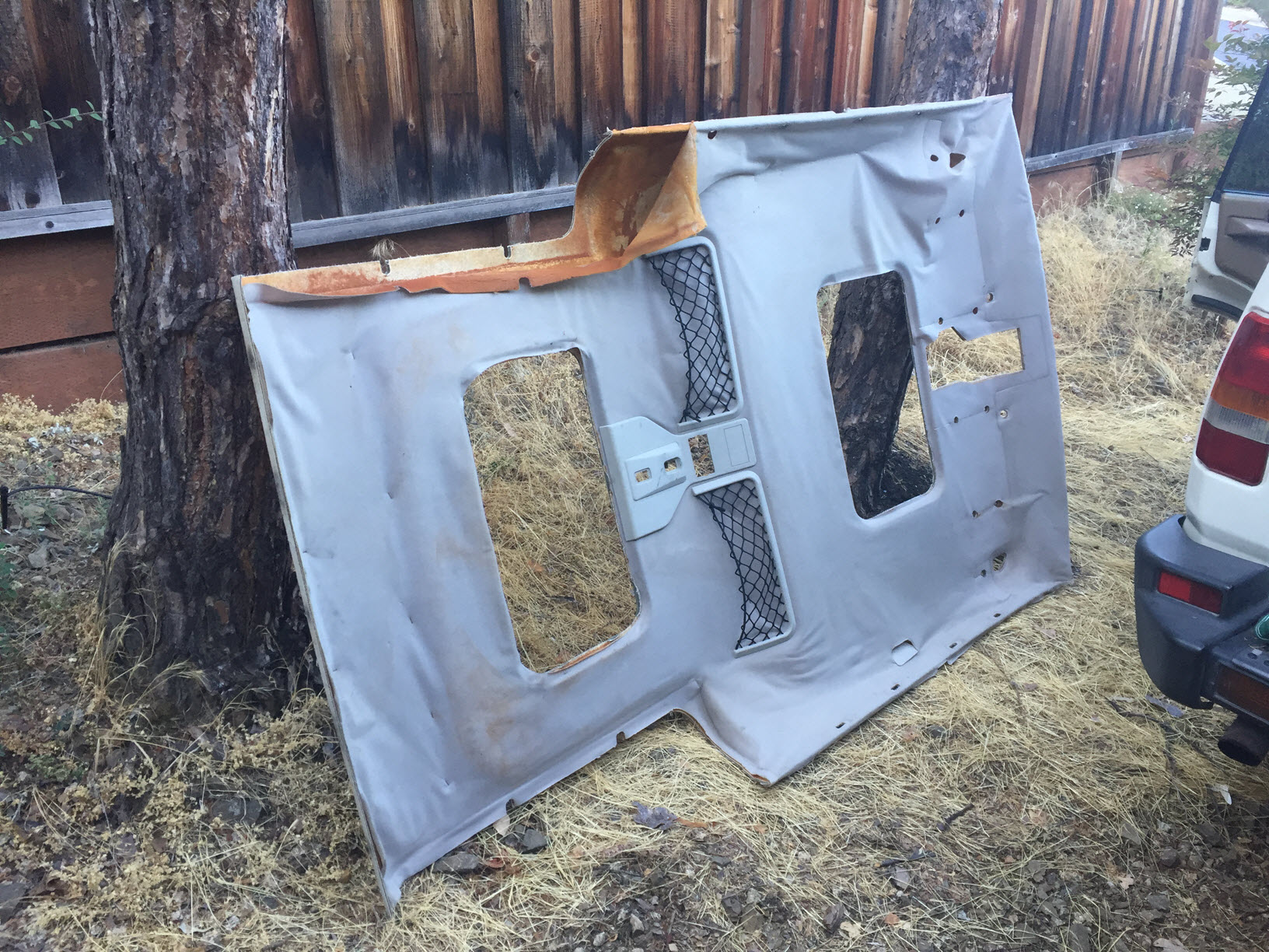

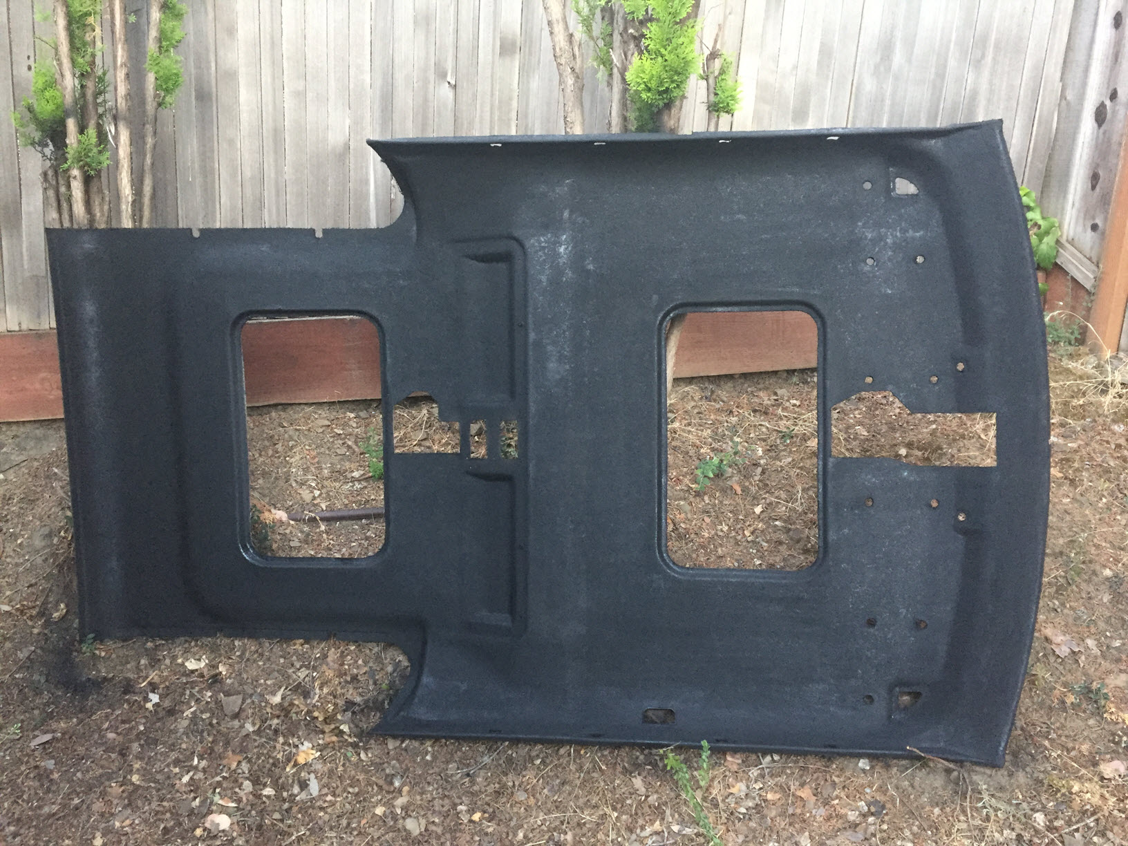

The next project is to remove that sagging headliner.
Since 3M glue ($50 for 2 cans) and headliner material (JoAnn fabrics $150) is probably over 200 bones, I'll just paint the thing black with rattle-cans for now. I could always take it out again and line it properly if the mood struck me. Then I checked the drain hoses and they all seem entact. Leakage should be non-existant.
Attached Thumbnails 1998 Discovery 1 LE - White on Beige-falling.jpg   1998 Discovery 1 LE - White on Beige-old.jpg   1998 Discovery 1 LE - White on Beige-black.jpg

I've done several headliners, and know more people who have as well. I've never seen 3m spray glue hold a headliner more than 2 summers. Then it's falling down again.
Miami spray glue works excellent, and is $18 for a large spray can.
Just my 2 cents for anyone doing a headliner.
Old Aug 29, 2017 | 10:58 AM
Sixpack577's Avatar
Joined: Jul 2017
Posts: 3,387
Likes: 488
I'de definately put Reflectix or a radiant barrier on the roof before putting the headliner board back up.
About $25 for a 4'x10' roll.
