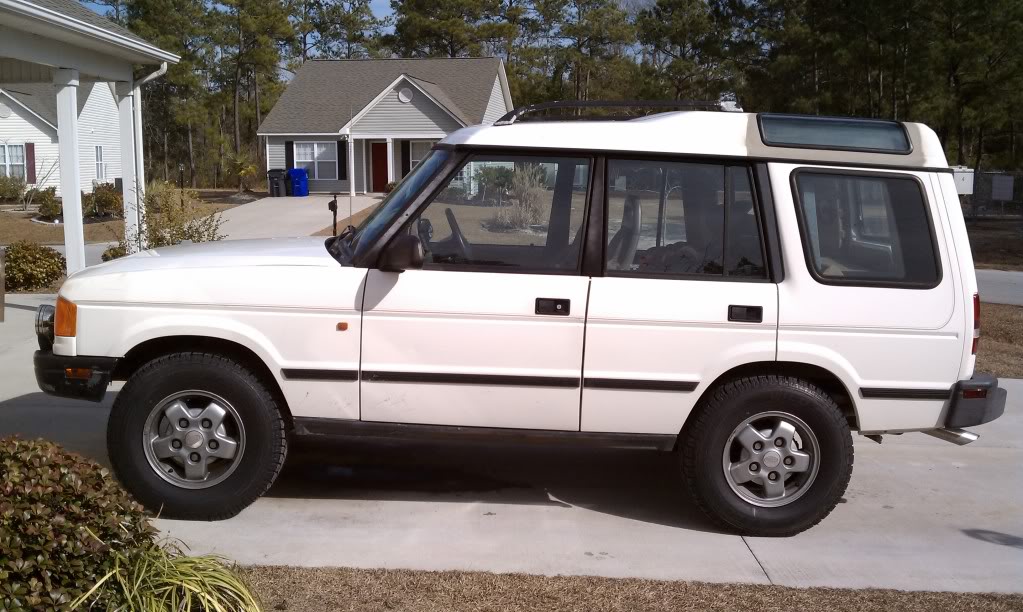

Old Feb 15, 2011 | 05:34 PM
tweakrover's Avatar
Joined: May 2009
Posts: 1,348
From: North Carolina Coast
new 245/75-16 on stock truck, now if the lift would just get here already.Name:  IMAG0082.jpg

Old Feb 16, 2011 | 01:18 AM
tornado_735's Avatar
Joined: Jan 2008
Posts: 854
From: Ohio
LOL For a second, I was like "Where in the sh*t did someone get a picture of my truck?!"
