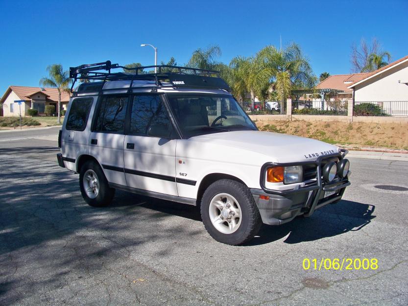

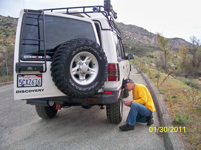

Just an FYI. I just did the TF 2" HD kit with the Goodyear MTR/K and I'm rubbing on the rear fender off-road. I may have to trim the corner about 3" on top and 2" on the bottom to clear. I'll send some pictures next.
Old Jan 31, 2011 | 08:29 AM
jefsantiago's Avatar
Joined: Aug 2009
Posts: 44
Default TF 2" HD Kit (post install)
Here's the before and after. Also, the picture where I had to bend a portion of the back fender while off-road.
Attached Thumbnails 265/75/16 on stock suspension-101_0941.jpg   265/75/16 on stock suspension-101_1037.jpg   265/75/16 on stock suspension-101_1045.jpg
