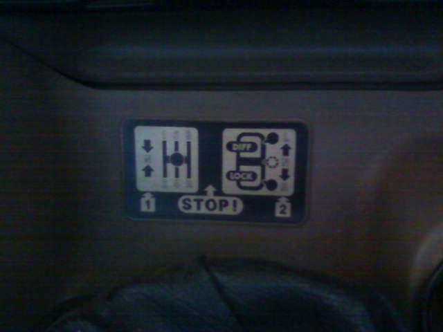

From 94 the stock Disco came out with T 230 transfer case.
The 3rd diff in the transfer allows the 70% rear and 30% front torque distribution under normal driving conditions. That is with shift lever to the right and down.
With selector pushed upwards you will engage Low range but still 70/30 only more torque.
When the lever is pushed on the neutral line towards the left the 3rd diff will engage (Lock) Then the torque distribution is 50/50 front an rear.
Your dash indicator will show the orange 2 diffs and 4 wheels.
With the lever in this position down it is locked in high range 4x4(50/50)
With lever upwards you should have engaged 4x4 low range and not to exceed 40 km/ph in this selection.
To solve your mystery lift the center console and see if all the links is there.
It might be stuck or bended.
Happy hunting
